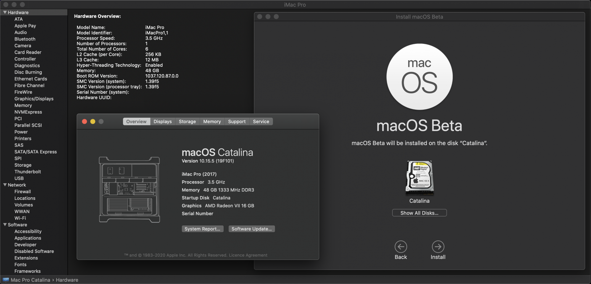

One step further. In order to let the installer run properly, we need to completely spoof the SMBIOS.

It’s installing now.
We will know if complete SMBIOS spposing is only required for installing soon.

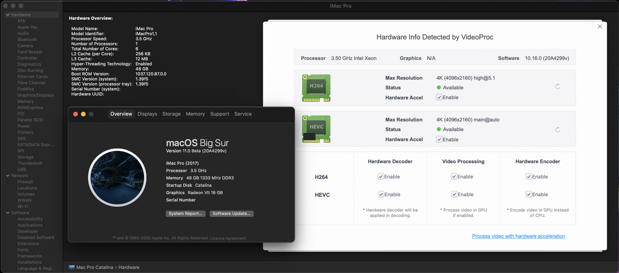

Base on the early stage OC experience (we used complete SMBIOS spoifing to activate HWAccel). Complete SMBIOS spoofing should be quite safe. But of course, it will be much more ideal if we can keep the 5,1 ident.
I believe I am using complete SMBIOS spoofing then currently if it is what is in your hardware acceleration package... I wonder if I just have a bad install image or something.

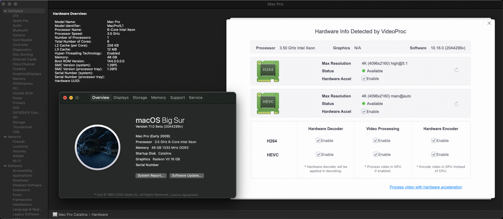

You can check the first few pages of this thread. We posted about how to completely spoof the cMP as iMac Pro at there.

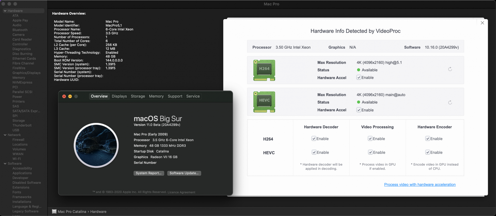

Anyway, we just need to spoof the cMP ident for installation. Once Big Sur is installed, we can boot Big Sur with the current OpenCore config and keep the 5,1 ident.
Anyway, we just need to spoof the cMP ident for installation. Once Big Sur is installed, we can boot Bit Sur with the current OpenCore config and keep the 5,1 ident.

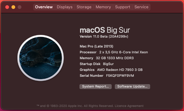

Got Big Sur installed with OpenCore, so that's exciting. Missing bluetooth (I have a 2015 iMac card), Raid Card says it has no driver, and don't see nightshift so not sure if Lilu & such is working either. Great start though!

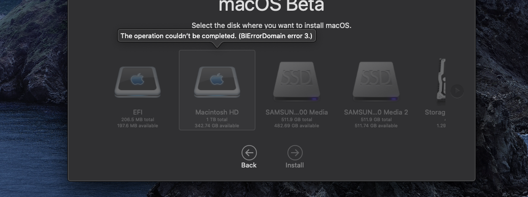

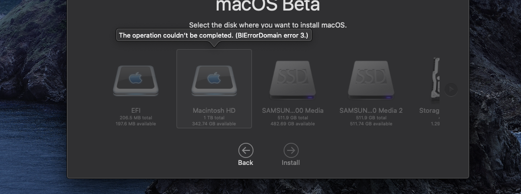

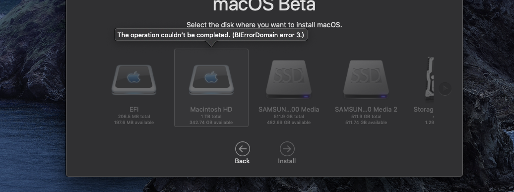

I get the error The operation couldn't be completed BIErrorDomain error 3 when update SMBIOS is false, when it is true it says, the disk need a firmware updates etc etc ... so I then switch back to false and gives me again the above error ...
My BCM943602CS works, Magic Mouse works straight away. Personal Hotspot and Handoff also works.

I get the error The operation couldn't be completed BIErrorDomain error 3 when update SMBIOS is false, when it is true it says, the disk need a firmware updates etc etc ... so I then switch back to false and gives me again the above error ...View attachment 926369
The way to spoofing your 5,1 as iMac Pro 1,1 is at post #7.
N.B. You may need Lilu, WhateverGreen, and agdpmod=pikera in order to let the graphic card display properly (in most case, one of the Display Port should still work without all these. But you have to find out which one).
For dual CPU cMP, you may need AppleMCEReporterDisabler.kext as well even just for installation.
