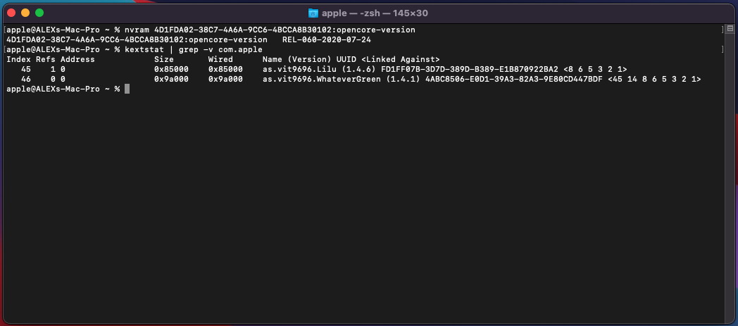

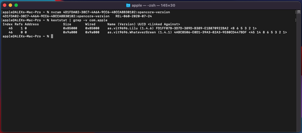

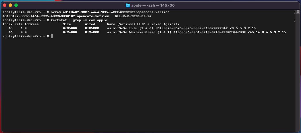

Check that OpenCore has actually booted the system by entering: nvram 4D1FDA02-38C7-4A6A-9CC6-4BCCA8B30102:eek:pencore-version

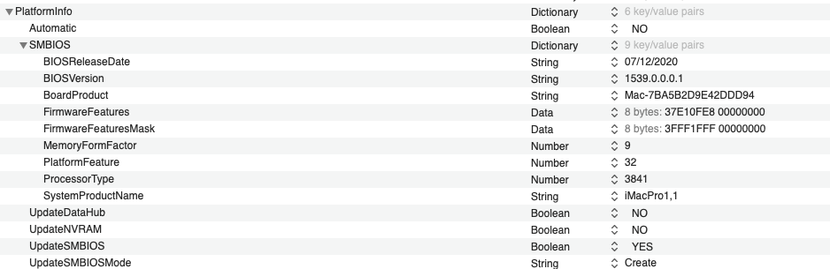

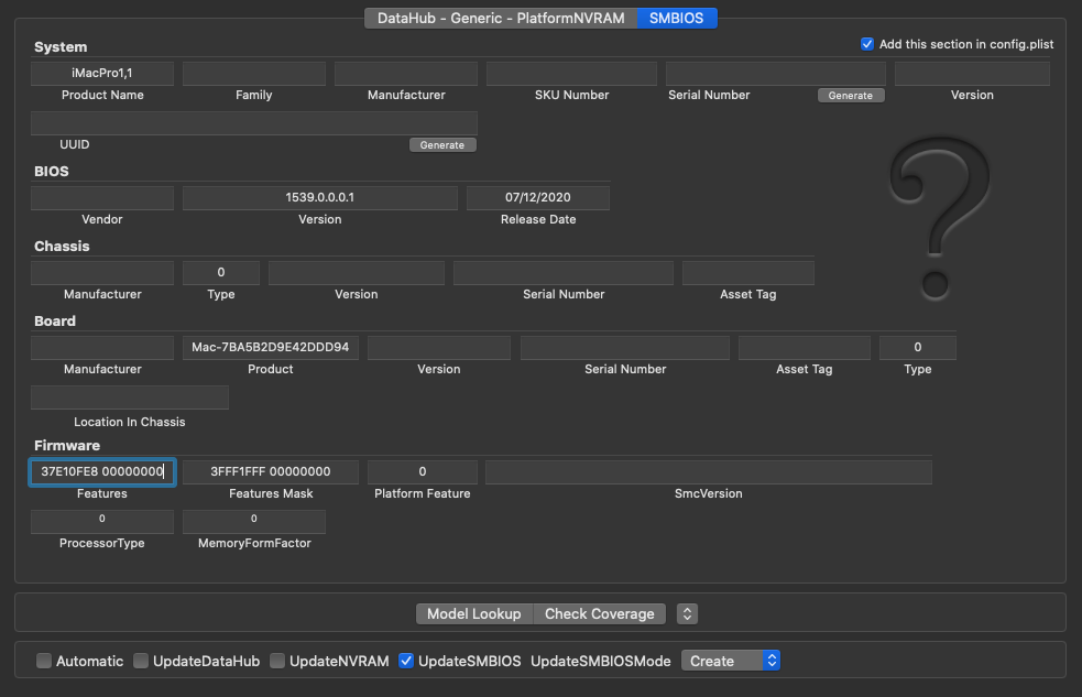

So @startergo just looking at the SMBIOS generator on OpenCore Configurator, it appears that the values can be inserted directly into that as:
37E10FE8 00000000
3FFF1FFF 00000000
Screenshot:
Those translate into base64 encoded versions as:
Code:
            <key>FirmwareFeatures</key>
            <data>N+EP6AAAAAA=</data>
            <key>FirmwareFeaturesMask</key>
            <data>P/8f/wAAAAA=</data>
37E10FE8 00000000
3FFF1FFF 00000000
Screenshot:
Code:

No longer over to install Beta 11.0 (20A5323l) use SMBIOS from iMacPro OpenCore by williambj1 RELEASE

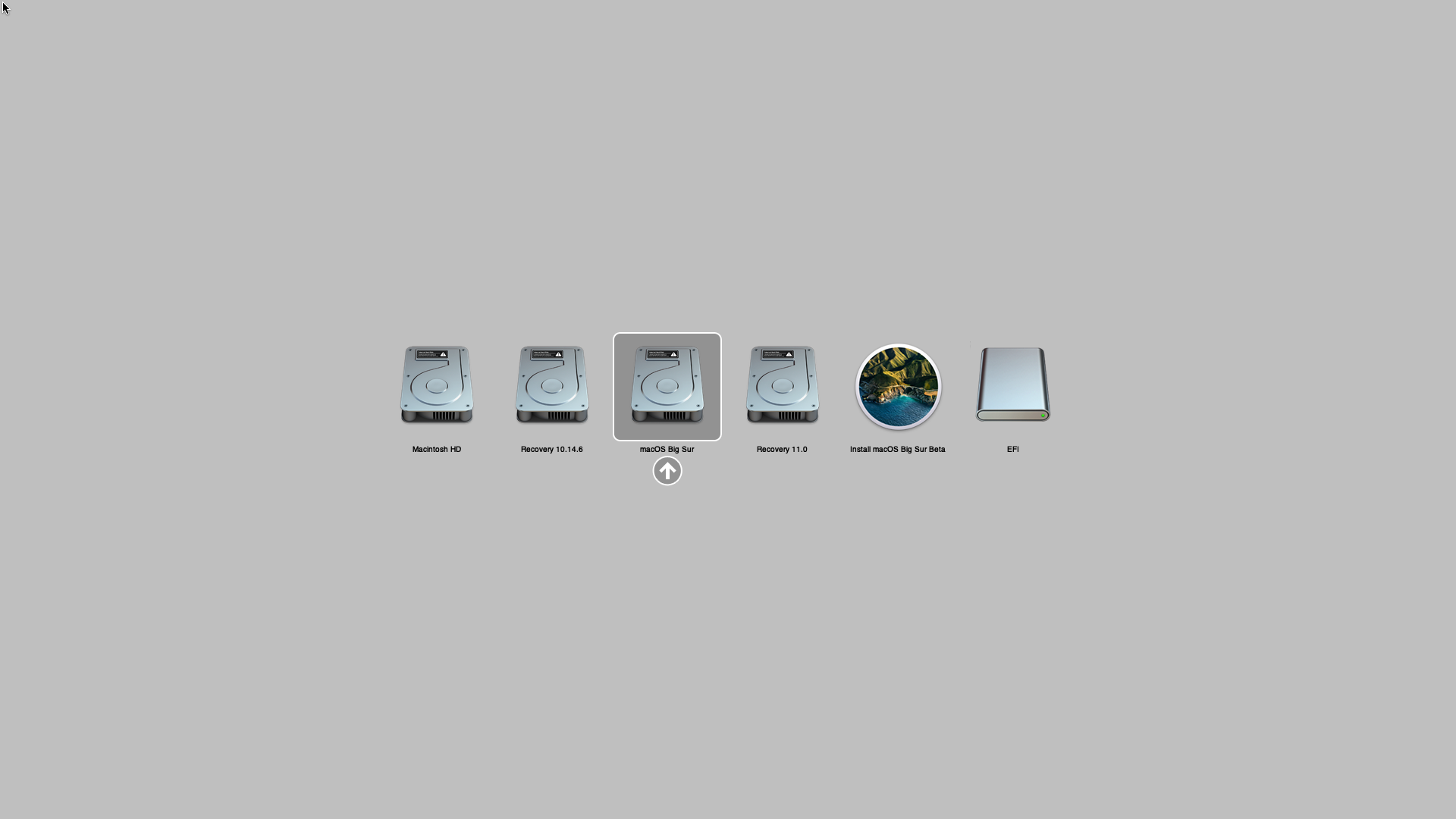

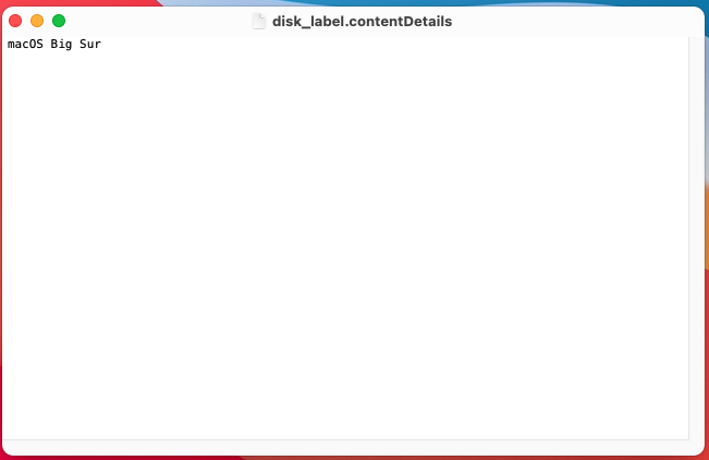

To those who use BigSur through OpenCanopy boot menu, I noticed that BigSur is showed only as Preboot, I found a way to rename it (for OpenCore), and it consists in using this attached and copy it, from BigSur normal booting, on this path:
/System/Volumes/Preboot/YourBigSurUUID/System/Library/CoreServices/
then you can rename the "BigSur label" using this attached (it's an hidden file) with a plain text editor, it should work.
  • disk_label.contentDetails.zip

I rephrase, you should unzip that attached in that BigSur Preboot path, then from that path you can edit with a plain text the content of this file .disk_label.contentDetails

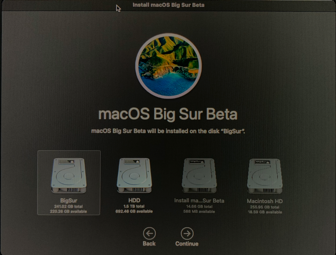

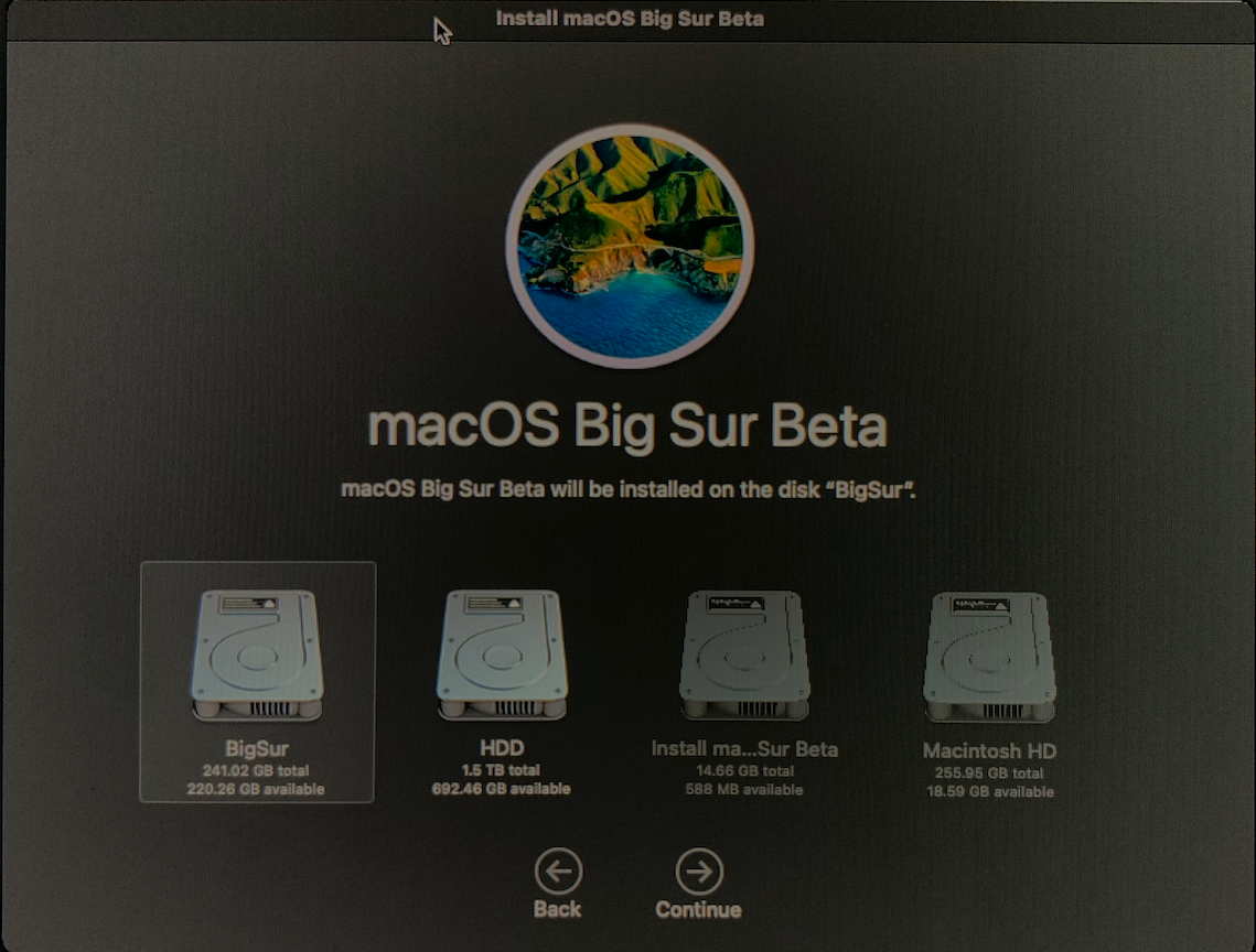

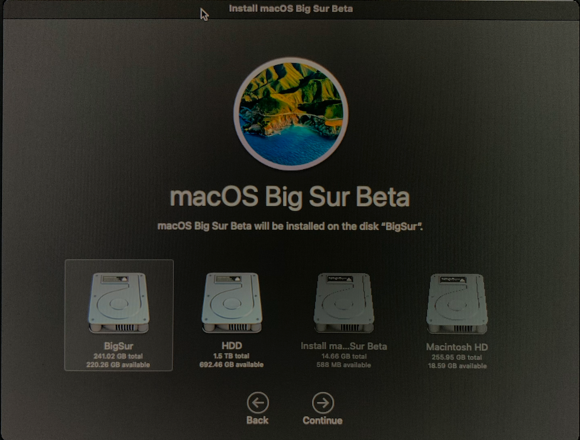

You actually click one of those disk, and successfully perform the installation?
Yes

Do it like this and everything will be fine))
