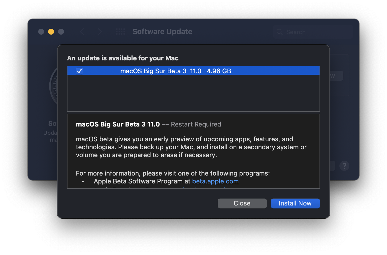

Yes, that works.

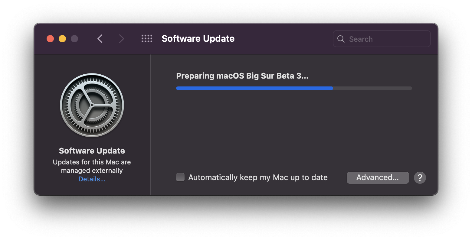

Once click the "More info..." it will download the 4.96GB incremental update image, but not the full 12.88GB full update image.
And it seems this more like the iOS OTA update. It has pretty long preparation time.

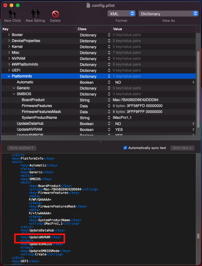

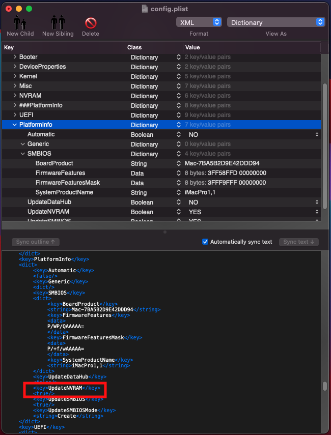

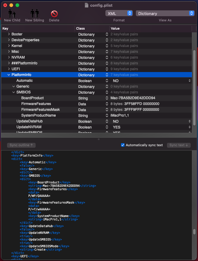

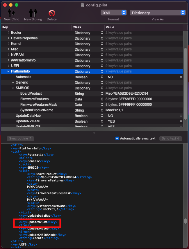

First I used full SMBIOS spoofing for the upgrade after which switched back to board-id only spoofing and later to this one (the one you linked):
See here update NVRAM is true but PlatformNVram is not defined. Here is a one liner to quickly check most of the parameters needed for iMessage:

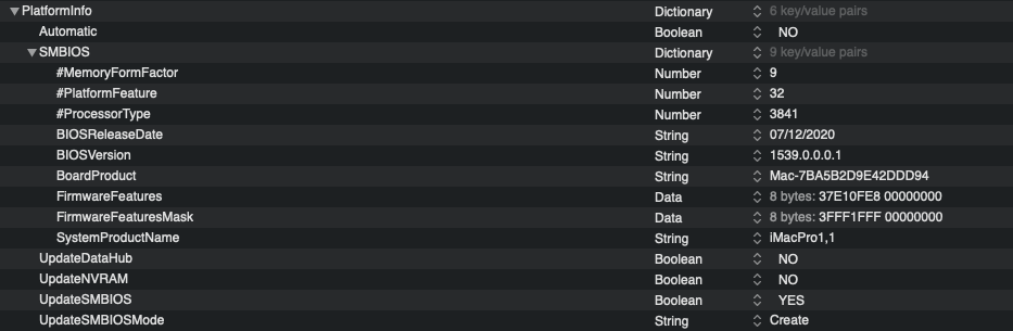

with full SMBIOS spoofing try :
BIOSVersion: "1539.0.0.0.1" BIOSReleaseDate: "07/12/2020"
IMO, it's either use automatic spoofing, then only fill in the MLB, ROM, System Product Name, Serial number, and UUID in the Generic section.
Or complete manual SMBIOS injection (fill in every single item in the DataHub, PlatformNVRAM and SMBIOS section).
I never try to use manual mode but only inject so little info. That may be the issue.
But still you need to create a new iMacPro identity for the iMessage. On the top of this if you change the UUID, the licensed software will stop working, so will the licensed Windows installation. This may be used as a temporary fix for upgrading/updating, but I would recommend logging out of all Apple subscriptions beforehand. This should not be used on regular basis.

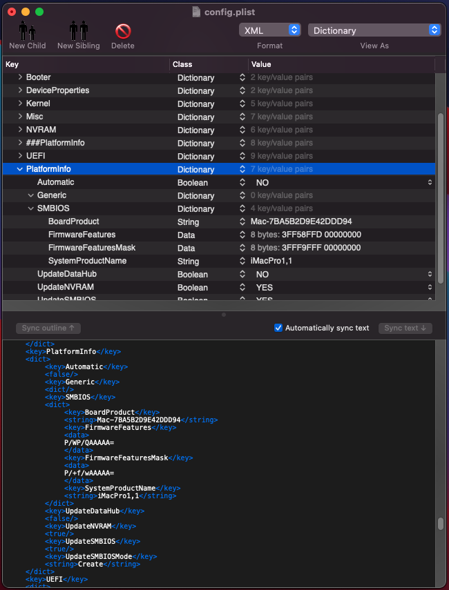

In looking at the suggestion to try an iMacPro1,1 I see that you did this yourself. Right now I am using the BoardProduct of Mac-7BA5B2D9E42DDD94, but where do you get the other values (and are they needed?) that you're using for your hybridization from your screenshot?
From here. I am not sure if all are needed. I disabled the first 3:
Thanks for pointing that out - on the FirmwareFeatures and FirmwareFeaturesMask: both in Xcode and other options, nothing seems to give the same result that you have shown there for the data contents. How did you insert these two values? I could cheat and ask you for a copy of your config.plist, but I'd also like to understand how to edit data fields in these plists properly...
Code:
FirmwareFeatures: 0xFD8FF53E
FirmwareFeaturesMask: 0xFF9FFF3F
