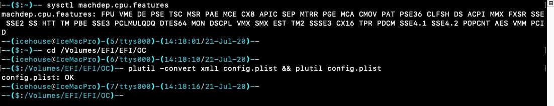

Has anyone used OpenCore Configurator? The changes to config.plist seem pretty innocuous except for the SMBIOS section where it inserts a lot of blank fields in. It doesn't alter the actual BoardProduct, just the other fields around it to blanks. It's also seemingly easier to just modify the VMM value therein via 00000000 00000000 00000000 00000000 for AAAAAAAAAAAAAAAAAAAAAA in Cpuid1Mask. Of course VMM enabled is 00000000 00000000 00000080 00000000 (AAAAAAAAAAAAAACAAAAAAA).

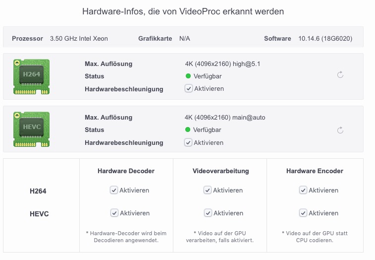

Hello,

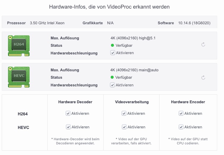

first of all: Thank you for all your work. Great wiki (first post) that helped me to build my own config file (attached)
Everything works great - OC 0.5.9 (my version) and the HW Acc (Lilu 1.4.5 / WhateverGreen 1.4.0) and the OpenCanopy Boot Picker. Today I try to make a test install of macos 10.15 with the original installer from Apple. I prepare the config file (attached) with the Cpuid1Mask value to get the VMM status and also I proof the config file before (see picture VMM-Valid-Config). I reboot and test the VMM status (it's there) but then I get a big surprise: The macos 10.15 installer shows me up all APFS drives greyed out and only a HFS+ drive for valid install - I don't try to install there because of importand data. If I click the drive where I want to install 10.15 a small baloon help shows me the hint that I need a firmware update before. I can press the drive icon but there is NO install button that I can click.
The config file is build by myself... I double check my entrys but I am not be able to find my mistake. I am looking for help / a hint...
Thank's for reading.

Hello,
Disable SMBIOS spoofing for Catalina installation / update.
Awesome...🖖 thank you very much. That hit the nail. Sometimes I don't see the wood because of the trees 🤪

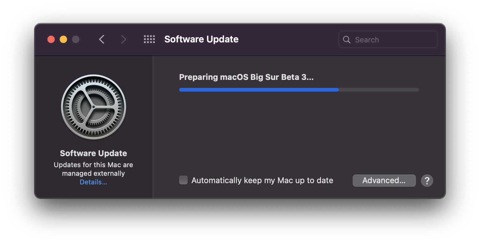

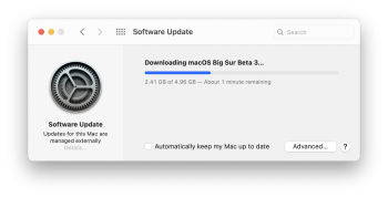

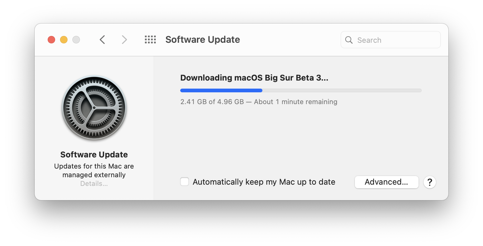

@h9826790 do you tried to upgrade BigSur through opencore spoofing using the new method that apple labels "Incremental update image"
I made an attempt here (my customized opencore setup is based on 0.5.9): https://forums.macrumors.com/thread...unsupported-macs-thread.2242172/post-28699756
but after the "BigSur OTA update" starts to download then fails some checks, maybe the sealed snapshot volume is the issue.

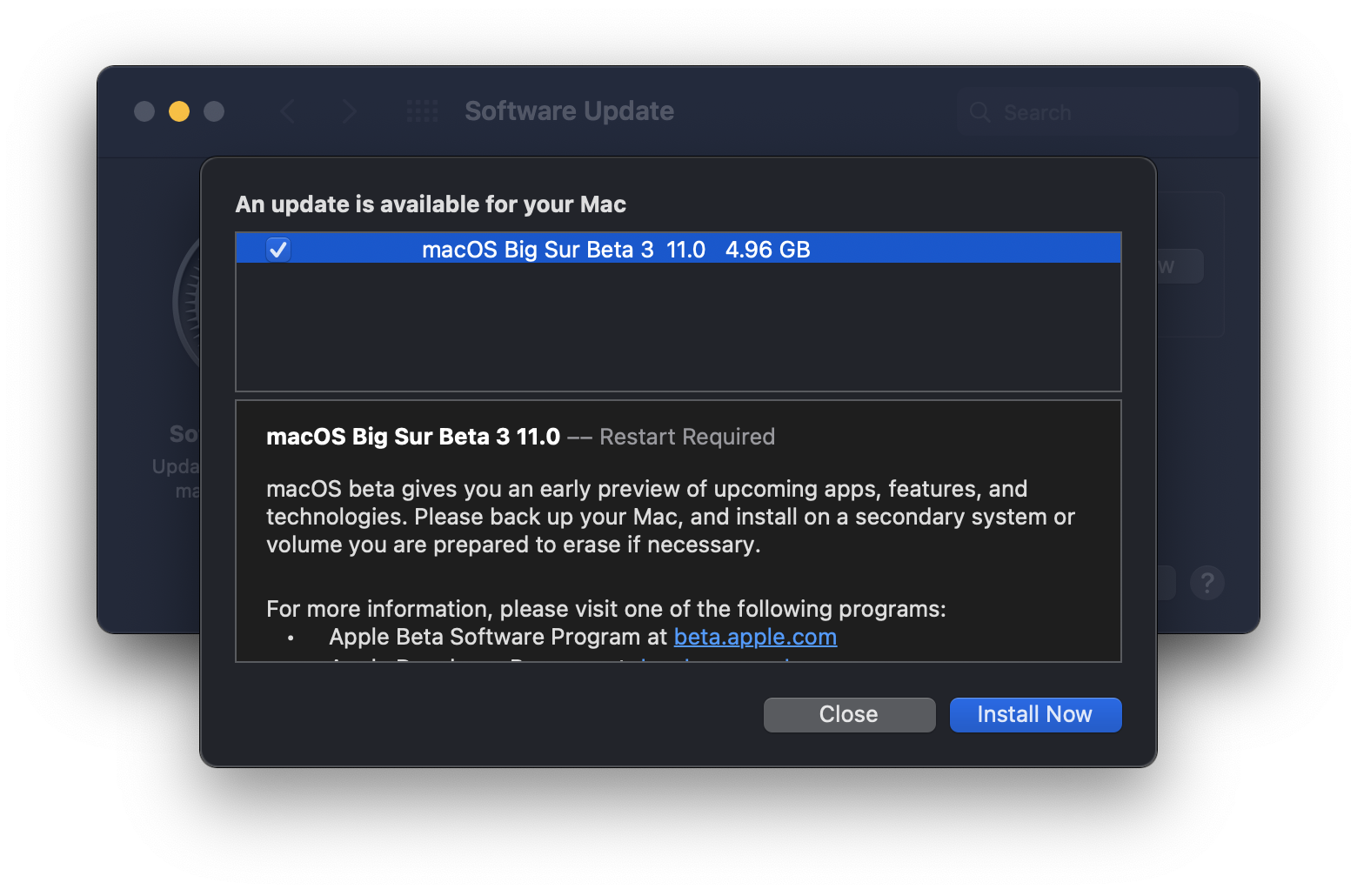

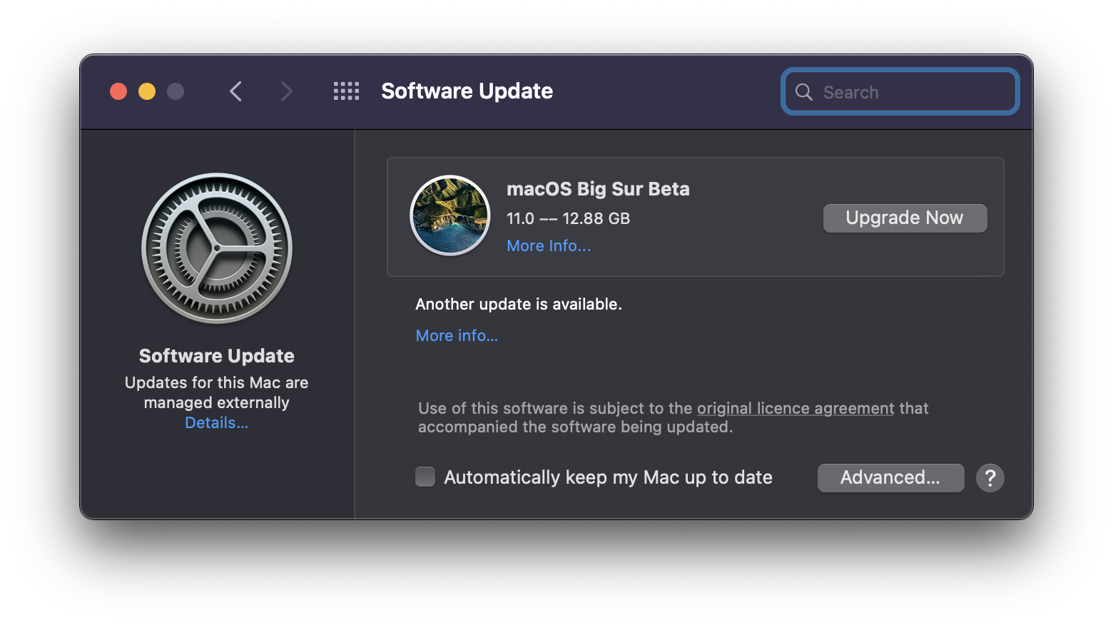

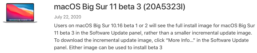

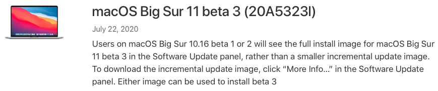

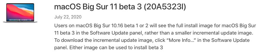

Yes, that works.

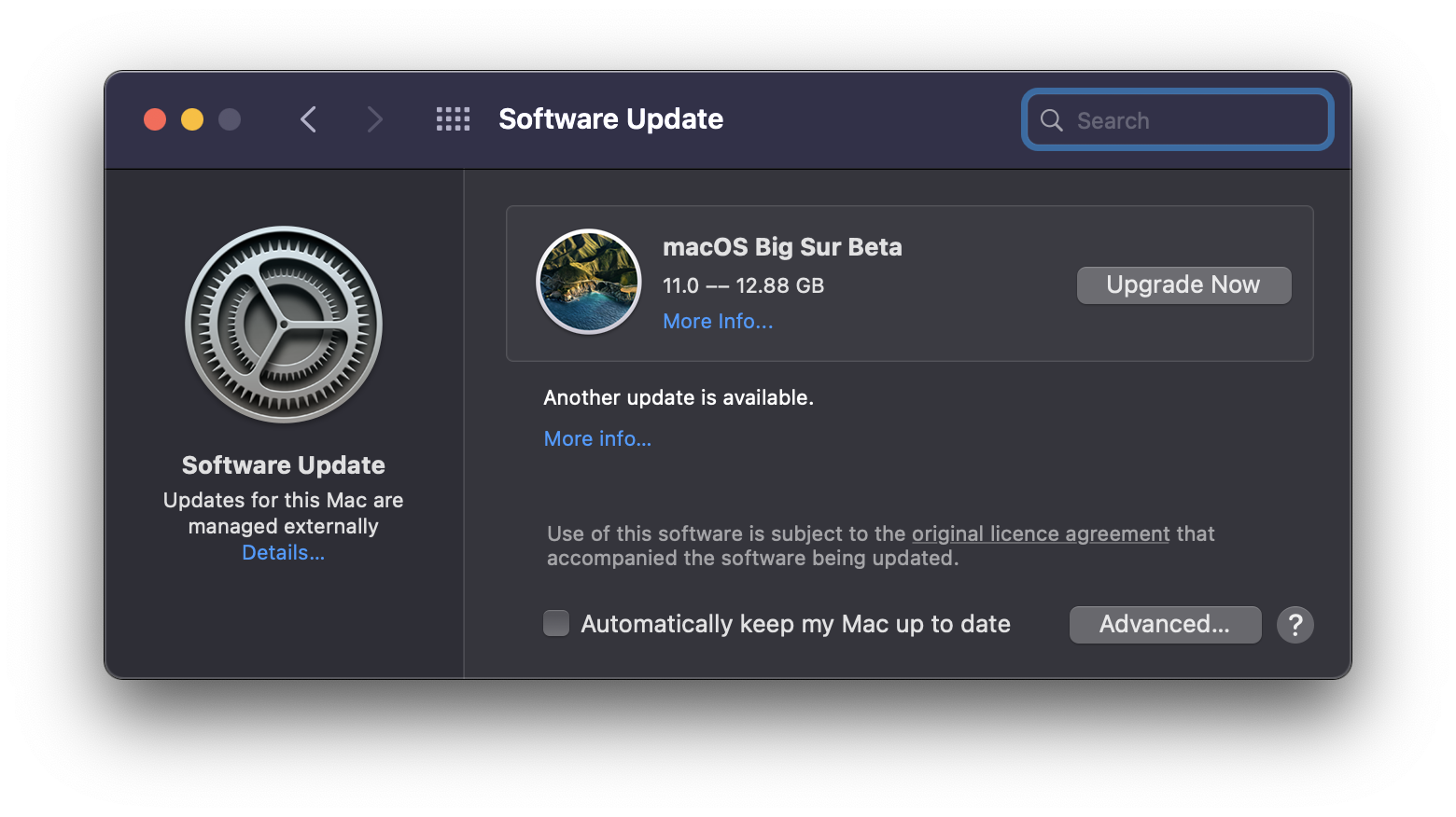

Once click the "More info..." it will download the 4.96GB incremental update image, but not the full 12.88GB full update image.
And it seems this more like the iOS OTA update. It has pretty long preparation time.
Yes, that works.
Once click the "More info..." it will download the 4.xxGB incremental update image, but not the full 12.88GB full update image.

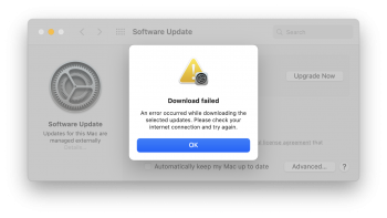

This is the error I get when I try to do the incremental update.
I am using smbios 'hybridization' so I have modified my Board ID, but everything else is still the same. I will try enabling the VMM flag and see I get different behavior, but perhaps I need to spoof a iMacPro to download the incremental update.
Update: I have to have the VMM flag enabled to do the incremental update.
