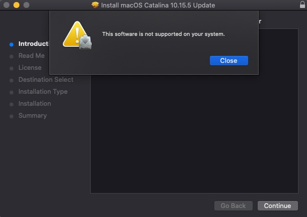

Updating from 10.15.4 to 10.15.5 via combo updater with OpenCore 0.5.9 and got "This software is not supported on your system."
What should be done to work around this?
Enable VMM on OpenCore config?
Oh that's right - slipped my mind. Are we supposed to enable it for updates and then disable for running regularly?
