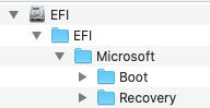

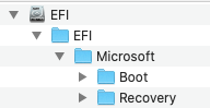

Hi cdf, before I do the final step, I'd like to check everything is as expected. My current 'Bootcamp' EFI folder structure looks like this:

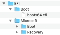

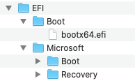

The saved EFI folder (i.e. that was in the trash after OC Bootcamp installation) looks like:
I.e. with an additional Boot folder, containing bootx64.efi, alongside the Microsoft folder. In both cases the Microsoft folder contains a Boot folder, and both of these Boot folders contain a lot of files.
If I copy the whole backed-up EFI folder into /Volumes/EFI, Finder will want to replace the contents of the Microsoft folder, in addition to adding the Boot folder containing bootx64.efi. Is this intended?
Doing a folder compare, most of the files in the two versions of Microsoft/Boot are identical, but a handful of BCD files have changed.
Copying just the EFI/Boot folder (the one containing bootx64.efi) into place should be enough for our purposes. We just want to see if Parallels expects it to be there. If Parallels is still no go, I recommend that you go back to the original contents (the configuration shown in your first image).

Windows started straight up, installed Parallels Tools and is working as normal. With the bootx64.efi in place, is there any danger of Windows bricking my Mac Pro, whether opened via Parallels or by directly booting in to it?
Great! So that was it. The risk is only with your Mac booting Windows directly, outside of OpenCore. Make sure to never have just the Windows disk in your machine. As an extra precaution, you can set BootProtect in your config to "Bootstrap." This will help make OC persistent. If OC's bootx64.efi ever gets overwritten, OC will still boot. (Although this is mainly if you're using the same EFI partition for OC and Windows).
Thanks for all your help cdf. macOS and Windows are on separate disks here (NVMe and SATA SSD respectively), so I assume BootProtect won't really help in this case?
Correct. It's just an extra measure to keep in mind in case your configuration changes.

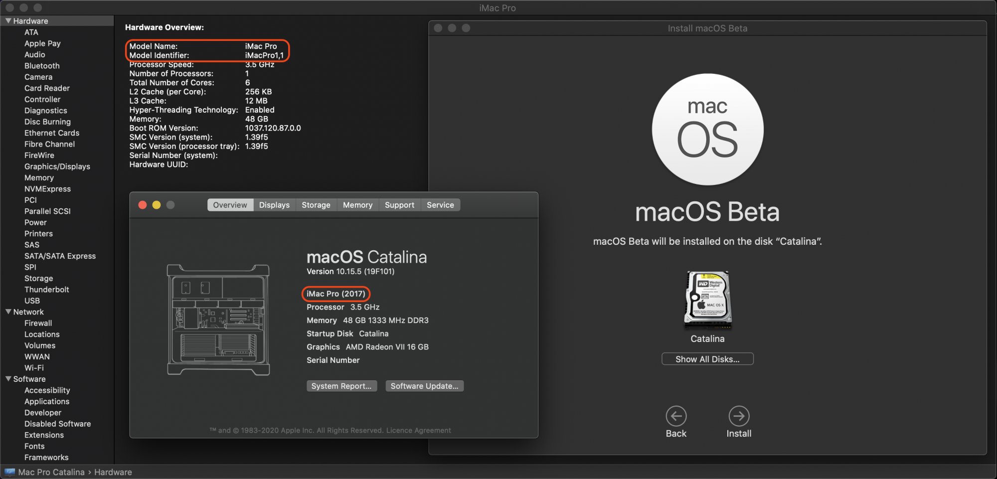

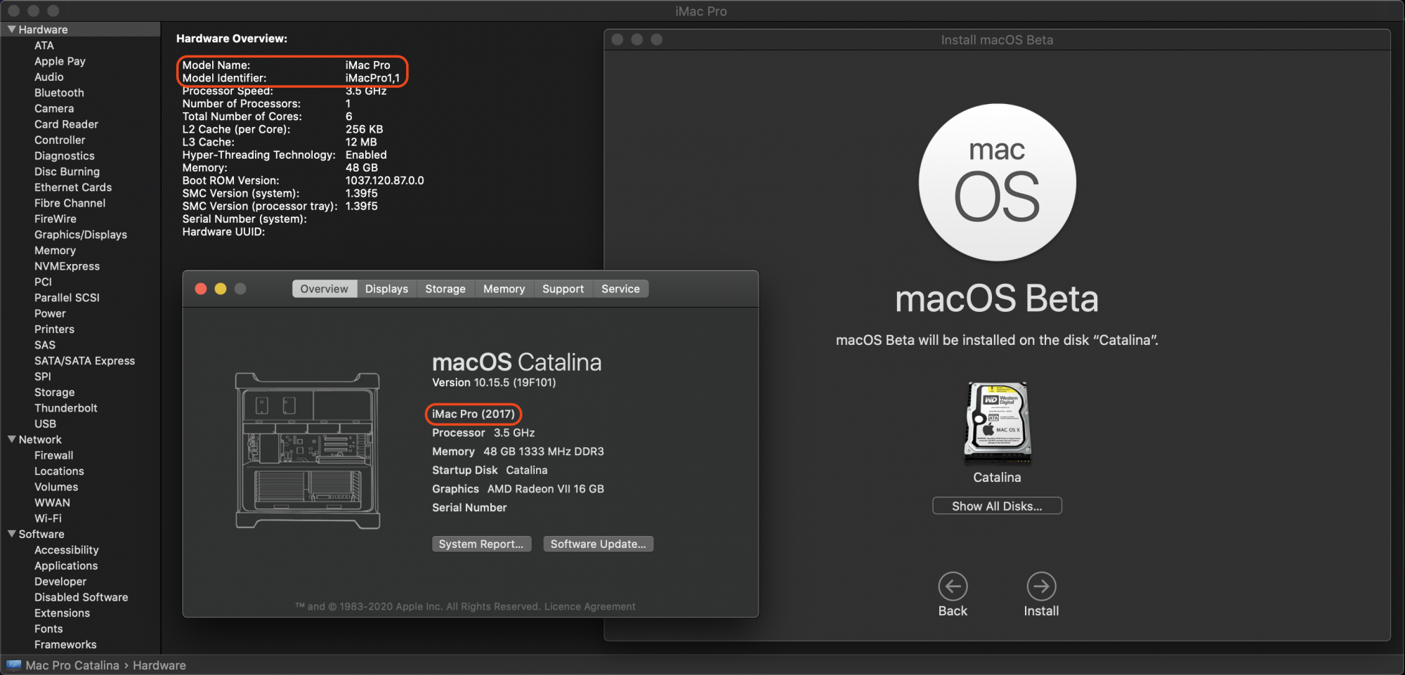

I just try the whole Big Sur installation again onto a newly formatted HDD. The whole process is really very native.
1) Boot cMP 5,1 via OpenCore with complete iMac Pro SMBIOS spoofing (VMM flag can stay off, the required code in post 7)
2) Boot to Mojave (or Catalina) desktop.
3) Run the Big Sur installer.
4) Select the newly formatted HDD/SSD as destination
5) Let it finish the whole installation by itself. As long as you have time out function set in boot picker. 100% no need to touch the cMP during installation.
6) After boot to Big Sur desktop. Mount the EFI partition again, and turn off SMBIOS spoofing (N.B. the no compat check boot argument MUST in the config.plist as per post 1).

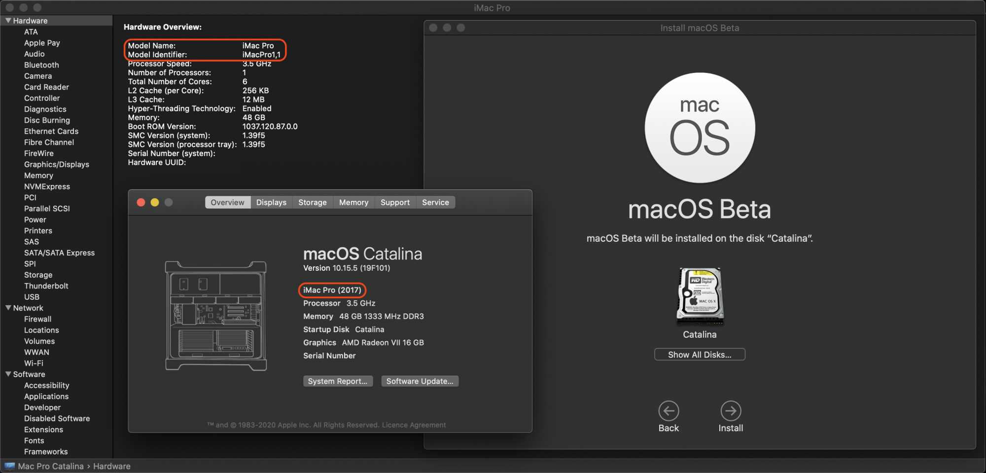

I am attempting this with a Mac Pro 4,1 -> 5,1 with 2 x 2.66 GHz 6-Core Intel Xeon and flashed R280x successfully using Open Core and running Catalina. I was able to enrol the Mac in the beta and download the Big Sur update but I get the BIErrorDomain Error 3.
I attempted your spoofing iMac fix by copy and pasting the text into the configuration file and the computer will boot loop unless I turn off VMM flag then it will startup to the macOS properly. once it starts up with the VMM flag off I start the Big Sur update however the drives are greyed out and the message BIErrorDomain Error 3 is given.
Any idea what I am doing wrong?
The "normal" config should be with VMM off.
Does your cMP ident as iMac Pro?
It wasn't identifying as an iMac so I thought it may have been booting off my working Catalina OpenCore EFI so I removed all drives and reinserted the iMac code into the drive I am trying to make Big Sur and turned of the VMM Flag. The computer boots to 3/4 of the progress bar then kernel panics. Is it because I have a R280X that the computer can't spoof as a iMac Pro?
I checked my Config file in OpenCore Configurator and it is system identifying as a iMac Pro 1,1
Has anyone had success with OpenCore on MP 3,1? If so, could you point me to the right resources? AFAIK there's no support for E5462 Intel Xeon but maybe somebody found a way.
We can't tell if you did anything wrong without your EFI folder (or at least your config.plist).
If you suspect the flashed 280X is the problem, then you may try the 6,1 SMBIOS. The 280X is actually the D700.
