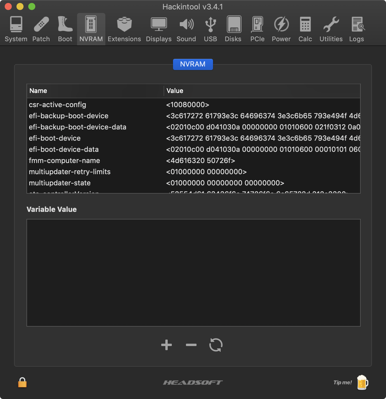

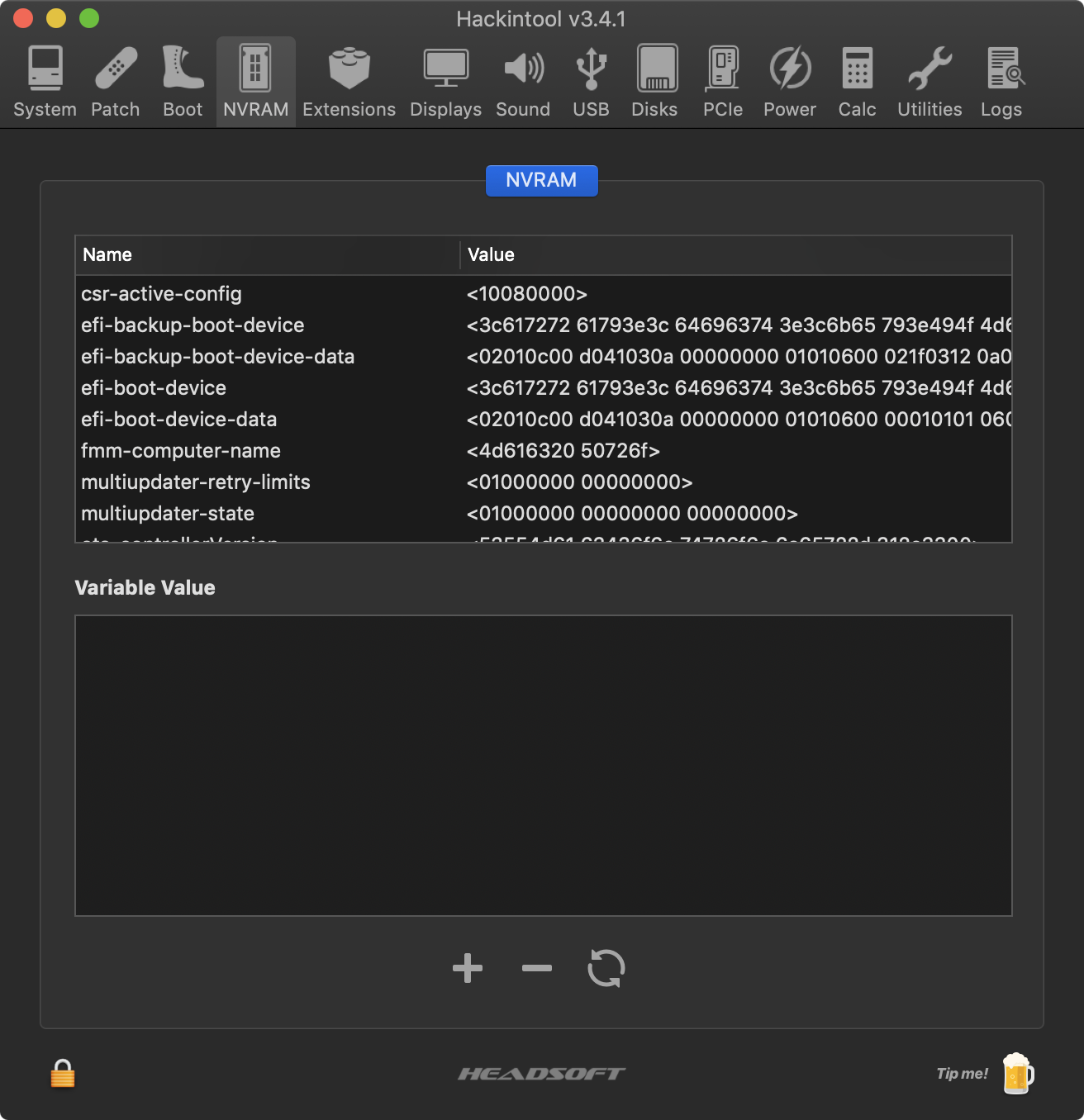

Using this "csr-active-config" on OpenCore 0.59 config.plist : ZwAAAA== (that is the standard El Capitan SIP disabled 0x67)
now from OpenCore menu targeting any macOS Recovery (BigSur included) or macOS Installer, I can use csrutil authenticated-root disable (or nvram csr-active-config=w%08%00%00 ) without any "This tool needs to be executed from the Recovery OS".

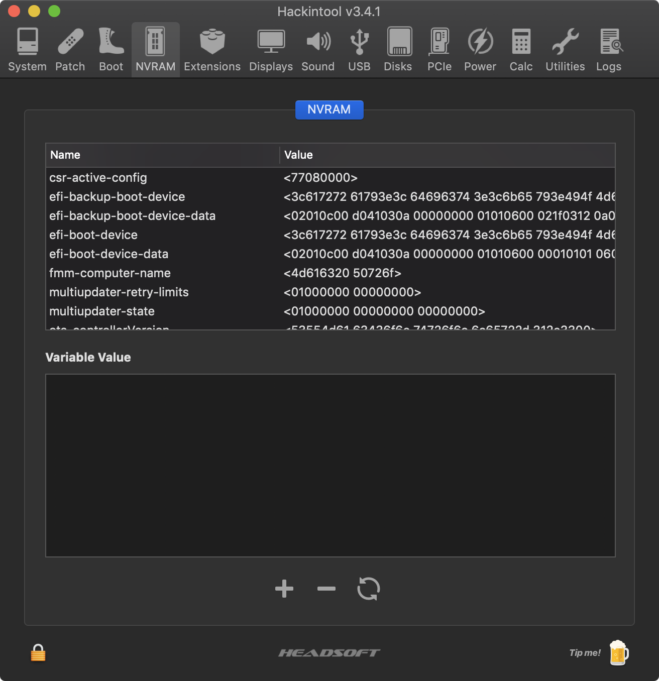

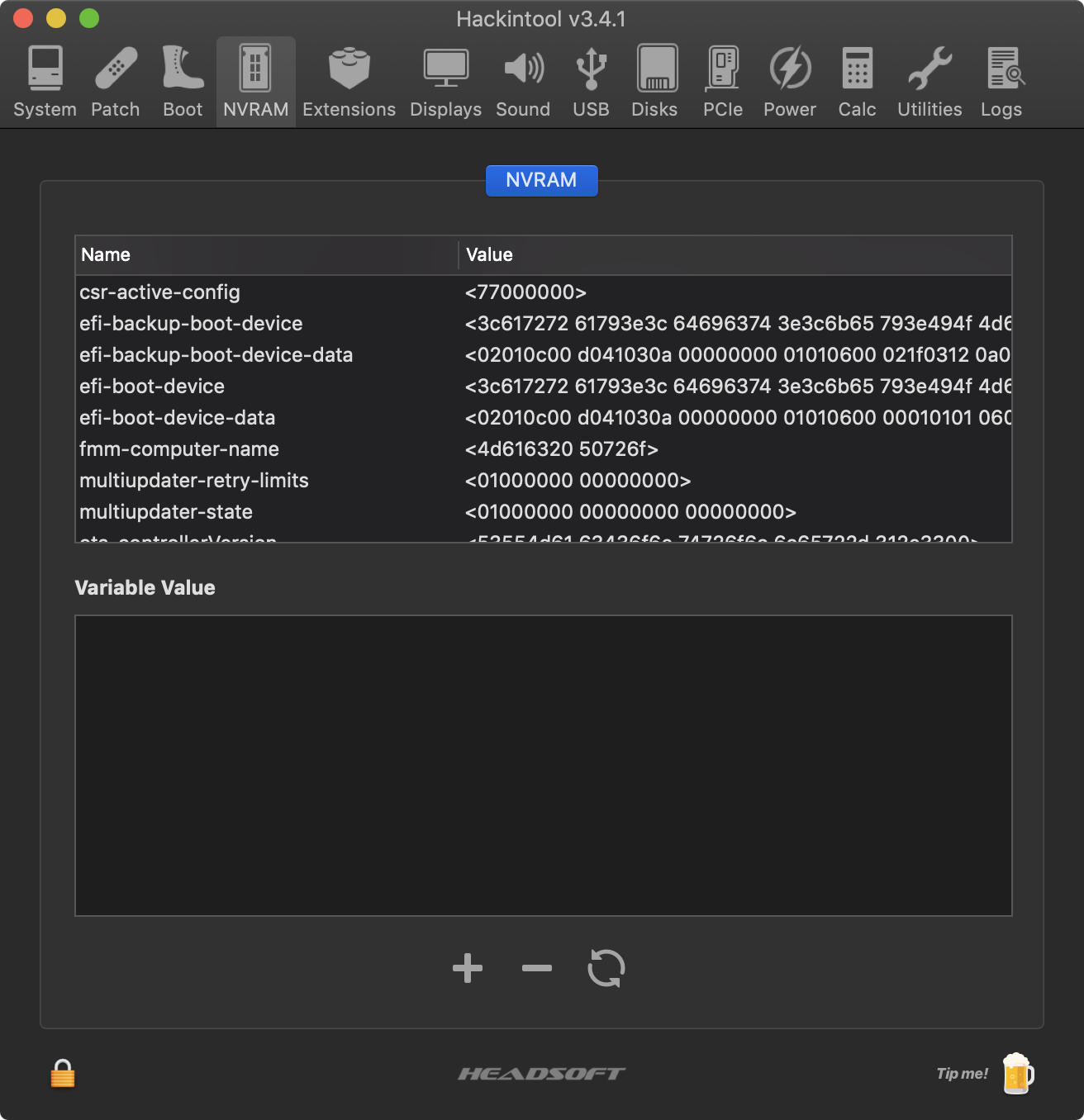

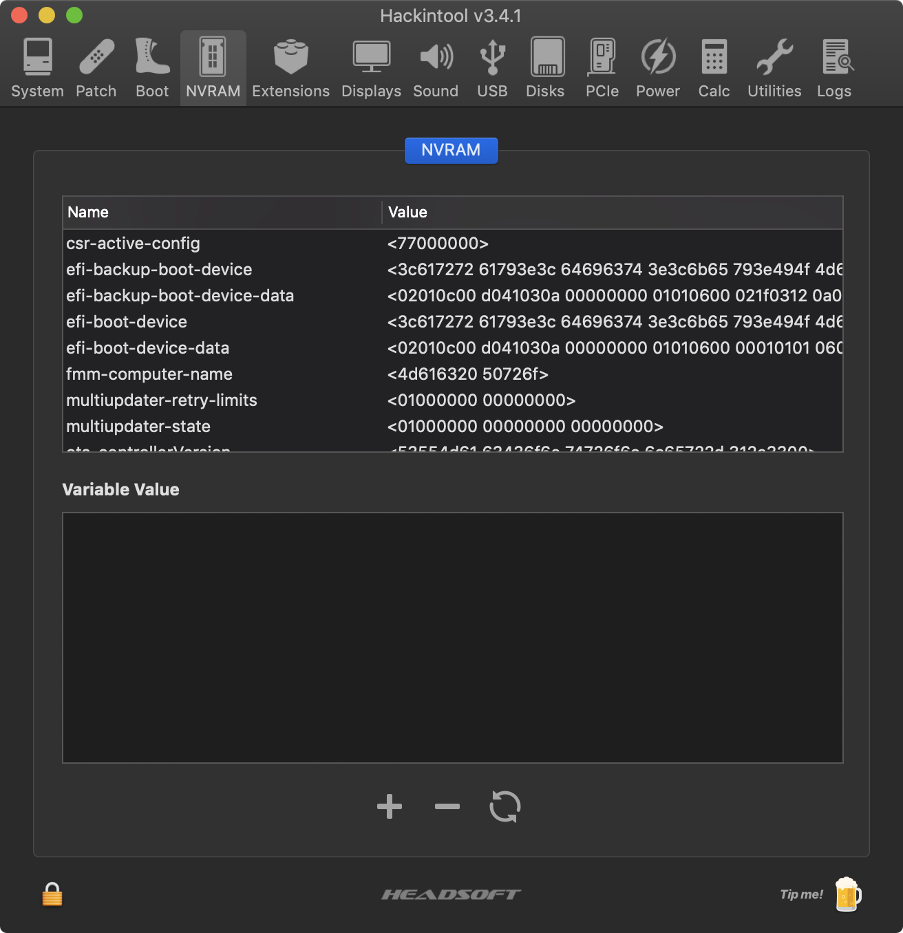

If you disable SIP in Mojave Recovery Partition, 77000000 will be written into the NVRAM.

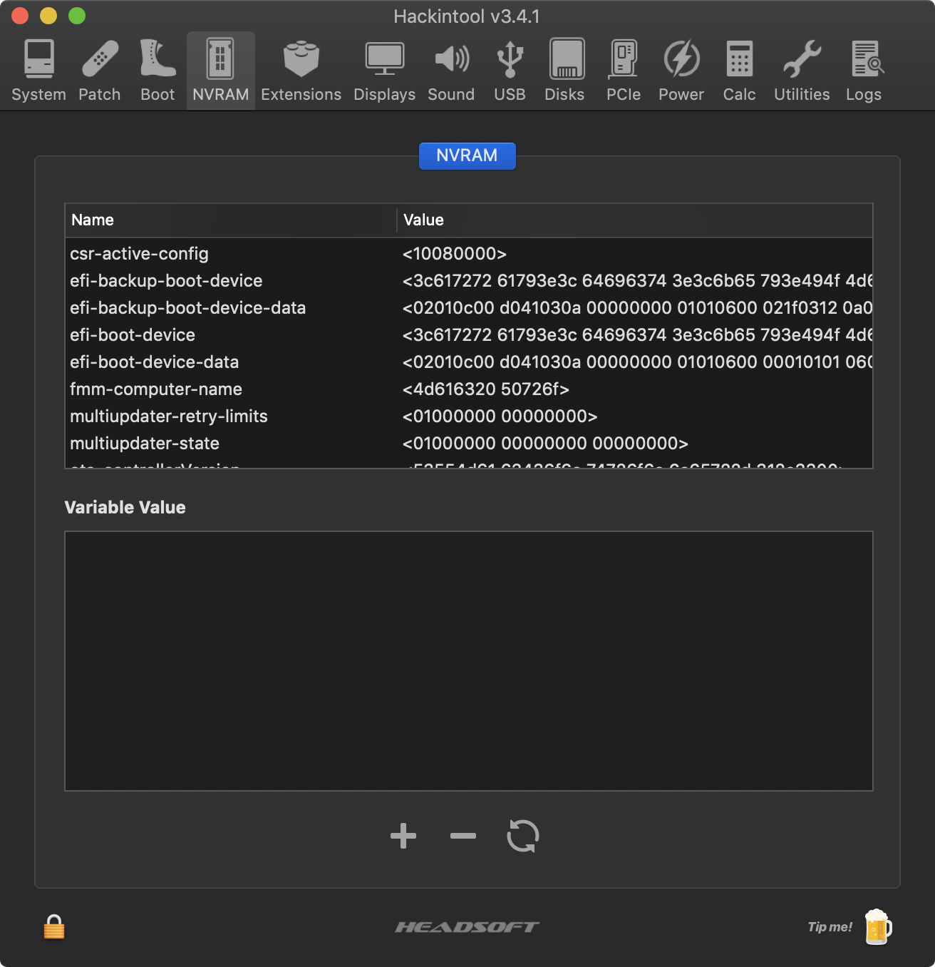

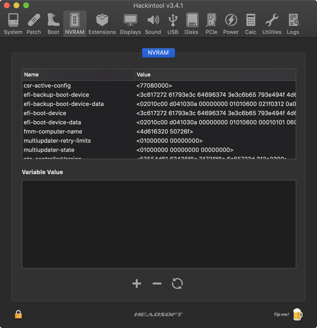

If you disable SSV in Big Sur Recovery Partition (by running csrutil authenticated-root disable in terminal). 10080000 will be written into the NVRAM (SIP still enabled)

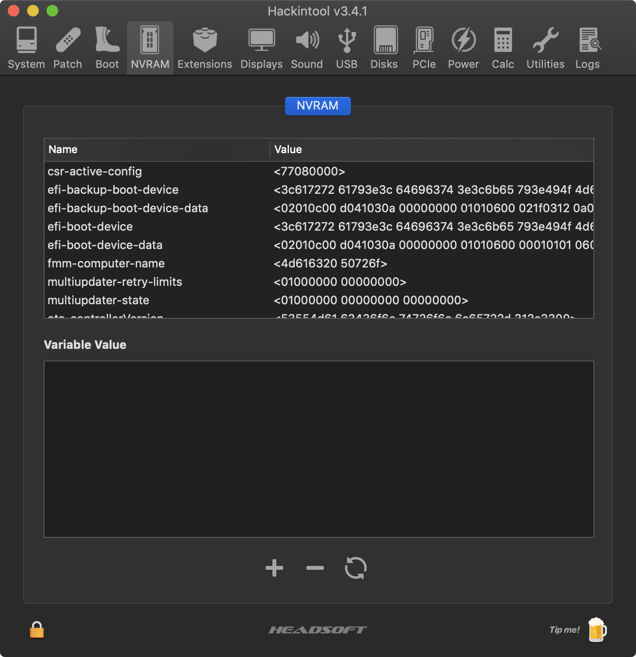

If you disable SIP in Mojave Recovery Partition, then disable SSV in Big Sur Recovery Partition (MUST in this correct order). Then 77080000 will be written into the NVRAM.
So, if you want to keep both SIP and SSV disabled, 77080000 should be the key value for csr-active-config. Which is dwgAAA== in Base64

If you disable SIP in Mojave Recovery Partition, 77000000 will be written into the NVRAM.View attachment 932484

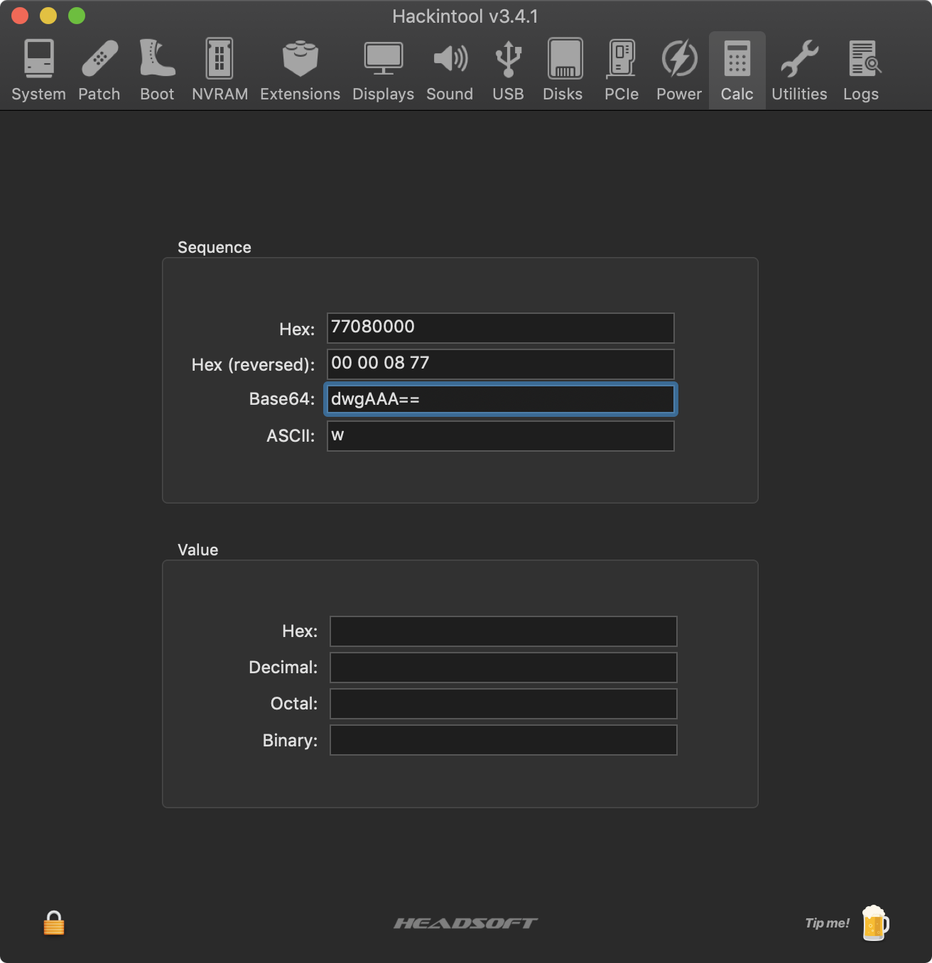

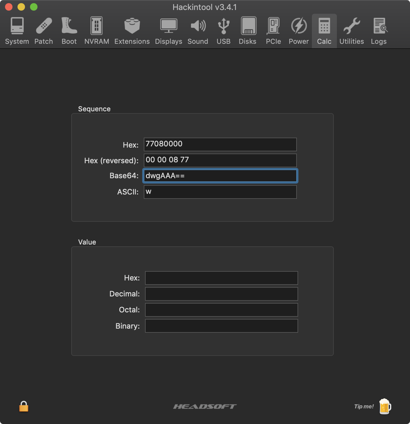

So, if you want to keep both SIP and SSV disabled, 77080000 should be the key value for csr-active-config. Which is dwgAAA== in Base64View attachment 932487

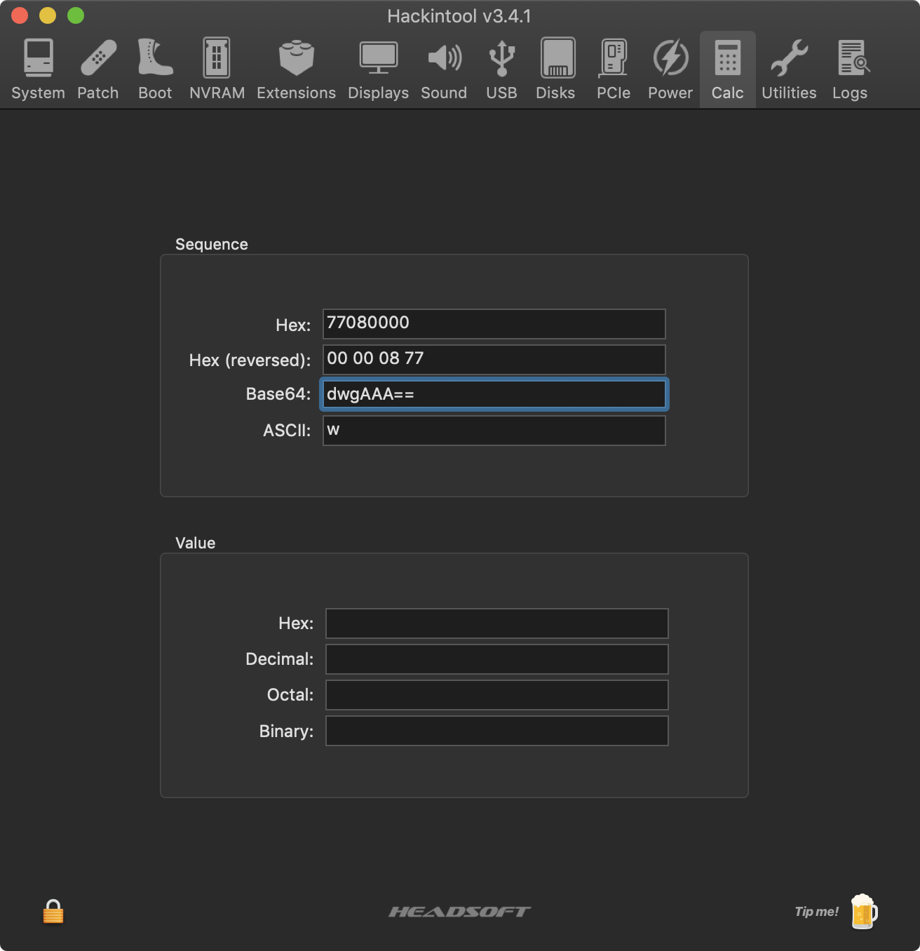

Understood, but for me (I am using OpenCore 0.59) disabling SSV (that already includes SIP disabled) from opencore csr-active-config dwgAAA== doesn't worked, I need to do it from a BigSur Recovery (or its USB Installer) .
Code:
<dict>
    <key>NVRAM</key>
    <dict>
        <key>Add</key>
        <dict>
            <key>7C436110-AB2A-4BBB-A880-FE41995C9F82</key>
            <dict>
                <key>csr-active-config</key>
                <data>dwgAAA==</data>

Thanks @startergo just adding <string>csr-active-config</string> to the <key>Delete</key> worked.

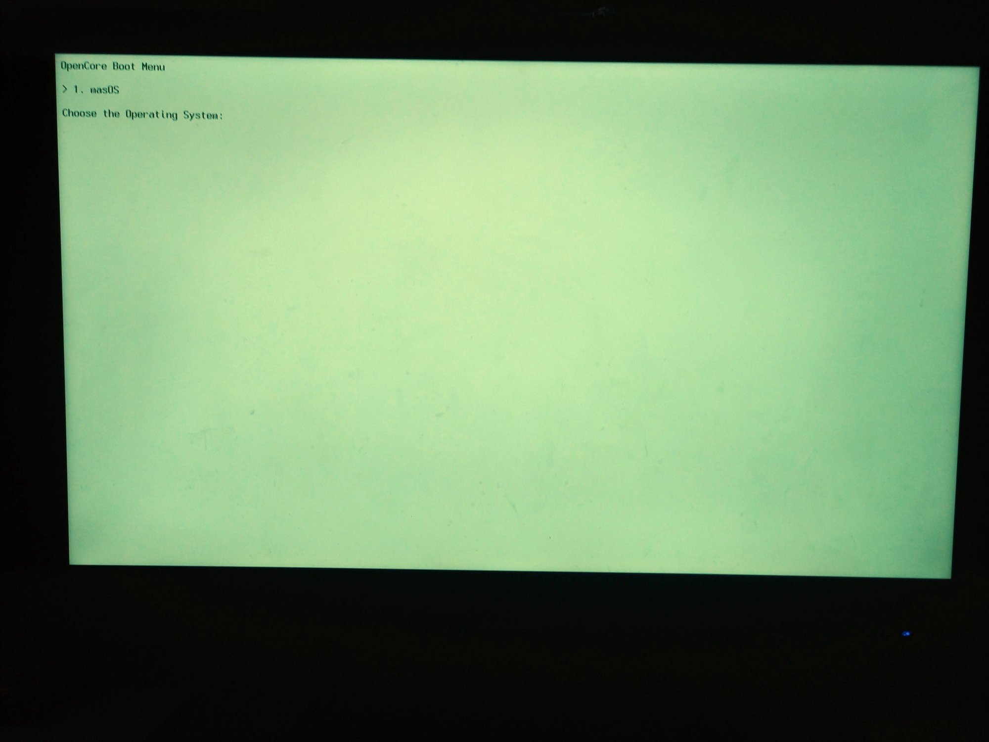

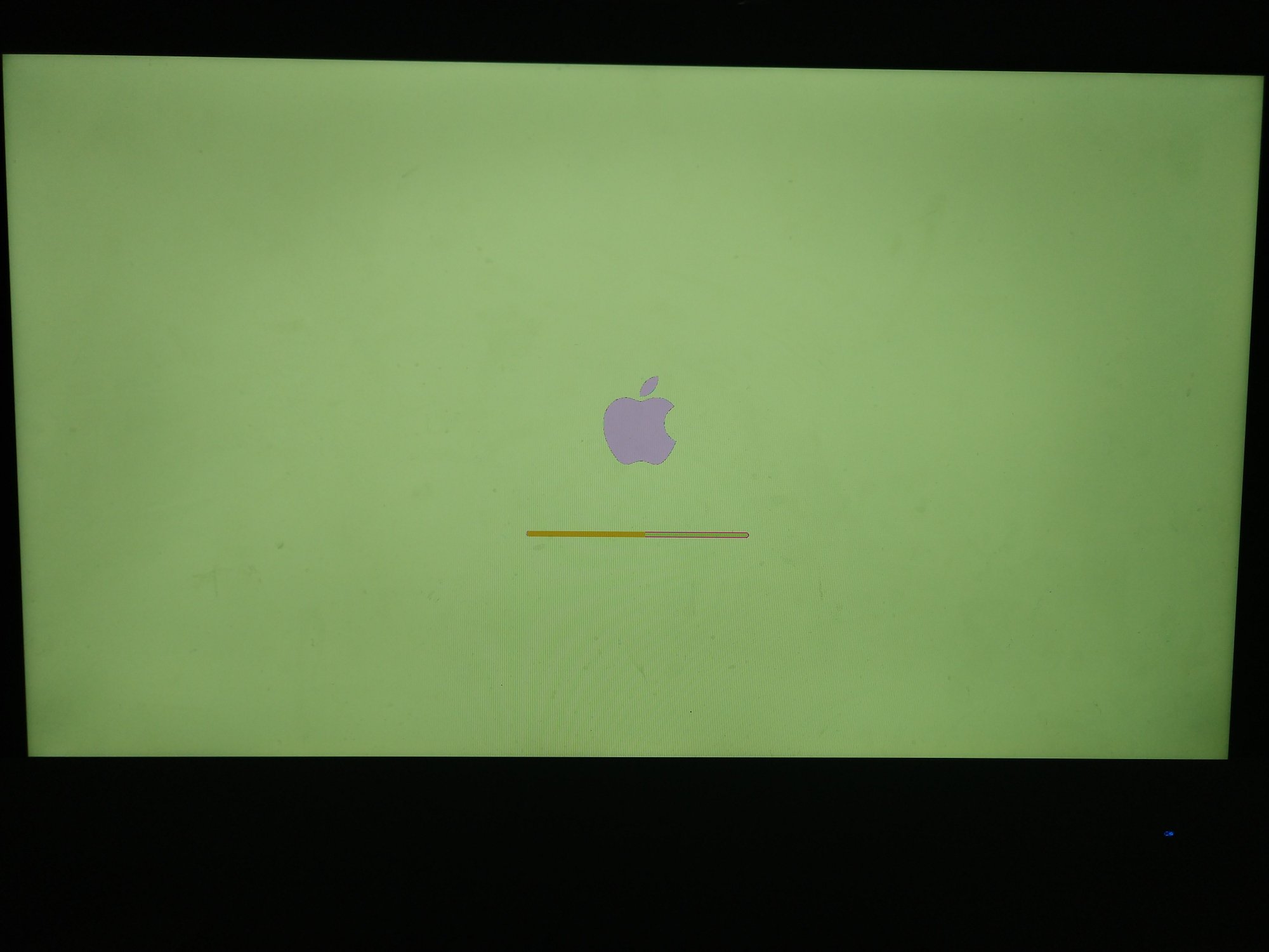

While talking about recovery/boot and extra Mojave... If I have Time Machine turned on.. can't I just boot from USB and do a recovery from time machine? I cloned my original Catalina to boot from it and re-install over my original then I erased the partition and turned on Time Machine (use a 2TB mechanical drive for this, my "Data" drive). Can I have OpenCore on a USB install drive? Like I used to do for Hackintosh when it wouldn't boot...
[automerge]1594397731[/automerge]
It's already like that. But just for fun I switched it towards the power connector and it had no effect. Any other clues?
Any ideas anybody?
Any ideas anybody?

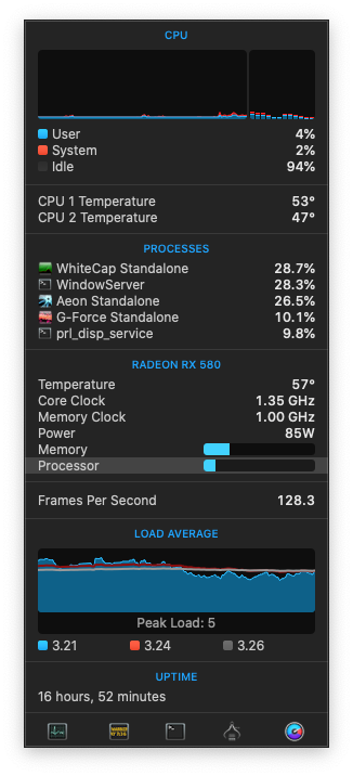

You don't say what monitor you have. Can you change settings on it? It may be a mismatch between the card and monitor. I didn't do anything special to the config.plist set up. Just followed the guide in the first post - including opencanopy, changing boot screen background color, disabling GOP, hardware acceleration, etc
