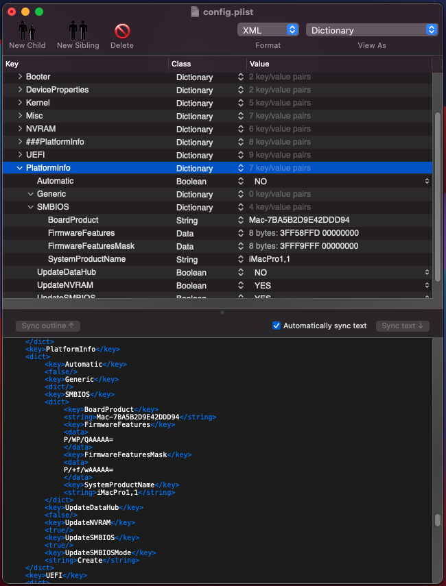

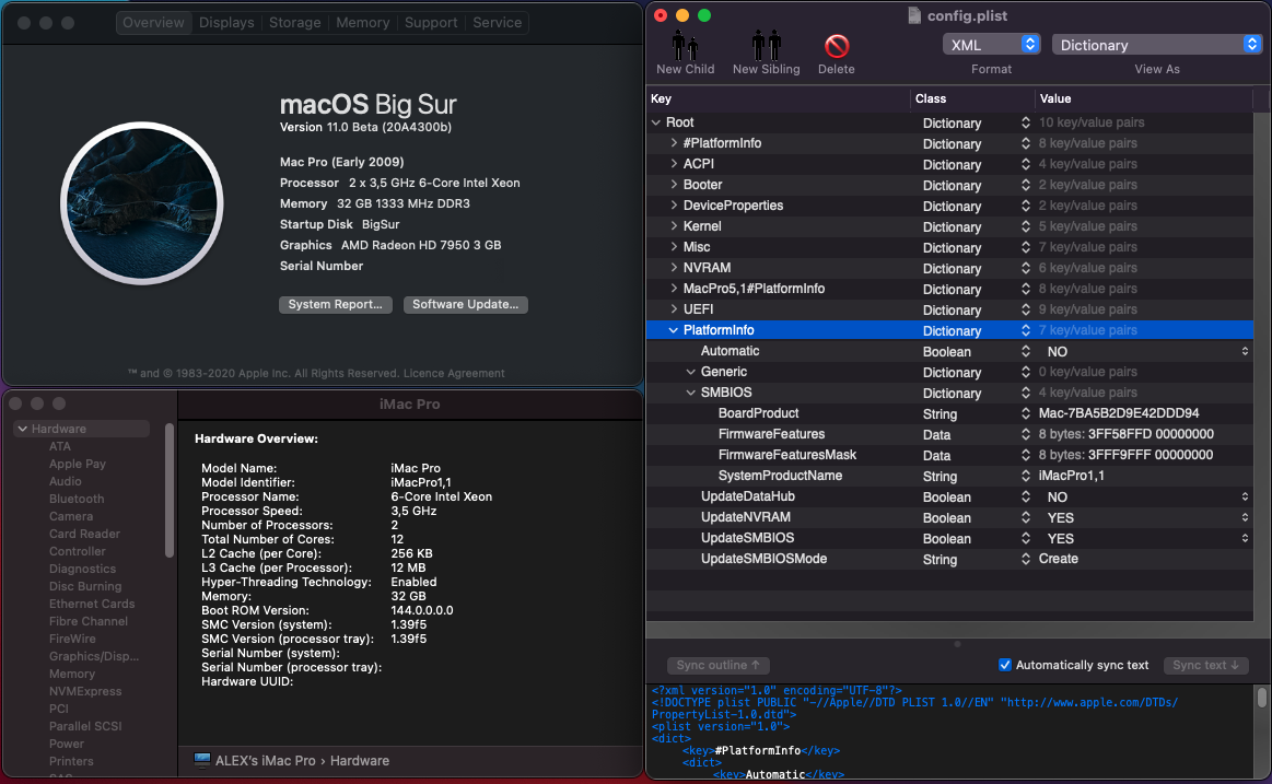

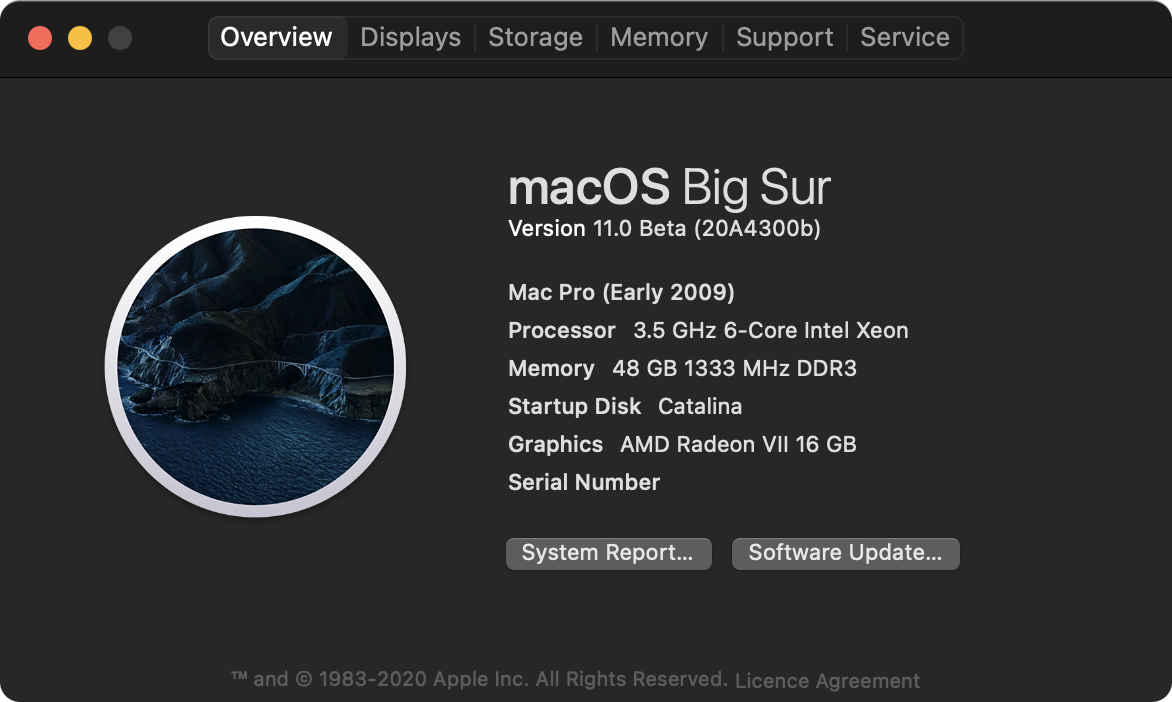

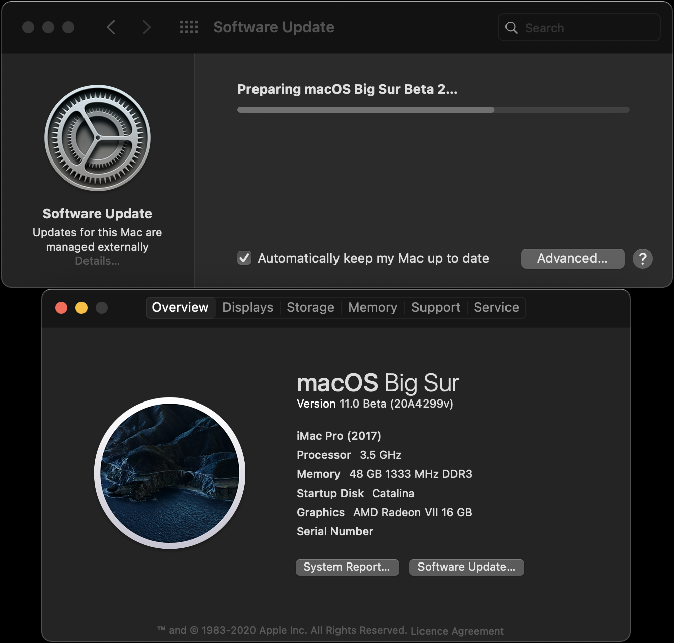

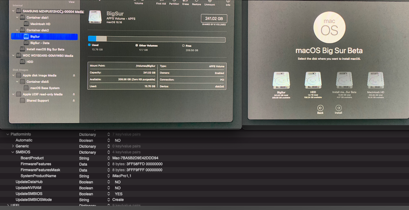

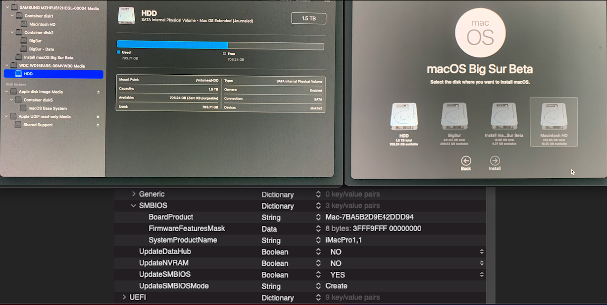

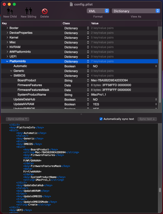

Same as before. Can perform update "natively" with complete iMac Pro SMBIOS spoofing.
Once finished, you can remove the SMBIOS spoofing.

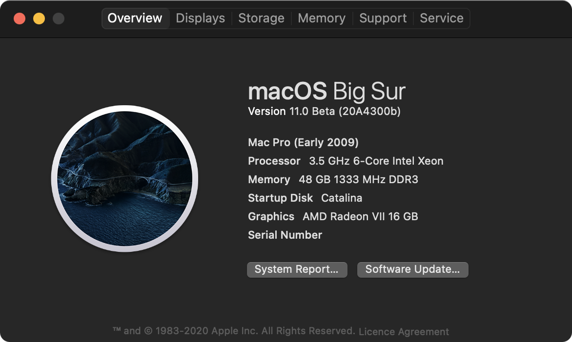

I installed 11.0 (20A4300b) iMacPro SMBIOS )) OpenCore-0.6.0-RELEASE

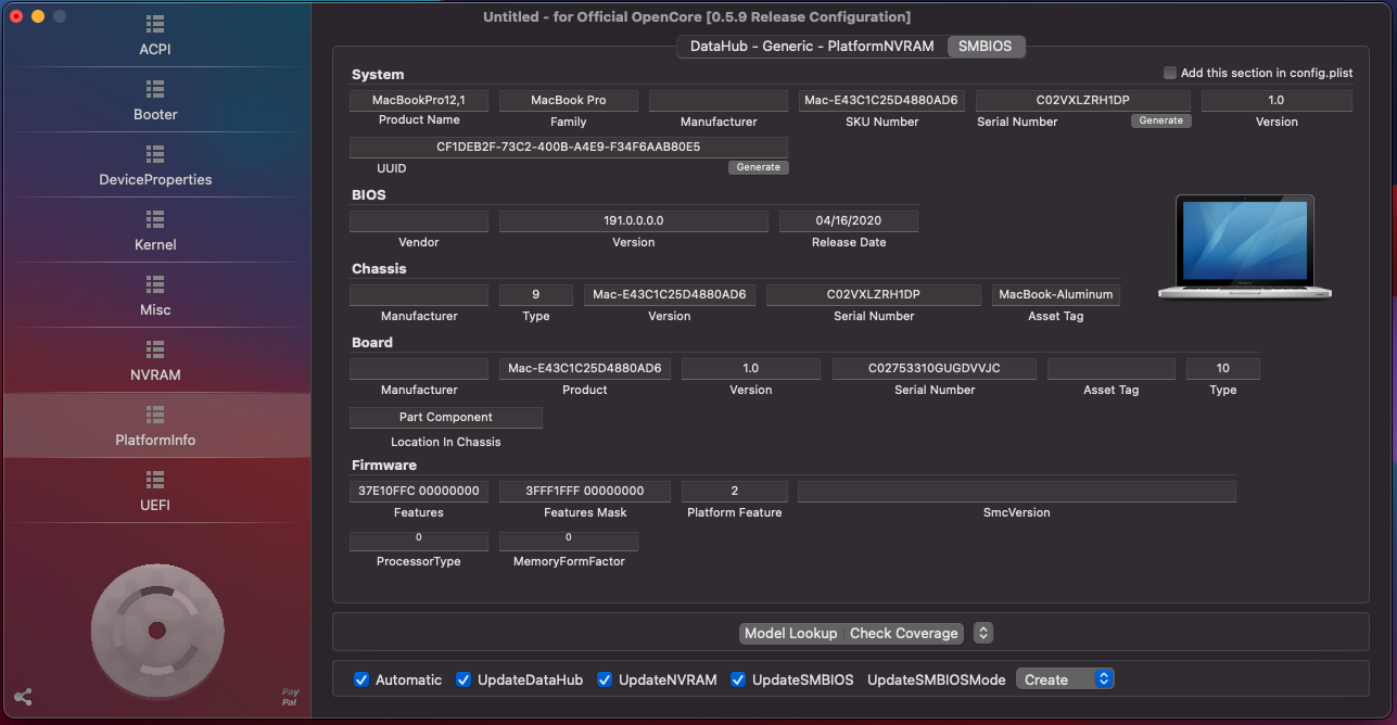

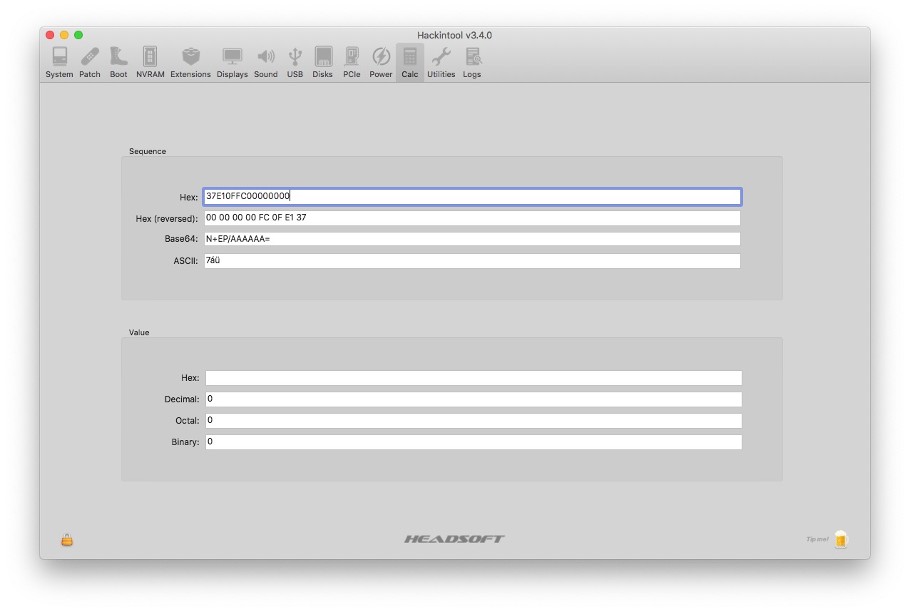

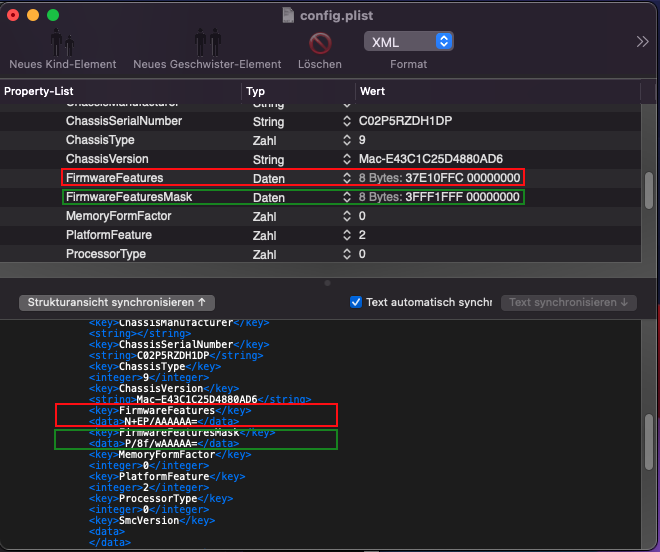

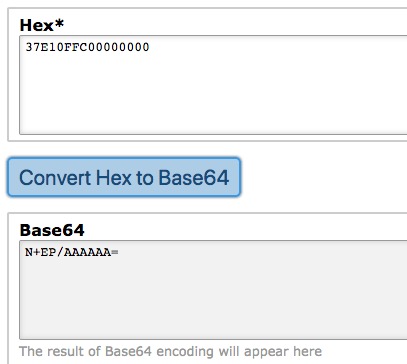

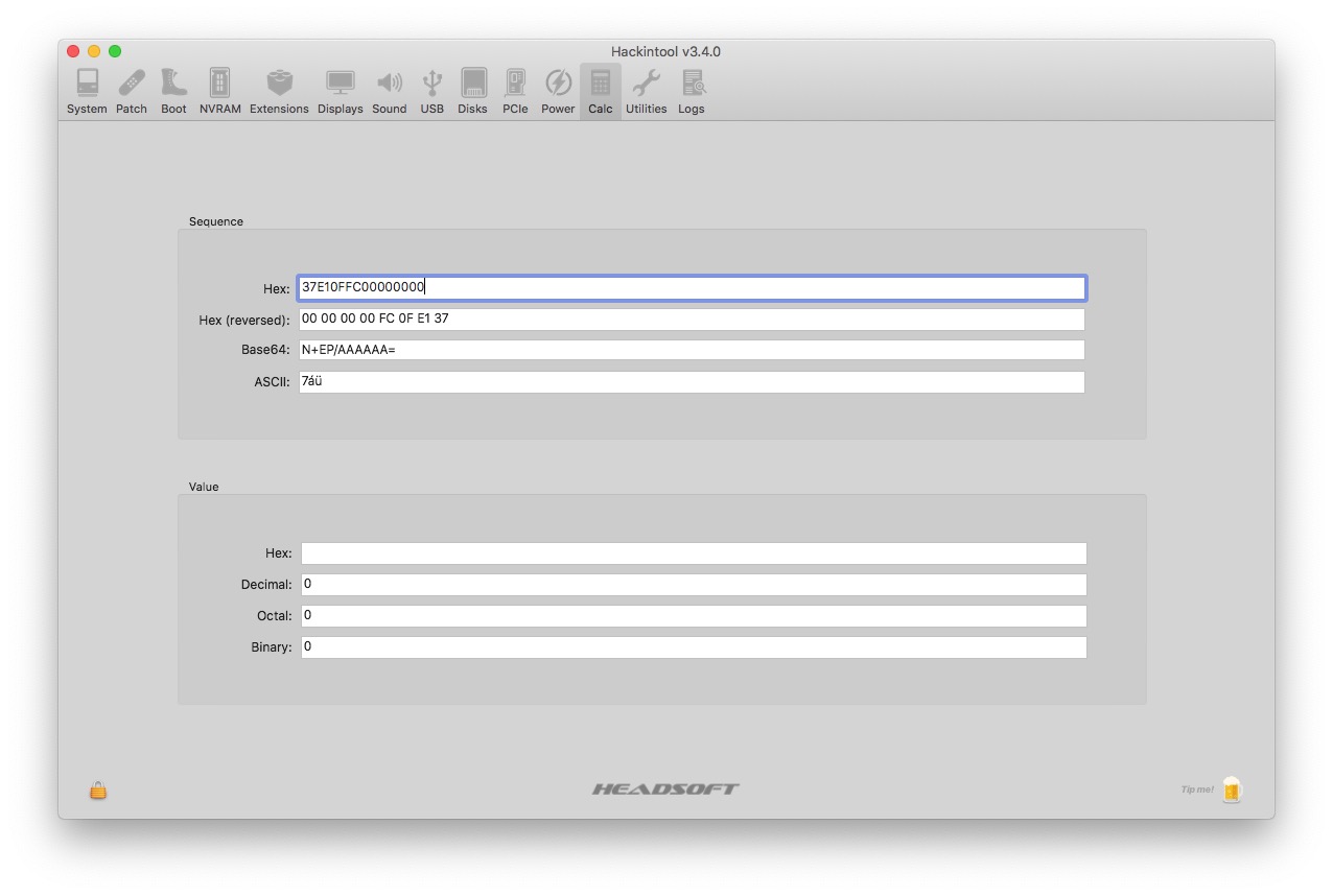

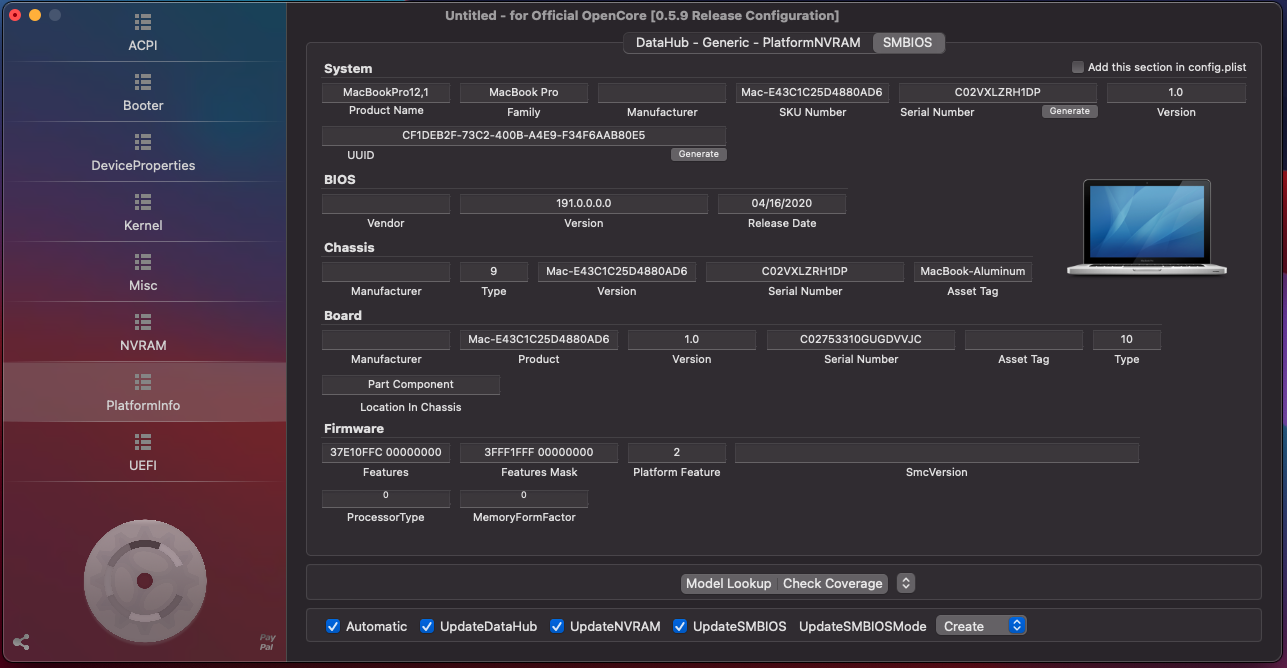

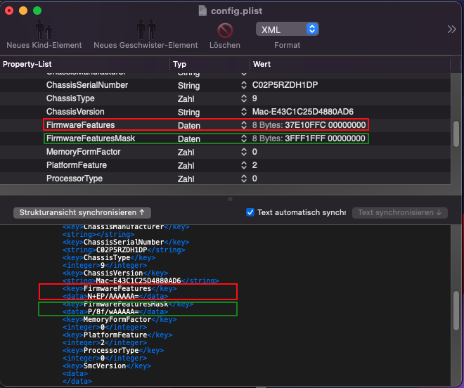

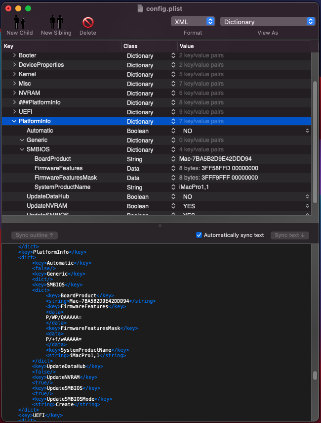

What is your problem here I don't understand? , also how do you calculate the firmwareFeatures and the FirwareMask let's say I have 0xFF9FFF3F how do you convert it? is there any software I need to use?
I run the latest 0.6 and spoofed MacPro7.1 and everything is working now like a charm... And I wanted to thank you as well.. for the precious advises... and others here.

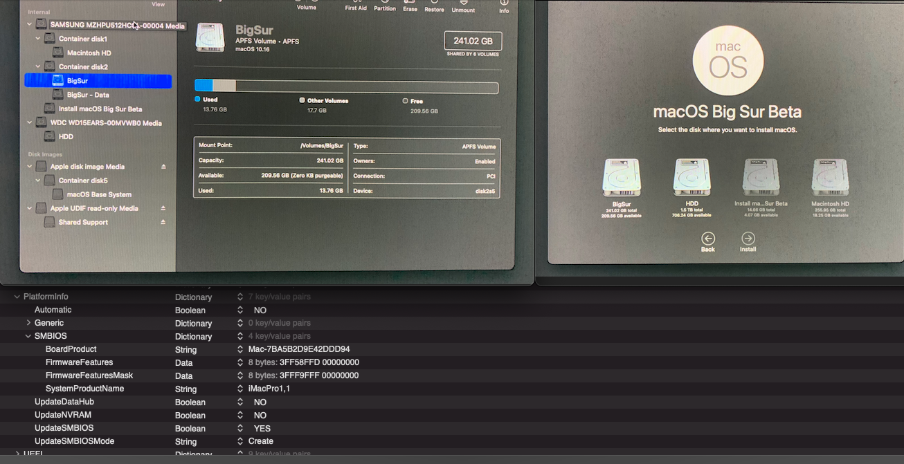

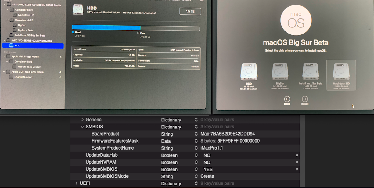

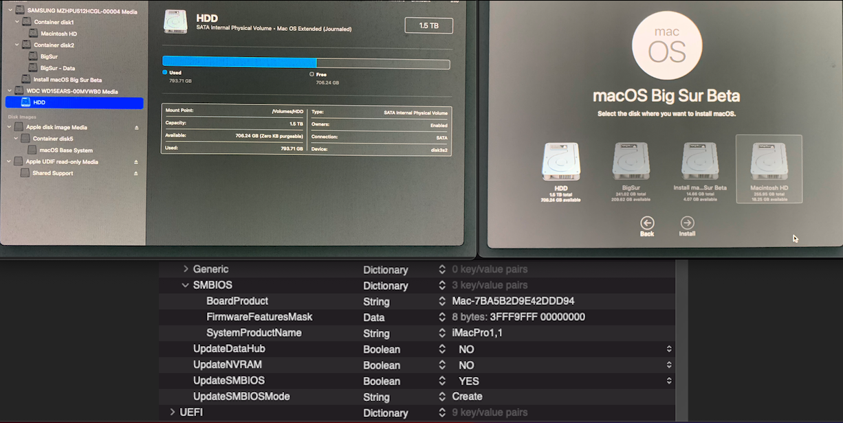

yes two gray disks are active HFS / APFS wash SMBIOS iMacPro
Take a look at your PM
[automerge]1594319512[/automerge]
I am pretty sure that if you replace by what I gave you they will all show up normally ...
How do you calculate the FiwmareFeatures and the FirmwareFeaturesMask? any particular software you are using?

Are the imessage keys the same as compared to motherboard spoofing only (first page of hackintool)?
Ohhh boy did I read the manual oh yesss yesss yess I have an awesome config and everything is perfectly working expect that I cannot get the mount -uw / working it returns the 66 error... Authenticated-root disabled from recovery...

I do not need MLB and ROM for imessage I have MacPro 5.1
What I meant is to check the imessage keys, as you manipulate values in the SMBIOS and the NVRAM and those keys, are used for identification purposes during the communication with the Apple servers. Anyway I will check them when I have time so there is no need to do anything.
How do you decode the ROM output --> 70cd609d9be6 to which rom the system really reads?
