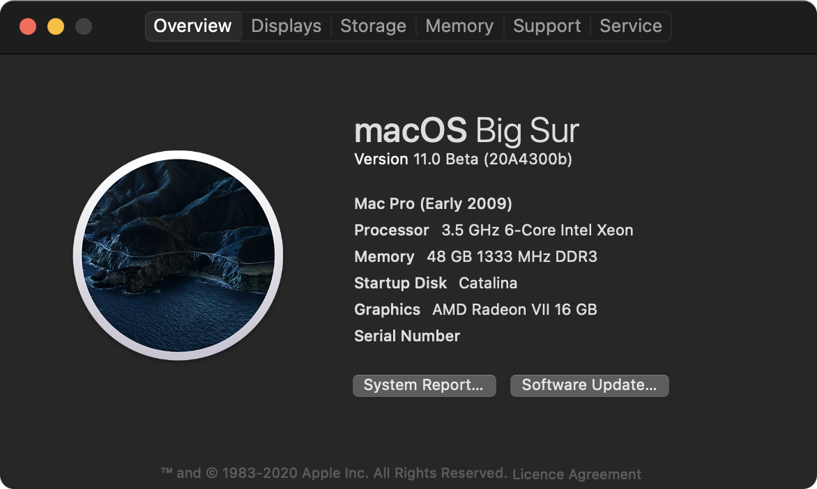

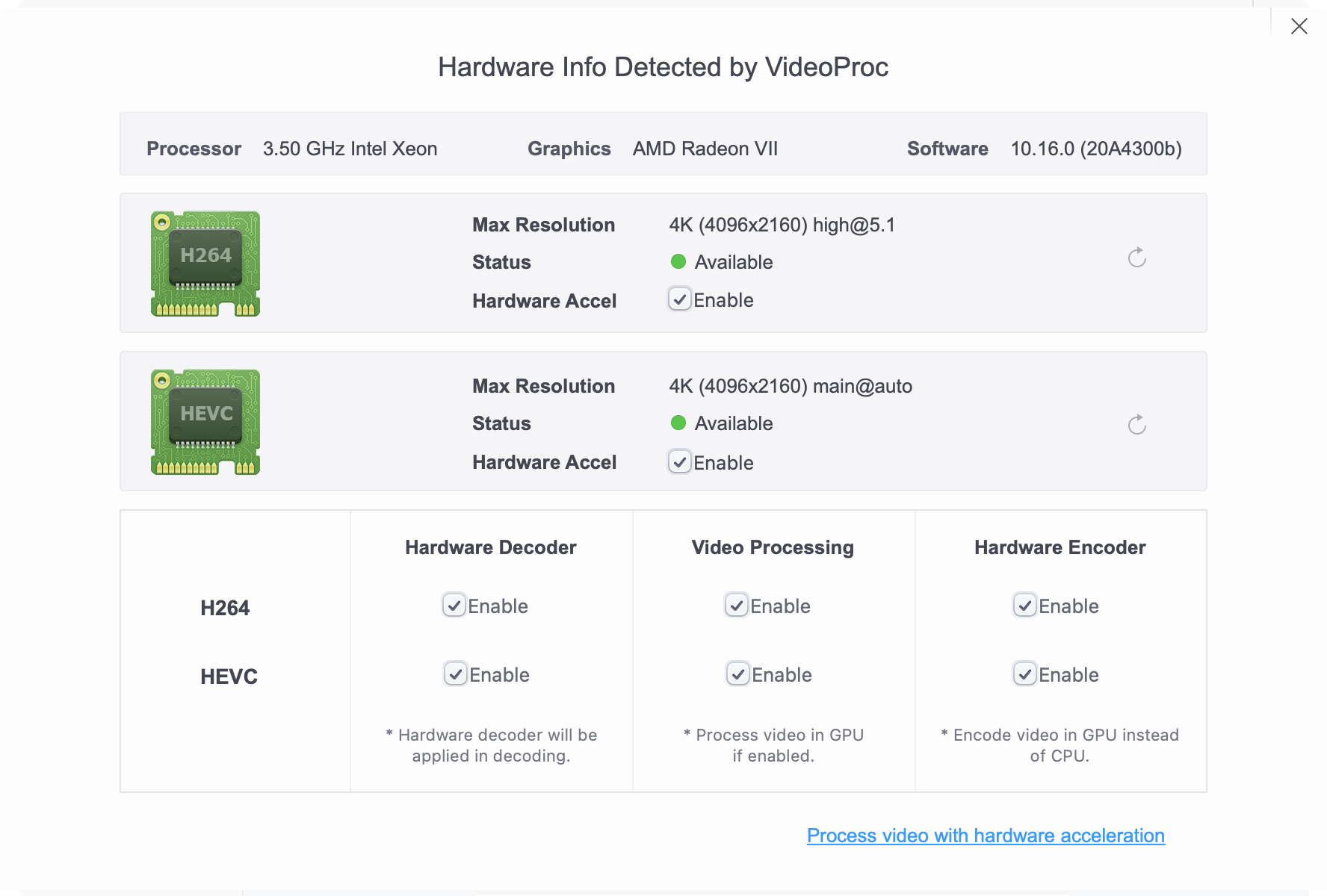

I have a quick question regarding this screenshot, you still got hardware acceleration while having the Mac Pro 5,1 ID? Thought you had to spoof always as an iMac to have a successfull HW accel like this guide says on OP
As the others said, HWAccel still works when boot with 5,1 ident. However, you still have to spoof the board ID.

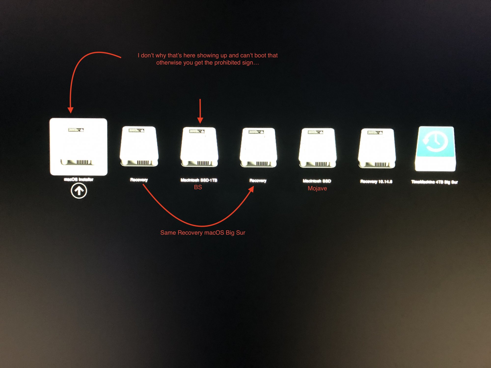

I got this weird 2 recovery show up in the boot screen picker. and it does only say recovery and that installer I do not know why.... It happened after the installation of the beta 2
running on opencore-version DBG-060-2020-07-07
Anyone knows how I can fix that? Thank you./
