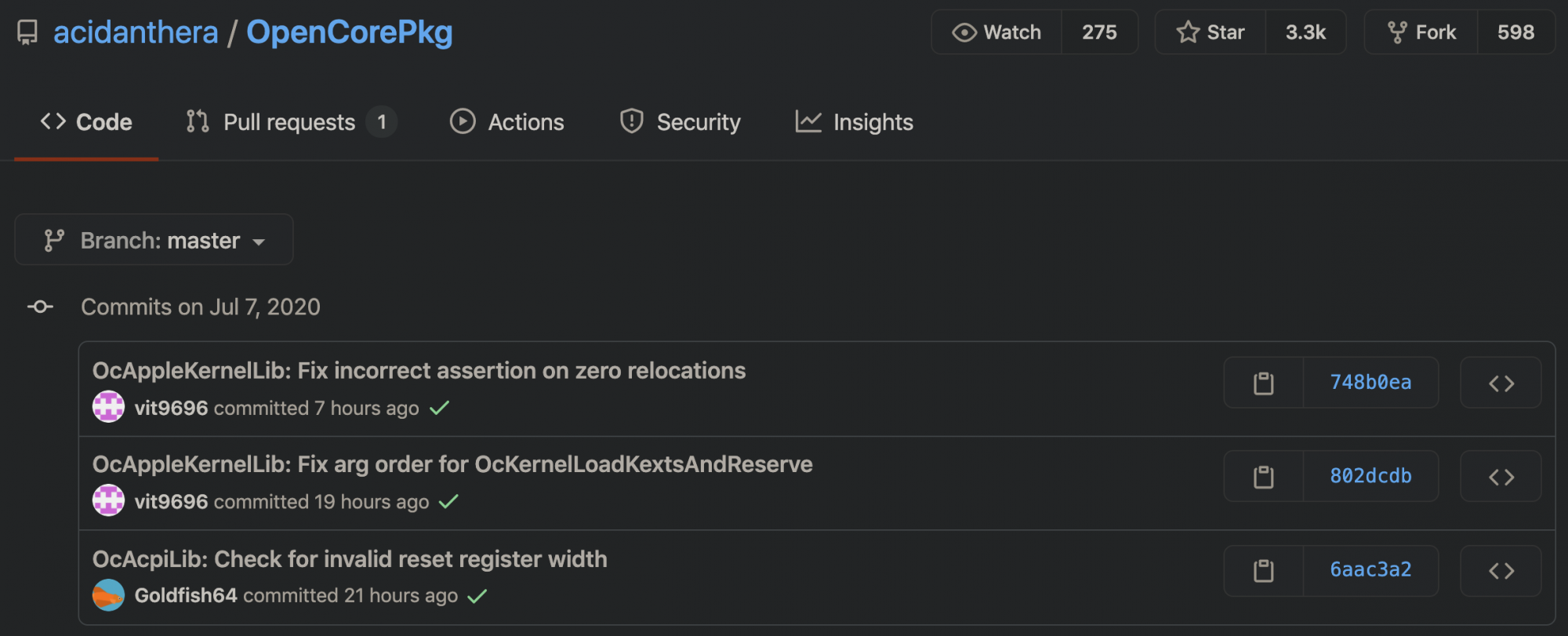

I thought updated versions of OpenCore were released on the first Monday of each month (which would have been yesterday). I also thought I read somewhere that the development team was "on vacation" and there wouldn't be an update until Sept. Anyone have any insight?
It seems that they are still working on it.

In order not to rush things because of Big Sur, the July release is skipped.
Been monitoring the chatter regarding BS super-SIP issues, SMBIOS spoofing, etc. A lot to work around. Understandable not doing a release until those can be understood and handled, particularly since 0.5.9 is rock solid stable with Mojave/Catalina & Win10 (at least it is for me). I've decided not not get caught up in trying to shoe horn BS into either of my cMPs while in either the private or public beta stages. I'm content to wait until release for both it and OC.

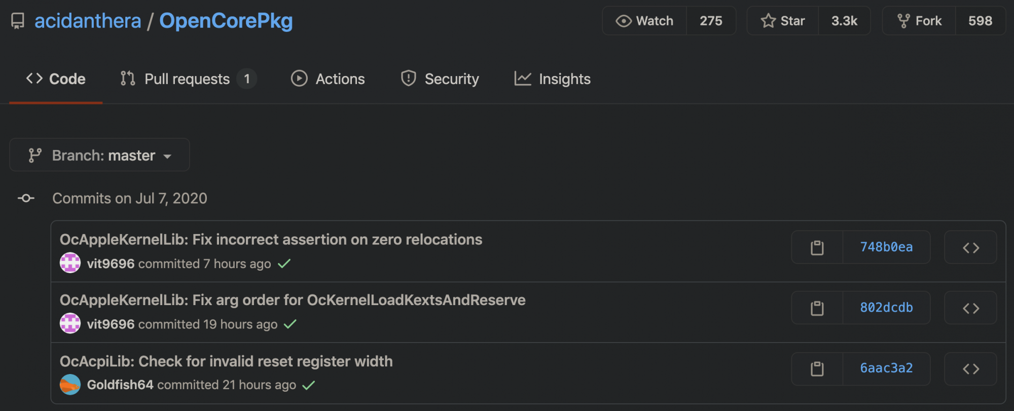

They mentioned they would skip July release here due to WWDC
Are you suffering from (OCMRDS) OpenCore Monthly Release Deprivation Syndrome?
ATTENTION! ATTENTION!
Through the Github project known as OpenCore-Factory you can get the latest, automatically built release of the current version of OpenCore under development. Currently pre-release builds of 0.6.0 incorporate the latest commits and are released automatically every 8 hours. You may never feel OpenCore deprived again!
However README.md file states:
THIS PROJECT IS NOT OFFICIALLY SUPPORTED BY ACIDANTHERA.
BUILD RESULTS IN THIS REPO ARE AUTO-GENERATED WITHOUT ANY TESTING.
I'M NOT RESPONSIBLE FOR ANY OF THOSE BUILD RESULTS.
TAKE YOUR OWN RISK WHEN USING THE BINARIES.
The Github project is known as OpenCore-Factory. It is the project of williambj1.
Here is the URL: OpenCore-Factory on Github

2020-07-07
Repository: williambj1/OpenCore-Factory · Tag: 2020-07-07 · Commit: 03100b8 · Released by: williambj1
Changes
OpenCorePkg
  • OcAppleKernelLib: Fix arg order for OcKernelLoadKextsAndReserve
  • OcAcpiLib: Check for invalid reset register width

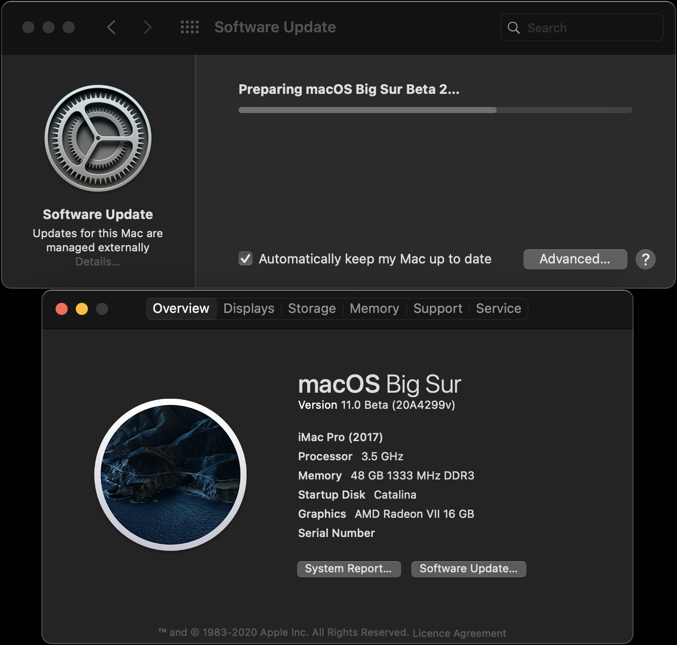

Same as before. Can perform update "natively" with complete iMac Pro SMBIOS spoofing.
Once finished, you can remove the SMBIOS spoofing.
Did you use 0.6? or 5.9?
I got in trouble you know that I have Dual Procs, it installed it and on the third reboot boom blackout no screen and impossible to boot back on the SSD nor the get open core loading.
Thank you nice pics.
You can check the first few pages of this thread. We posted about how to completely spoof the cMP as iMac Pro at there.

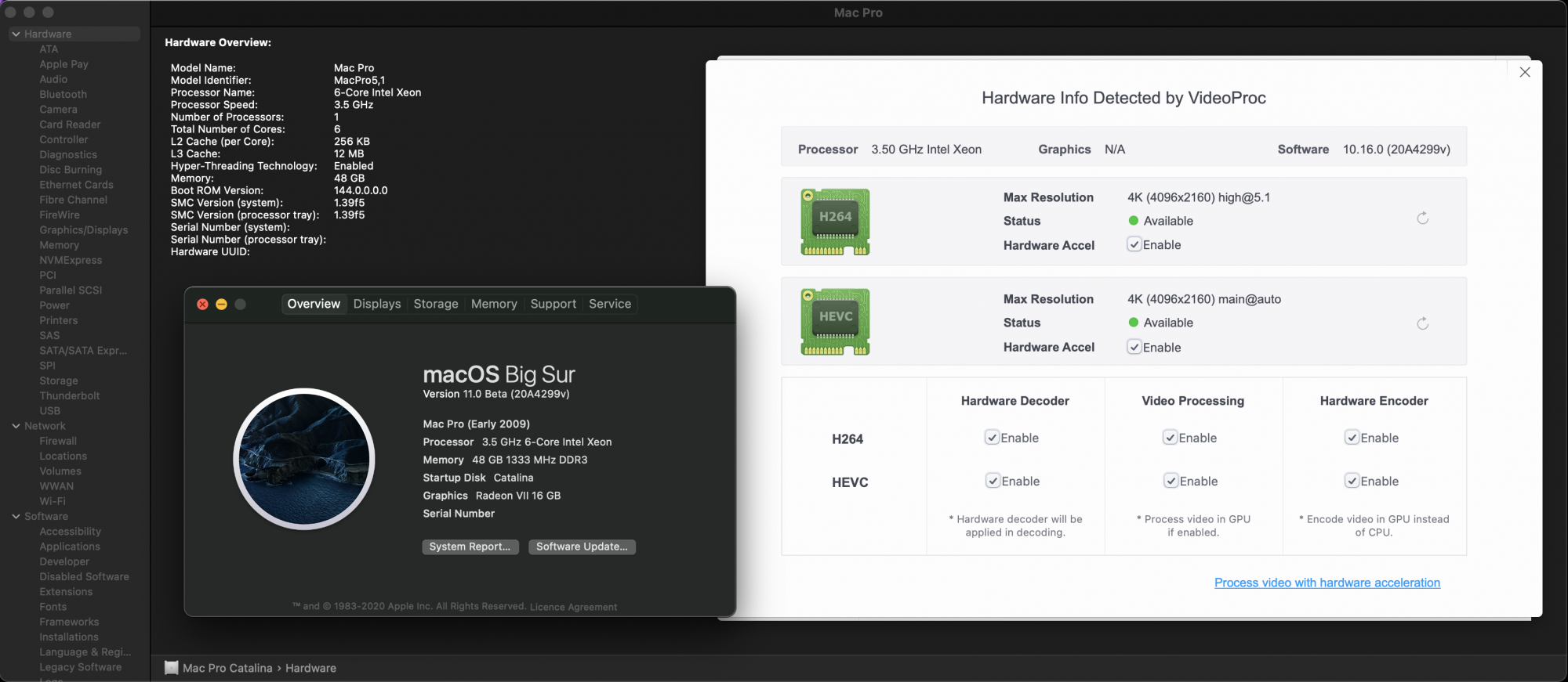

Anyway, we just need to spoof the cMP ident for installation. Once Big Sur is installed, we can boot Big Sur with the current OpenCore config and keep the 5,1 ident.
I have a quick question regarding this screenshot, you still got hardware acceleration while having the Mac Pro 5,1 ID? Thought you had to spoof always as an iMac to have a successfull HW accel like this guide says on OP

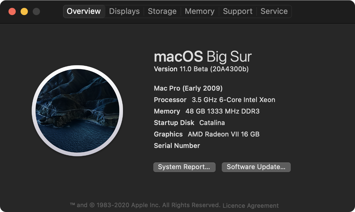

Works for me. The standard config.plist made everything all good. 5,1 success!
