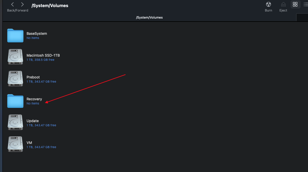

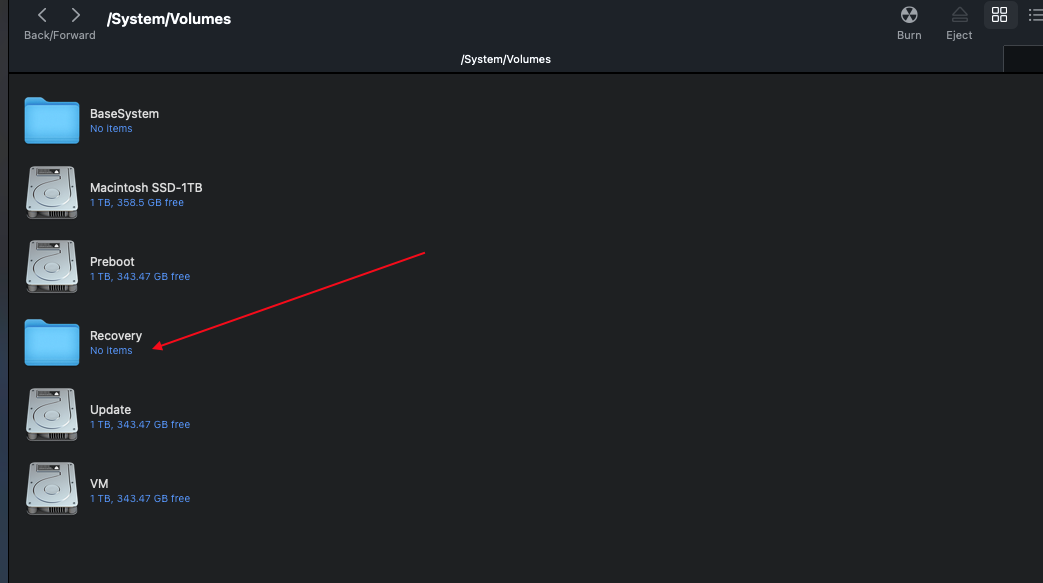

Well recovery folder Big Sur is empty so no wonder why I can't boot from it. But I do not understand why though :/
anybody knows besides reinstalling the whole system how can I recreate the recovery? Thank you./

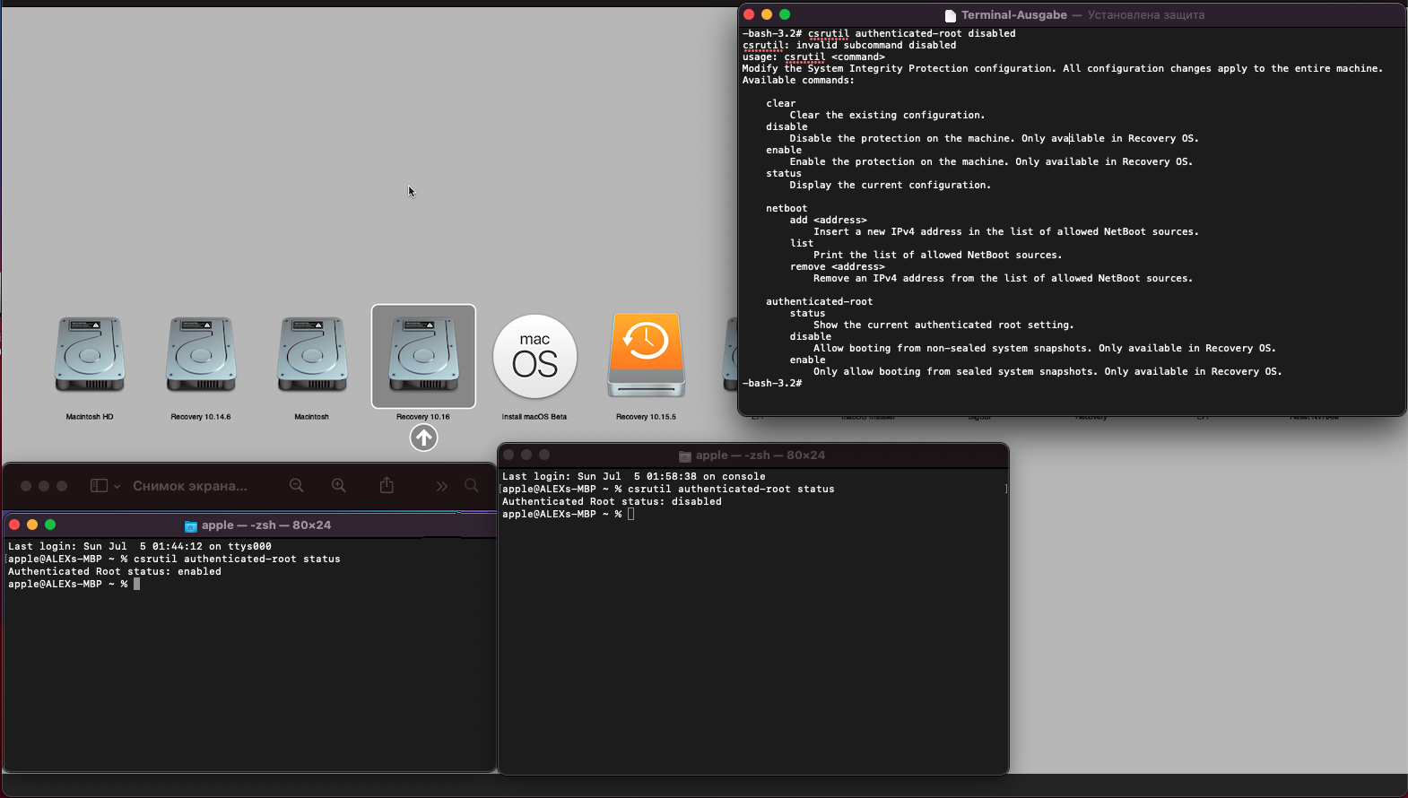

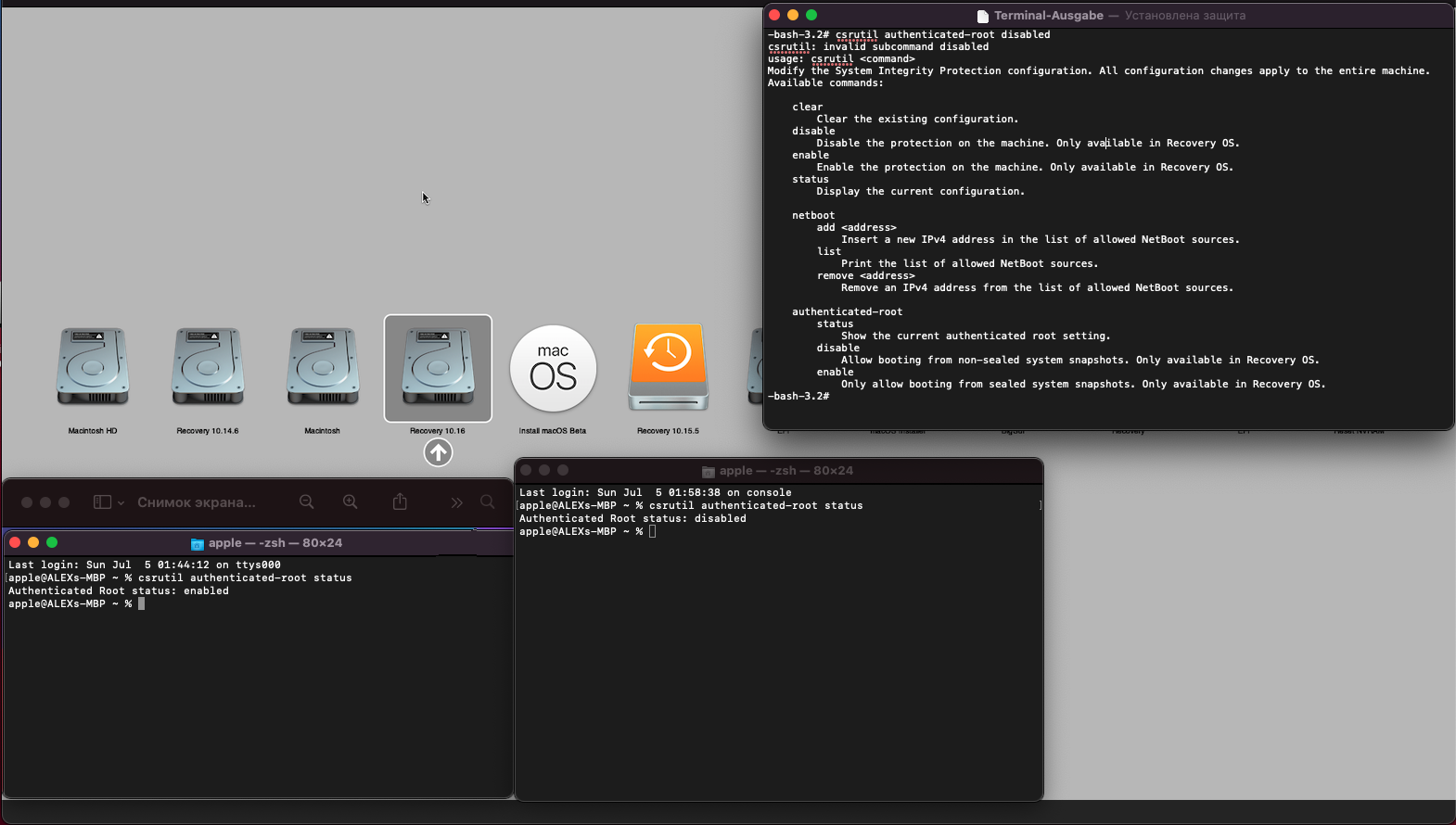

Nope actually we were referring from a USB Thunmbdrive to get authenticated disabled since I could not get into my BS recovery. From the USB then from the terminal:
cd /
./csrutil2 authenticated-root disable
You will see that even you can access BS recovery and there try to disable the new SIP you still have no access whatsoever to any permission.

@205Maxi to manual fix the BigSur Recovery, you should check this:
diskutil list | grep Preboot
mount the largest MB Preboot Volume (that is the BigSur one)
diskutil mount diskXsY
open /Volumes/Preboot/
(if you are in BigSur use instead open /System/Volumes/Preboot/ )
now copy only the folder name that is the BigSur UUID (random numbers and letters folder) that you will use for its Recovery
Now mount the BigSur Recovery:
diskutil mount Recovery
open /Volumes/Recovery/
in this path make a new folder with the previous copied folder name UUID
in this folder /Volumes/Recovery/UUID-numbers-letters/
you should copy the BigSur BaseSystem.dmg (740 MB) and its BaseSystem.chunklist
you can retrieve them from an USB BigSur Installer in this path:
/Volumes/USBInstallerBigSur/BaseSystem/
if you don't have a BigSur USB Installer, then make one from the "Install macOS Beta.app" (9,58 gb) with the apple createinstallmedia method:
sudo /Applications/Install\ macOS\ Beta.app/Contents/Resources/createinstallmedia --volume /Volumes/YourUSBLabel/
BigSur Installer requires at least a 16 gb flash drive .

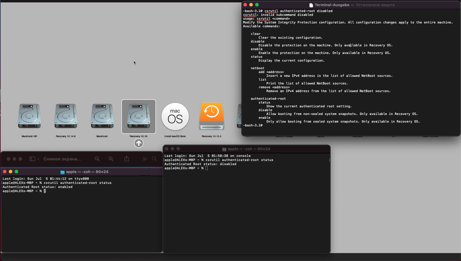

cd /
