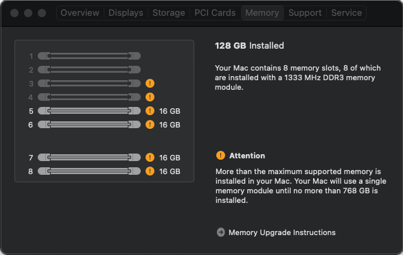

Here is a pic that I have taken yesterday or so with the Memory Tab half way functioning under Catalina 10.15.5 (101)
With the MemoryFix.kext the notification is gone and ram show green and orange ( I do not know how to get green on the top 4 ) opencore-version DBG-060-2020-06-29 I do not think I am getting the green ones with 0.5.9 though.
Could it be possible you think to duplicate somehow the 4 ( green marks ) to get the top 4 showing the same? I mean if the system sees it that way maybe we can get the top showing green as well...
It would be so nice to see green everywhere... I do not know how the system calculate how the ram displays but when I run the terminal cmd I get all the memory seen by the system.

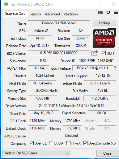

Thanks for the tip on this after some searching of this thread I found this about the ebay bought or 3rd party bought used cards mining versus GOP rom. I just found it hard to believe that all the GPU cards I tried would not get me to the OC GUI Picker screen until I grabbed my Sapphire RX580 (bought new) from my Z380 MacOS clone installed into the MacPro5,1 and it immediately went to the GUI picker.
Cards I tried none would work EVGA GT 640, 710, 740, AMD Aero RX 560 both 4GB and one 2GB. I have not tried any of my EVGA GTX 770's (most used) which all work natively in MacOS.
I have to install windows on my Asus Z380 and go to Techpowerup and find factory ROMs. Does Techpowerup offer Nvidia factory ROMS and a tool to flash the Nvidia cards I listed?
Also thanks for attaching your OC a ways back this is the one I am using now with these boot-args listed below but should it be the same for the RX 560 and Nvidia cards I listed above?
agdpmod=pikera shikigva=80 mbasd=1 -wegtree -no_compat_check no32exec=0
Most older cards doesn't shipped with UEFI GOP ROM. You may contact the manufacture to ask for a GOP ROM. Or you may google how to make a GOP ROM for your own cards.
For OpenCore with Nvidia cards, you don't need board ID spoofing, also don't need agdpmod=pikera shikigva=80 -wegtree. All these are for HWAccel, which not avail for Nvidia GPU in macOS.
mbasd=1 is to make Apple USB SuperDrive to work on cMP. You can remove that if you don't need it (this boot argument has no adverse effect anyway)

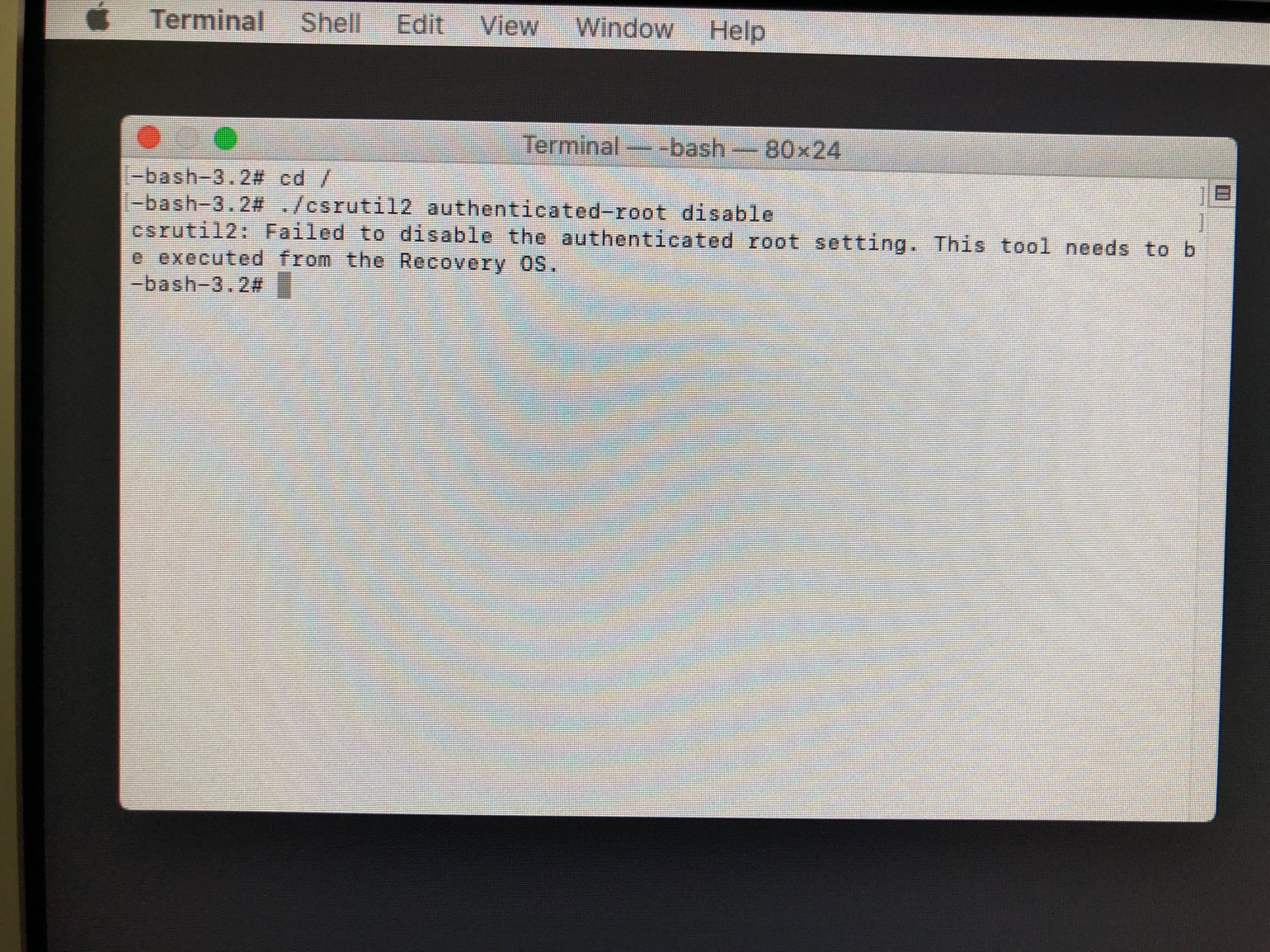

Speaking of it, I guess for me it does not work I do not know but see the attached; Booted from Mojave USB installer
Never mind I did not read correctly but it has to be renamed Ohhh gosh ...! Even renaming it will not work....

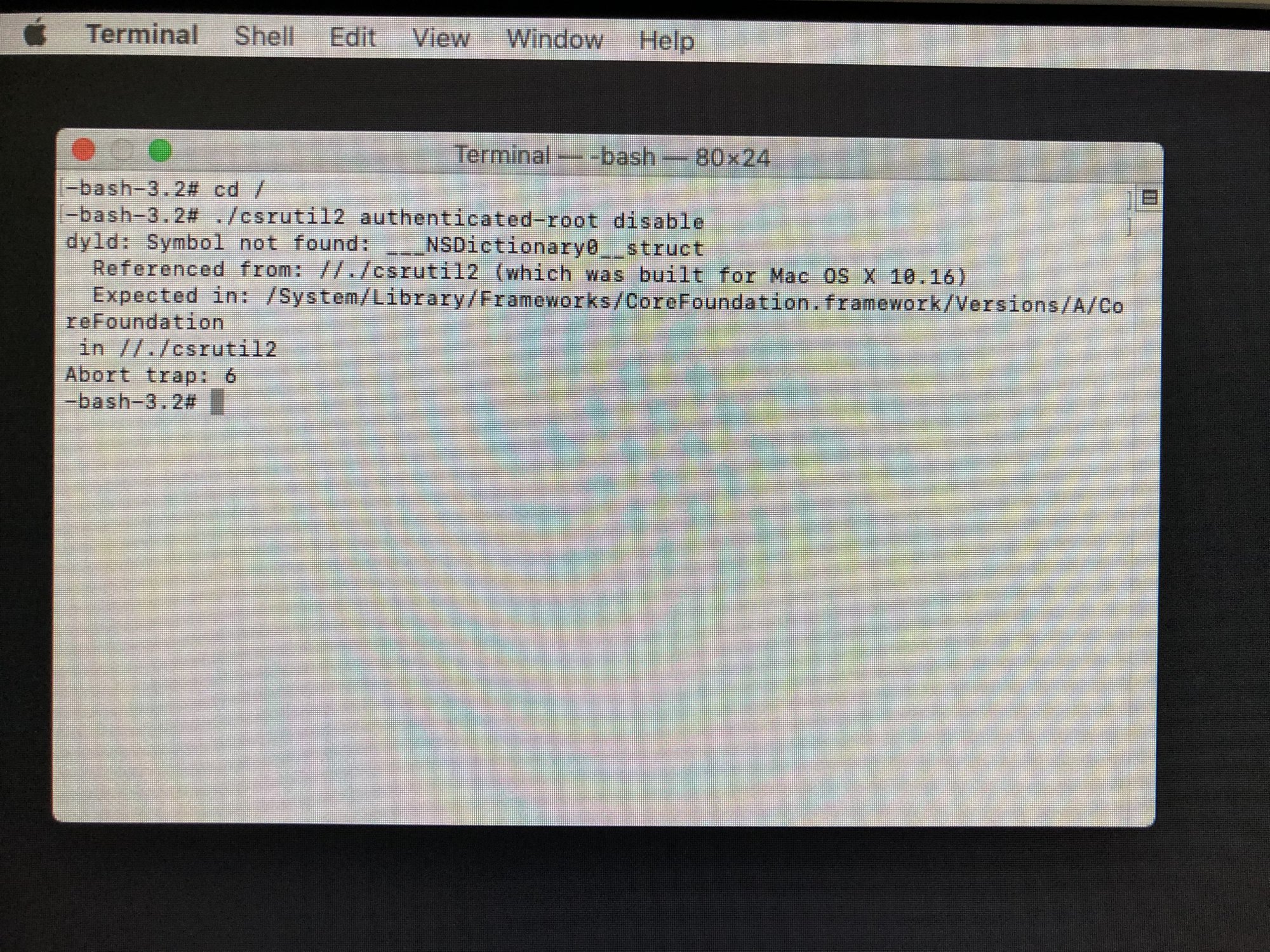

I guess then you should use an USB Catalina Installer, because csrutil2 requires more recent SDK .
Thanks, this looks way beyond my abilities but I'll give it a shot.
Actually quite straight forward. Type a command into terminal, press enter, go to make a cup of tea and by the time you get back, you have OpenCore built.
Only catch is that you need to have Apple's Development Tools installed which I can appreciate that some might find daunting.

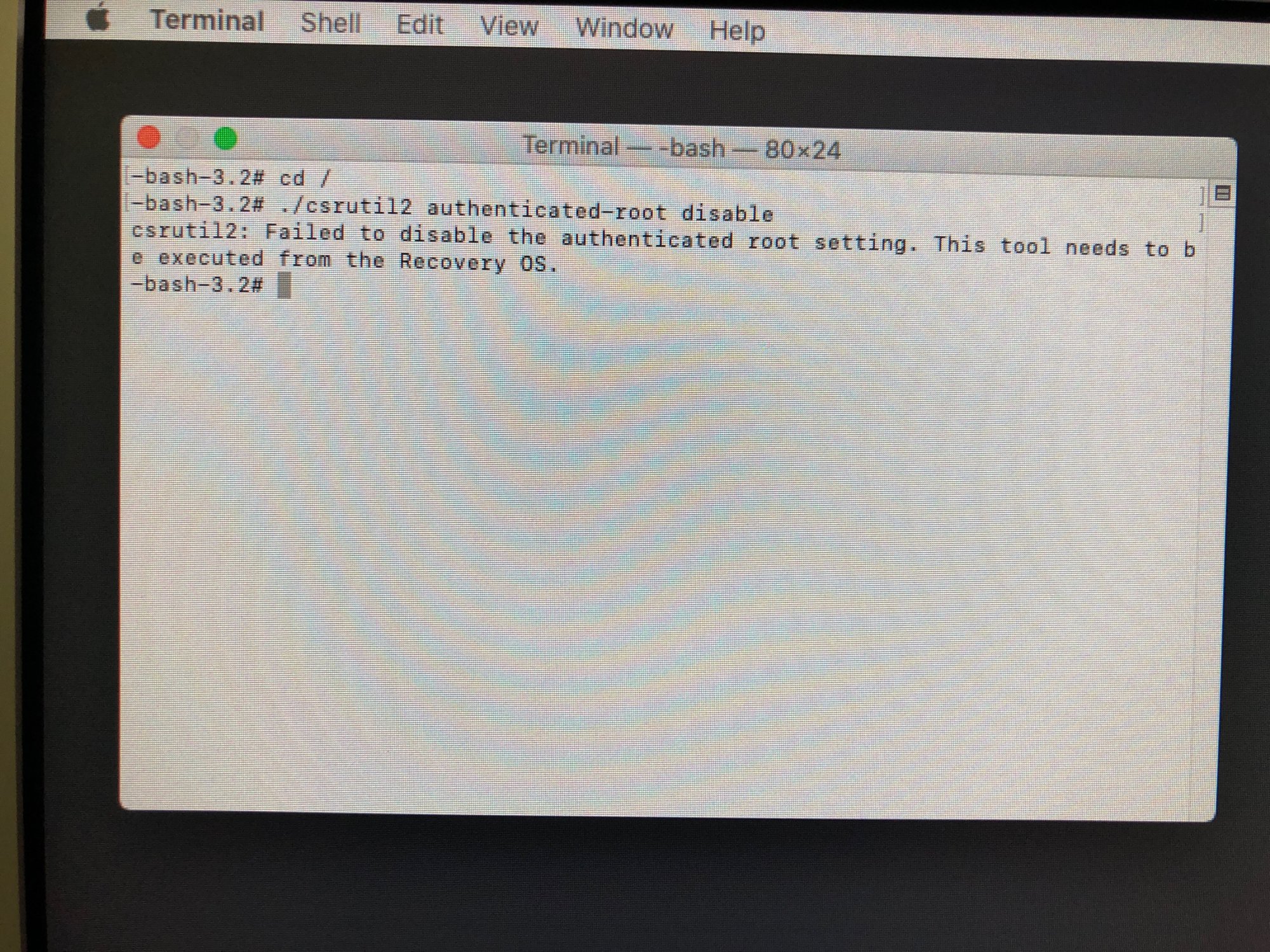

Booted from USB Catalina installer as you can see in the pic it did not work either.
The installer is made with apple "createinstallmedia" method ? Because this method requires a booting with BaseSystem.dmg Ramdisk.
Anyway you could copy the file on any USB device, then boot from a Catalina Recovery, maybe make an external Recovery with this: https://github.com/chris1111/Catalina-Recovery-HD-Partition
and from there open terminal:
Code:
cd /Volumes/ ; ls
cd YourUSBLabel
./csrutil2 authenticated-root disable

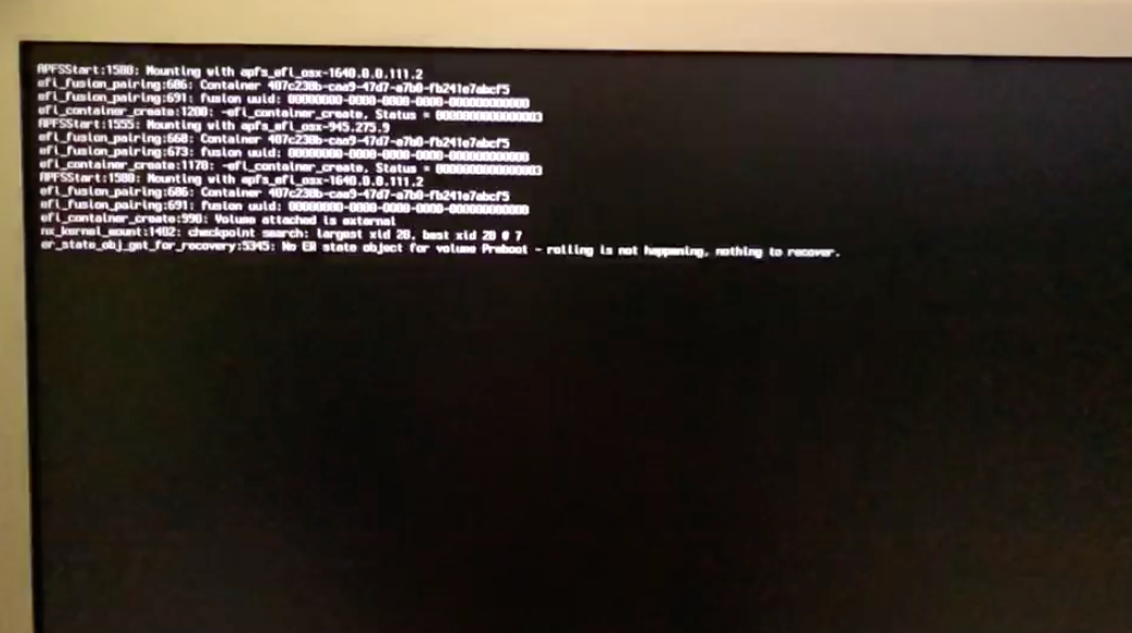

Also here is what I obtain when I try to boot from Big Sur Recovery under 0.6. The attached pic is not clear and so sorry about that that thing appears in a blink of an eye very hard to capture even with slow mo so imagine how fast that goes... Anyways.
Hope that can help to determine why we are not able to boot from the recovery Big Sur.

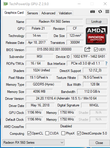

Thanks for the reply. I checked both ITX Aero RX560's 4GB and they are stock rom UEFI yet I can't get to the OC Canopy GUI Picker just a black screen then boots to desktop.
