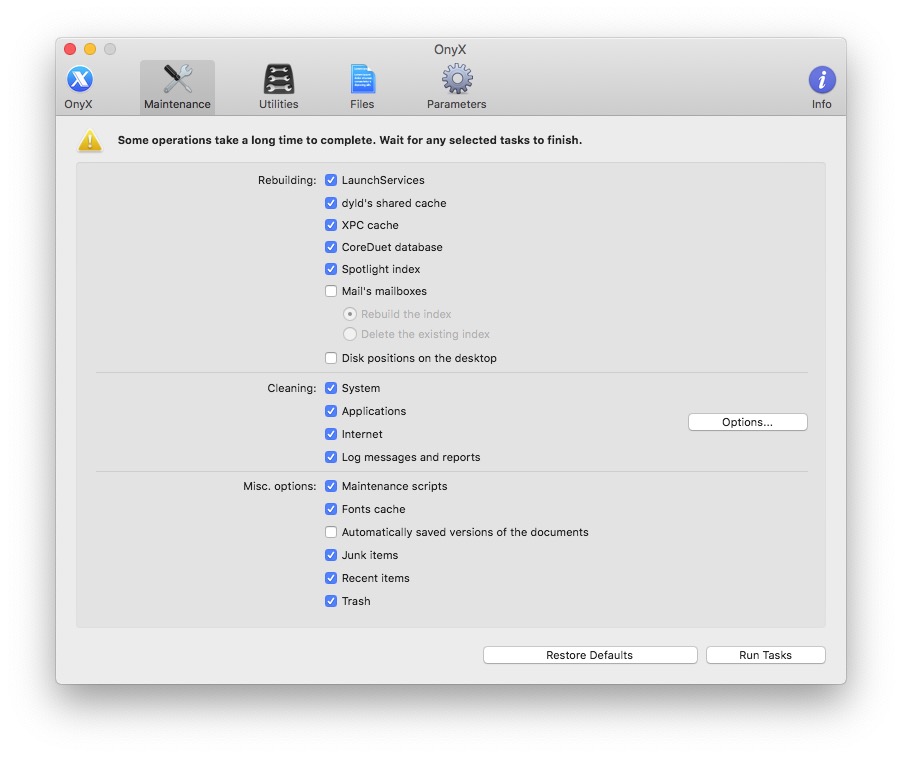

FWIW, I seem to have stopped having the issue after running the maintenance tasks in Onyx:

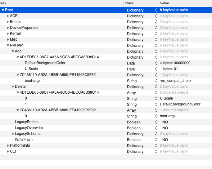

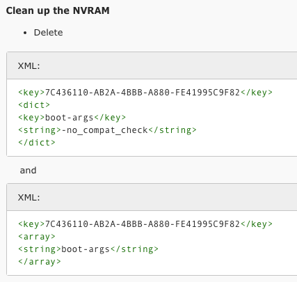

From the OP procedure I am not clear on what this is trying to explain what to do?
NVRAM in OC has two sections an Add and Delete. Leave the delete section alone and literally delete the NVRAM entries under Add both Child and Sibling if using a plist editor?

So are we suppose to delete Add Nvram entries?

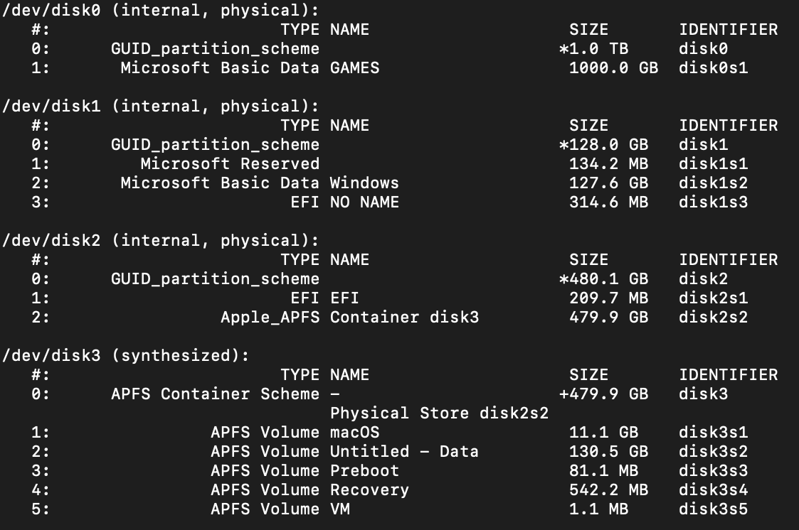

Also, regarding the second issue of a 'stray' additional Windows icon on the bootpicker screen, could you or someone please take a look at my diskutil list output and see if you could identify the culprit leftover partition so that I could delete it? VM is virtual memory and is not it, right?
Three physical drives - disk0 is the 1TB no-os data-only PCIe, disk1 is the 128GB Windows drive, and disk2 is the macOS one with Open Core.

Ok thanks so the OP instructions say to delete the nvram not sure what that is all about?
Means put in "Delete" section
There is no leftover partition there and what you are getting appears related to the first issue which OC has decided not to fix for various reasons.
I have found that running the maintenance tasks in Onyx cures a lot of issues. Perhaps install and give this a try.
Reactions: osxfr33k

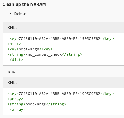

That step is part of the hybridization procedure, which makes -no_compat_check redundant.
I understand now, but if I still want to use the boot-arg lets say verbose boot just for a while then can I just have delete section only -no_compat_check and delete boot-arg? I want to preserve boot-arg in Add section in case I want to place a -v in boot-arg for verbose boot or any boot argument I may need later.
