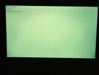

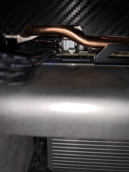

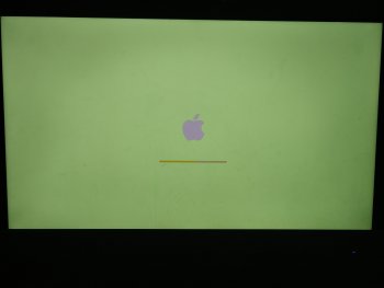

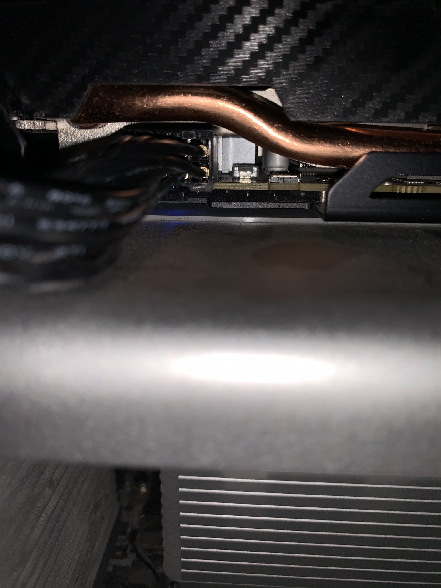

Got a question... I'm using OpenCore on a Mac Pro 5,1 with an XFX RX580 4GB and my boot screen is a greenish color until it reaches the OS. Is there a way to fix this?
Try setting the switch on the RX580 to the non-gaming mode. It is on the top side of the card. Really tiny. Slide it away from connector end.
Power down first of course.
It's already like that. But just for fun I switched it towards the power connector and it had no effect. Any other clues?
Setting the switch cleared it up for me. What kind of monitor do you have and how are you connecting the RX580?
