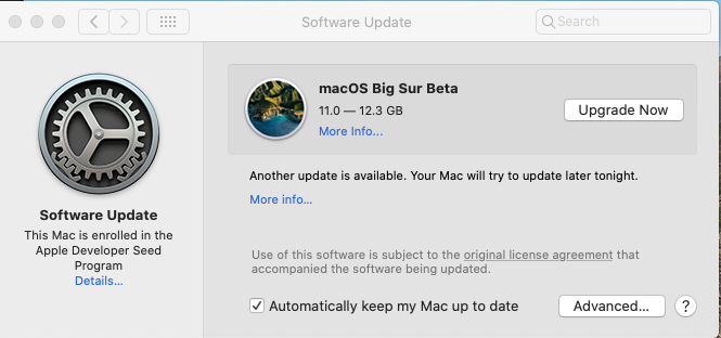

@h9826790 beta 4 is released, for incremental update (or full install) I guess VMM flag is not suffice, do you confirm is required SMBIOS spoofing ?
This must be the beta 4... with VMM flag (and beta profile)
Also with sudo ./installinstallmacos.py --seedprogram DeveloperSeed --build 20A5343i

yes only board-id. I only change the VMM flag for updates.
If you used a board-id spoofing (I guess the iMacPro1,1 board id) , this is almost equivalent to the SystemProductName spoofing, perhaps with board-id spoofing you don't need VMM flag for detecting incremental updates in Big Sur .
That's it, I only turned on the VMM, and disabled all spoofing.
I guess for detecting BigSur OTA updates (or from createinstallmedia USB Big Sur Installer) is sufficient a board-id spoofing on config.plist without VMM flag :

From my earlier test BigSur software update distribution file checks only for the supported board-id , while Catalina distribution file allowed also VMM "as board-id".
