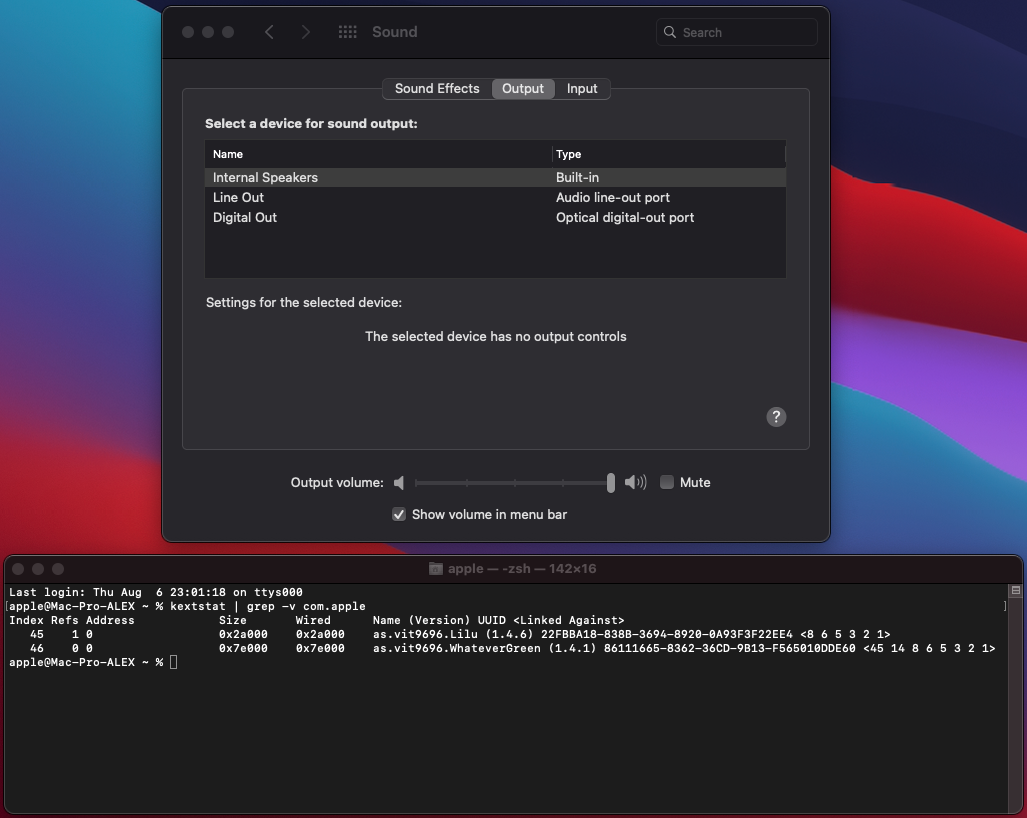

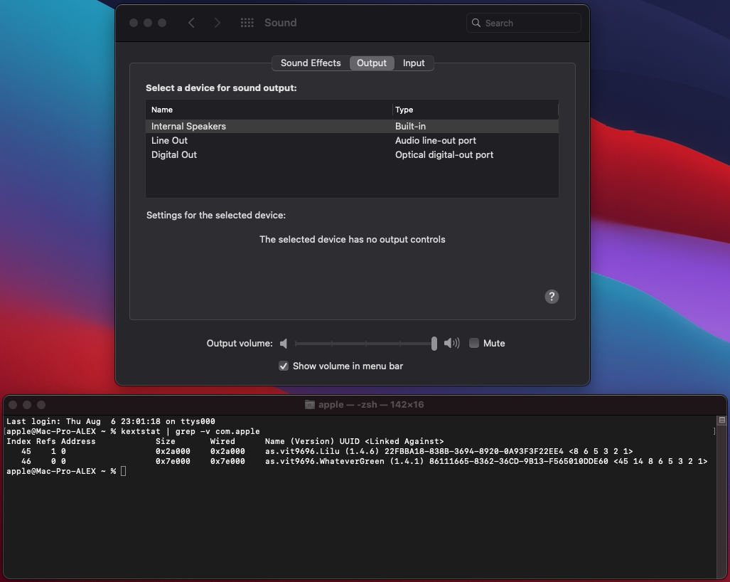

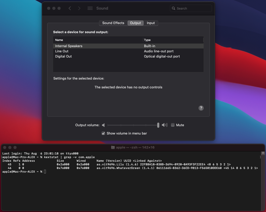

Did you check the sound preference to make sure HDMI is selected?
Here without AppleALC

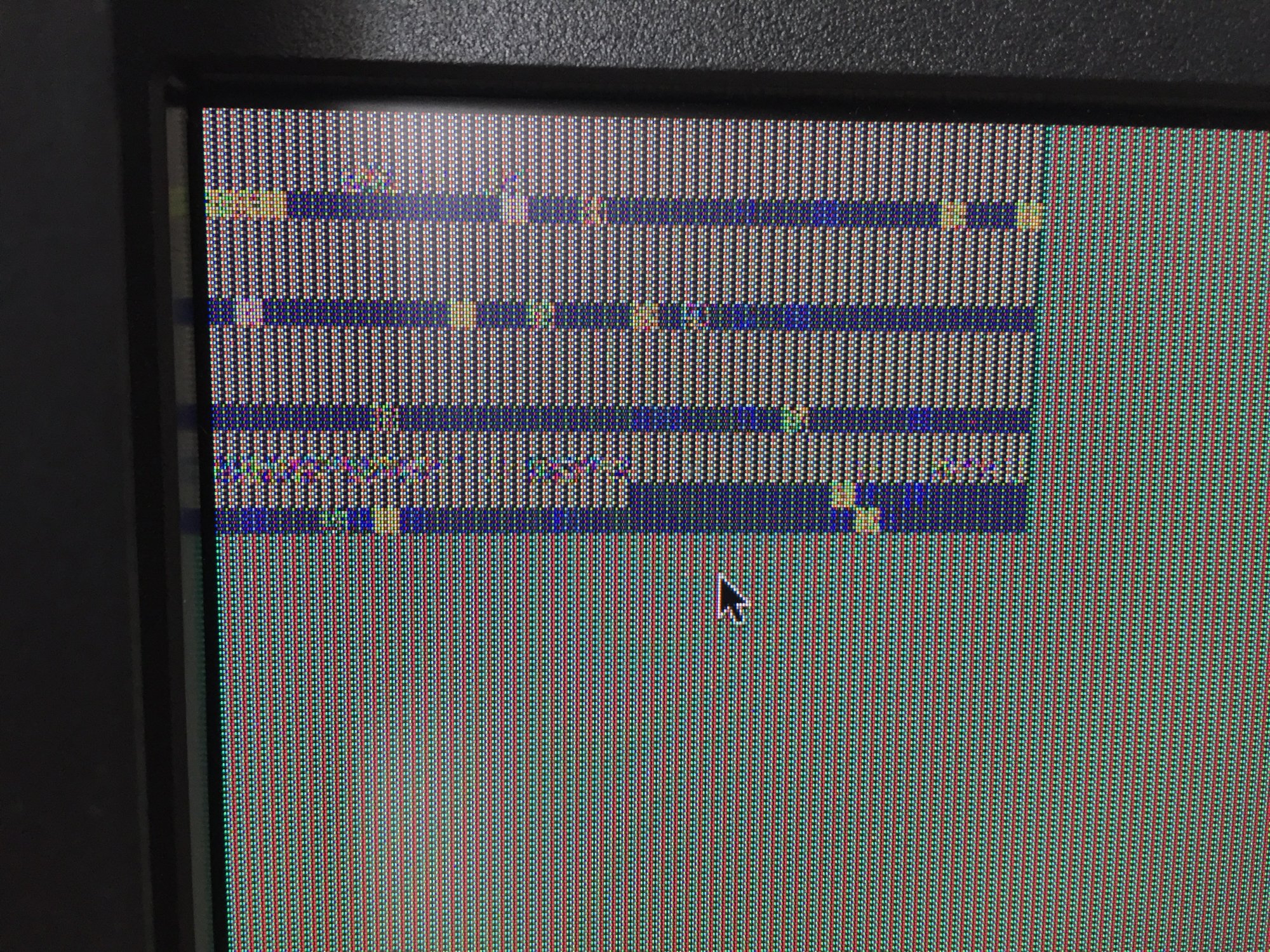

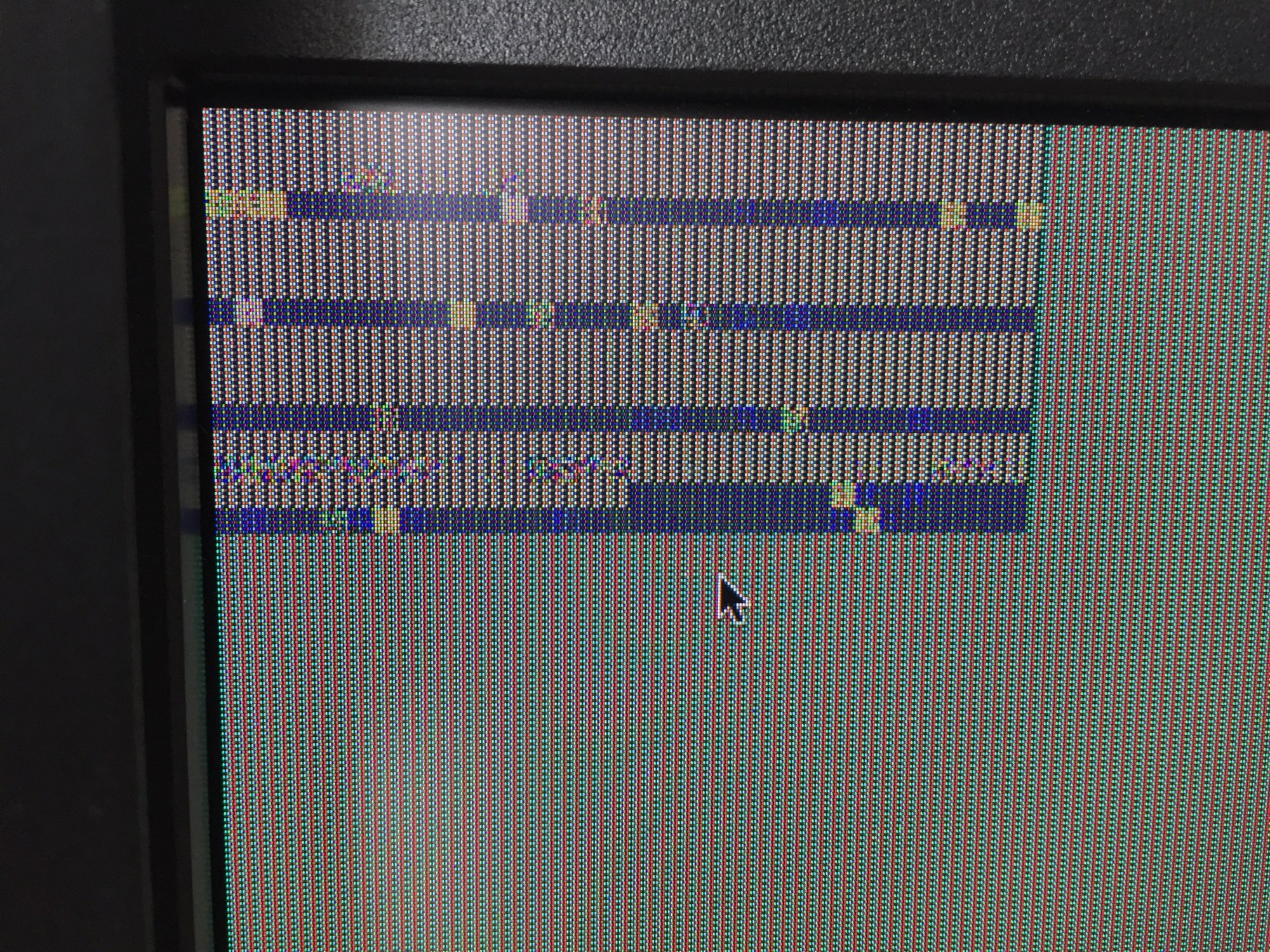

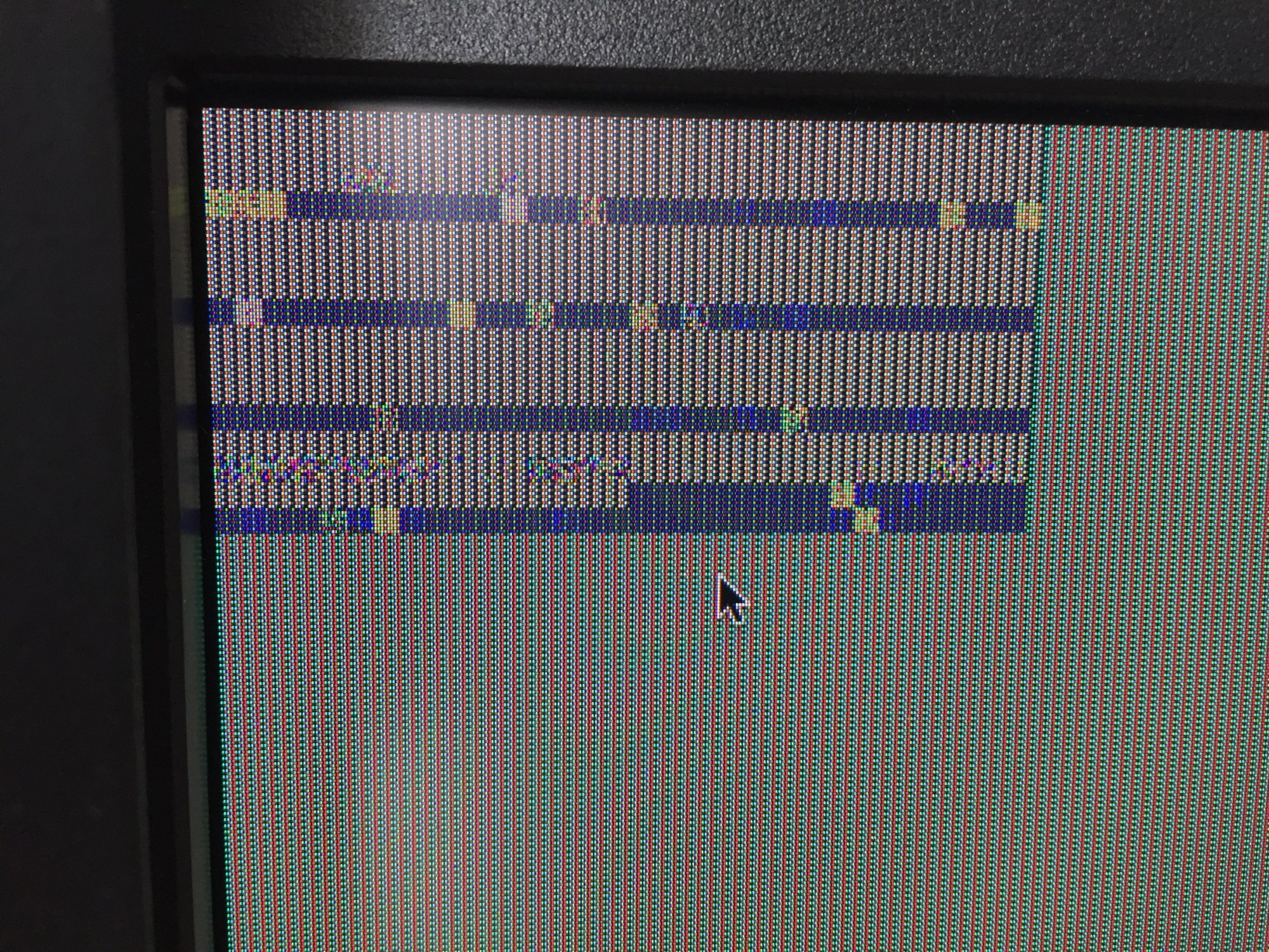

Update: cloning macOS with SuperDuper! rather than CCC made it bootable off USB... to a point. It loads slowly, as you would expect off USB 2, then when the progress bar gets to the end only one of my three screens lights up (the one using DVI) and it slows a garbled picture. The mouse cursor moves, but that's as far as it goes. Does anyone have any idea why this might be?
Instead of cloning try a straight installation. USB drives are tricky. You'll never know it's bad until you try and make it an installer or opsys. Some just won't boot. My installation took about 2 hours on a non-powered 128GB USB drive. I'm glad my first shot went in. Otherwise, I would be tackling this until I won or conceded. Has anyone else mentioned this problem? I figured it was the multiple bootable EFIs confusing the boot loader.
