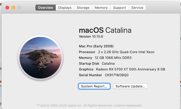

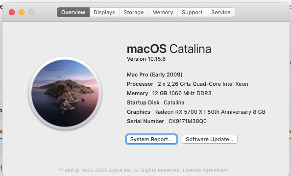

Hi Folks!
I need assistance here.
I'm on mac pro 4.1-->5.1. Still original CPUs and RAM here, I'm waiting for them to arrive.
I installed Catalina on nvme.
I used OpenCore 0.6.
Now almost everything I need is working except the hardware acceleration (used VideoProc to test it) and hibernation: if I put my system into sleep mode, it never goes back to work.
To do the install I followed the post on page 1. I edited the config file to have hardware acceleration, graphical boot picker and nightshift.
I attach my config file. Could anyone tell me how I can make hardware acceleration to work?
  • config.zip

Everything you need is in the 1st post. For you look at Hybridization section.

Try Martin Lo's OpenCore package and config here:
Excuse me sir, I stated I followed the first post. If I still have issues, maybe I did something wrong or that's not explained in way I can understand. In addition, I tried to do the hybridization steps and I had errors during the verification.
Hybridization
iMacPro hybridization, a strategy originally due to @h9826790, is integral to successful hardware acceleration.
Thank you man! It worked (quite) like a charm.
I also manually added the support to Night Shift.
Still have to try if cmp wake up after the sleep though.

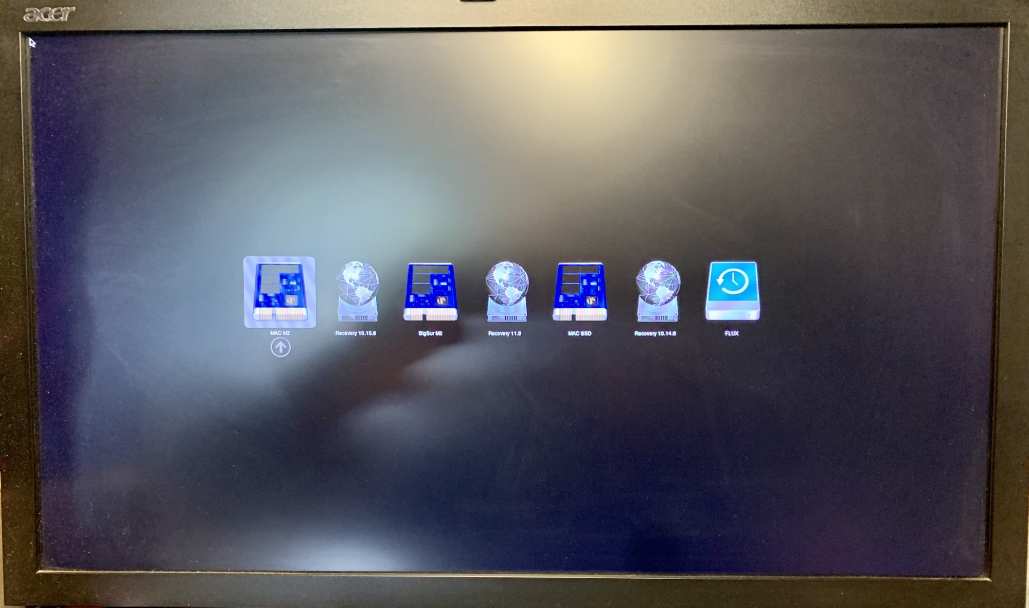

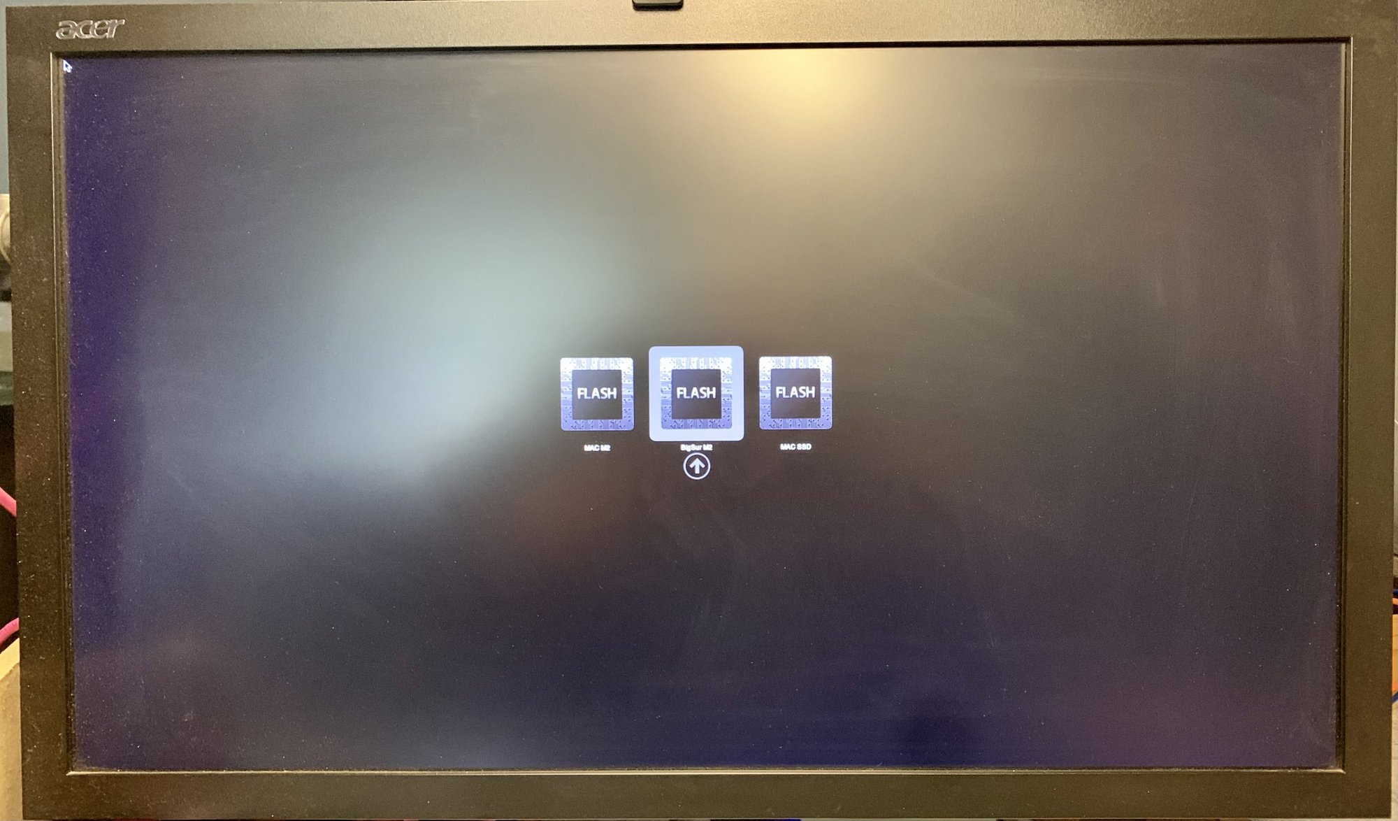

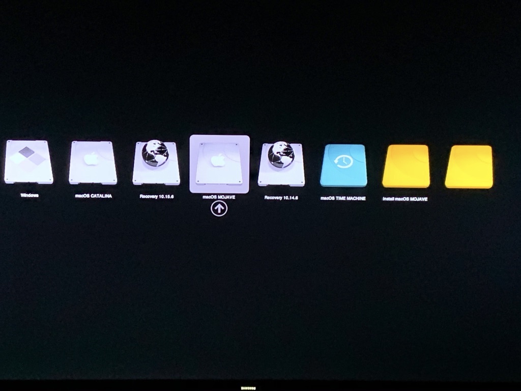

This is my newly edited boot screens
with more appropriate icons

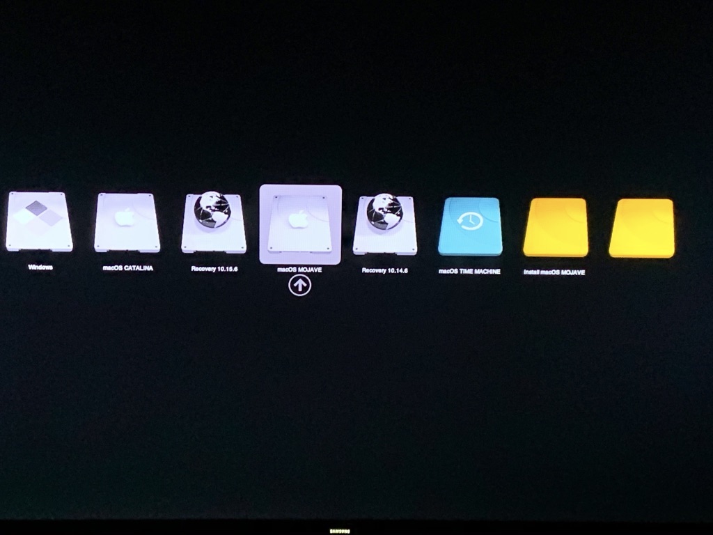

Does anyone have a bootpicker screen with power and restart buttons added?
