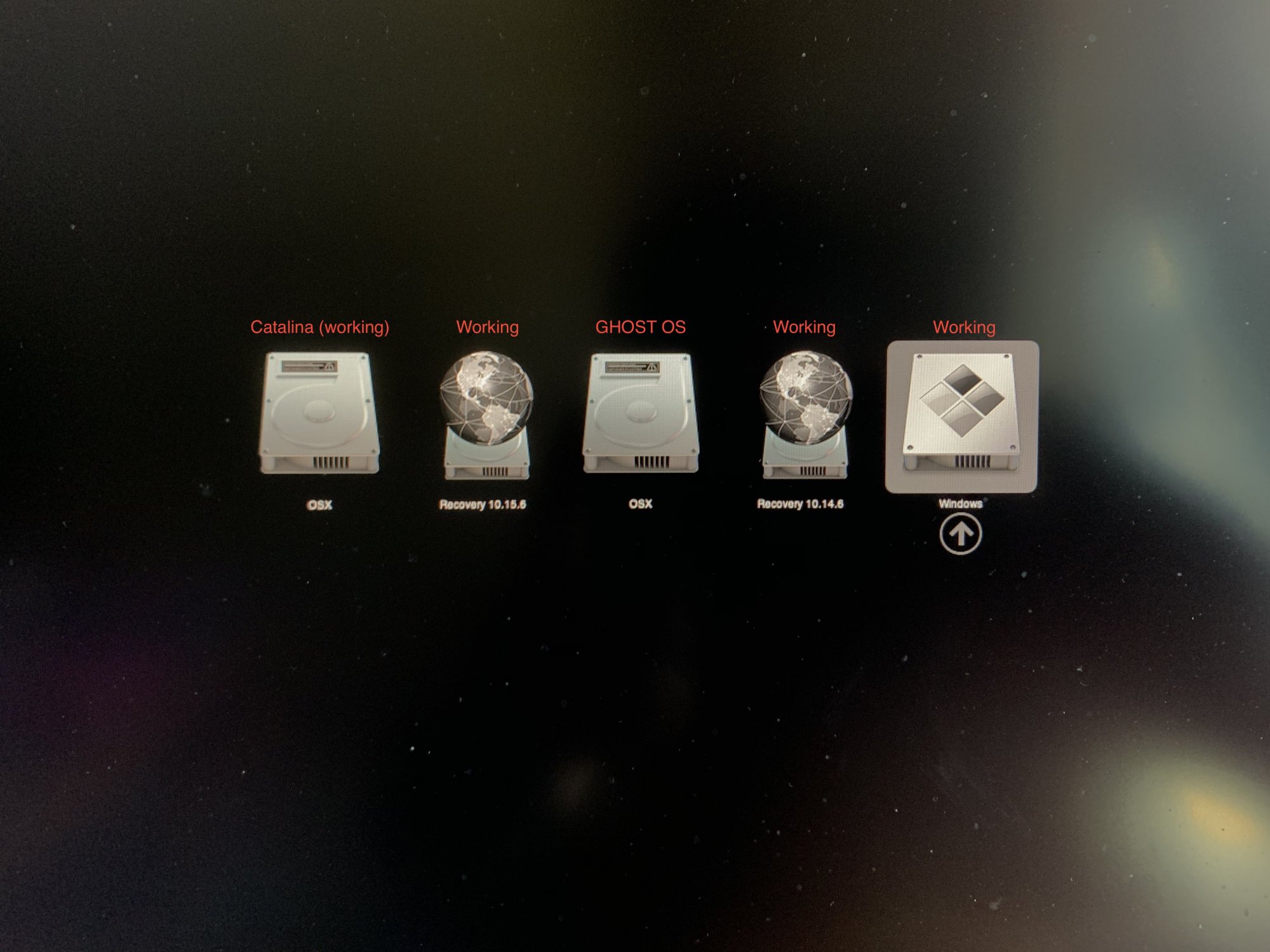

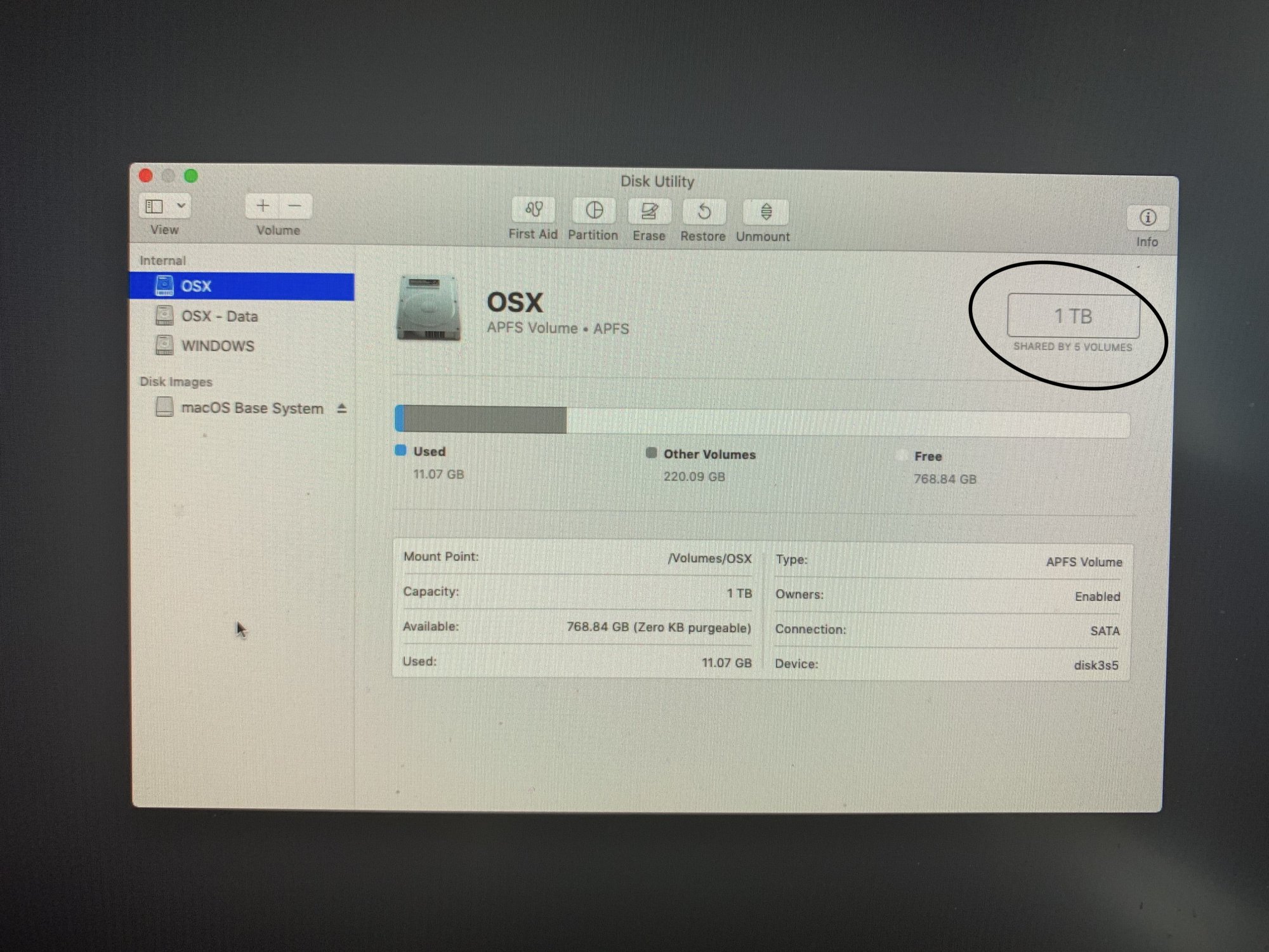

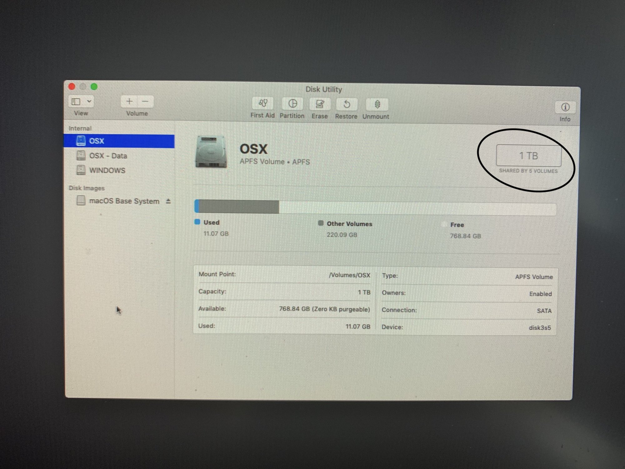

Hi everyone,
After some considerable pain and faffing about last night. I did eventually succeed in getting Catalina up and going on 0.6.1
And I currently have Bootpicker giving me access to a working copy Catalina, a 10.15.6 Recovery Partition, my Windows drive and a 10.14.6 Recovery Partition. There's also a "ghost" icon for OSX (which I'm assuming is the ghost of Mojave?).
I'm wondering if there's a way to strip out the ghost volume of Mojave and the Mojave Recovery Partition from the bookpicker?

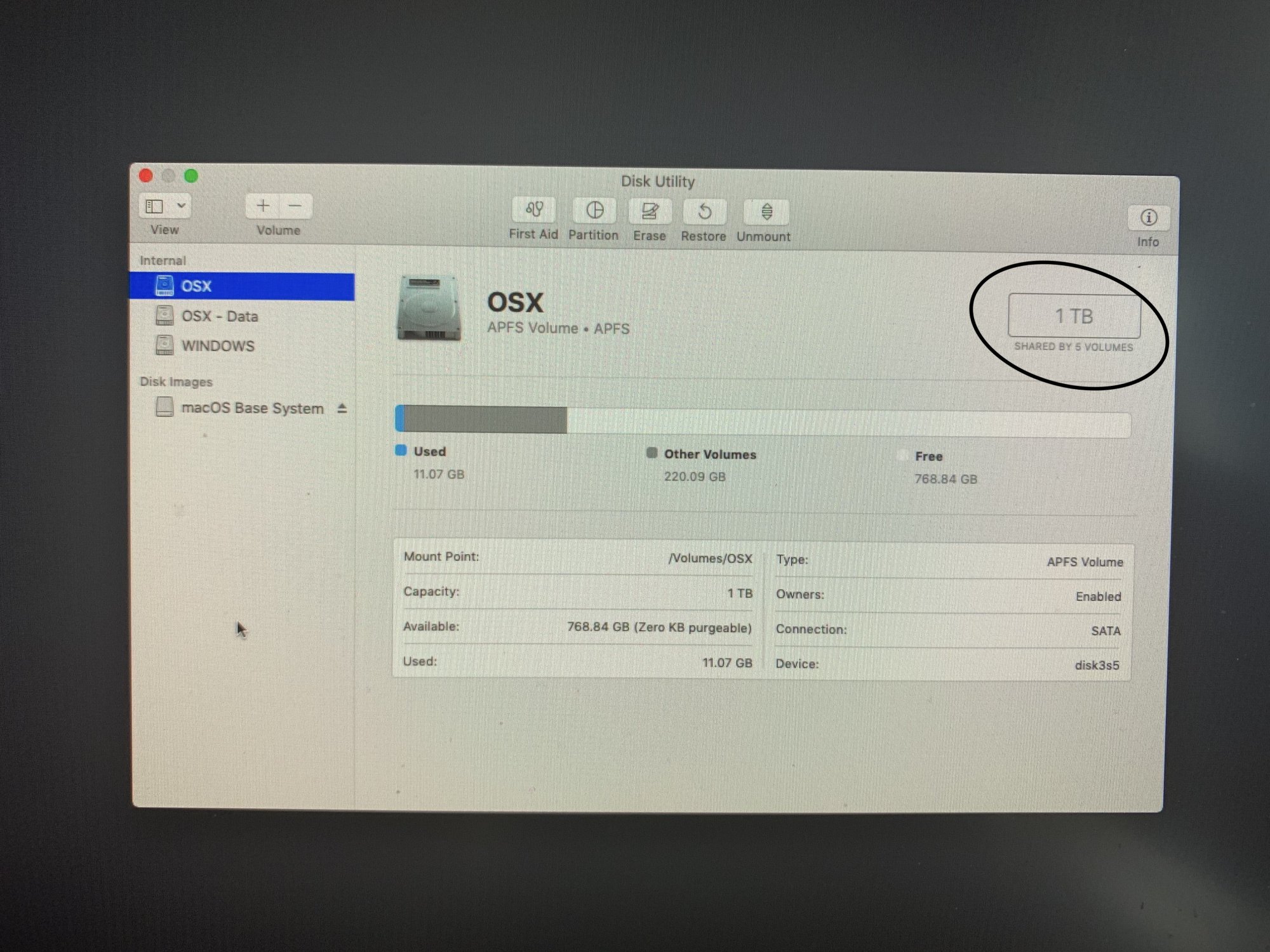

When I go into disk utility, I am seeing this curious situation, where there's the correct number of volumes listed on the left, but in the top corner it says my Catalina drive is "SHARED BY 5 VOLUMES":
Is that what's causing the "ghost" volumes to show up in the Boot Picker? And if so, how do I ghost bust them?

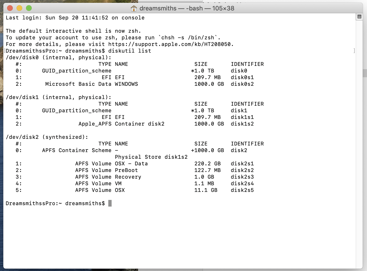

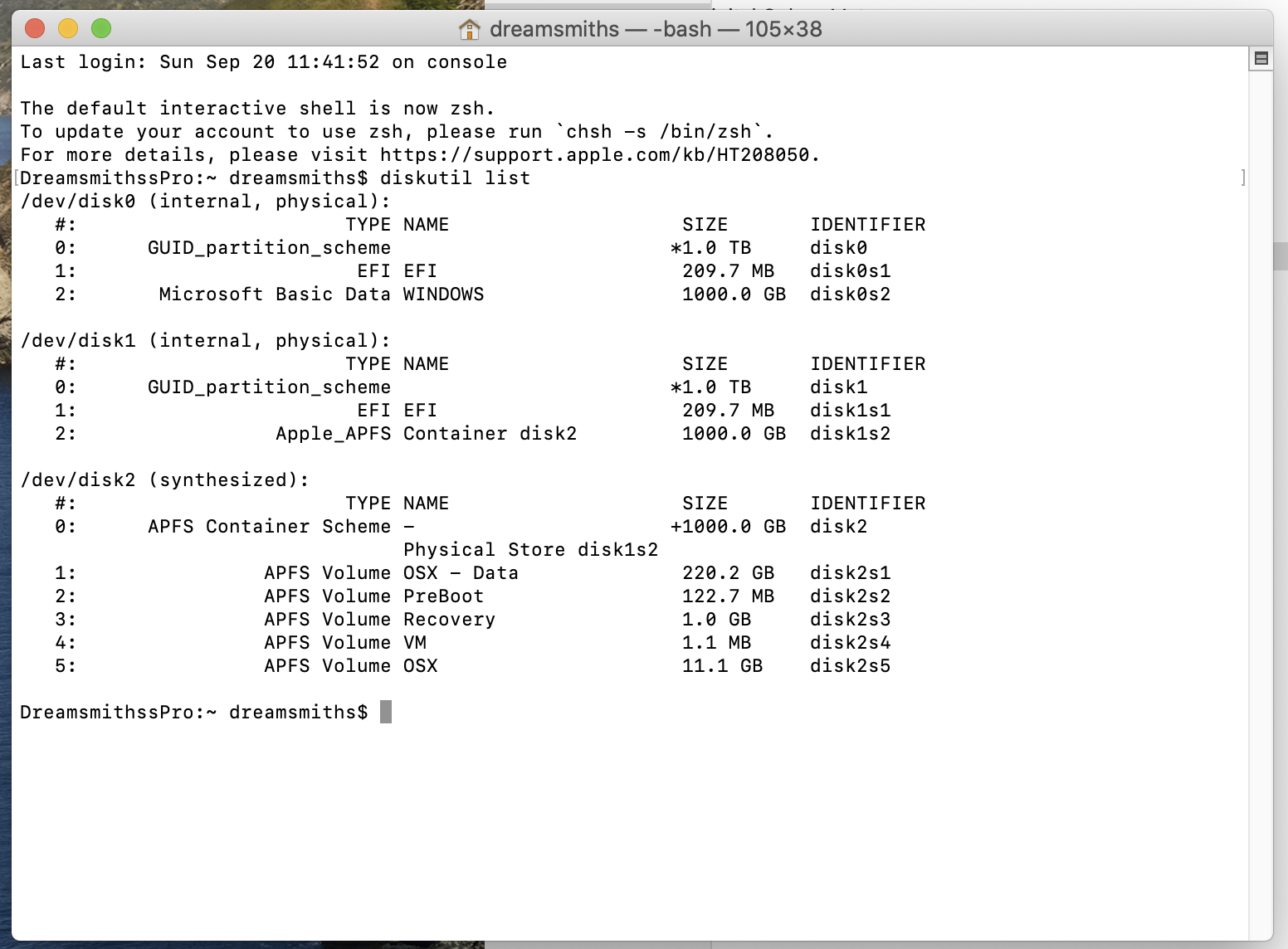

When I ask Terminal to list the volumes, this is what I get (what's actually plugged into the machine are two 1tb SATA SSDs, one for Catalina, one for Windows):

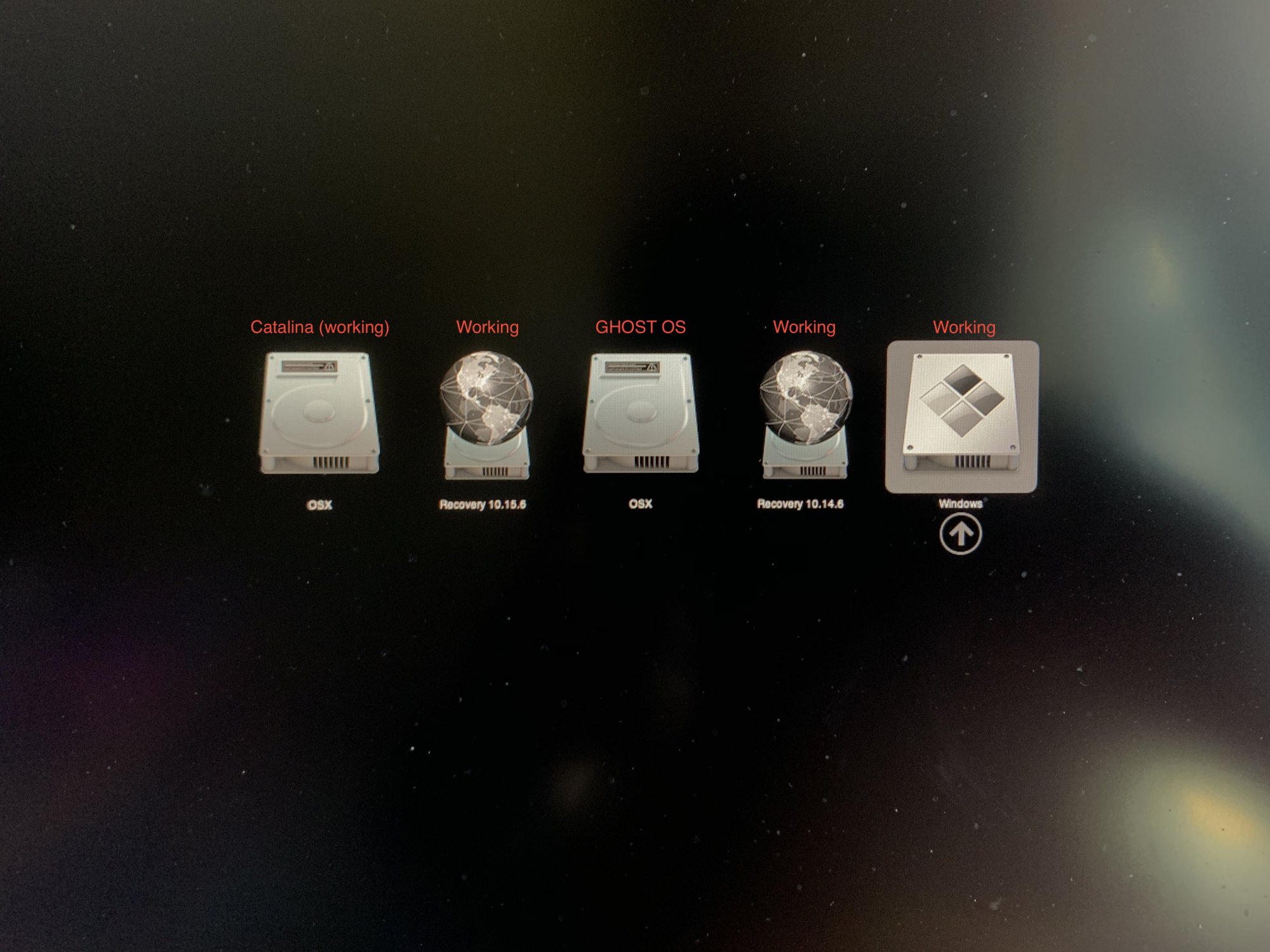

Hi everyone,
Why don't you enable all devices in disk utility? It looks like disk1s2 is not mounted for some reason.

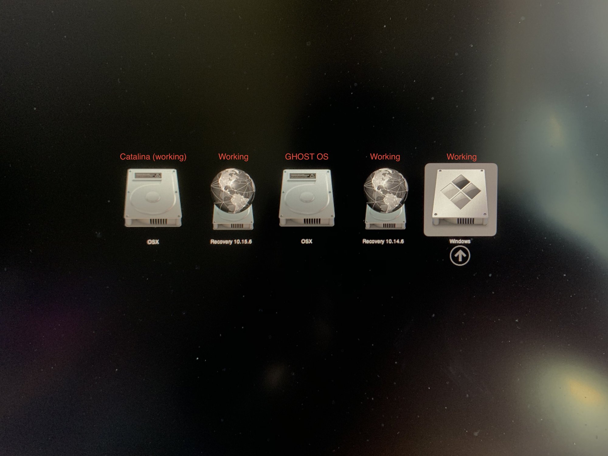

Well after another full day of fiddling, I've had some success and now have Catalina up and running seamlessly, with bootpicker giving me just the options for:
- Catalina
- Recovery Partition
- Windows
Which is where I was with Mojave on 0.6.0, and where I wanted to be. I am noticing though with Catalina and 0.6.1 that my initial boot up into the bootpicker has become significantly slower. Before it was maybe 15-20 seconds, now it's closer to a minute before the bootpicker shows up (boot times once a partition has been selected appear to be normal).
Is this common? Or might something have gone awry?

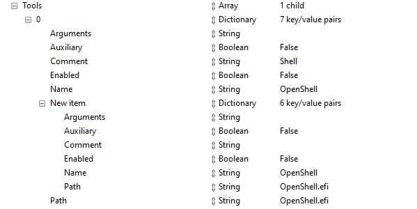

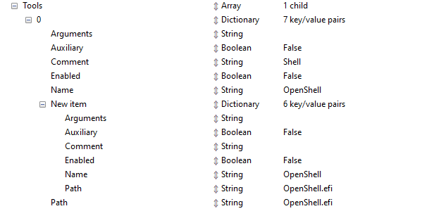

You can check your config file with the ocvalidate even in Windows from here:

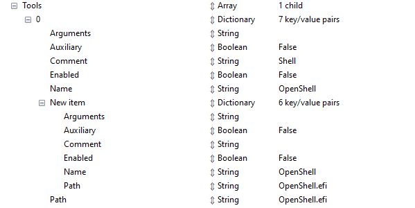

OCS: No schema for DirectGopCacheMode at 2 index, context <Output>! is no longer a valid option.
OCS: No schema for New item at 5 index, context <Tools>! this code looks screwed up in your config:

Code:
\OpenCore-0.6.1-RELEASE\Utilities\ocvalidate>ocvalidate.exe config.plist
Done checking config.plist in 146 ms
Many thanks for the heads up. Actually, most of the ocvalidate warnings refer to options directly inherited from my currently working 0.6.0 setup, which one of the members of this forum was kind enough to provide. That also applies to the "New item" oddity you mention. I'll study that section in particular using known valid config.plists of others. I've already removed the invalid DirectGopChacheMode parameter.
- Catalina
- Windows
Blessing the EFI volume again sped up the bootpicker showing. Need to do that if you do a NVRAM reset.
