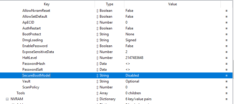

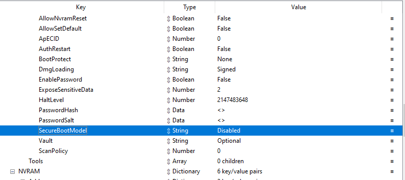

Attached is my current config.plist which works fine on 0.5.8 and not on 0.6.1. I'll trace what's changed another day, too late now. Clues appreciated.
May I please know what you meant by "swapped out the guts of OpenCore and rebooted?"
I have the exact same problem that you encountered -- the endless loop of being thrown back to the OC boot picker menu.
I have tried redoing the OC installation process 2 times now but failed both times with the same result of being thrown back to the boot picker.
Hope you can kindly clarify how you fix this.

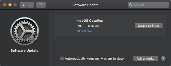

I recently installed Mohave on disk A because of a failed disk. The system is telling me to upgrade the OS but is giving me a null version? Before I used to get a specific version. I don't have an Apple ID set.
Do you have imacpro board-id in your config? "will not boot" is a vague term. Provide a debug boot log as a minimum.
