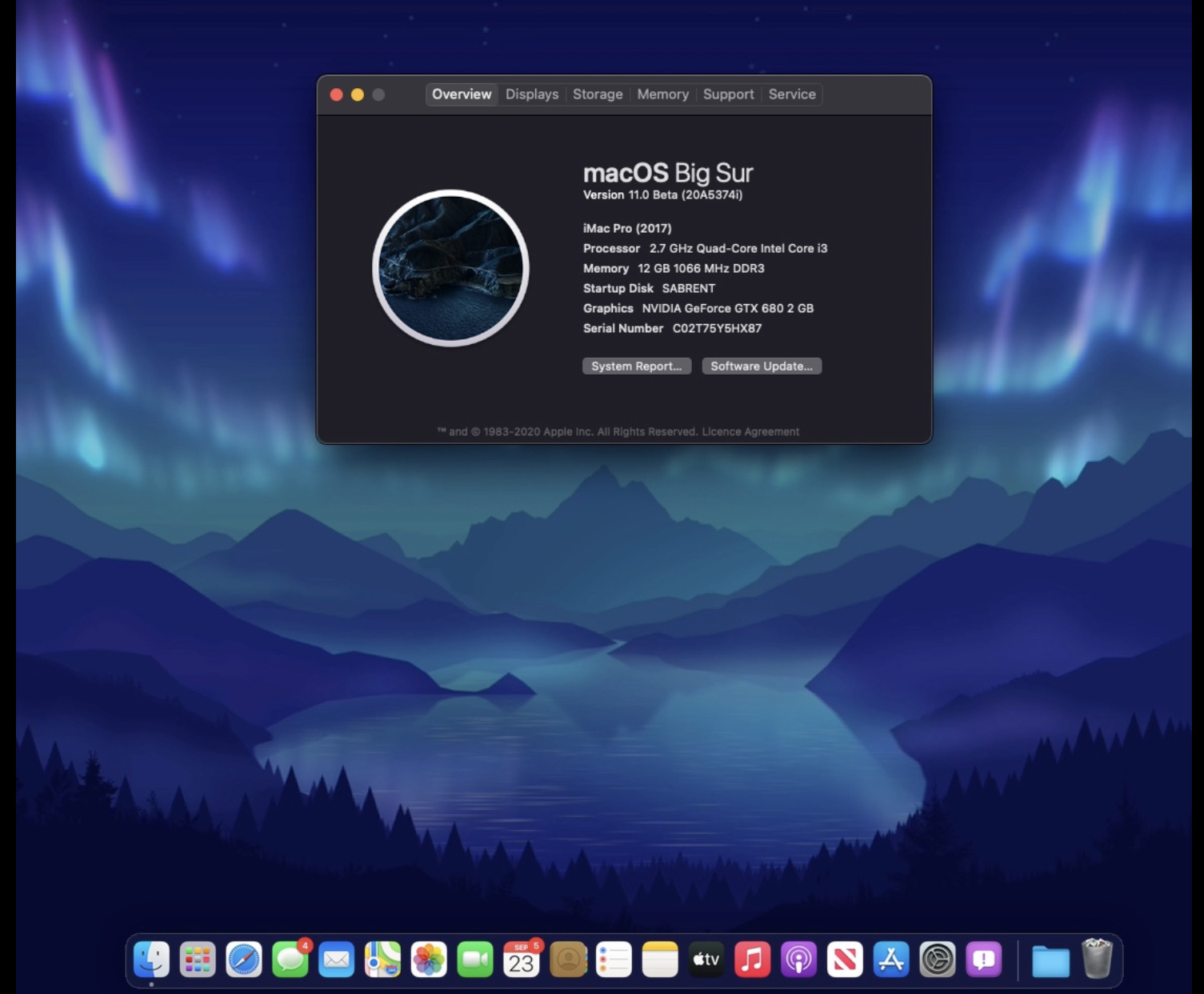

Hi Folks.
Does anyone know what I need to do in order to make my cmp 4.1 to correctly recognize the 1333 memory with OC?
At the moment I'm seeing my new RAM modules as old 1066, but they are 1333.
How can I edit the config file?
TIA

That is most probably a CPU restriction not OC. What is your CPU?
Note:
Although the memory speed of the UDIMMS is 1333 MHz, they will operate at 1066 MHz or 1333 MHz depending on the processor in the computer.
Note:
Thank you man.
I still have the old processors, I'm still a little bit worried about changing them.

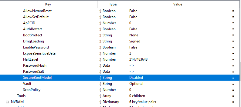

Yes, that's indeed the case. There's something wrong in either 0.6.1 itself or with the config.plist provided, and it has nothing to do whatsoever with the specific operating system you are trying to boot. The boot affects OpenCore itself, not Catalina in any of its iterations.
Yes there is an error. @cdf SecureBootModel needs to be either properly set (not only through the config file) or disabled. So for BigSur you will also need the board-id. The attached config file should let you boot. Let me know if it does not.
Edit: I forgot that for dual CPU's you will need also DisableMCEReporter.kext. ALso you can add WEG and LILU kexts.
