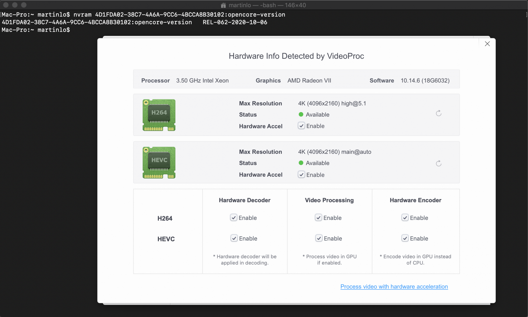

HWAccel works fine in 0.6.2
screenshot-2020-10-06-at-00-52-54-png.963185

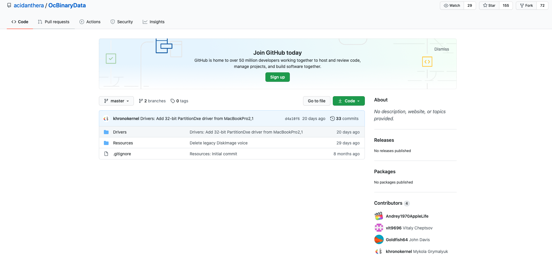

Luckily it seems replacing the config file and switching to OpenCore 0.6.2 worked. I couldn't find the ZIP file for OcBinaryData am I at the wrong page?

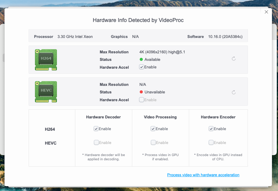

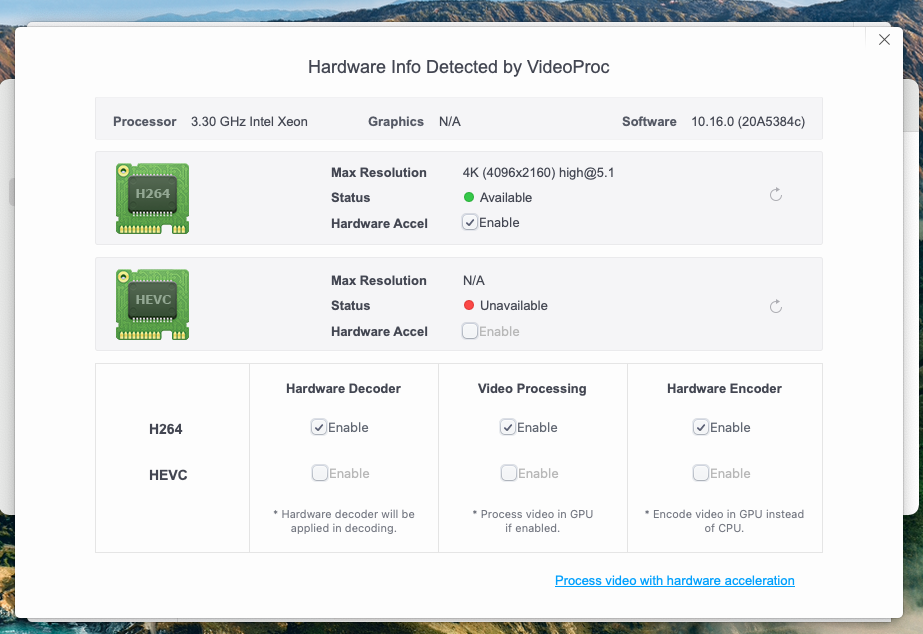

Here's what I get on Big Sur Beta 9.
Same here .. I was told it is a bug that was mistakenly introduced. But if that was the case then it would be the same for the entire line of product \s running that same beta 9 no? Since I have upgrade to beta 9 I do not have that HWACCL anymore..

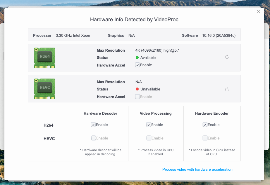

the same, now it's waiting for the new update ...
