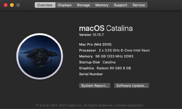

Also here is a quick System Specs Screenie incase hardware is a possible issue

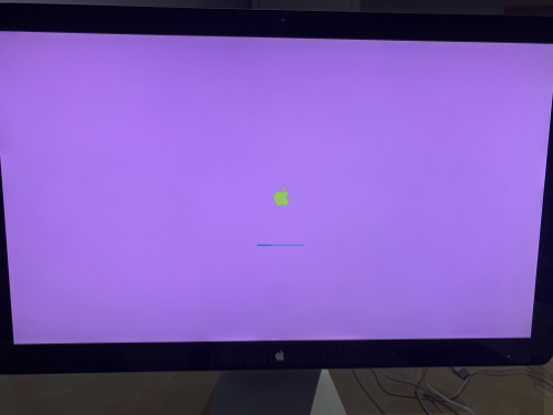

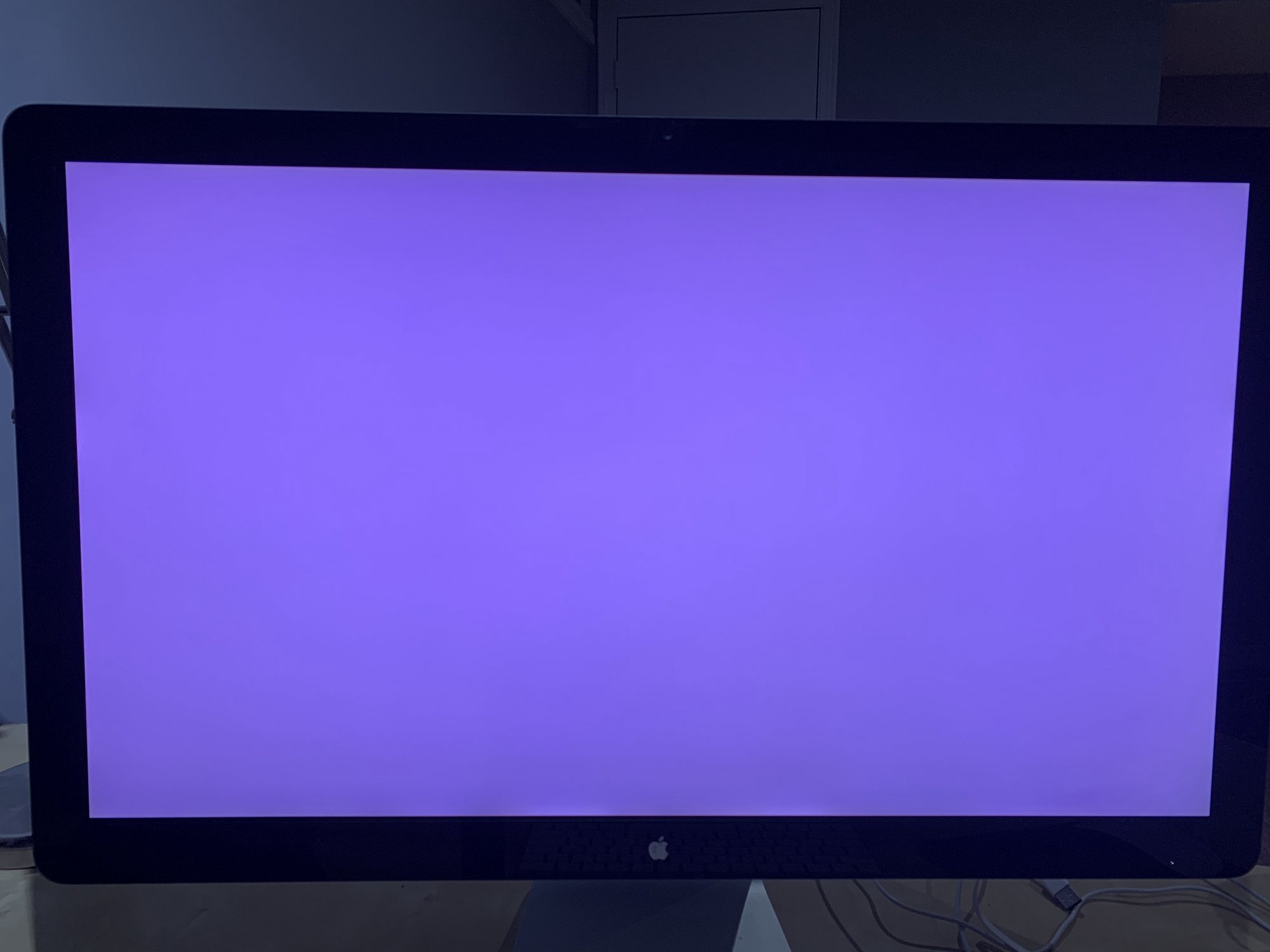

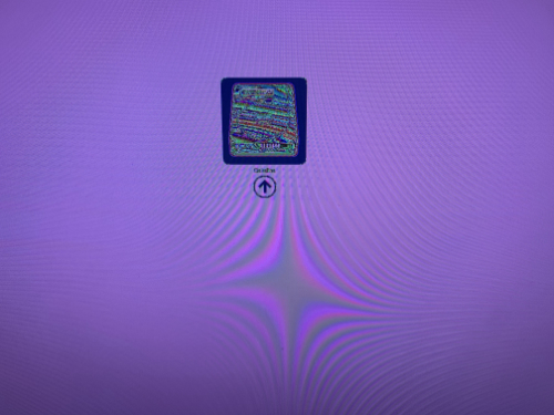

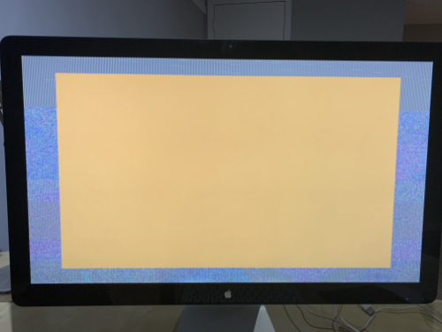

I am running into a few small aesthetic issues that if someone has a solution to resolve it would be awesome but if not then its an aesthetic issue so ill just deal with it.
I followed the basic installation parts 1 - 5 to the letter in post #1. and I also Enabled the Graphical Boot Picker in "Part II Advanced Configuration".
When I boot up the Mac the wild and negative colours appear on boot. Much like when I first installed OpenCore. I can make out that the Graphical Boot Picker is working but those pinks and yellows and rainbow spectrum colours don't look the greatest. Once I select the Boot Drive the Black screen with the white apple logo kicks in and everything is fine from there on.
I went and repeated all the Post Install actions again (made sure the changes were correct) I even re enabled some like HiDPI Display, GOP Renderer but reboots with those reverted were still the same.
Could someone let me know if the initial boot screen is supposed to be crazy colours and if not if you have any suggestions on what the issue might be that would be awesome.
End of day though is a small aesthetic issue when I first boot up so if that's just how it is I won't complain.
Awesome Job once again :D
Edit: Attached are photos of the screens I see in order, Ive seen this (Apart from the Graphic Icon of the Boot Drive) on boot up ever since going to Open Core (incase that in itself is unusual). a second after the last photo in the series it goes to the black apple boot screen for a second before logging into Catalina
View attachment 964771View attachment 964772
The suggestion is to run the debug version and enable logging for further evaluation. I have seen colors in the code for the boot kicker perhaps they are somewhere else in the code and they mean something.

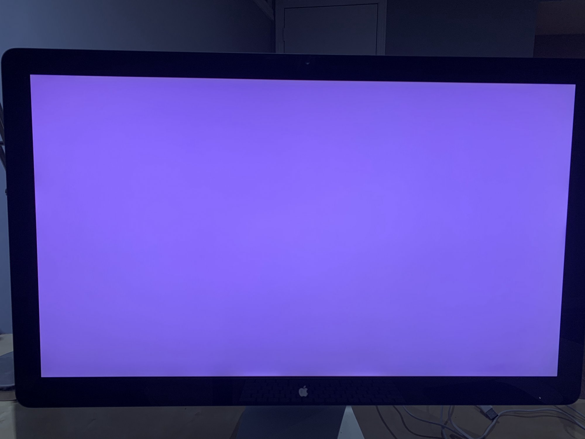

So does that mean that what I am seeing when I initially boot up is normal or did something go wrong in my process?

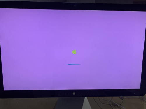

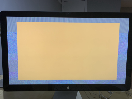

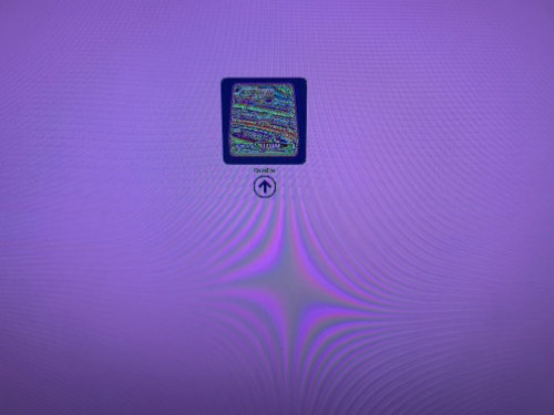

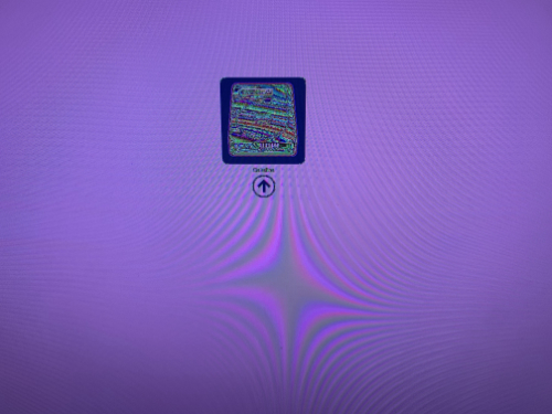

Hi There,
First off I wanted to say a Huge Thank You to the OP and everyone involved in this guide and all the magic that allowed me to Install OpenCore and get Catalina on my 5,1. :)
It works and from a complete techno dunce like me being able to follow along and get this done is massive.
