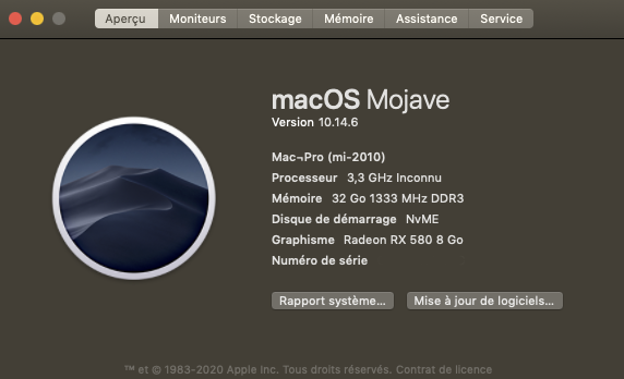

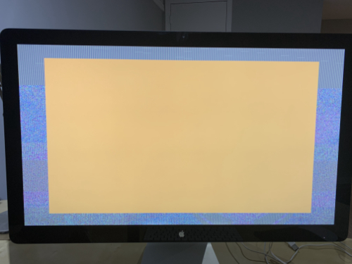

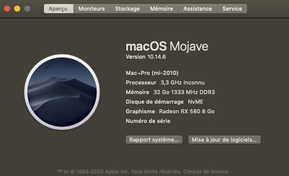

I have the exact same problem as RottenCotton.
cMP 5.1, 3.33 Gh, XFX 580.
I get the same screen with weird colors. I tried several solutions: the small switch on the card in the 2 positions does not change anything. I tested “DirectGopRendering = false”, it doesn't change anything.
Please does anyone have an idea?
Everything else works without problems, hardware acceleration etc ...
Thank you !

I followed the basic installation parts 1 - 5 to the letter in post #1. and I also Enabled the Graphical Boot Picker in "Part II Advanced Configuration".
When I boot up the Mac the wild and negative colours appear on boot. Much like when I first installed OpenCore. I can make out that the Graphical Boot Picker is working but those pinks and yellows and rainbow spectrum colours don't look the greatest. Once I select the Boot Drive the Black screen with the white apple logo kicks in and everything is fine from there on.
I went and repeated all the Post Install actions again (made sure the changes were correct) I even re enabled some like HiDPI Display, GOP Renderer but reboots with those reverted were still the same.
Could someone let me know if the initial boot screen is supposed to be crazy colours and if not if you have any suggestions on what the issue might be that would be awesome.
End of day though is a small aesthetic issue when I first boot up so if that's just how it is I won't complain.
Awesome Job once again :D
Edit: Attached are photos of the screens I see in order, Ive seen this (Apart from the Graphic Icon of the Boot Drive) on boot up ever since going to Open Core (incase that in itself is unusual). a second after the last photo in the series it goes to the black apple boot screen for a second before logging into Catalina

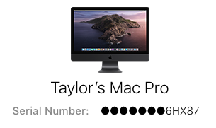

Hey all,

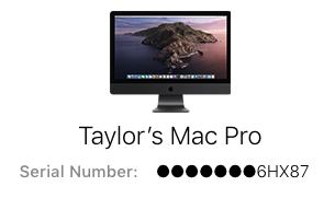

A warning to all using the config in post #7 when updating Big Sur, make sure you sign out of your iCloud account! After seeing all the warnings on here, I had sworn everything was successfully signed out before I switched to the OC config. I am now unable to sign into iMessage or Facetime because I get an "unknown error" upon activation.
On my device page for my iCloud account it has my MacPro listed with obviously the incorrect serial number, it's now the same one matching the config in post #7. No matter how many times I hit remove, it won't delist the device from my account. When I look at my devices on the settings page on iOS, it has my MacPro listed with the proper serial. I am no longer using the config and am using just the vanilla AMD hardware acceleration config. Any suggestions on how I could get this sorted out so I can use iMessage again?

Are those weird colors limited to Apple's Statup Manager boot screen and/or the OpenCore Boot Picker, or do they have an impact on your desktop? Has your XFX 580 been flashed? Several 580 users have stated that weird colors and artifacts can often appear BEFORE the Metal drivers kick in at boot time, but everything should settle once the drivers have been loaded, a few seconds before your desktop is displayed. If that's what happens, I wouldn't worry too much.
Those weird colors are limited to the OpenCore Boot Picker, but render the Graphical Boot Picker unreadable... and useless. After the drivers are loaded, everything is fine...

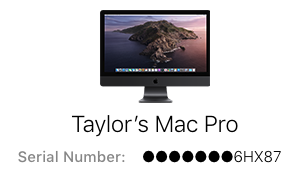

Hey all,
Try Sign out iCloud on cMP. Shutdown, wait few minutes, then switch on the cMP and sign in again.
If doesn't work, then try the same thing, but after shutdown, perform a 3x NVRAM reset before you sign in again. [N.B. Even our default config should makes OpenCore survive after NVRAM reset. But always know your plan B in case NVRAM reset disable OpenCore].
Check out post #3,062

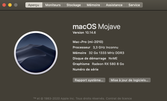

Hi everybody,
Thank you for all this shared work ...
Thank you !
Hey there,
Just to confirm our issues are the same:
- power on and black screen for 10 seconds
then screen shows a box that’s usually off white or light yellow, sometimes pink
- then I got boot picker screen (I think that’s the term, where I get to choose Mojave or Catalina login And the disk icons are multi coloured ..... but crazy like your staring at the pixels of an old crt television.
then the Apple logo with boot up progress bar but the Apple logo is one crazy color like hard pink on a dark blue background
- then the nice black loading screen with the white Apple logo kicks in
is that what you see?
Hi Peter,
Thanks for looking into this. If you see my reply just above #4,169 that’s what I see / experience and while I’m not 100% on the terminology that’s pretty much it.
so it looks like it’s an issue for 580 users, but as you mentioned once logged in you would never know it had happened. Zero effect!
as I said before end Of the day it’s not a big deal, but I think I have a dose of OCD or something similar as even though it’s inconsequential it still at the back of my mind festering 😛
anyway if some bright spark ever figures it out I would give them major respect and dues if they could share it here.... I just saw this community resolve a ton of bigger issues, wierd colours on boot should be a walk in the park for some of you.
