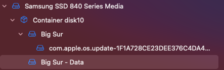

Installed Big Sur beta 10 (20A5395g) on an empty SSD from Catalina 10.15.7 with full installer offered from the update assistant.

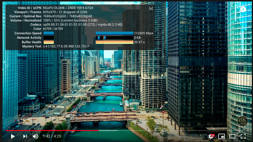

8K VP9 video playback in Safari:

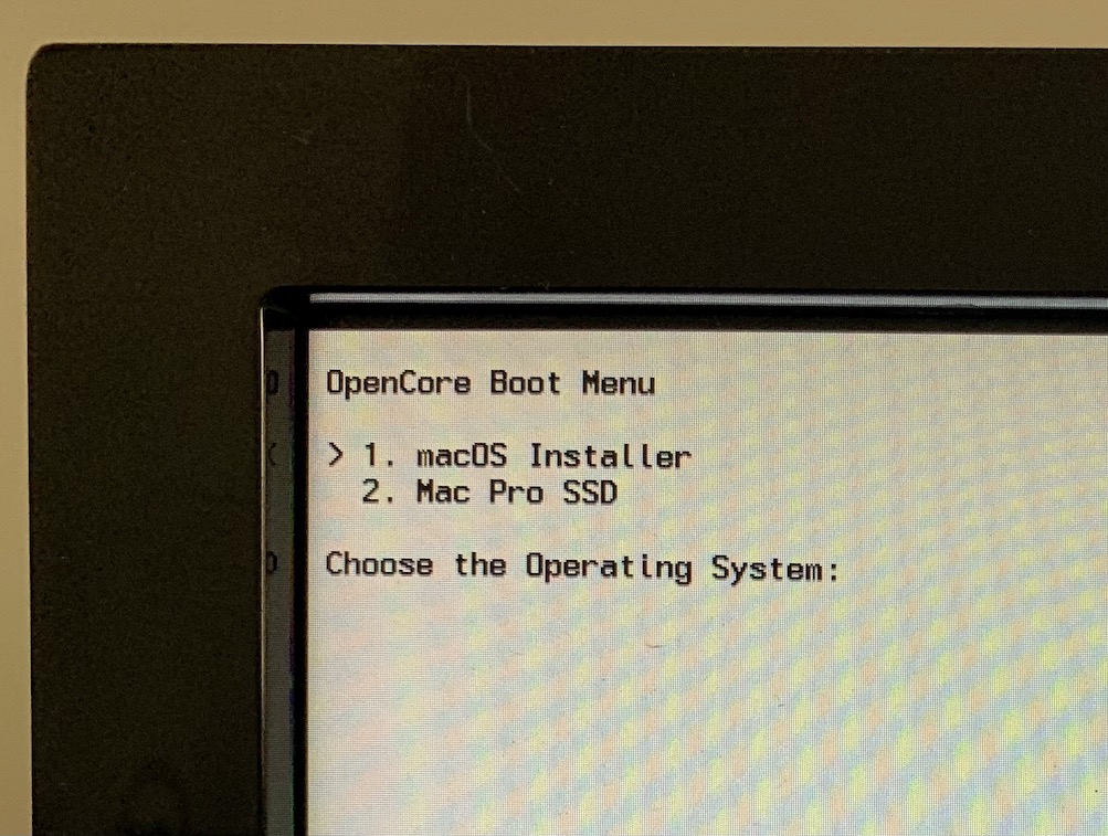

i tried to install big sure on a new hard drive (fist time open core install).
everything worked well until installing big sure to the new drive.
during installation, the mac reboots and i see the boot picker (see attached image).
after selection 'macOS Installer' i see the apple logo but nothing happens.
i waited for almost 10min and then i shut down my mac.
What am i doing wrong?
Thanks

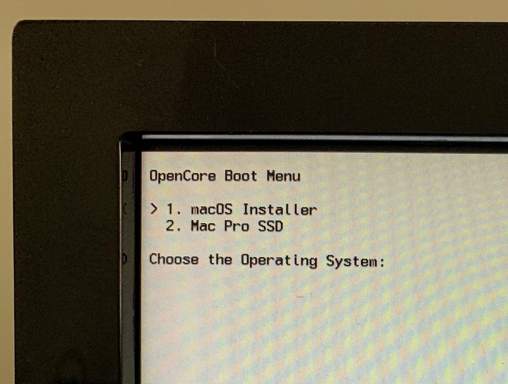

i waited for almost 30min and then i shut down my mac.
Thanks
Which config you used for Big Sur installation? There are some reports about Big Sur installation stuck after 2nd stage reboot.
I recommend you try again, but use the settings in post #4212 for Big Sur installation.
That "macOS Installer" is the correct and expected behaviour, you don't need to touch it, OpenCore will pick the correct option to boot, and continue the macOS installation automatically.
Reactions: naerct
I used the config.plist from the first post. But even after using from post 4212 nothing happens. I see the Apple logo and that’s it.
should I install Catalina first and upgrade to Big Sur afterwards?
This is an unsupported configuration, likely to break in the future and leave your machine in an unknown state.
nvram 7C436110-AB2A-4BBB-A880-FE41995C9F82:csr-active-config
7C436110-AB2A-4BBB-A880-FE41995C9F82:csr-active-config w%08%00%00[/CODE]
Yo is that HWaccel? Thought HEVC stopped working on previous betas. I imagine Netflix also plays 4K with this?
