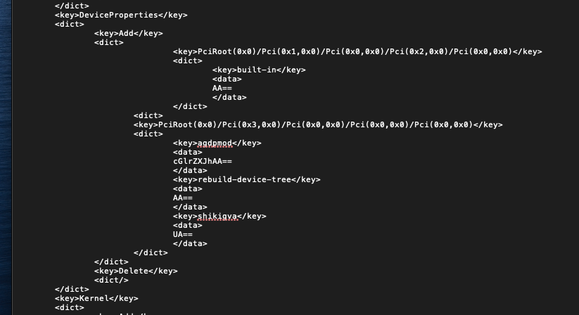

So I went ahead with testing this out on the 5,1 yesterday, and again this morning, Currently running Catalina 10.15.7
everything is working so far on a clean install except the ability to get external PCI SSD as internal I keep getting this error:
here is the full Device Properties key list:
if anyone could help me see whats wrong that would be awesome I've tried a few different things and haven't seemed to get it going yet.
Once I get it I would like to try getting Big Sur on a second test SDD
Looks like you have an extra <dict> entry - 4th one down in your image. Did you confirm the config is Ok as indicated in Post #1?
Reactions: wickerstick

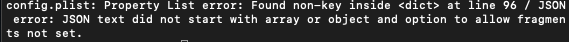

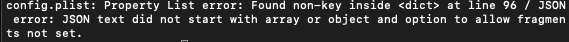

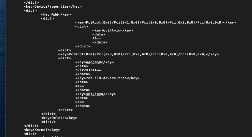

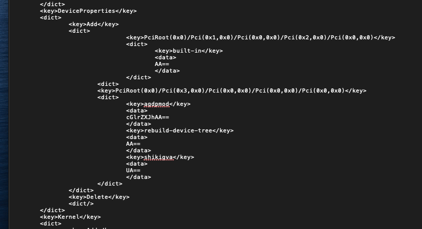

First pic show the error output of config when I add the xml from post 1. when I remove xml for external drive I get the a okay. Ive copy pasted the XML in notepad with my PciRoot pasted in place of the generic one. every time I try something different I get the same error in a different line
Edit: you were right thanks for pointing that out!
