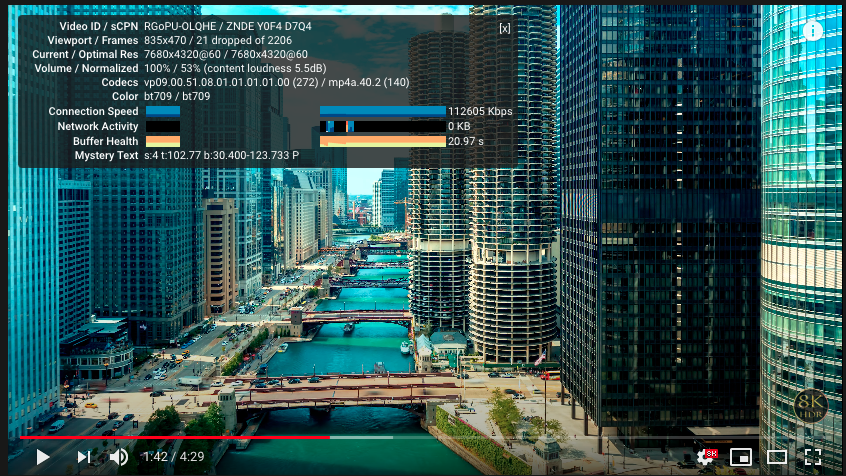

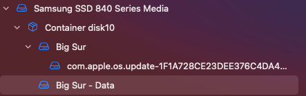

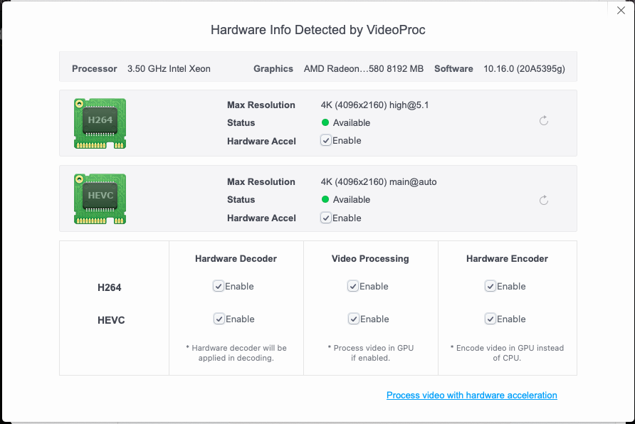

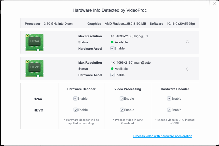

Installed Big Sur beta 10 (20A5395g) on an empty SSD from Catalina 10.15.7 with full installer offered from the update assistant.

8K VP9 video playback in Safari:
hi, as i understand with your post, I think finally understand the following: I must simulate a iMac Pro to get working Big Sur? this is right? thanks in advance
That is what gave me the update yes. Another way to install it is here:
That is without spoofing.
Reactions: Gerardo Flores
That is what have me the update yes. Another way to install it is here:
Thanks!, I will going to try with the spoofing way
