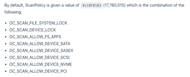

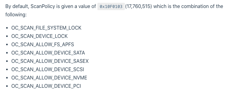

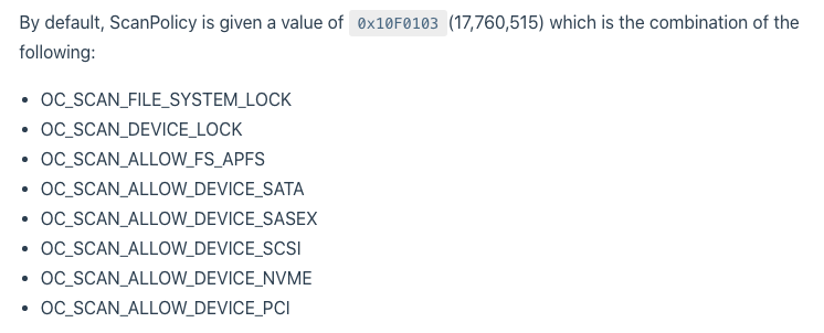

I did some testing with ScanPolicy and Vault with the EFI package installed on an external USB drive. And it worked well.
But now as I moved the EFI package to an internal drive suddenly both features are not working anymore.
When the EFI is on the internal drive the NVMe PCI device shows only up with ScanPolicy 0 whereas with the EFI on the USB drive it showed up with ScanPolicy 0x10F0103 (17,760,515):
Why is the EFI behaving differently on an internal drive then on an external drive? Any ideas?
Same with the Vault. With the EFI on the external drive the signing was very easy and reliable. But as soon as I moved it to the internal drive the EFI didn't boot with the signing applied.
What could be wrong?
Thank you so much for your help.
It was a bug and it is fixed with the a9af4ab commit.

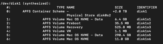

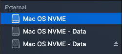

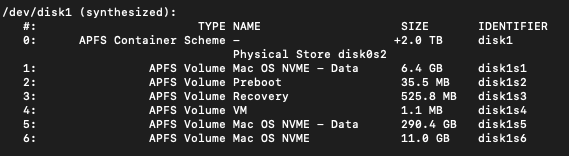

Hi,
I followed your guide on a flashed and updated 4.1 (3.46, 48GB, 2TB SSD NVME, Nitro+ RX580).
Great guide, thank you for your efforts on that.
I have a question however. Catalina is installed my PCI NVME. After the installation this drive appears 3 times in Disk Utility. Once with the normal name and once with "-Data" behind it. Is this normal? I didn't find any reference to this in the guide? Because of this I don't want to execute the part to get it to show as internal for now.
Thanks !
Physically remove Disk A, reset smc, now you should be able to boot from Disk B.

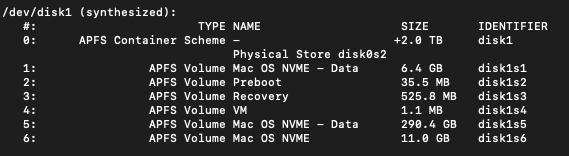

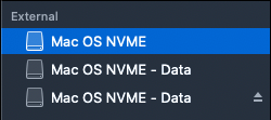

Hi,
Thanks !
Normally there should be two volumes, one for the OS and the other for your data. Does the diskutil in terminal also list two "- Data" volumes? In any case, making the disk internal should not break anything.

If you've followed the guide, then this should be the result. You can verify it by entering the following in terminal: ioreg -l | grep agdpmod. You should see "agdpmod" = <"pikera">.
It does show two as well. I did follow the guide twice, but I fully formatted the disk before starting over again.
Is there any way to get rid of this? Sounds a bit OCD-ish but it's mentally bothering me :)
If you change the name of the main volume the corresponding DATA volume will automatically change. This way you will find out, which is the third volume and you can rename it to anything you want.
