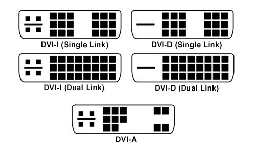

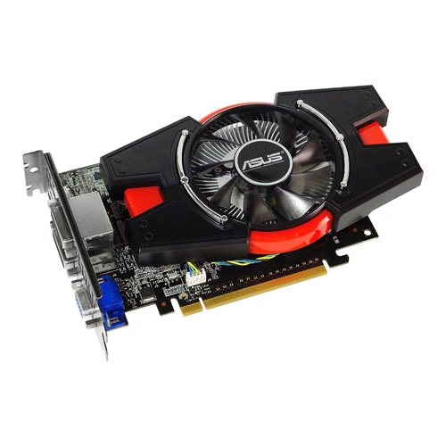

Which Gt-640? Does it have DVI-I (dual link) connector?
You can try with that one.

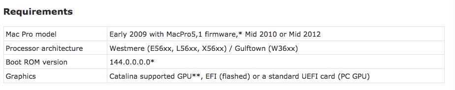

Sorry, I really can't watch the video and it doesn't matter what it does as such.
The important bit is this from Post 1:
If you meet these requirements, then follow the guide in Post 1 (I assume that's what the video does)
If you don't, follow the alternative I gave you earlier.
