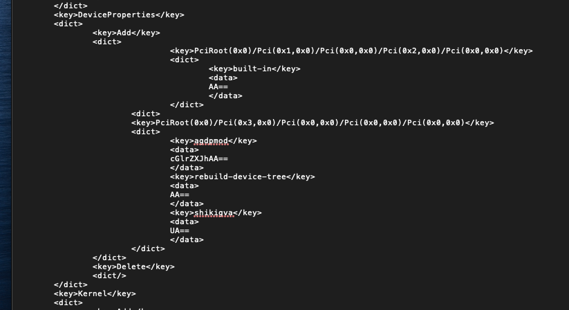

You use the config in post #1, then mod it as per post #4212?
No other editing in the config.plist, is that correct?
I also used the config from post #4212 an hour ago, but I added it to my config with OpenCanopy and other stuff on my Mac Pro 4,1 ---> Mac Pro 5,1. I used a empty APFS formatted SSD for installing macOS Big Sur Developer Preview 10. It didn't work for me either but I could boot in verbose mode. I get the same error message again and again but I don't know what the error message exactly mean. Maybe you know what the problem is. Thanks in Advance for helping.
i did like you said. But it did not work
Please try to use my config in this post.
You may simply replace the whole EFI folder to ensure the whole OpenCore installed properly.
Then sign out iCloud.
And then use the code in post #7 (this thread).
After reboot, you should able to install Big Sur. You may also format the target drive to HFS+, and let the installer to do the APFS conversion.
Let's see if this combination can work.

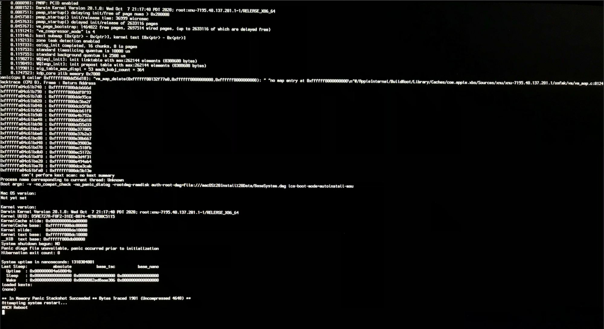

I was able to install Open Core and Catalina just fine. But for whatever reason, I cannot get my AMD 5700 XT to work in Catalina. It is a flashed card and it will allow me to boot into High Sierra and Mojave. It will NOT however, allow me to even so much as boot into Catalina. Anytime I try to boot using the AMD 5700 RX, it puts me through an infinite reboot cycle. Here's the error report. I'm basically at the end of my rope with this Mac. It's pretty much over unless I can resolve this.

*** Panic Report ***
panic(cpu 4 caller 0xffffff7f8b89747a): "[7:0:0][PPLIB] Failed Power Play Initialization. TTL Error Message: .
"@/AppleInternal/BuildRoot/Library/Caches/com.apple.xbs/Sources/GPUDriversAMD/GPUDriversAMD-3.10.18/Common/IONDRV/ATI/AMDUniversalFramebuffer/AMDUniversalFramebuffer/Controller/Controllers/AmdRadeonController.cpp:1670
Backtrace (CPU 4), Frame : Return Address
0xffffff864108b540 : 0xffffff8008d1a65d
0xffffff864108b590 : 0xffffff8008e54a75
0xffffff864108b5d0 : 0xffffff8008e465fe
0xffffff864108b620 : 0xffffff8008cc0a40
0xffffff864108b640 : 0xffffff8008d19d27
0xffffff864108b740 : 0xffffff8008d1a117
0xffffff864108b790 : 0xffffff80094c1a6c
0xffffff864108b800 : 0xffffff7f8b89747a
0xffffff864108b810 : 0xffffff7f8b7469c2
0xffffff864108ba90 : 0xffffff7f8b711c93
0xffffff864108bae0 : 0xffffff7f8b745a5b
0xffffff864108bb30 : 0xffffff7f8b7160b6
0xffffff864108bb90 : 0xffffff7f8b2b916c
0xffffff864108bc10 : 0xffffff7f8b2af9ac
0xffffff864108bca0 : 0xffffff8009400d1b
0xffffff864108bd00 : 0xffffff800945bbe9
0xffffff864108bd60 : 0xffffff8008e030af
0xffffff864108bdb0 : 0xffffff8008d203c8
0xffffff864108be10 : 0xffffff8008cf6d15
0xffffff864108be70 : 0xffffff8008d0db22
0xffffff864108bf00 : 0xffffff8008e2c065
0xffffff864108bfa0 : 0xffffff8008cc1226
Kernel Extensions in backtrace:
com.apple.iokit.IOGraphicsFamily(576.1)[1279CBF9-88F1-3EB4-9566-1085DBF6DF8B]@0xffffff7f8b2a0000->0xffffff7f8b2f0fff
dependency: com.apple.iokit.IOPCIFamily(2.9)[44472E6F-8DA0-3B46-ADEF-AFF76EC6C6DB]@0xffffff7f89902000
com.apple.kext.AMDRadeonX6000Framebuffer(3.1)[4E9BF2CA-278D-3488-991C-538E1AE1B478]@0xffffff7f8b705000->0xffffff7f8bb3afff
dependency: com.apple.iokit.IOACPIFamily(1.4)[2956198D-24F2-3790-A9B2-1EAB9434B906]@0xffffff7f898f0000
dependency: com.apple.iokit.IOGraphicsFamily(576.1)[1279CBF9-88F1-3EB4-9566-1085DBF6DF8B]@0xffffff7f8b2a0000
dependency: com.apple.AppleGraphicsDeviceControl(5.2.6)[E04CD680-EC03-39ED-99C6-902C8495543F]@0xffffff7f8b2f1000
BSD process name corresponding to current thread: WindowServer
Boot args: -no_compat_check

So I went ahead with testing this out on the 5,1 yesterday, and again this morning, Currently running Catalina 10.15.7
everything is working so far on a clean install except the ability to get external PCI SSD as internal I keep getting this error:
here is the full Device Properties key list:
if anyone could help me see whats wrong that would be awesome I've tried a few different things and haven't seemed to get it going yet.
