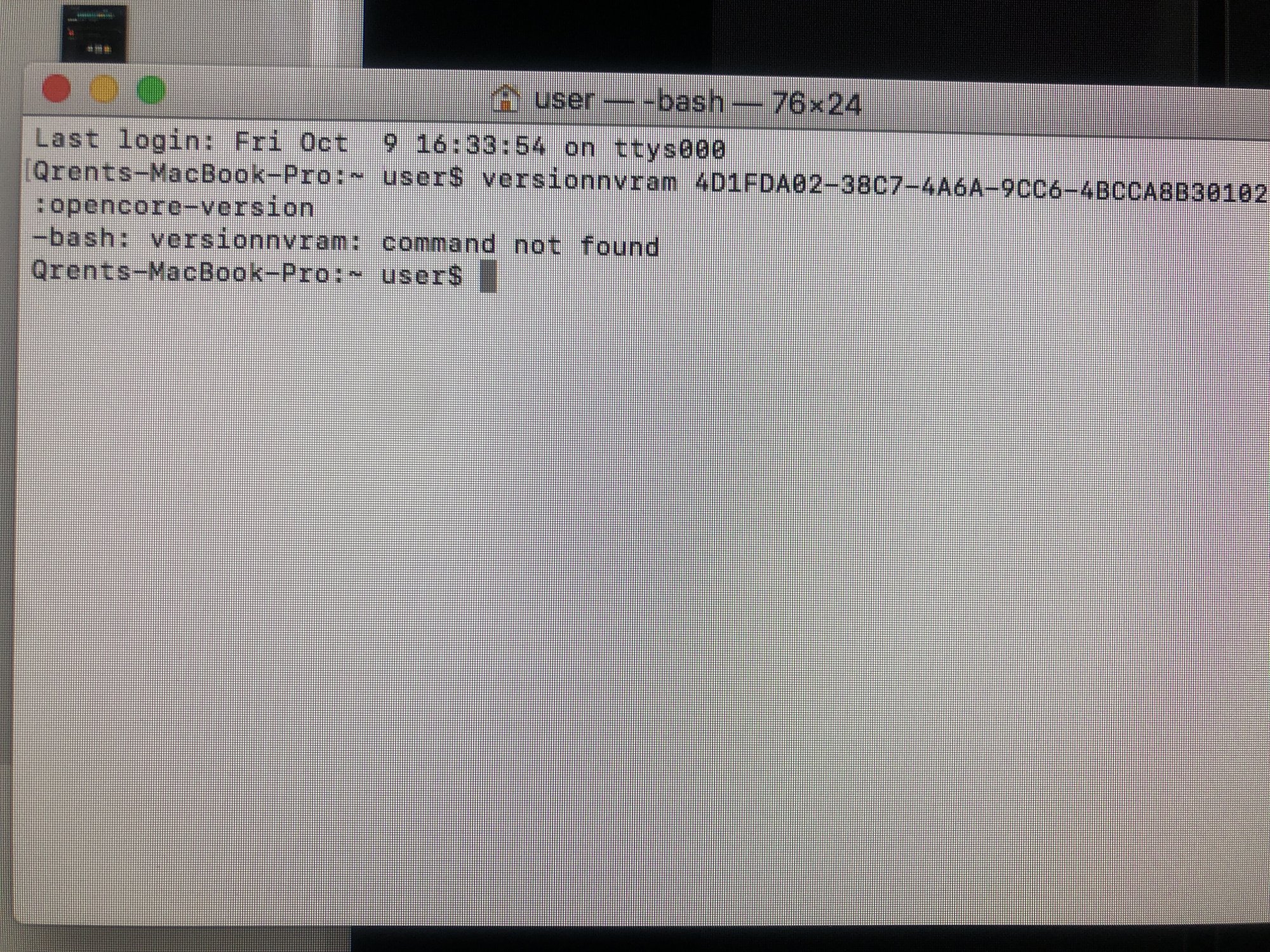

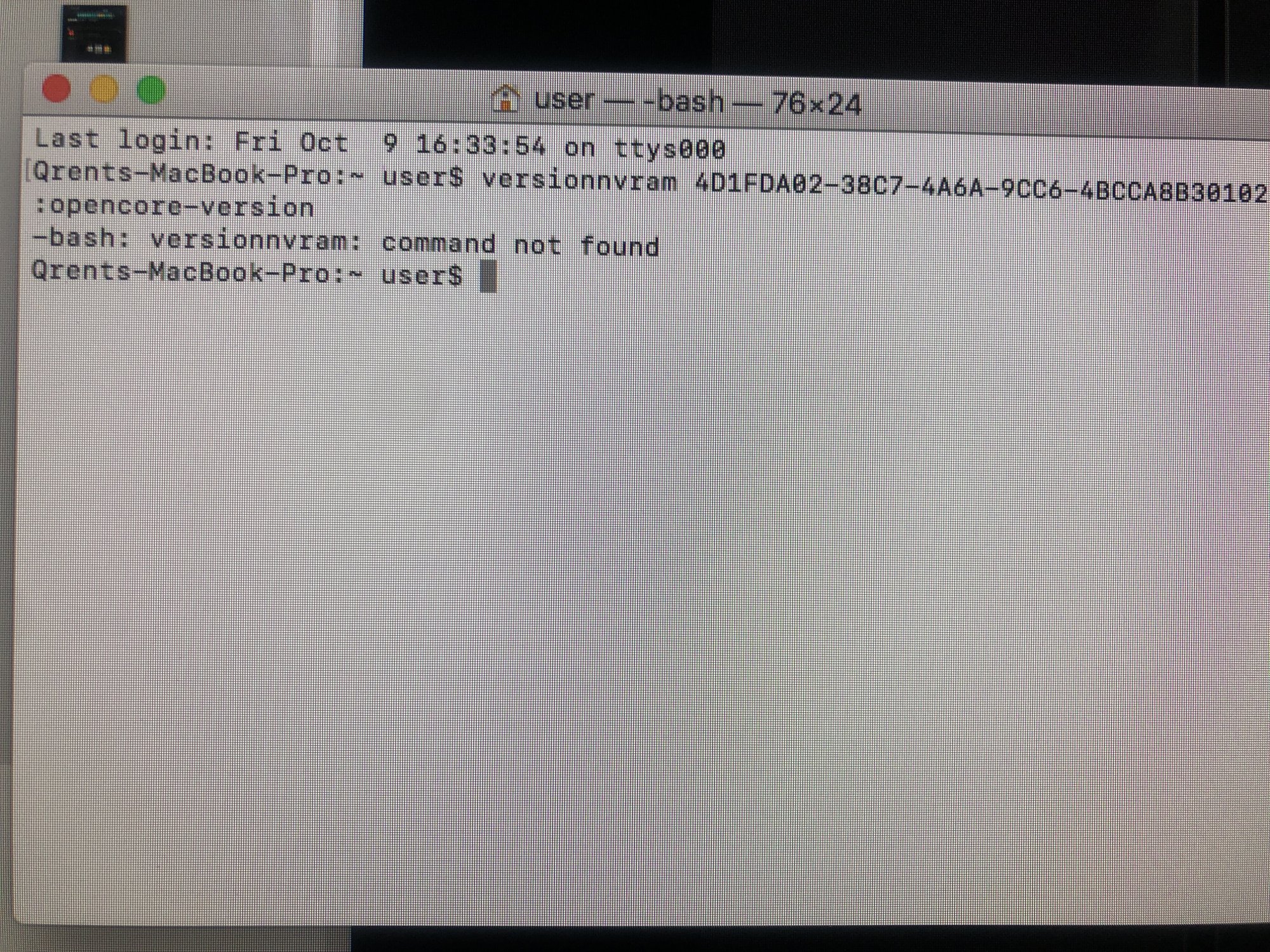

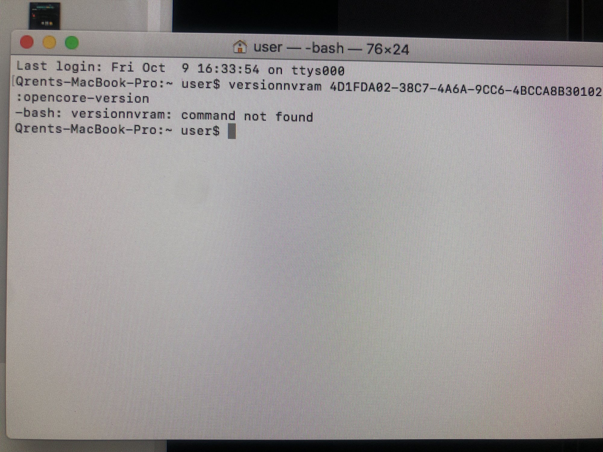

Thanks for helping me so far. Just one more thing. I have managed to bless and it didn’t give me any errors. I just see any errors SMC. I have the following error when trying to see the open core version.
remove versionnvram and leave only nvram 4D1FDA02-38C7-4A6A-9CC6-4BCCA8B30102:eek:pencore-version
@Mogale use this:
Code:
nvram 4D1FDA02-38C7-4A6A-9CC6-4BCCA8B30102:opencore-version
Copy and past that code into terminal.

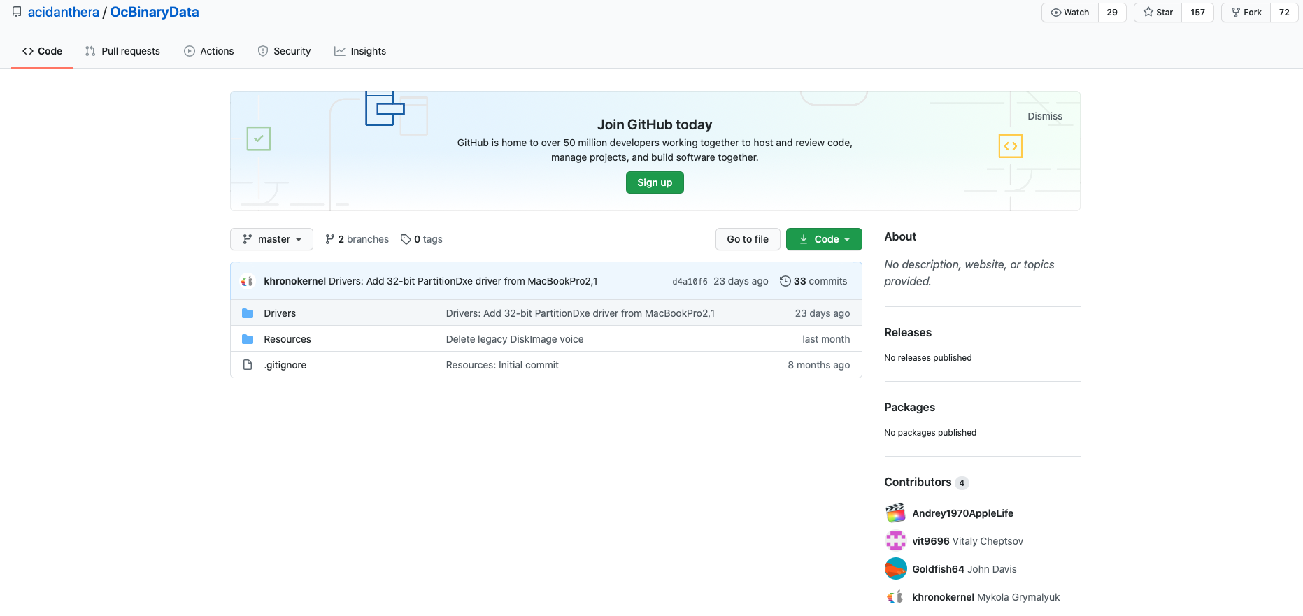

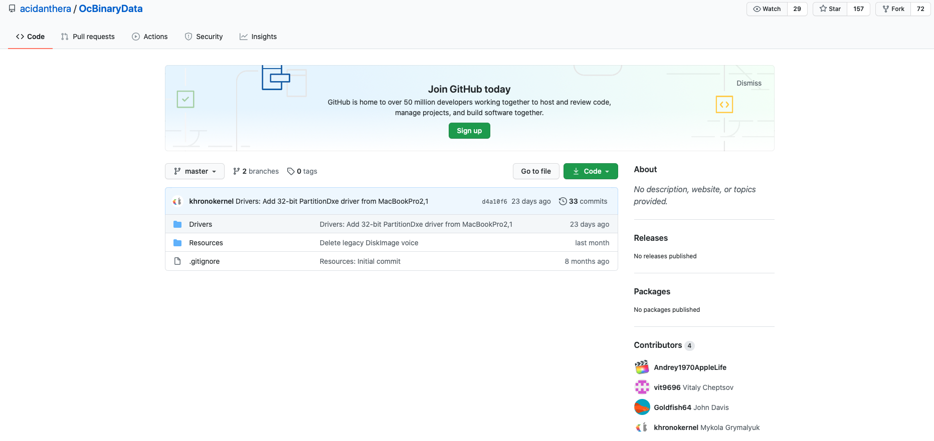

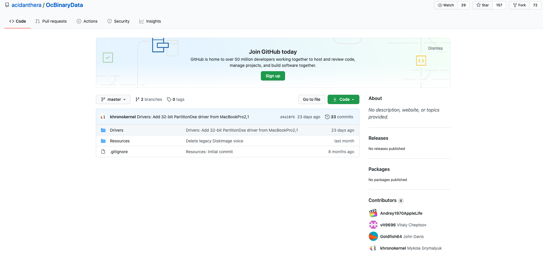

I'm trying to enable the graphical boot picker but can't find the ZIP. The link brings me to this page. Where can I find the the OcBinaryData ZIP to download?
Just click on the green button “code” then choose “download zip “ or something very similar
This is now clarified in the guide.

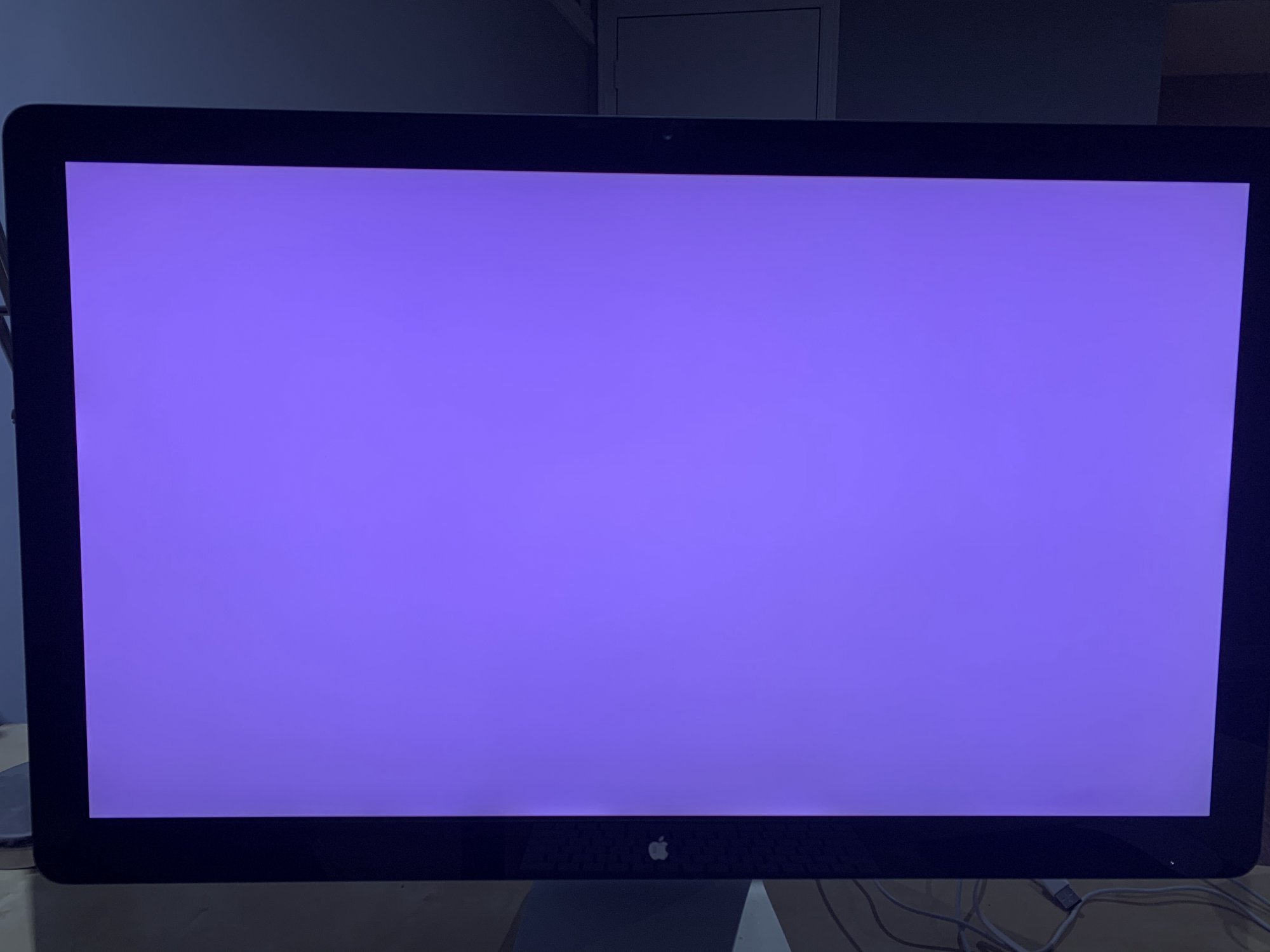

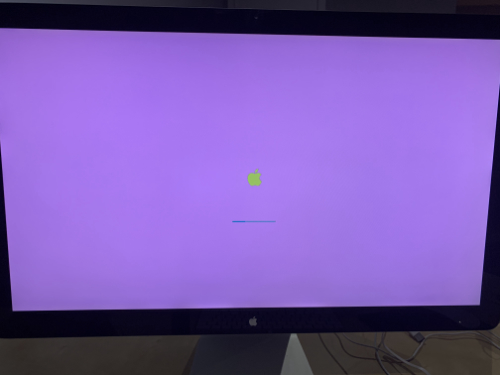

I am running into a few small aesthetic issues that if someone has a solution to resolve it would be awesome but if not then its an aesthetic issue so ill just deal with it.
I followed the basic installation parts 1 - 5 to the letter in post #1. and I also Enabled the Graphical Boot Picker in "Part II Advanced Configuration".
When I boot up the Mac the wild and negative colours appear on boot. Much like when I first installed OpenCore. I can make out that the Graphical Boot Picker is working but those pinks and yellows and rainbow spectrum colours don't look the greatest. Once I select the Boot Drive the Black screen with the white apple logo kicks in and everything is fine from there on.
I went and repeated all the Post Install actions again (made sure the changes were correct) I even re enabled some like HiDPI Display, GOP Renderer but reboots with those reverted were still the same.
Could someone let me know if the initial boot screen is supposed to be crazy colours and if not if you have any suggestions on what the issue might be that would be awesome.
End of day though is a small aesthetic issue when I first boot up so if that's just how it is I won't complain.
Awesome Job once again :D
Edit: Attached are photos of the screens I see in order, Ive seen this (Apart from the Graphic Icon of the Boot Drive) on boot up ever since going to Open Core (incase that in itself is unusual). a second after the last photo in the series it goes to the black apple boot screen for a second before logging into Catalina
