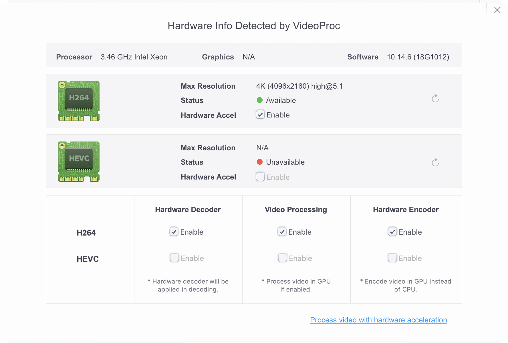

First test is done, I am able to rename PXS1 to GFX0. So, the code in post #31 is correct.

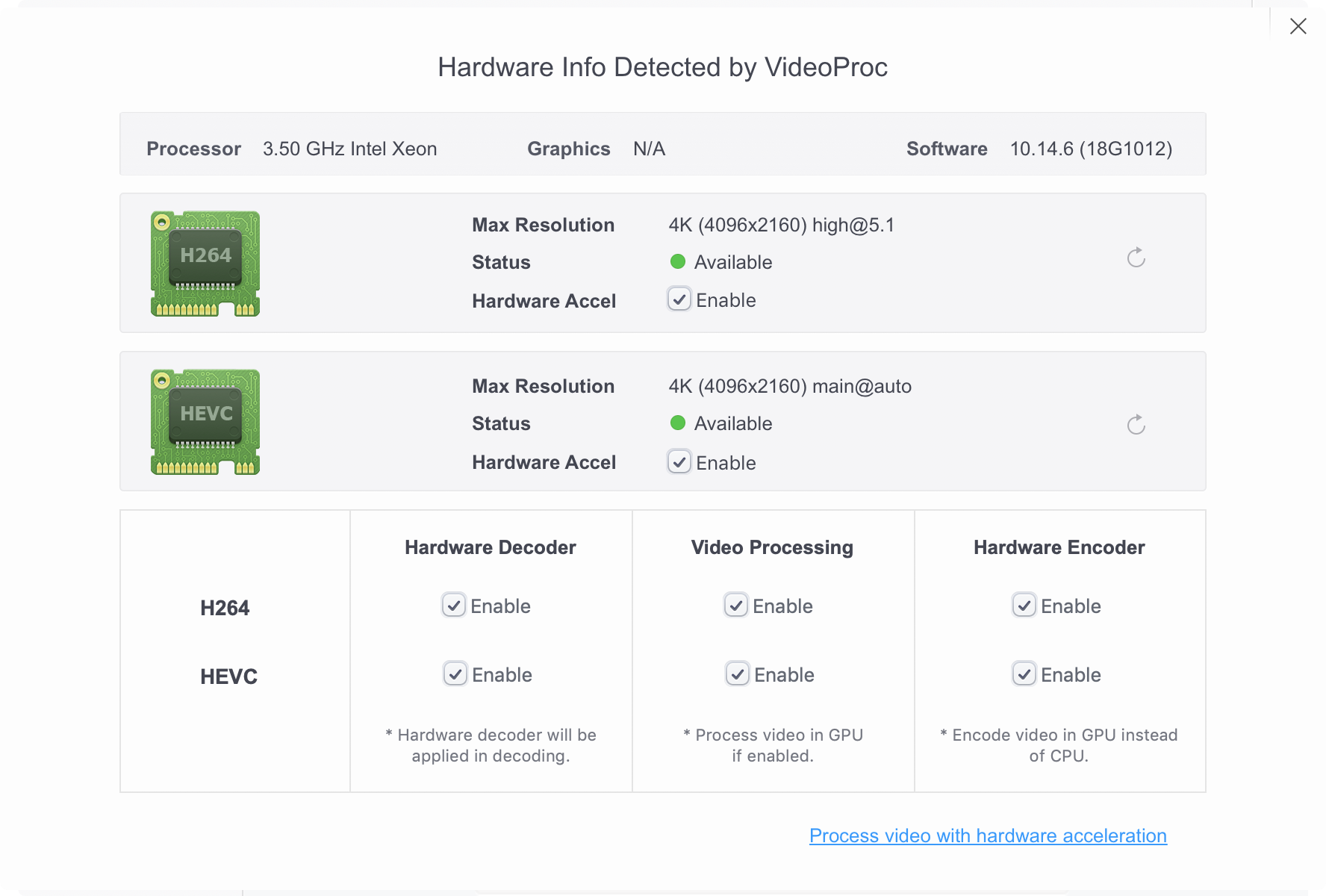

This test use the cdf default config + GFX0 patch, so, still ident as 5,1. With the hex edited AppleGVA framework, HEVC encoding still not available yet.

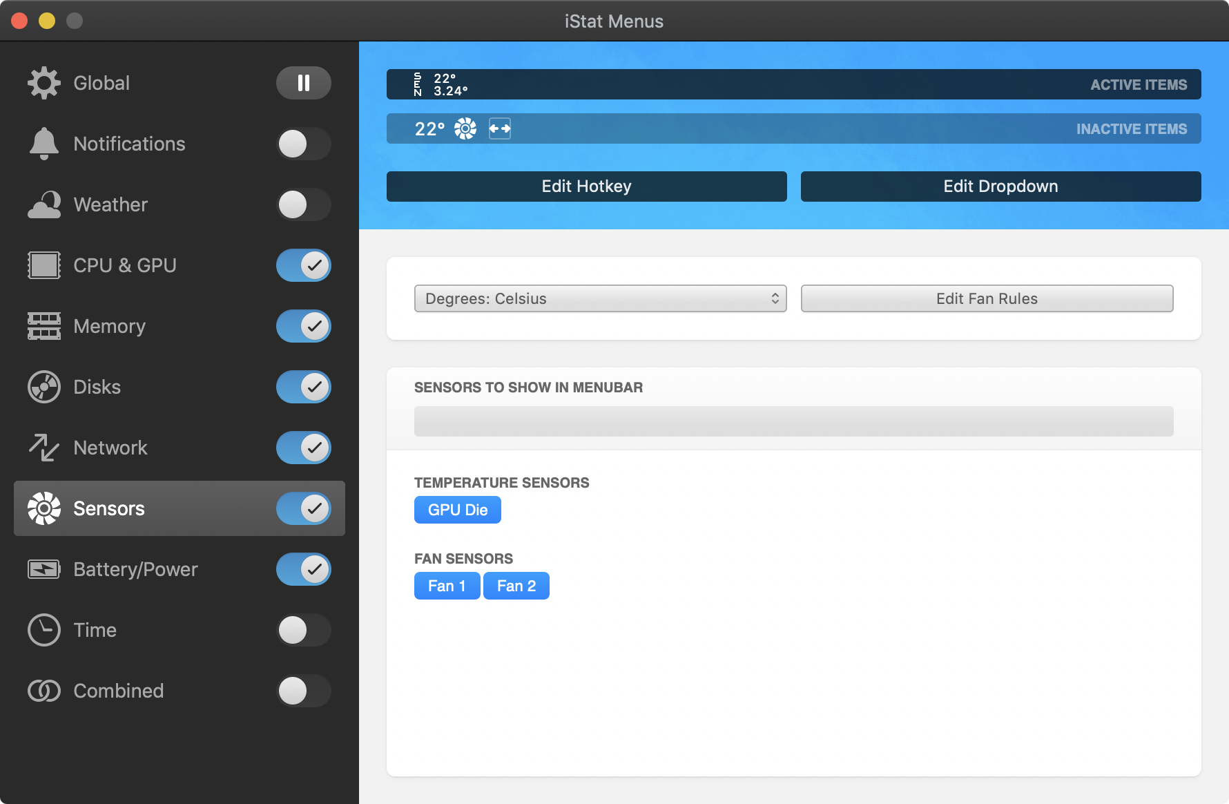

And now, it's time to fix the SMC issue (if ident as iMac Pro)
(Update 1: the two fans are the PSU fan, and PCIe fan. Max RPM shows up correctly in iStat menu. And will spin up accordingly when I stress the GPU.
All the missing fans are for CPU. Intake, Exhaust, Booster)

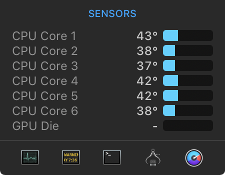

Get the CPU sensors back by using VirtualSMC, and even better, I can now see the temperature for every single core. However, lost all other sensors 😆

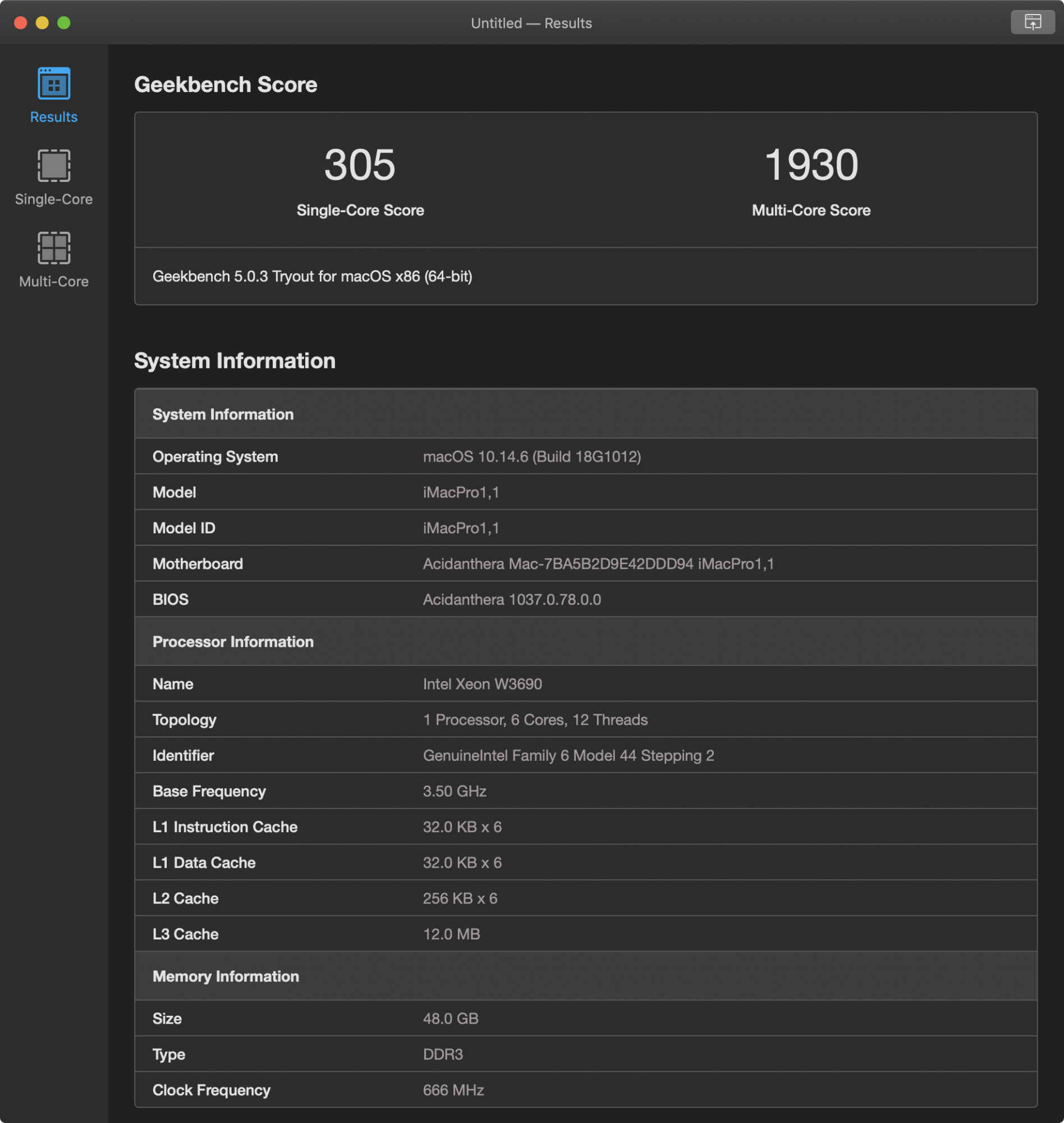

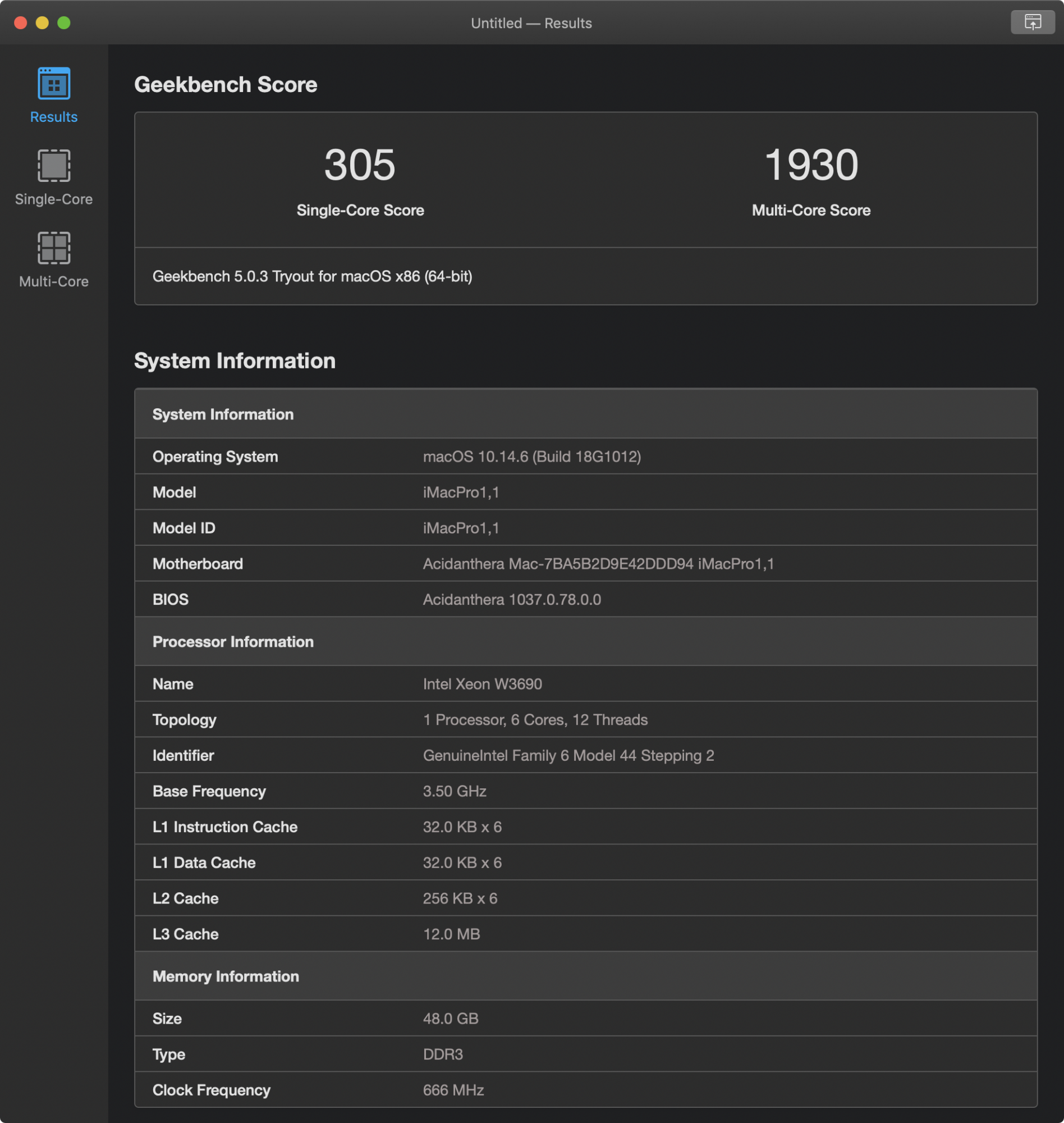

More issue found when ident as iMac Pro. The CPU only work at ~50% speed.
Not sure if it's SMC related. Or due to the computer now can't ident the CPU correctly (the CPU name came from my info edition, not from the system natively), and the Base Frequency is wrong obviously.
Nice problem there, hope you figure it out as it makes a 3,1 faster than your 5,1 according to a benchmark. Mine was 467/2820
I've observed the same thing about the frequency when OpenCore sets the platform information.

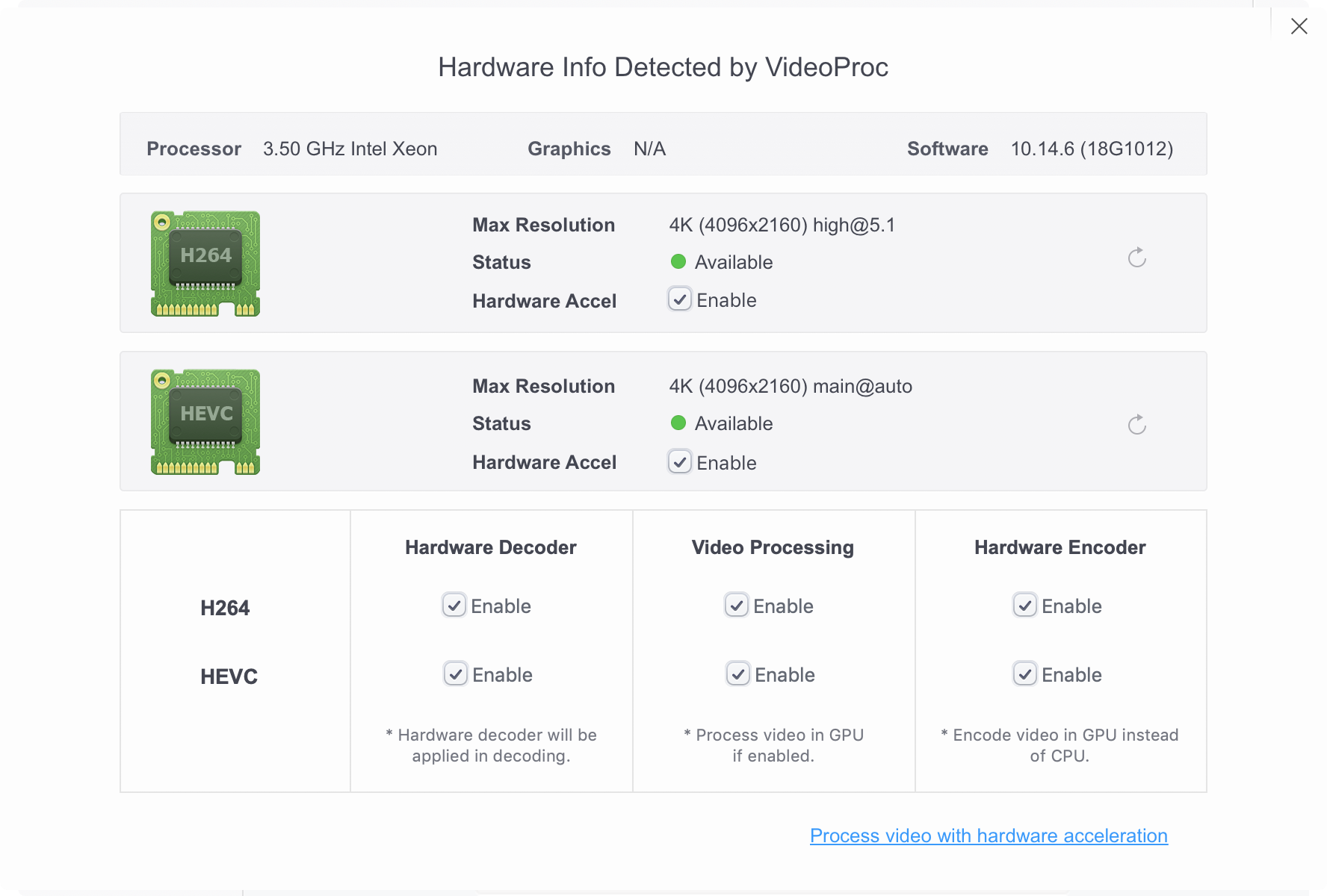

@h9826790 Try using original SMBIOS and set those boot args for whatevergreen:
shikigva=32 and shiki-id=Mac-7BA5B2D9E42DDD94
This spoofs iMacPro1,1 SMBIOS only for the AppleGVA framework to enable HEVC while the remaining components operate in your Mac Pro SMBIOS as intended.
Good idea. Tested with shikigva=96 and shiki-id=Mac-7BA5B2D9E42DDD94, doesn't work, but I forget to test 32 or 1......
Is opencore flexible enough to not set CPU related info?
The setup described in post #1 does not touch platform information at all. Most would be hard pressed to find differences between such a setup and a natively booted one.
Modifying the SMBIOS in automatic mode is what seems to lead to the wrong frequency. Perhaps manual mode gives more control. This remains to be tested.
