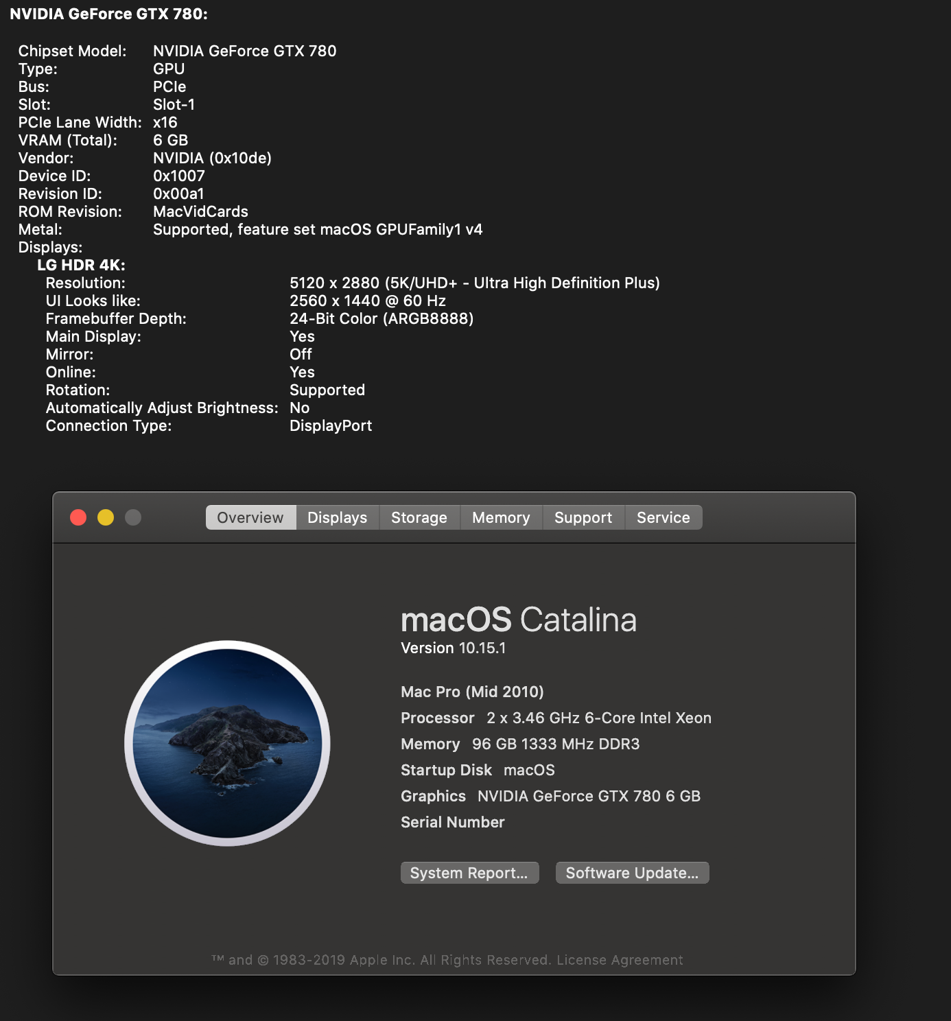

I started fiddling with OpenCore in more depth including the very useful command-line-tool and OpenCore configurator. It requires full knowledge of config.plist options as 10.15.1 did not resolve the disabled DisplayPort issue which is plaguing supported and unsupported macs under Catalina. Not sure if you are experiencing the same issue with your VII.
@Starplayr believes this may be a security restriction as some users managed to get their DisplayPorts working again once screen recording permission was given to vendor drivers or that Apple is intentionally restricting DisplayPorts on certain configurations. As for him, he managed to get his DisplayPort working again by changing the board-id of his cMP 3,1 to an iMac late 2009.
I'll post an update if I manage to get the displayports working again using OpenCore.

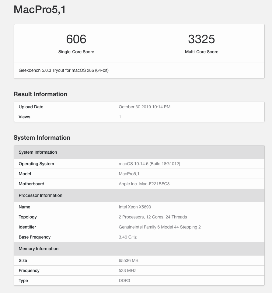

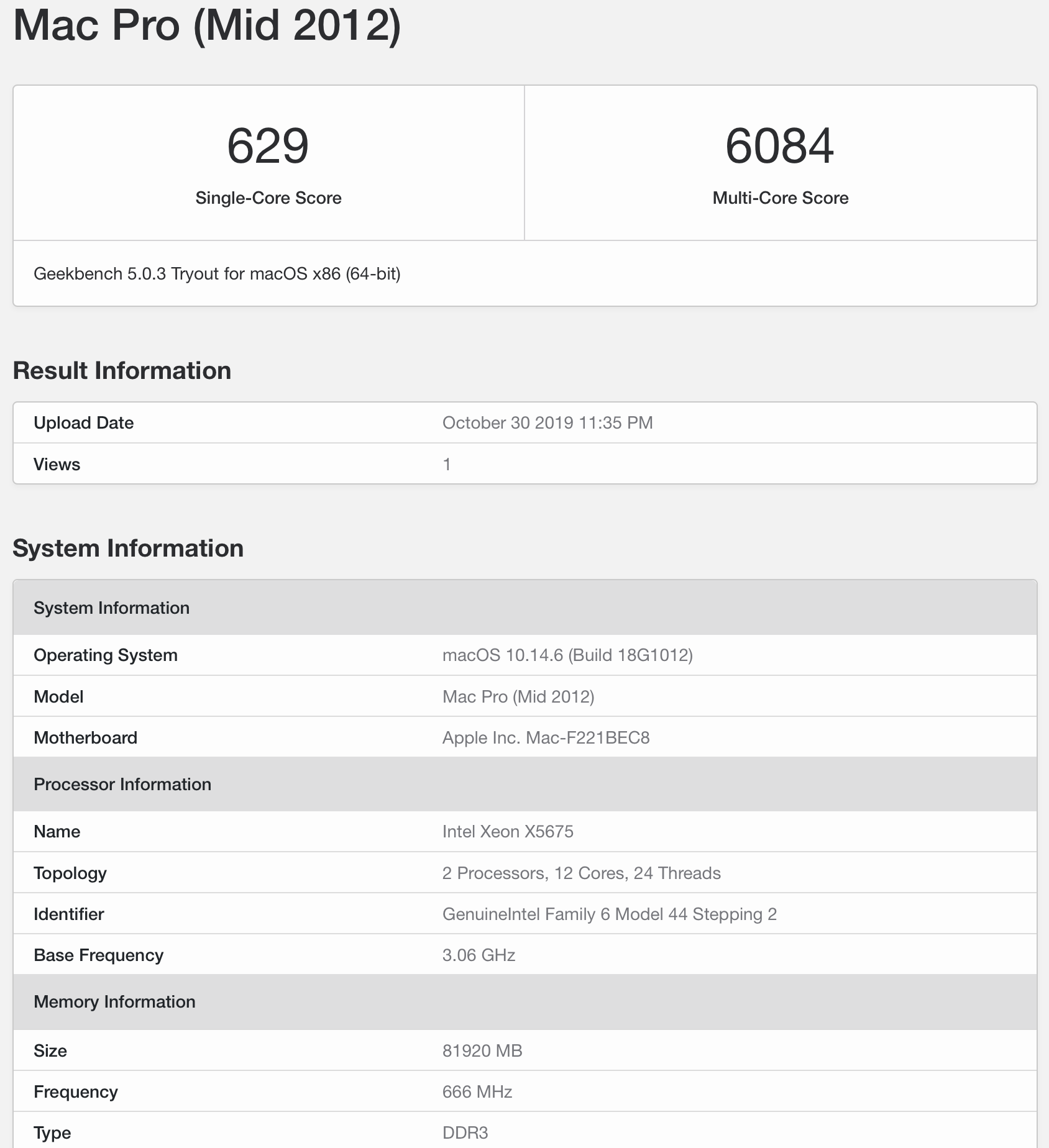

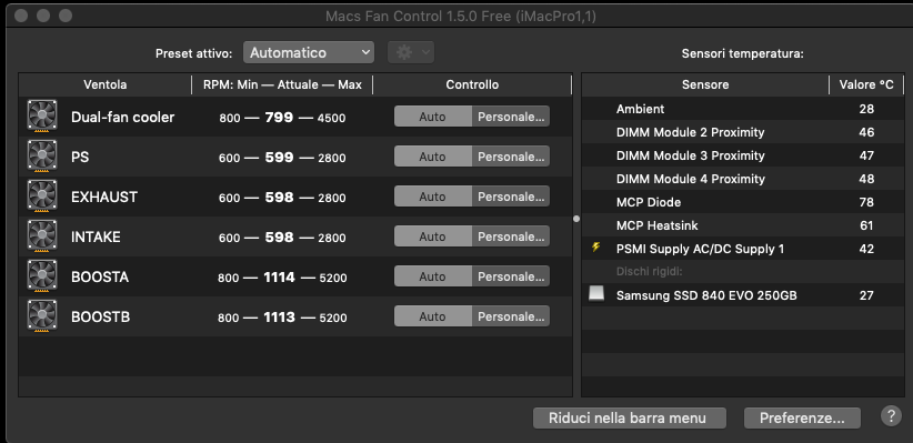

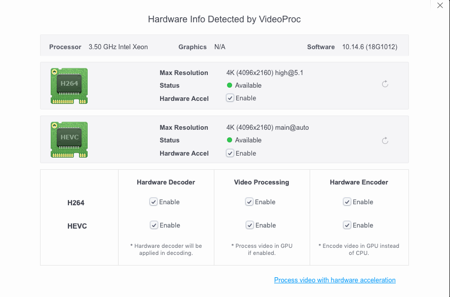

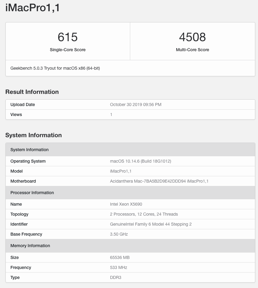

So i tested today opencore, thanks this forum.
Work fine h265 decode/encode very fast in Davinci resolve. WOw
Geek , before OC i have (mac pro 5,1) about 3300 after i have (imac1,1) 4500 nice improvement.
I should try to put ddr3 at 1333 and not 1066 maybe the 5000 reach them.
Fan work well under pression.

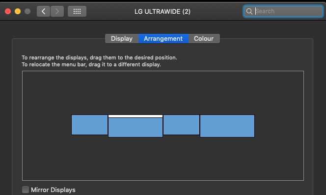

Only not work now is DP port, only 1 work.
any ideas to activate the other DP ports?
Please re-read all CMMChris’s posts, he covered that a few times already.

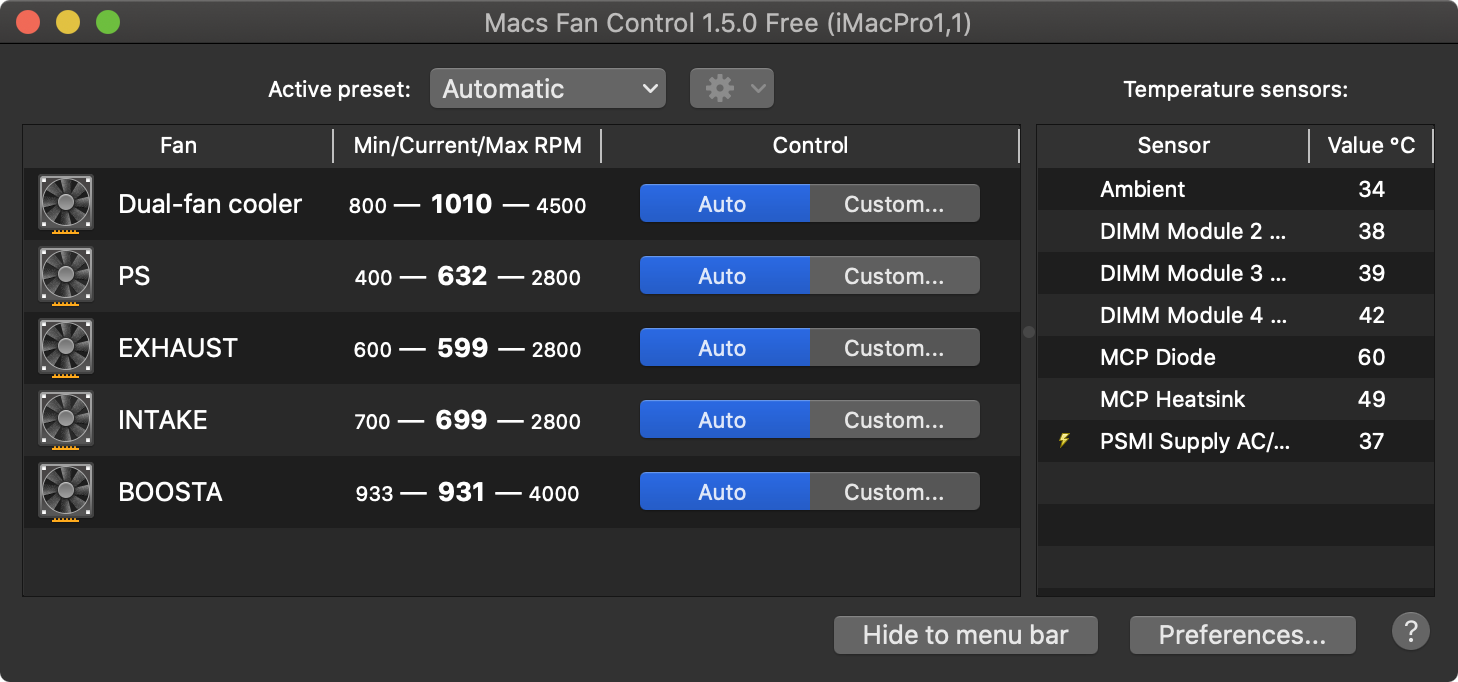

Anyway, it’s interesting that your CPU performance is improved. Also, can see all fan sensors. My be I should try MFC.
[automerge]1572476599[/automerge]
I just confirmed that MacsFanControl can see all the fans, and control them properly. It's just iStat menu cannot read them when I spoofing the iMac Pro 1,1 SMBIOS.
Reactions: octoviaa

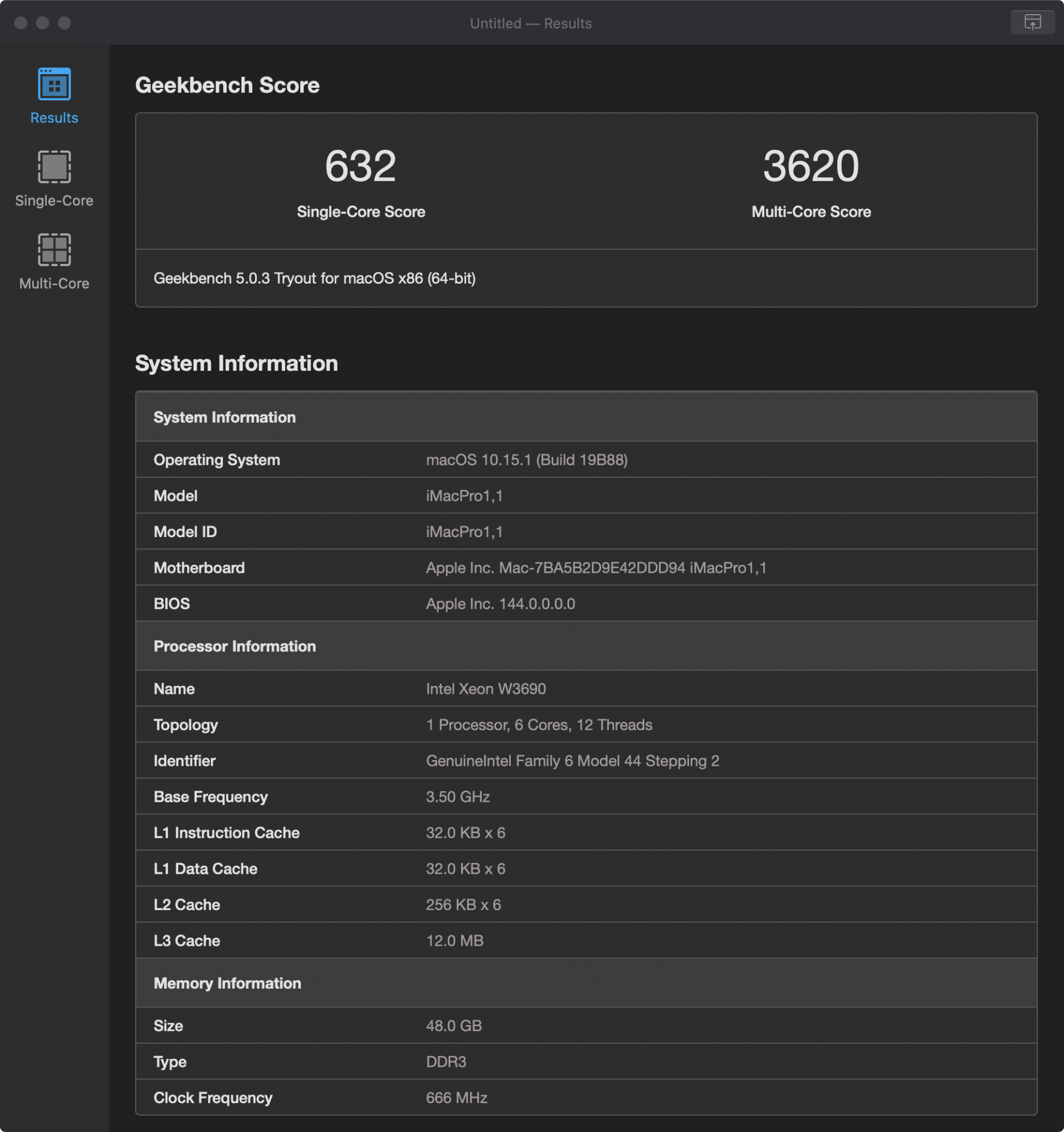

I also found the root cause of the CPU performance issue.
That's completely my mistake, I disabled the VMM flag, which cause the CPU performance drop by ~50%.
Once I turn it back on, CPU performance back to normal level. (I did quite a few things when benchmarking. So, the scores isn't that high, but at least, back to the normal level. That's all I want to see)

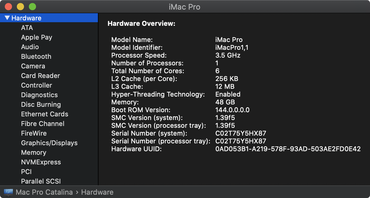

In fact, manual mode PlatformInfo also work. My Mac can now boot as iMac Pro ident, but still with the 5,1 BootROM and SMC version.
I can set FSB in the config.plist etc. But since the CPU performance is normal. I prefer not to touch it now. I don't care about the incorrectly reported Processor Speed, as long as that's cosmetic, and no real disadvantage.
