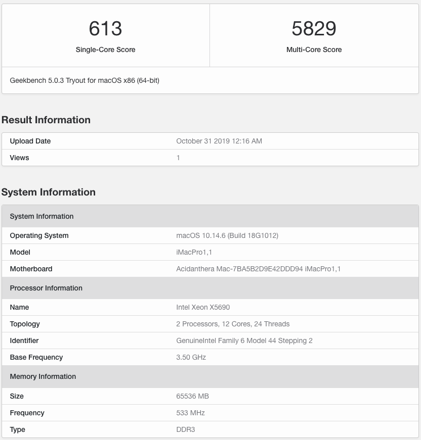

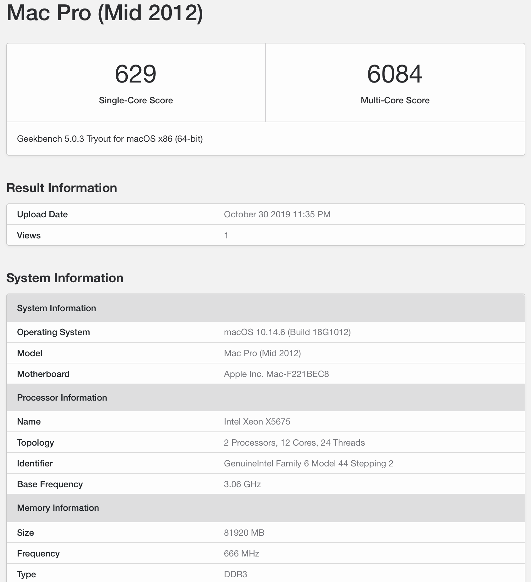

@gigignopechegno seems weird to me, my multi-core is almost twice of yours while using slower proc.
I haven't use OpenCore yet.
Uh, you have double the processors.
Edit: And just about double my score with a single x5675...

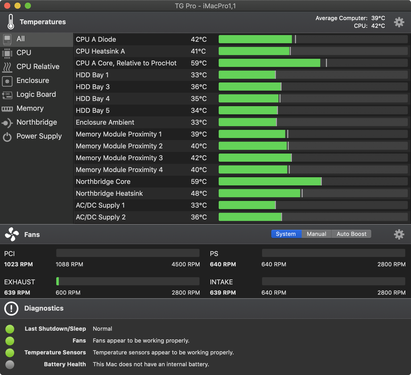

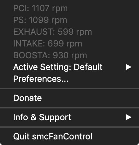

smcFanControl also work. So, it's just iStat menu can't see the fans
And smcFanControl can also display my CPU temperature on the menu bar. So, those sensors are actually working, just depends on if the software can get them correctly.
I'm comapring with the same 2 proc.
Anyway h98 and gig confirm their score is back to normal now. So at least we don't have to worry about OpenCore reducing the performance.

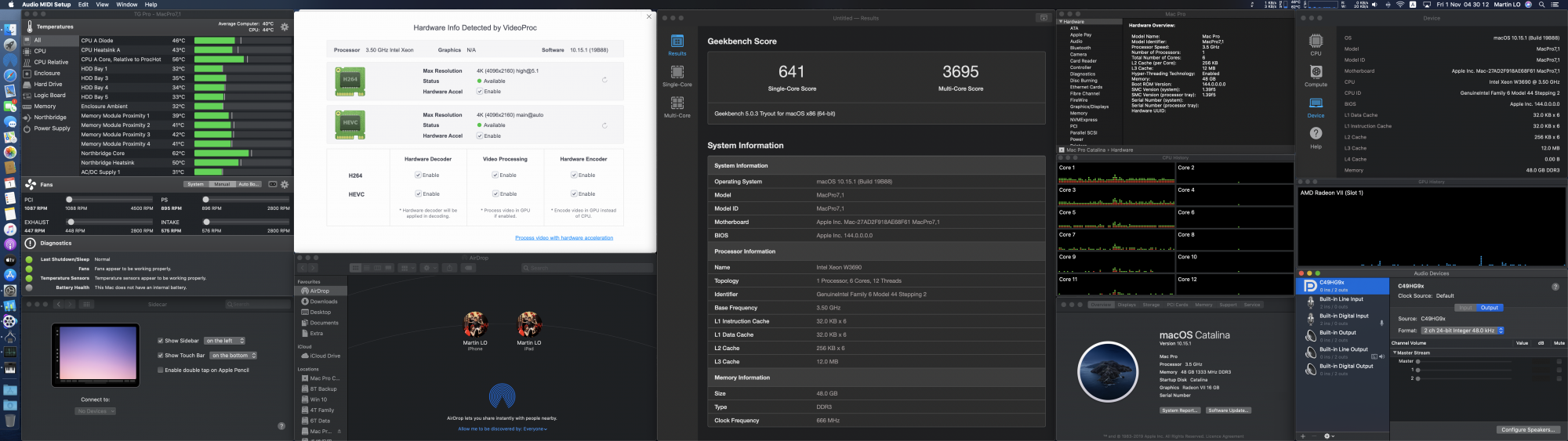

Yeah, I am very happy with the setup now.
I can now have full HWAccel. Most likely the Airplay Display will also work, but I can't test it yet.
CPU performance normal, and I can see the CPU diode temperature.
Fans normal, and I can control them via smcFanControl (MacsFanControl also work).
Even though it's not the best solution (not ident as 5,1), but at least everything work.
Most likely I will keep this as my final config (for Mojave).

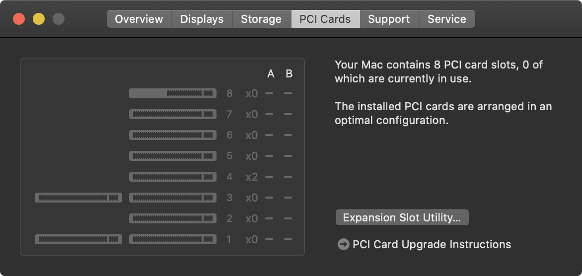

For Catalina, I prefer use the Mac Pro 7,1 SMBIOS more. So, all Display ports can work without patching. Also, I love to see the computer still ident itself as Mac Pro, and love to see that PCIe Cards page in About This Mac 😀

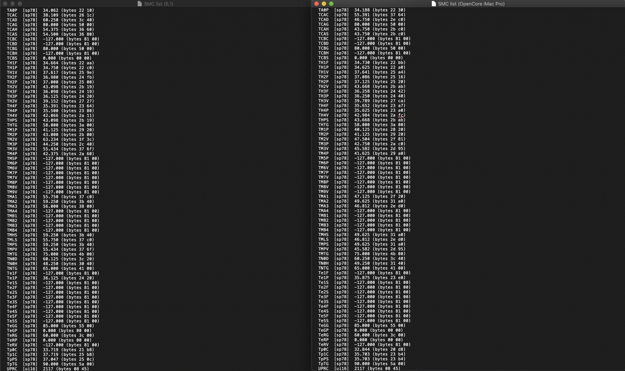

Anyway, for the "sensors issue". I am now 100% sure it's just the 3rd party software (e.g. iStat menu) cannot read them properly.

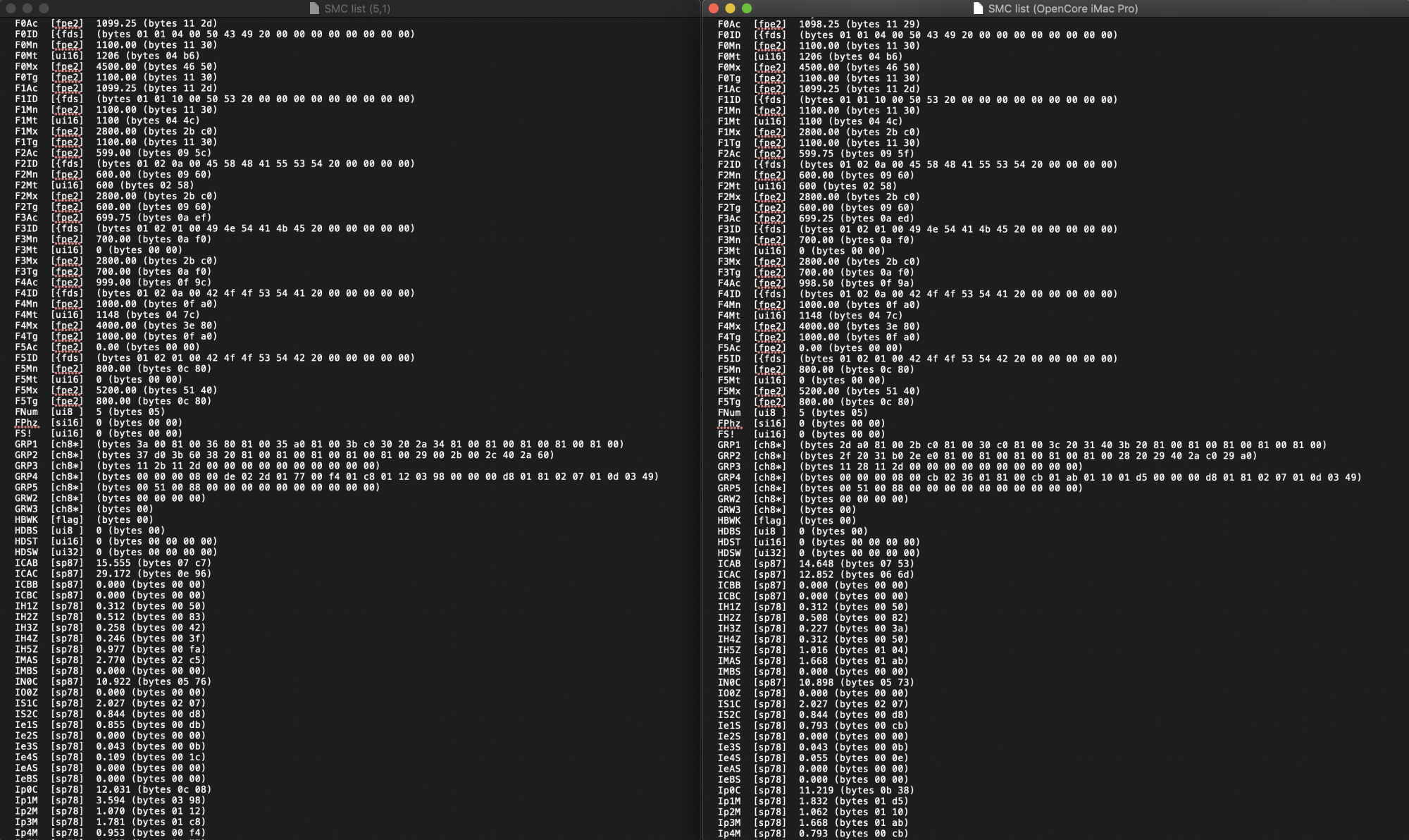

When boot as iMac Pro, I can still access the complete SMC key list with all valid value (and control them).
I dumped the SMC list when boot at 5,1 (natively), and another dump when boot as iMac Pro via OpenCore. The temperature SMC key lists are identical (of course, the values can be different. That's the associated temperature at that moment)
Same thing observed for the fans SMC keys. And as you can see, I want the NorthBridge to run cooler, therefore, I set F4Mn (Booster A fan minimum speed) to 1000, which keep TN0D (NorthBridge diode temperature, from the above screen capture) at ~60°C.
So, at least we know all the sensors work. No need to worry about that.

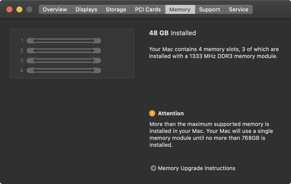

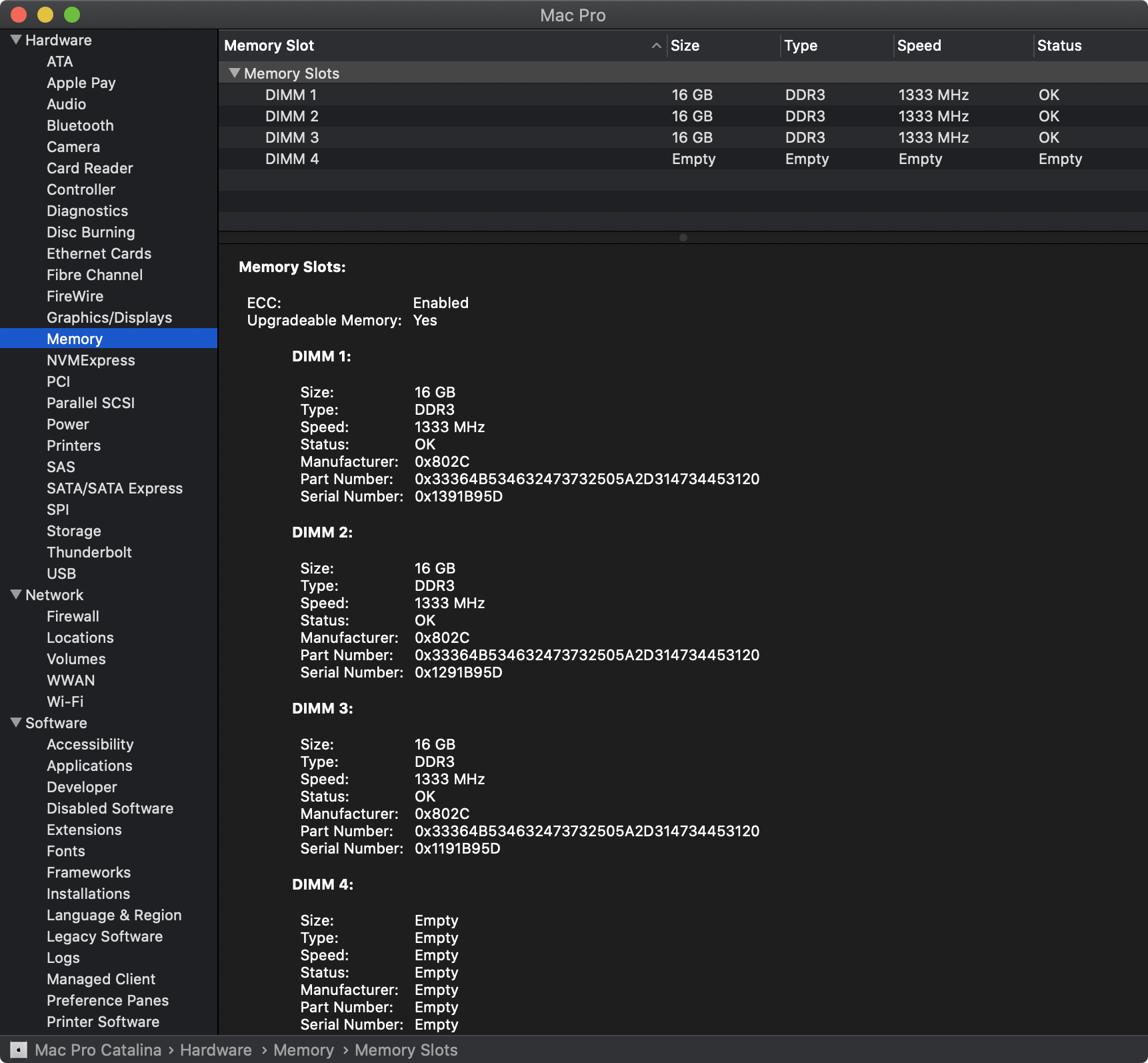

Anyway, there is a warning in the Memory tab.
But I am quite sure that's just cosmetic error.
