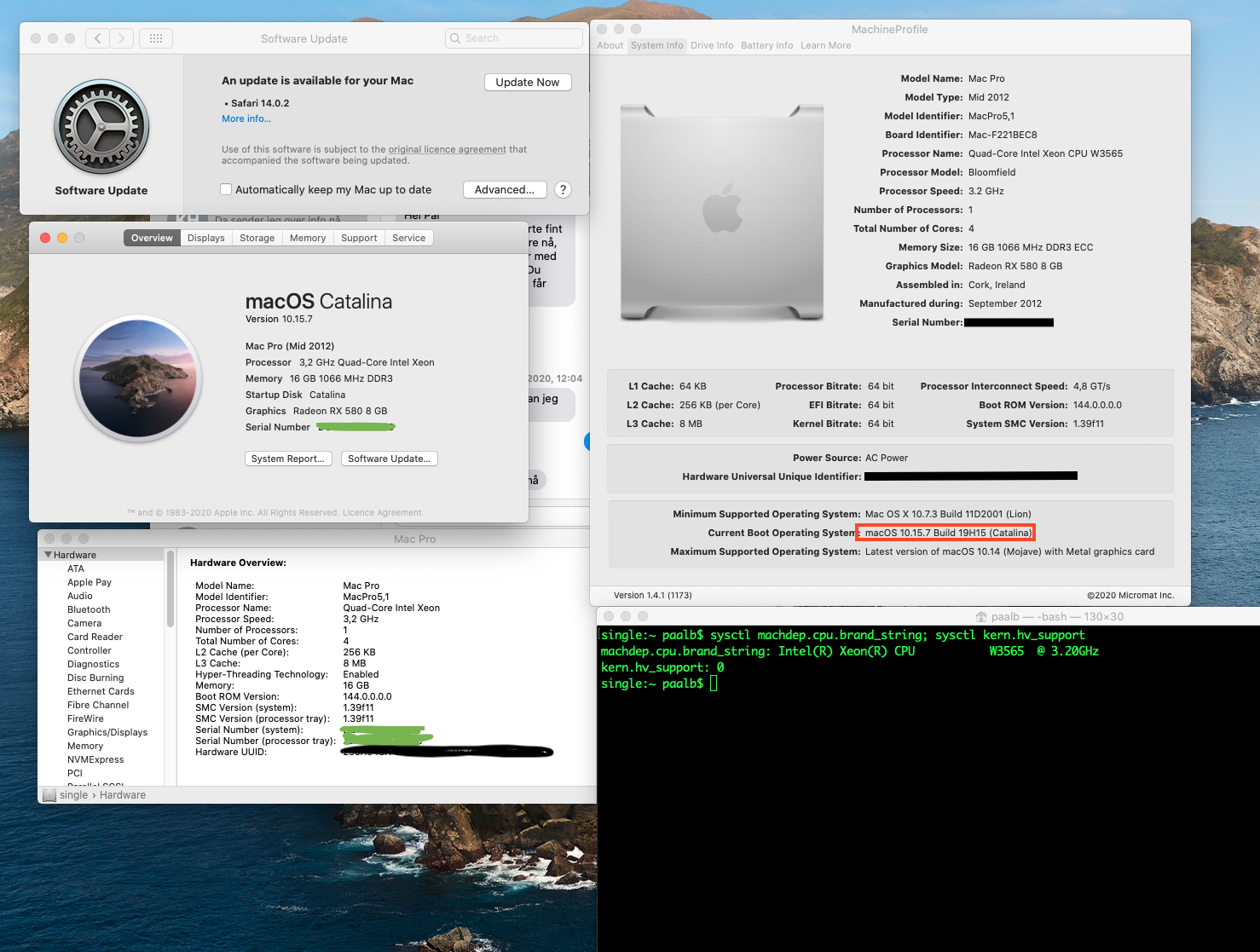

So, that means that - taking the sample info.plist from the guide on the first page - I do absolutely nothing regarding PlatformInfo etc, i.e. leave all as it is?
@frankiee, the sample config in the guide has the VMM flag pre-enabled; you should turn it off for your machine.
Hmm in the mentioned info.plist there is <00000000000000000000008000000000> for both Cpuid1Data and Cpuid1Mask. So I leave Cpuid1Data as it is and change Cpuid1Mask to AAAAAAAAAAAAAAAAAAAAAA== ??
Sorry for the dumb questions, I basically have not too much of an idea what I am doing ...
Reactions: Eschers
Yes, that will work. Alternatively, since you probably will not use the VMM flag at all, you can just make the fields blank:

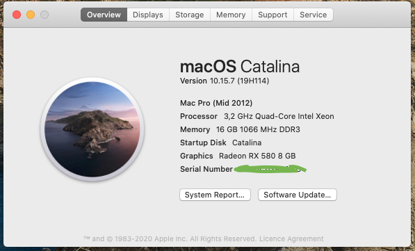

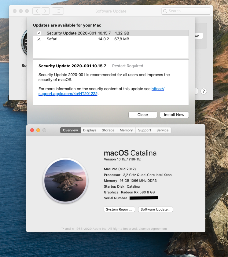

Single CPU 5,1 with Nehalem. Security Update Catalina.
Changed the VMM flag and did start the update from System Prefs >Software Update. Update went without a hitch.

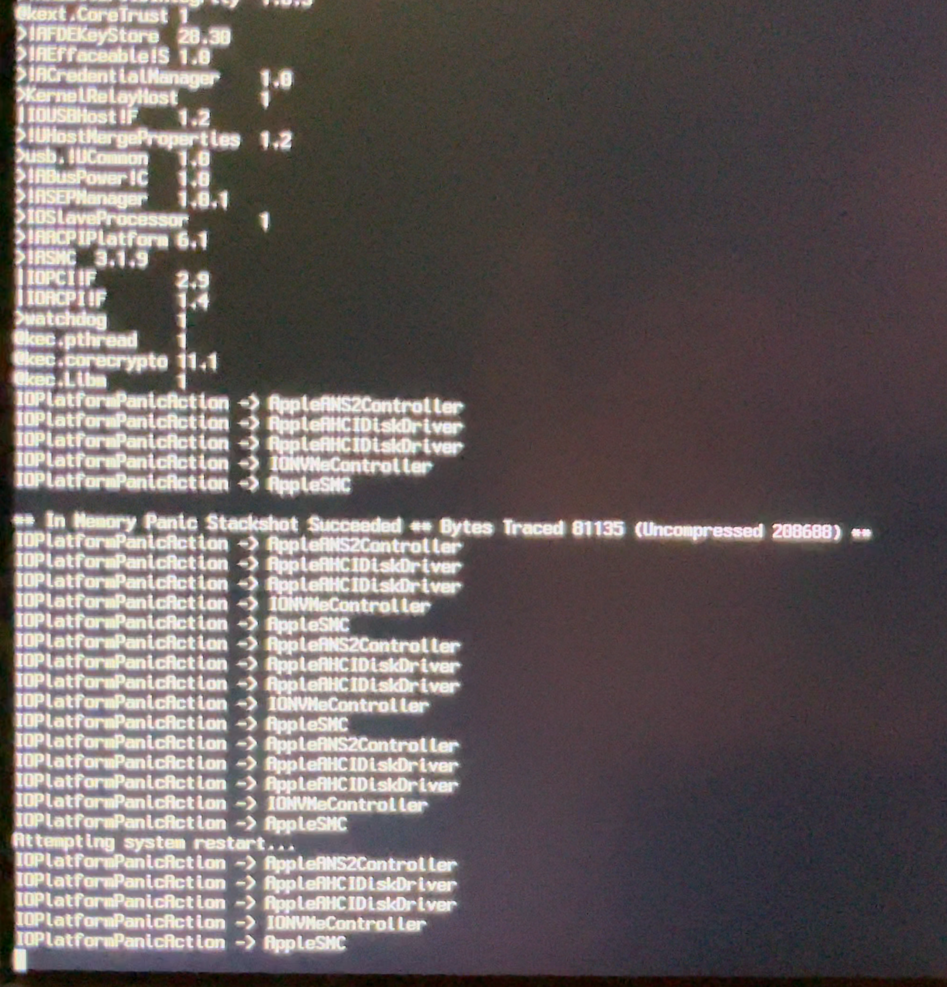

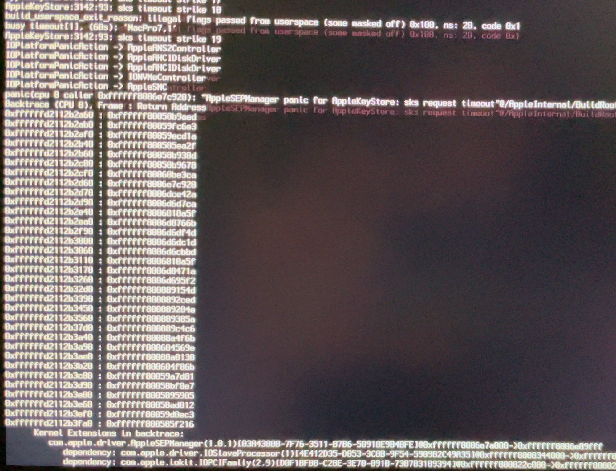

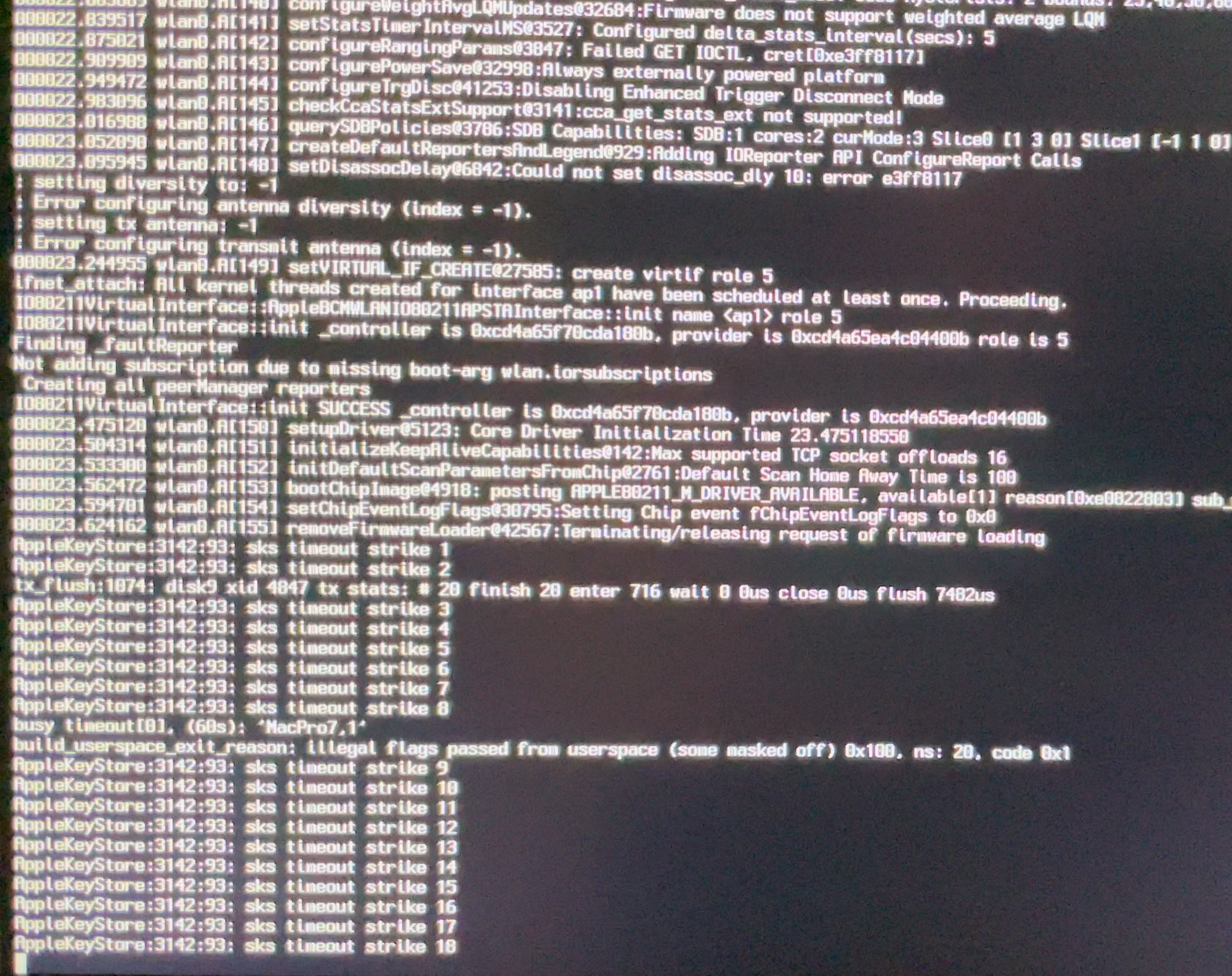

Okay, so I followed the guide (using an external SSD with Big Sur), using the sample config.plist and like cdf recommended I left the fields for Cpuid1Data and Cpuid1Mask emtpy (but maybe this is the culprit?)
I was being able to see the OC boot menu, and Big Sur does start booting, but at one point the machine just shuts down.
I have managed to get some screenshots with verbose mode, and it looks like there is first some messages stating "sks timeout strike", also causing a delay. Then, some messages about some illegal flags and finally a KP, apparently coming from "AppleSEPManager".
I get also this log when restarting again without OC:

Do you have Filevault enabled? Also remove the -no_compat_check boot argument.
@cdf, @tsialex. You guys are great at what you do and have done for the cMP. I appreciate the responses and I'll continue with questions as they arise. I think the monkey wrench has been tossed, though. Has anyone looked at the patchers out there that are available? Can they be streamlined into the OpenCore process? The good about Mojave is it boots on its own. Catalina can with @dosdude1 install, but it is so limited. Applying OpenCore to that is just a waste since they don't vibe well (updates). Now we have the newbie on the block and want to make it work. I don't think it will be stable for all. The cMP is being forced out at this point and Apple is doing that to support the nMP sales.
Just above my statements sits @startergo saying to remove no_compat_check. I think that multiple OSs aren't available to us since BS. It's stick to this or that. Make a choice is basically the given. I love Catalina with OpenCore. It works and is functional. I have to admit I waited until the finalized version to use it because of the work being done here. You all did an outstanding job. My suggestion is to take post #1 and simplify it for all. The simple package in post #1314 on setting up HWA actually is a better way for the neophytes out there. You get a lot of questions from them and I never see anyone direct them to the easy way. Read post #1 is what I see. If they have a 3.1 no-one sends them to @Dayo posts. It's a learning curve even for you big brains out there. I've worked IT for years and can't stress more the simpler the explanation, the less questions asked.
This is not a rant. Just a statement. Do you really need BS (BS. That's funny.) just to prove it will run? I'll wait until this one is finalized and try from there. Let's not blow up our precious cMPs just yet. All I use this box for is a media center and menial communications. I'll buy a M1 or M2 soon to deal with the Apple future. Until this thing kicks it I will love it as always. Thanks for all your support and keep up the good work.
Filevault is not enabled. Also removed that boot arg, but unfortunately, still restarts when booting macOS.
The KP log seemingly points to a problem with the Secure Enclave / the T2 chip (AppleSEPManager) but of course I have switched off T2 security, or OC wouldn't be able to start up anyways.
Any ideas? I mean when people can run this on a T2 MPB, it also should work on the MP 7,1 right?

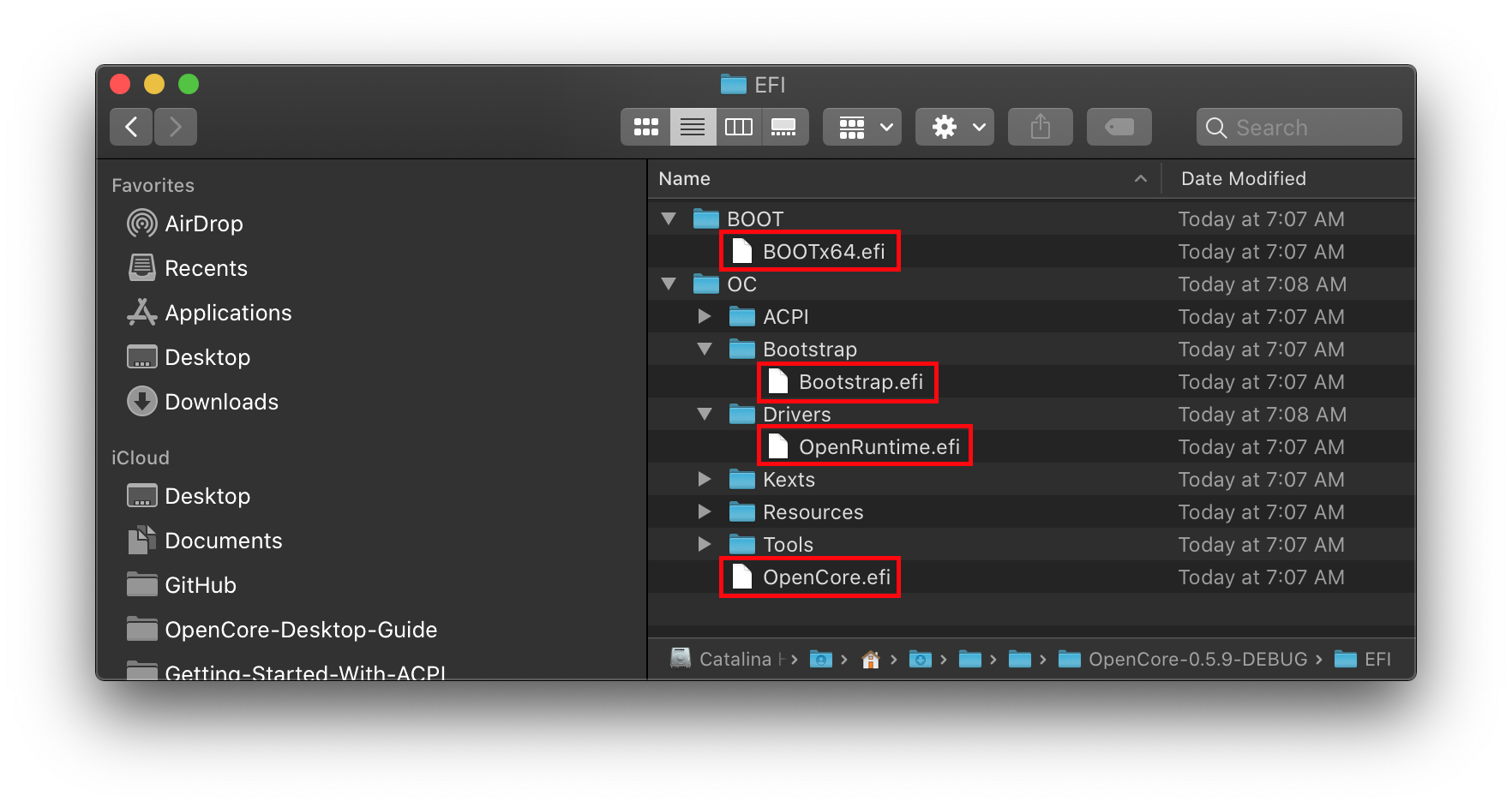

Try this config with a debug build.
The specific files that need to be swapped:
  • EFI/BOOT/
    • BOOTx64.efi
  • EFI/OC/Bootstrap/
    • Bootstrap.efi
  • EFI/OC/Drivers/
    • OpenRuntime.efi
    • OpenCanopy.efi(if you're using it)
  • EFI/OC/
    • OpenCore.efi
