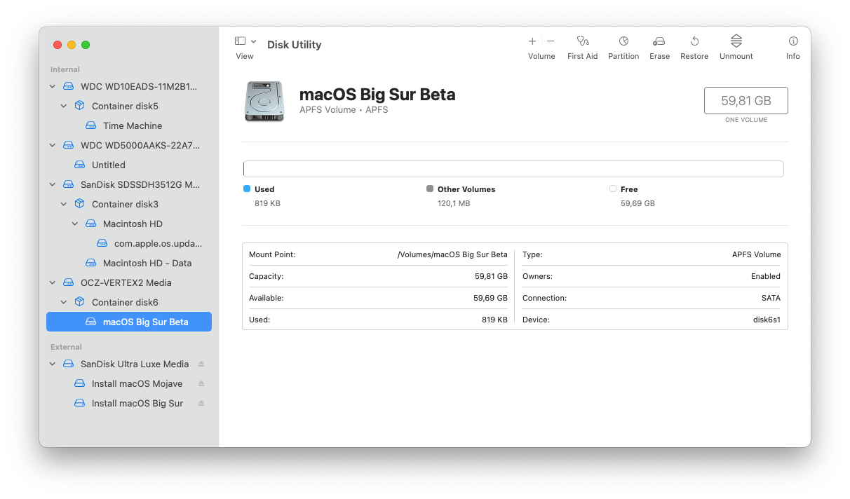

okay so I ran into a new problem. I tried to install macOS Big Sur 11.1 with a USB installer on a separate HDD. It did not worked for me, my cMP booted into the installation process just fine. However, the installation status bar did not appear ... after a short time the mouse cursor popped up on the screen for several seconds and then my cMP went off and everything started all over again.
I have waited an hour.
After that I also tried to install macOS Big Sur on a 60GB SSD, this did not work either. Same problem.
I did this with OpenCore 0.6.4 and the config from post 1 with the firmware features of the iMac Pro.
I also did this with the sample macOS Big Sur config from post #1,314 this also did not worked for me.
Does anyone know maybe what this is due to and maybe someone can try this as well?
Thanks in advance! 🙂
This will happen if the destination drive is formatted MacOS Extended rather than APFS.
Thank you for your reply!
Doesn't the installer actually format the destination drives itself to the appropriate format?
Anyways... I pre - formatted my destination drive (in this case the 60GB SSD) to APFS before I tried to install macOS Big Sur again but the problem occurs still.
Could you or someone else try it yourself to be 100% sure? Maybe it's a new problem in macOS Big Sur version 11.1 that needs to be fixed.
Could you maybe try it yourself to be 100% sure? Maybe it's a new problem in macOS Big Sur version 11.1, which needs to be fixed.
Should I maybe try to perform a full spoofing for the installation?
