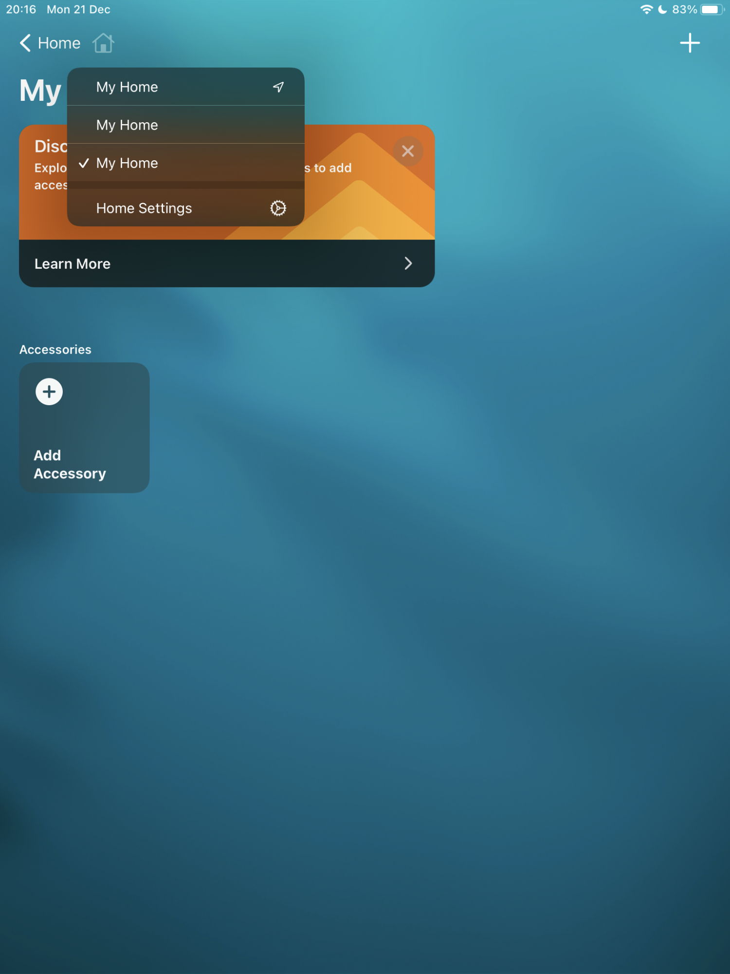

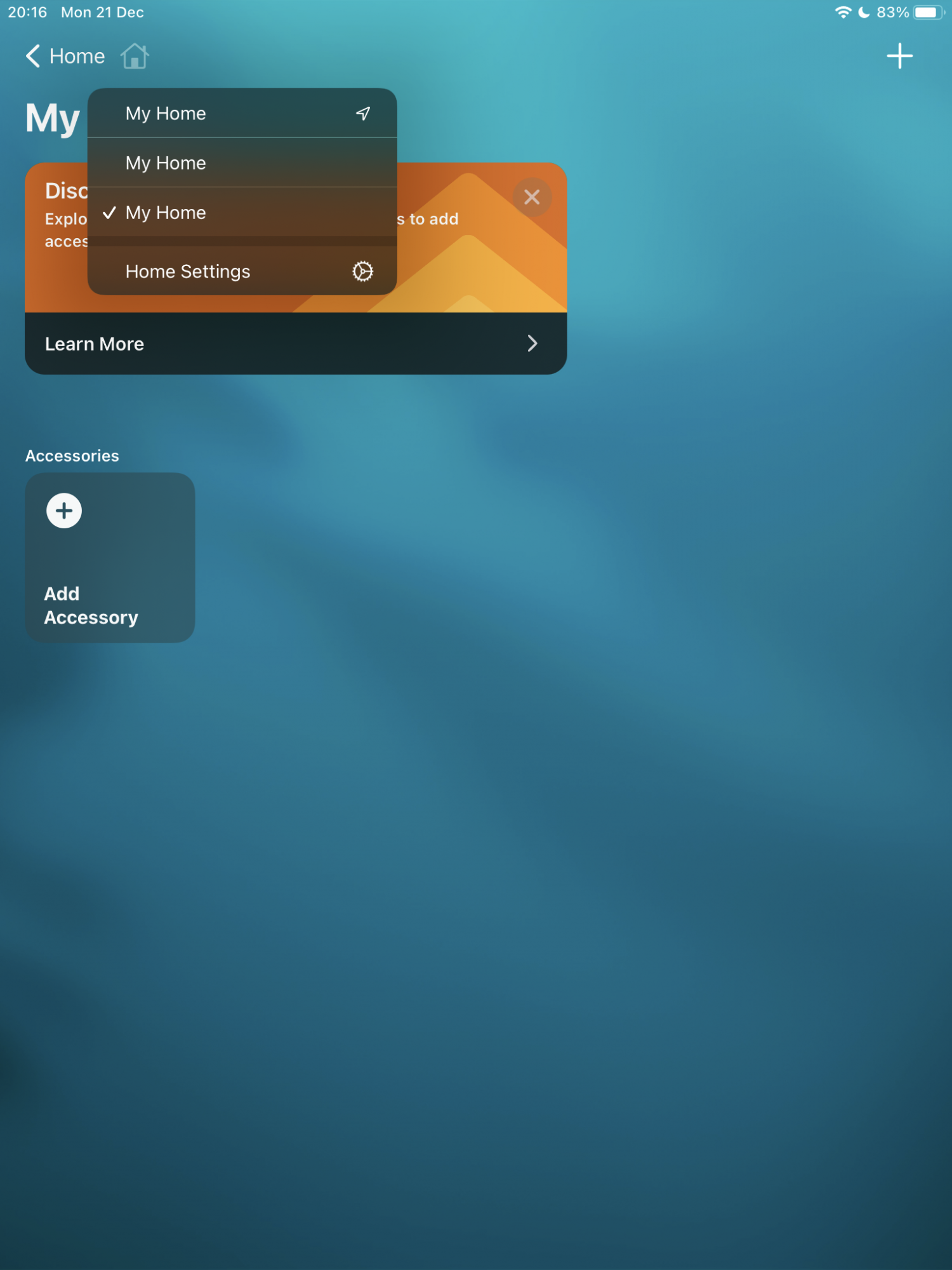

I uploaded a picture. Perhaps login out of iCloud could fix/reset the settings on the mac pro?

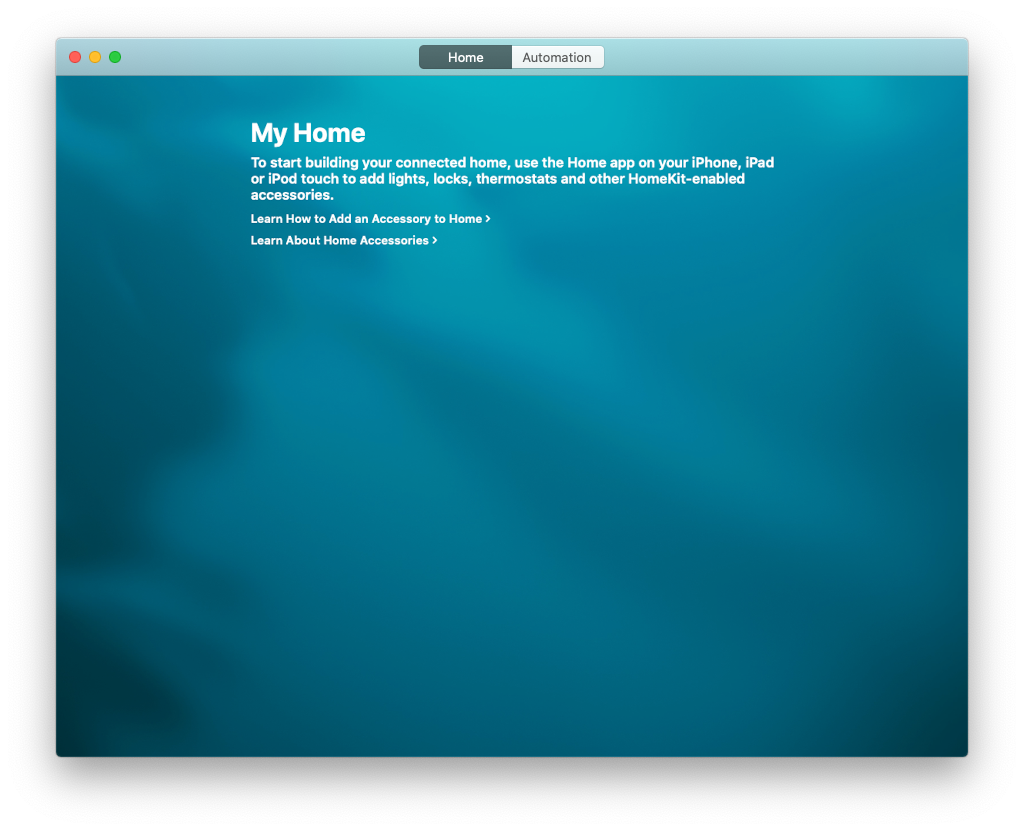

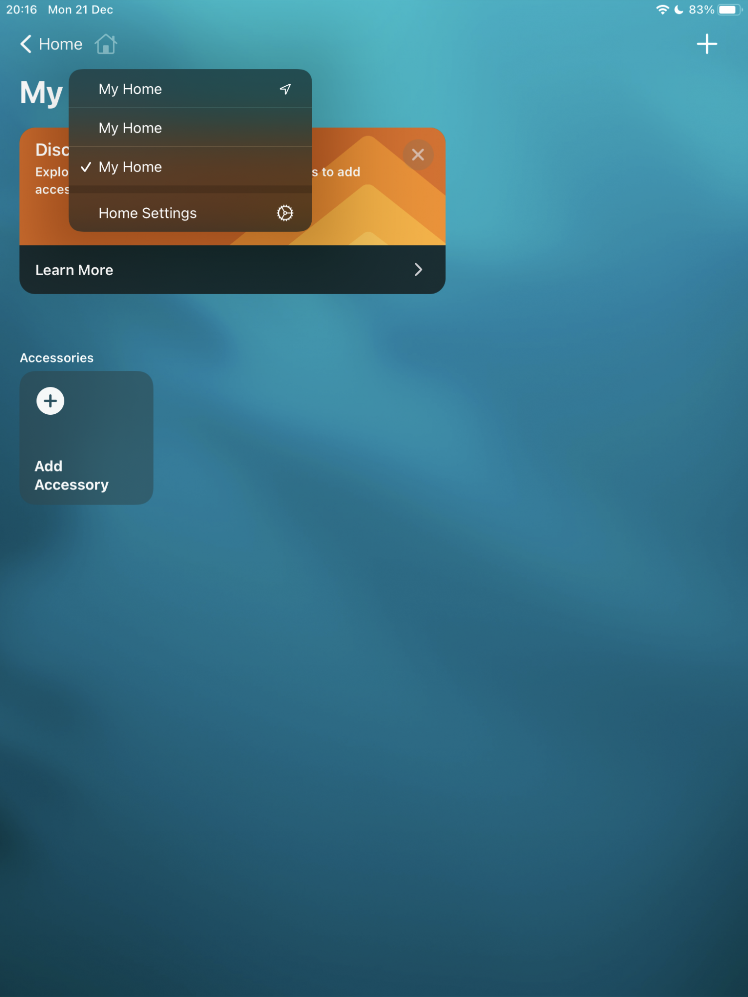

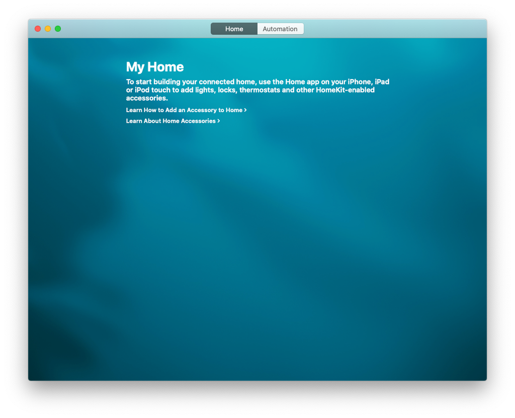

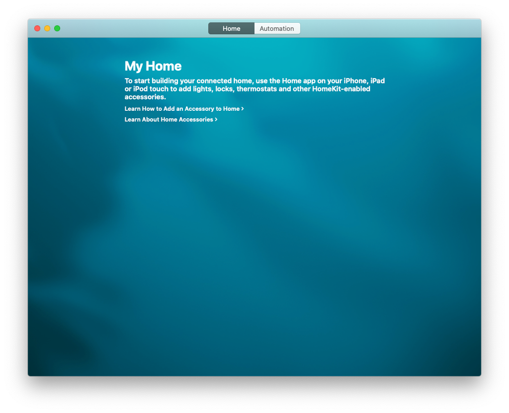

Is anyone else here using HomeKit on a Mac Pro with OpenCore? If you are, is it working for you? Because it's not here.
I've done this a few times now and here's how it goes. I delete all homes until I'm left with one which is seen by both the Mac Pro and my iPad. I set up that home. Everything is fine. I reboot the Mac Pro and relaunch the Home app. The home app doesn't see the home I've just created, but the iPad does. The Home app on macOS appears to create a new "My Home" which appears on the iPad as an additional home. It's usually around this point that the configured and working home gets "No Response" on all accessories and is effectively dead.
View attachment 1698898View attachment 1698900
I can rinse and repeat this as many times as I like. Every time the Home app on macOS is launched after a reboot a new "My Home" is created and it can no longer see the original, or any of the others it has created.
I'm posting here because OpenCore and macOS Catalina are the only 'odd' things about this system that I can think of that would possibly affect an iCloud service in this way, though I have no idea by what means. Does anybody have some insight? I'm on OpenCore 0.6.4 and my config is here.
I don't think this is OC related, more like macOS bug.

Well, how embarrasing. I've tried the old sign-out, sign-in to iCloud and it now seems to work. I swear I had no luck with this last night! Sorry folks, false alarm. :)
EDIT: ARGH! It's doing it again! It's unlikely to be OpenCore related if you folk are having success. I will go and take a stern look at my setup.
EDIT2: This machine was in need of a shake-down, so I've reinstalled. Less hassle than chasing this around the houses. The issue appears to be gone.

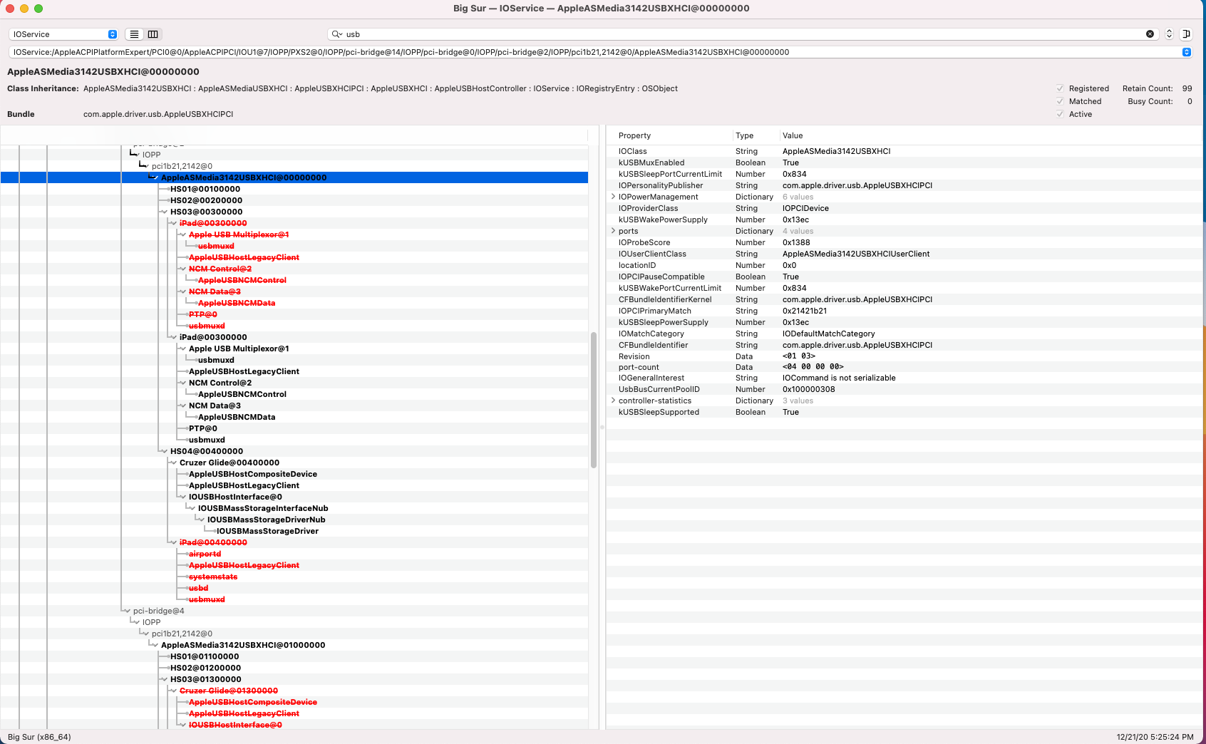

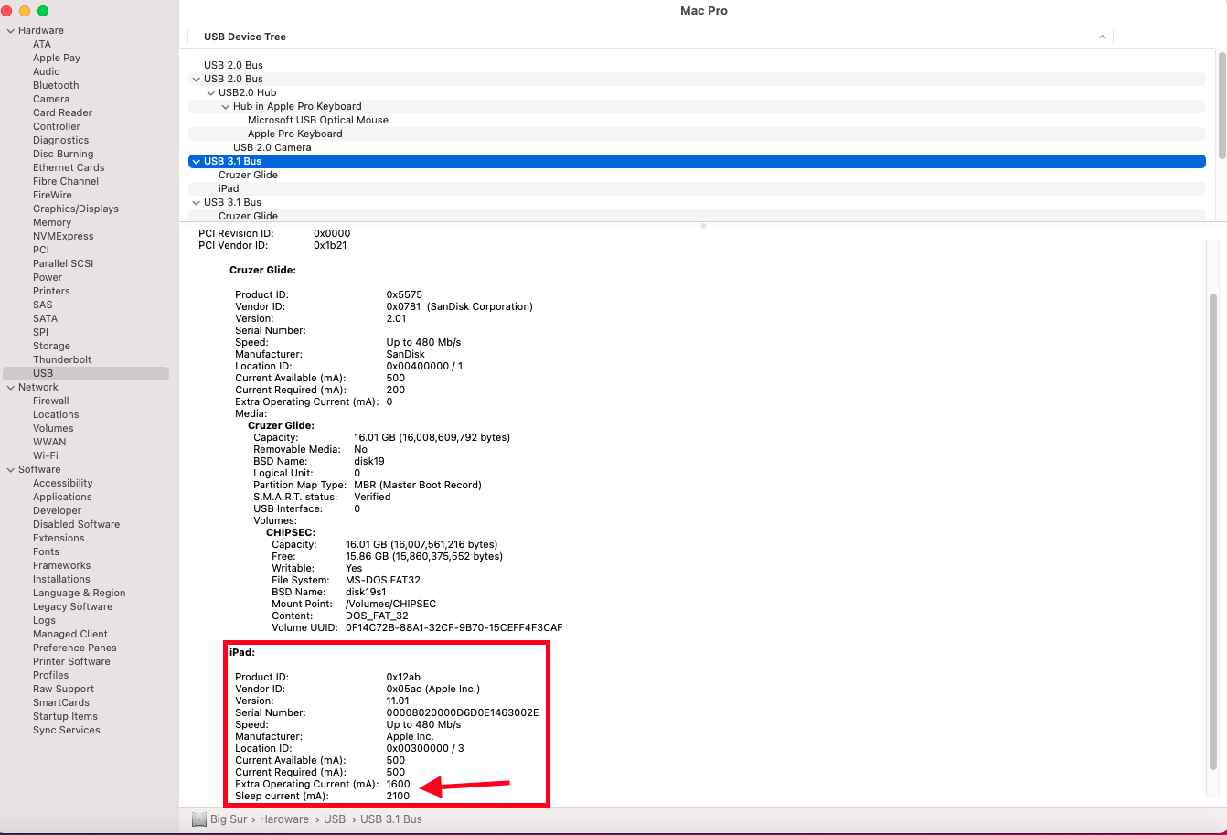

So I was playing with the USB3 ports in Big Sur. I have an Asmedia3142 controller PCIE card and I am now able to provide these properties when my iPad is connected:
  • USBMap.kext.zip
  • SSDT-EC-USBX.aml.zip
  • SSDT-RHUB-Reset.zip
