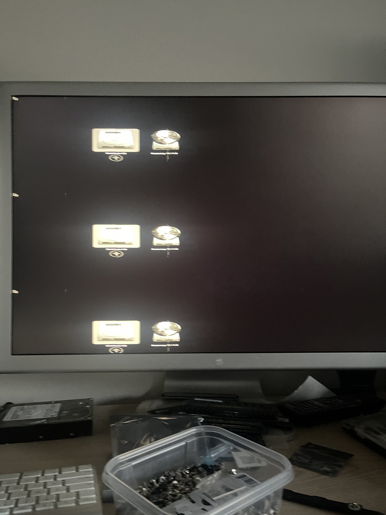

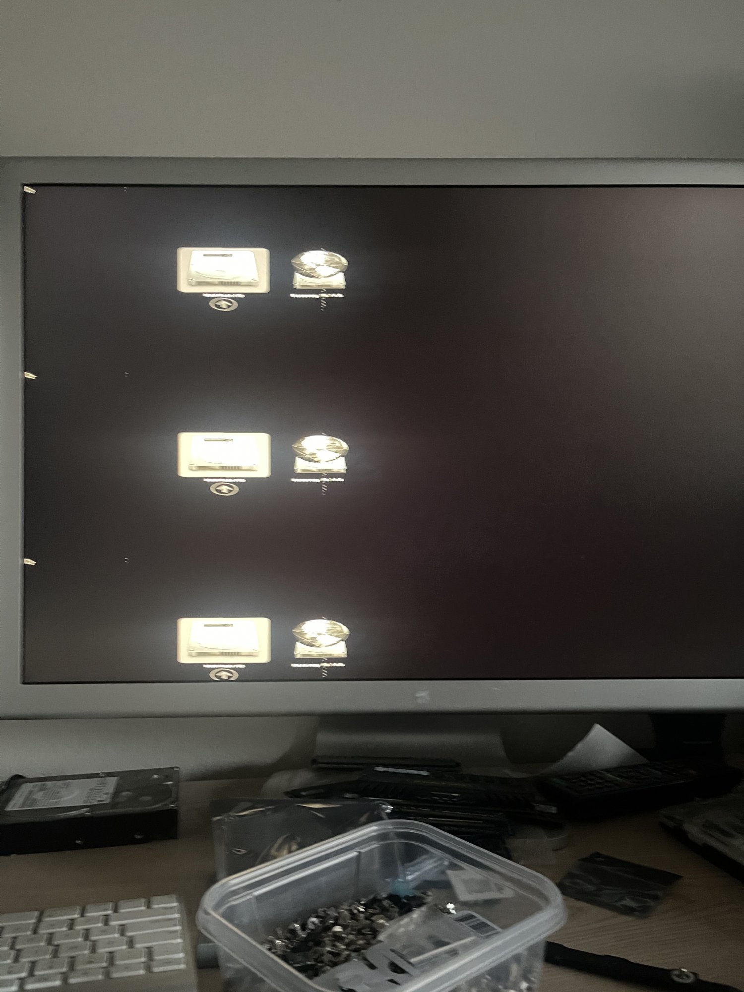

On my cmp 5,1 when I have my 30 inch Cinema Display plugged in to my rx 580 video card on the display port I get this at boot up and how can fix it and with a duel monitor set up only one port shows a boot screen and how can show a boot screen on all ports on my rx 580
Perhaps you can try setting another display mode (you can use the debug version of OpenCore to obtain the available modes). As for your dual monitor setup, I don't believe that the bootscreen can be mirrored on multiple monitors.
