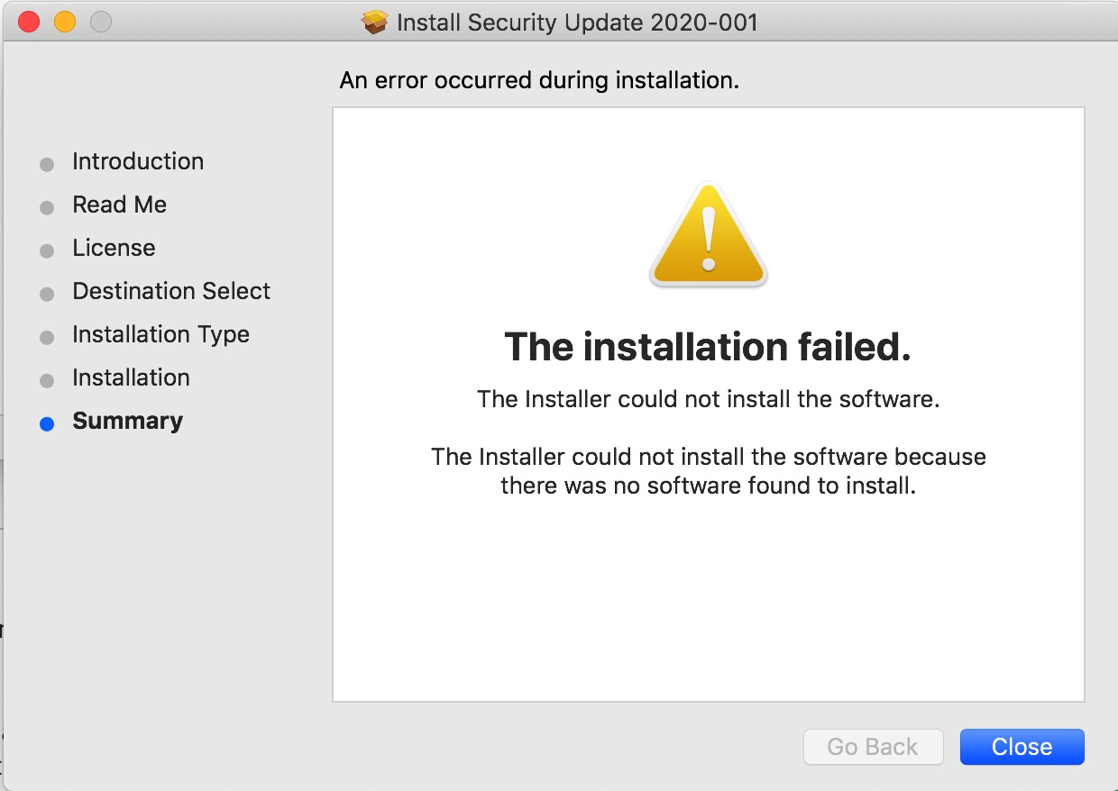

UPDATE: when I attempted to run the ModifiedUpdate.pkg I get the following error:
I had similar error, but my whole partition was not bootable. At least you can boot back.

That error is from the security update not from package managers. As I said it screwed my partition, so I had to reformat. But first I created an image of the container so later I copied it with CCC. Sounds like you can't boot either. Try another partition/drive this will not work.
How did it screw up your partition? Maybe I can un-screw it up before I reboot.
Boot with another partition and inspect both system and DATA volumes of that container. Search for the user folder in the system container. You will see what is missing. On mine eventually the whole system volume was empty but the installer could not recreate it due to the error.
