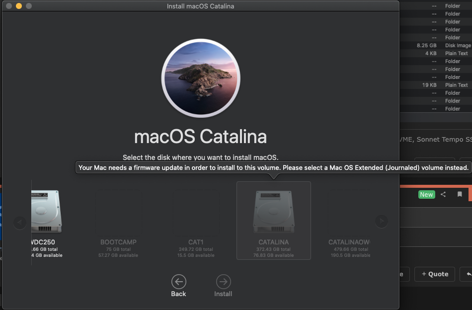

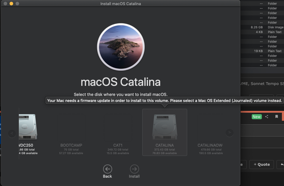

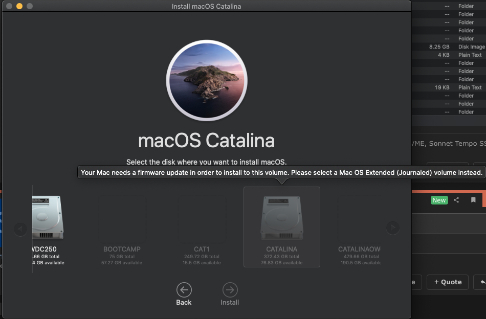

I attempted Security Update 2020-001 Catalina ... It did not finish
SecUpd2020-001Catalina includes firmware updates.
If you are running it while spoofing, you might have issues.
Basically, never run OTA updates on unsupported units while spoofing anything or try the "999.0.0.0.0" ROM trick.
I think best just not to spoof.
Reactions: Dewdman42 and cdf
Since most likely he is using the iMac Pro or Mac Pro 7,1 board-ID. Therefore, by spoofing the BootROM version to avoid firmware update, the number should be required to be above 1554.60.15.0.0
That 999.0.0.0.0 only works for other unsupported Mac users.
They can pick a non T2 model to spoof, and gain newer macOS support. Therefore, 999.0.0.0.0 can work.
For us, we use the board-ID to gain HWAccel. There is no non T2 option for us. So, we need a higher number to stay on the safe side.
In fact, we may run a test. e.g. spoof the BootROM to 9999.0.0.0.0, and keep the board ID spoofing, then check if the installer still pop up that firmware update alert.
Reactions: startergo and cdf
Although "run-efi-updater=No" should block unwanted updates in Catalina.
Reactions: h9826790
I turned off SMBIOS update. Only the VMM flag is set. Tried to finish the security update:
Cheers. It becomes the "9999.99.99.99.99" trick then ... or to only run such updates when not spoofing.
Even though I found that my 3,1 can do the OTA updates, I still prefer downloading them, running my fix script over them and going from there. I suppose that option might be going away with BS though.

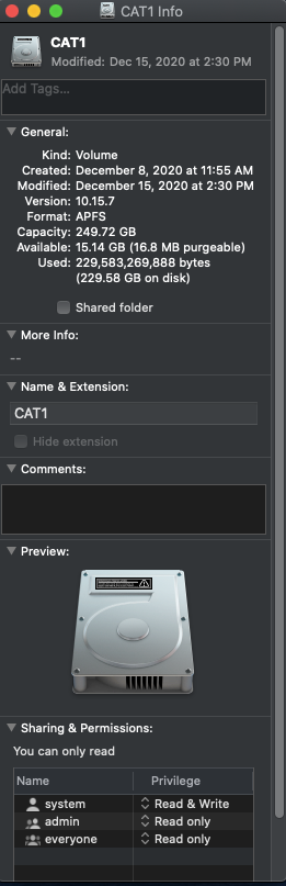

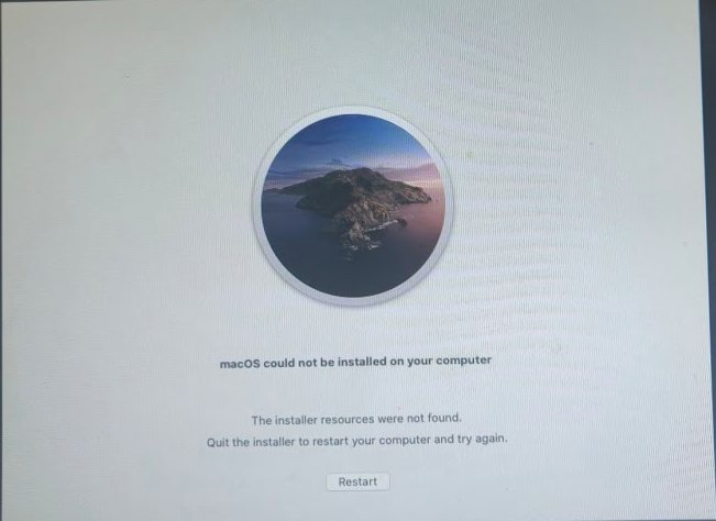

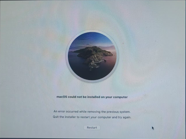

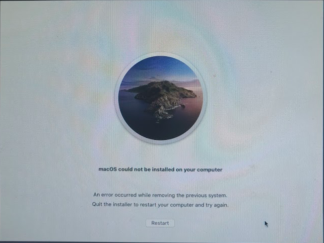

Something strange on that drive. When I inspect the size it says 15,14GB available:
Yet I inspected all folders including the hidden folders and I can't find a folder bigger than 1GB? Tried reinstalling the OS X from USB and it says not enough space available? Normally the Catalina disks are visible as Catalina+ Catalina-Data. So in terminal I have:

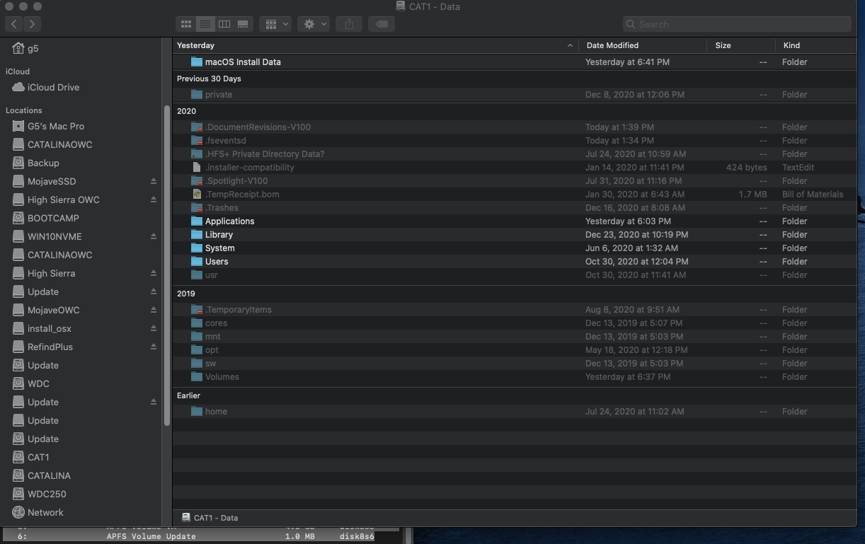

And also under the hidden Volume folder I got:
So macOS Install Data folder is there created by the security update, but it is not accessible. Also my user folder is there too. Somehow the APFS Container messed up. Anyway to recover it?
Code:
sudo diskutil repairVolume disk8
Started file system repair on disk8
Repairing storage system
Performing fsck_apfs -y -x /dev/disk7s2
Checking the container superblock
warning: container has been mounted by APFS version 1677.80.5, which is newer than 1412.141.1
warning: disabling overallocation repairs by default; use -o to override
Checking the EFI jumpstart record
Checking the space manager
Checking the space manager free queue trees
Checking the object map
Checking volume
Checking the APFS volume superblock
The volume CAT1 - Data was formatted by hfs_convert (1412.101.1) and last modified by apfs_kext (1412.141.1)
Checking the snapshot metadata tree
Checking the extent ref tree
Checking the fsroot tree
error: drec_key object (oid 0x300f256b8): invalid hash (0x0, expected 0x1d15c) of name (.store.db)
fsroot tree is invalid
The volume /dev/disk7s2 could not be verified completely
Storage system check exit code is 0
Finished file system repair on disk8

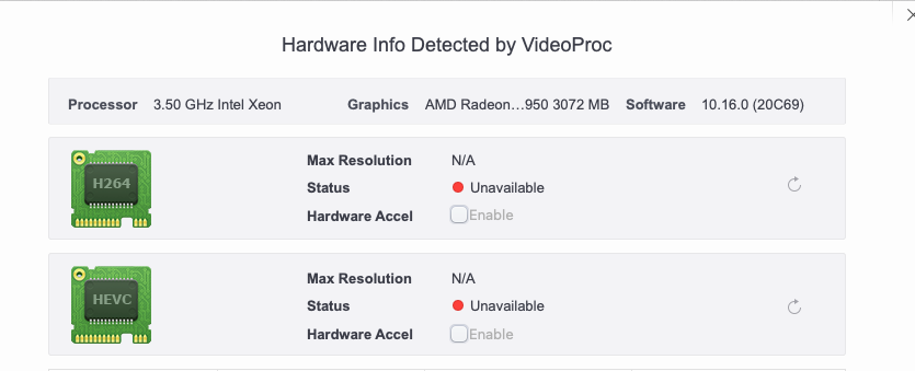

Hi everyone (and Happy New Year!),
I successfully have OpenCore 0.6.4 running on my cMP 4,1-flashed-to-5,1.
I upgraded the CPU awhile back to a 6-core W3690.
The GPU is a flashed AMD Radeon HD 7950 3GB card.
Big Sur runs as smoothly as I would expect, and I'm happy to no longer rely on dosdude or barryk's patching techniques.
I was able to successfully configure the graphical boot picker, but I cannot get hardware acceleration working. I am working under the presumption that I've followed the instructions to the absolute letter, before spending any more time on this I just need to know if this card even supports Hardware Acceleration with OpenCore.
I've seen a post from one user that suggested (but didn't really confirm) the 7970 didn't support it, but I'm hoping someone with a deeper technical level of knowledge (not just "oh well if they said the newer card doesn't why would you think yours does") can confirm whether or not I'm wasting time on making this card do things it doesn't support.

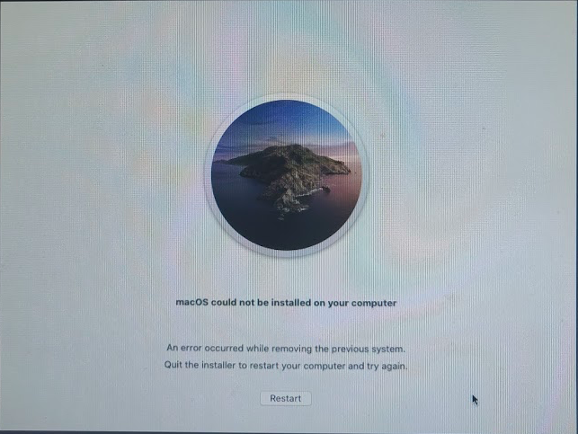

Same ****. Now my system volume is completely empty and is still stuck at that error. Is there any way to recreate the system Volume from the DATA volume? Or maybe reinstall Catalina and just copy over DATA volume?
