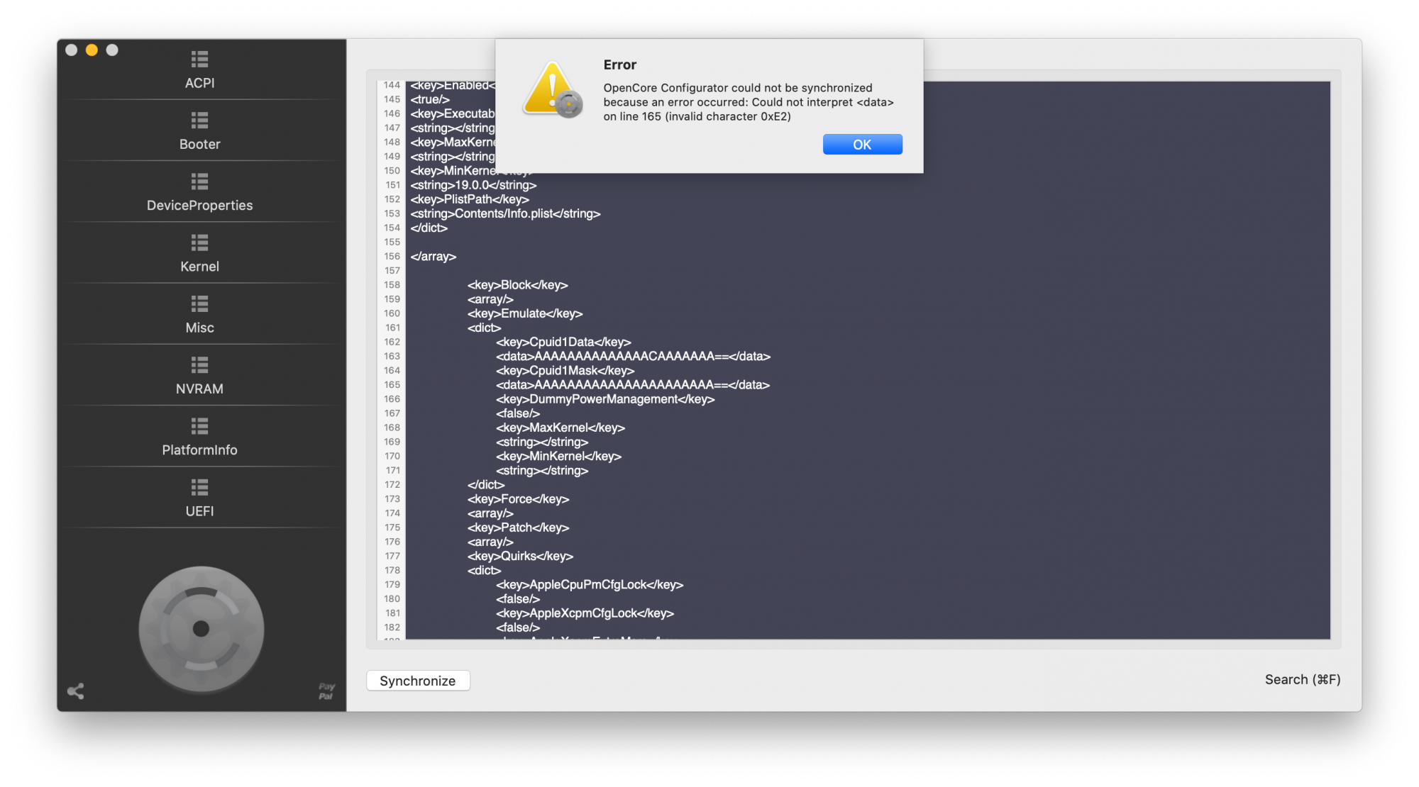

I've been succesfull in installing OC and upgrading to Catalina my system. I only can't get the boot picker screen on my 4k dispaly. Any idea? I try to attach my actual config file.

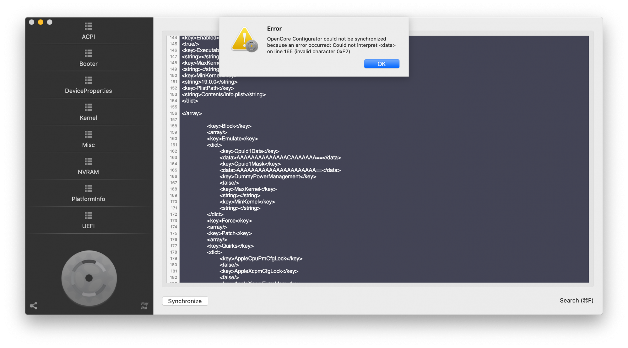

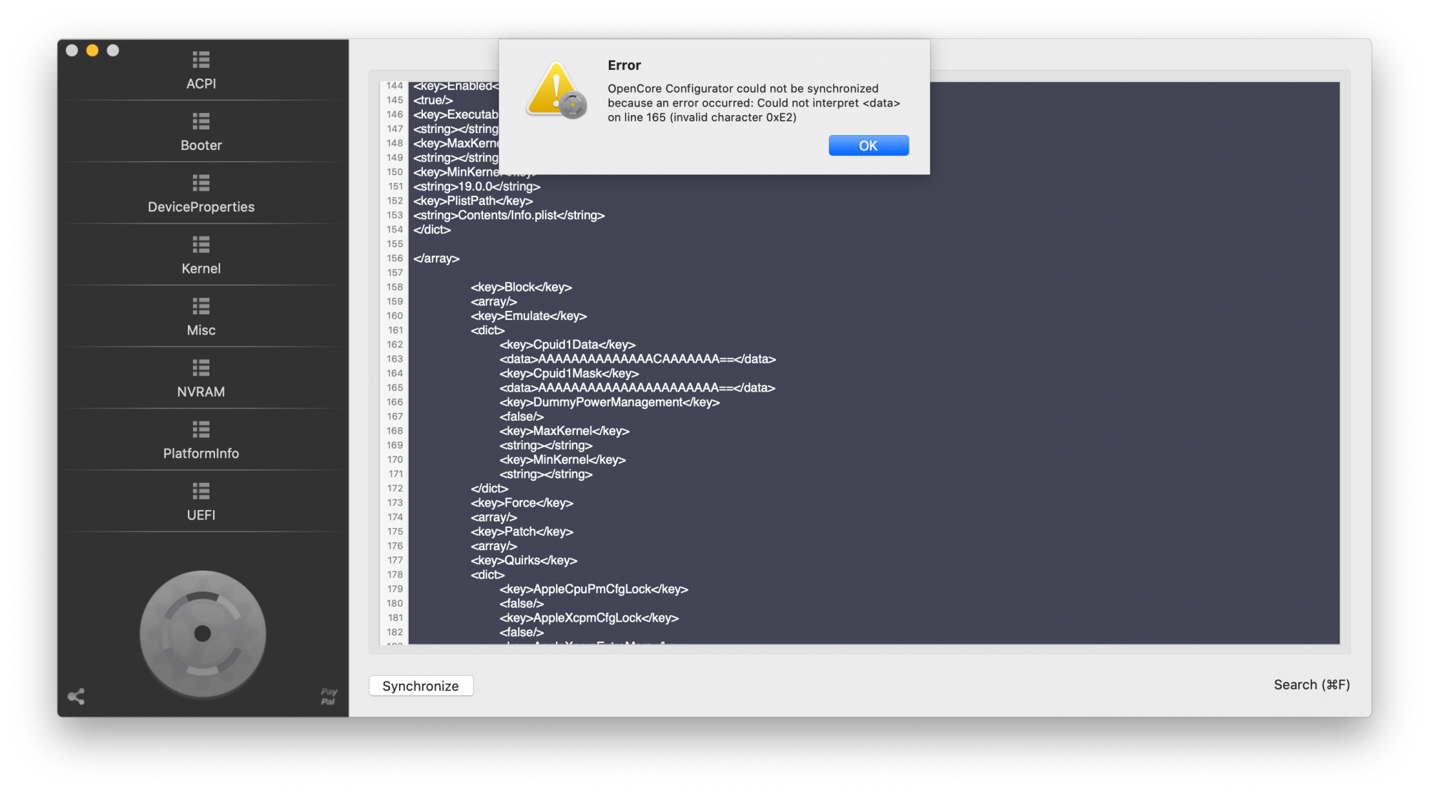

@cdf Am I wrong or adding "<string>OpenCanopy.efi</string>" instruction is missing in the first post? Anyway many thanks for your great work! Amazing stuff, great results!
My bad! Thanks for checking ;)
I was giving a try at OpenCore Configurator app... it identify the same error I was getting checking the file form the CLI. How may I fix it?
TIA
TIA
If you never touch that line, don't touch it. There is nothing wrong.
Anyway, use OpenCore Configurator carefully. In general, I won't recommend that. You really need to know how to use that correctly. Otherwise, it can create more trouble than fixing things.
Reactions: hwojtek and cdf
0xE2 is "â", so it seems to me there is a (not-visible) character in this line. Sometimes happens when copy/pasting. My advice: in an plain text editor (BBEdit for example) remove the whole line including <data></data> tags, also remove the blank line and then press enter at the end of the preceding line (cpuid1mask</key>) and then open the <data> tag, put all the A's manually one by one and close the tag </data>. Do not forget to press enter afterwards.

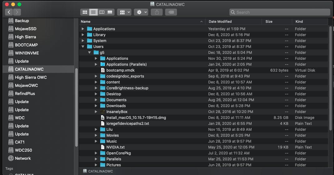

I attempted
Security Update 2020-001 Catalina​
It did not finish saying that the installer resources are not available yet the installer option sits is in the OC bootpicker and I can boot from it, but it just says that the installer resources are not available. If I try to boot that OS it just shuts down. I booted through another partition and I can see my entire user folder is missing. Only the shared account is there:

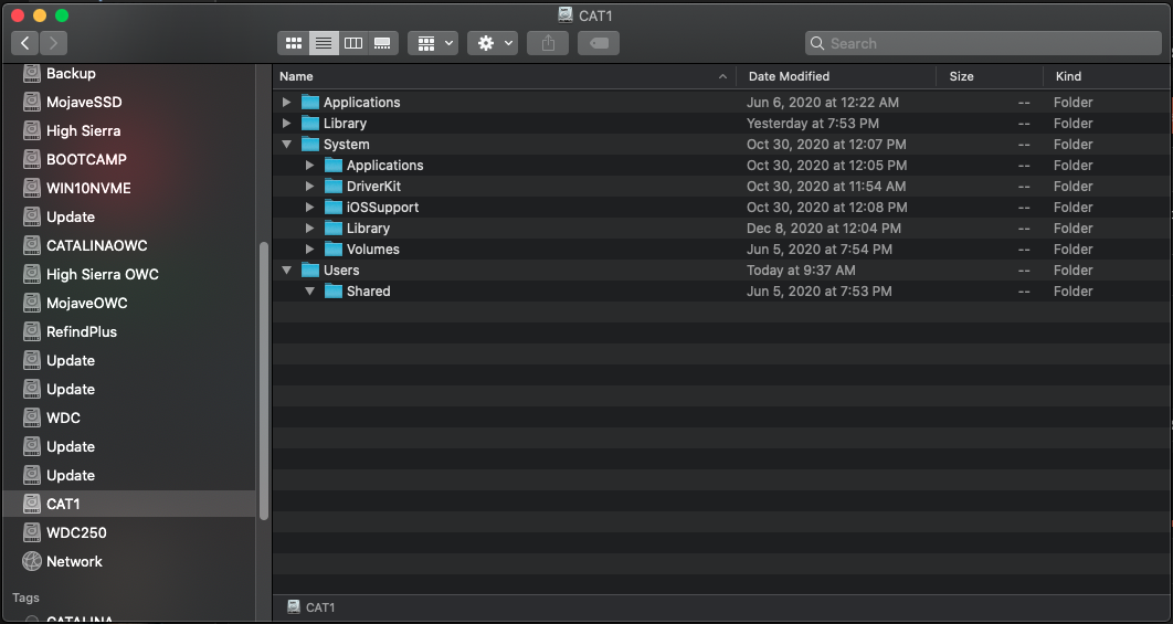

Here are the contents of another Catalina partition as seen from the booted partition:
