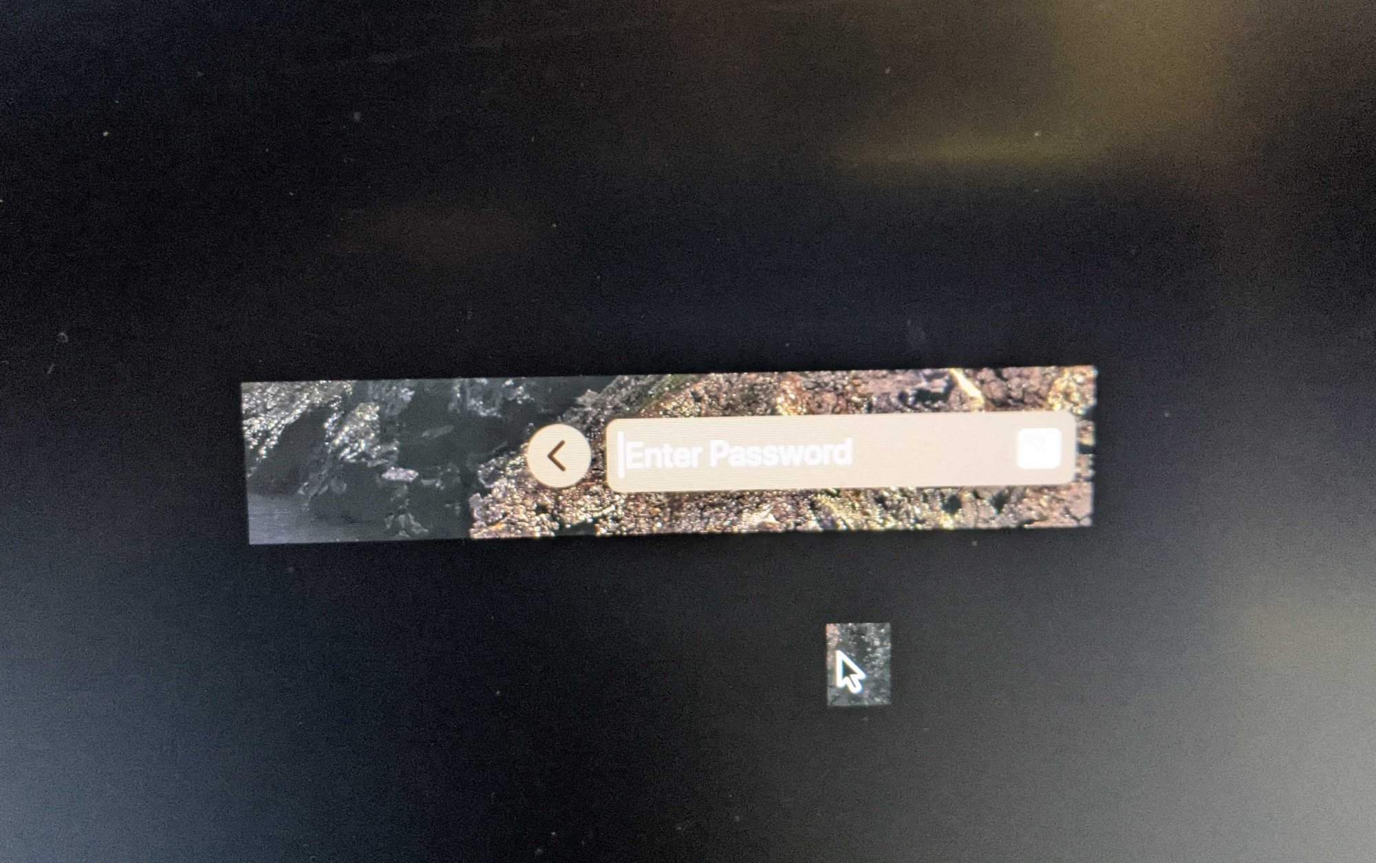

Odd login - display issues
My 5.1 is working fine(ish) thanks to all the info here. Issue is the login process has gotten a bit weird. It started out OK but now OC boots Catalina to a blank screen. If I Arrow Enter blind the login box pops up as shown in attached. I can then enter password and login proceeds normally.
Any ideas what's up?
Also can not enable automatic login which would be fine workaround
Note: I know just enough to be dangerous - please help. Thanks!
As shown in image, screen is blank except login "box" and a block around cursor

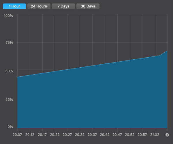

So I have been successful at installing Big Sur 11.1 using OpenCore 0.6.3 however using iStat Menus i can see my GPU Ram (RX580 8GB) is always maxed out.
Video works fine initially, however I am noticing slower graphics in Logic Pro X (meters lagging for instance)
However I can see the vRam steadily climb all the way up to 100% after about 1 hour working on just spreadsheets and web work, not doing anything graphically intensive
CPU Usage always very low. Ram (24GB) also is low, always have about 15GB to spare.
What could be causing this? I think this issue maybe causing my graphics in Logic to lag and, eventually slow down system response visually.
I am re-checking this again and the VRAM keeps slowly filing up more and more over time letting the system run practically idle..

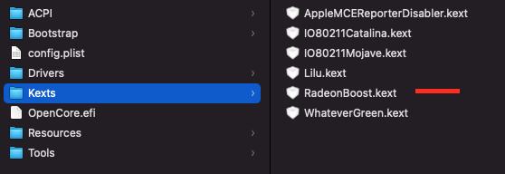

I am wondering if it may have to do with the RadeonBoost.kext ?
