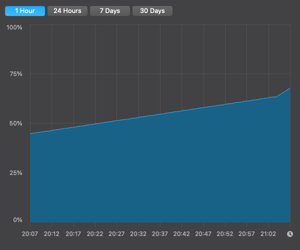

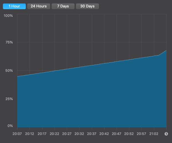

Probably a memory leak somewhere.I am re-checking this again and the VRAM keeps slowly filing up more and more over time letting the system run practically idle..

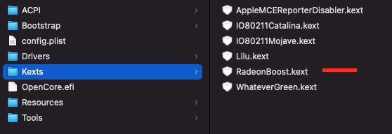

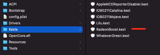

I am wondering if it may have to do with the RadeonBoost.kext ?
That feature is for automatic mode, which is not suitable for the hybridization approach used here in the guide.I was about to ask a question about this, what is the distinction between using the BIOSVersion (per the guide) and the new MaxBIOSVersion that is mentioned in the 0.6.6 OC manual..which I assume is a new feature?

Isn’t that referring to RAM memory leaks as opposed to my VRAM issue?Probably a memory leak somewhere.
Finding Memory Leaks
Guidelines for improving the performance of memory-related code.developer.apple.com

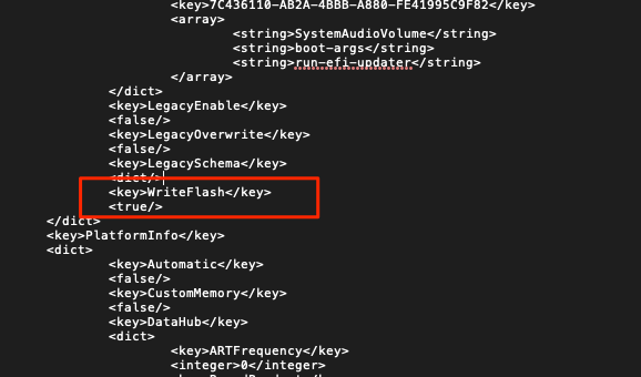

This depends on your configuration. With WriteFlash set to false, nothing is actually written.@cdf @tsialex

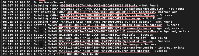

Sorry to bring this subject up again, but I'm reading some contradictory posts regarding OC writing to NVRAM on the SPI flash chip.
As I understand it, SPI flash has a finite amount of write/delete cycles (100k I think). I'm curious therefore if OC is physically writing or deleting NVRAM entries every single time it boots.
Unless I'm interpreting the following logs incorrectly, it appears to me that it does:
Would like to confirm if this is indeed the case, and what course of action is best to prevent an early death of the SPI flash.

The best course of action is to have a back up first. Then, after updating OpenCore and loading a recommended configuration, you can certainly try Software Update from Catalina.Just to follow on my previous post, in order to upgrade my 5.1 Opencore Catalina install to Big Sur do I just need to update Opencore and then click on the Big Sur upgrade in system update?
with WriteFlash set to true also, as long as it is already written:This depends on your configuration. With WriteFlash set to false, nothing is actually written.

This is what's in my config.plist and I assume is what you're referring to:This depends on your configuration. With WriteFlash set to false, nothing is actually written.
