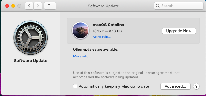

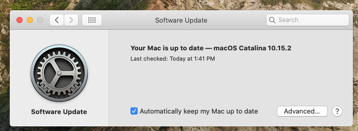

Expert @cdf-
I believe I installed OC correctly, 4,1 to 5,1 cMP! (Catalina installed on a 7101A Pcie)
It is running well, I Think!
One Issue, I do not have a software update install button??
Is that correct if OC boots the catalina os drive?
OH, So when there is a new update the "install/upgrade now button" will appear?!
I have all the advanced options checked-Is that OK?
I Can't Thank You All Enough!!
I have my cMP running Catalina (without patches) with the normal way to Update-UNBELEIVABLE!!
Reactions: cdf

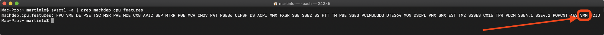

startergo:
How can you test/be sure the VMM flag is on? During the OC procedure, I remember a check for OC working but not for the VMM flag specifically-?
