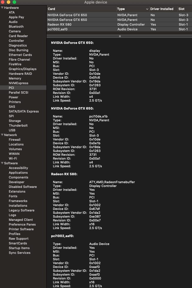

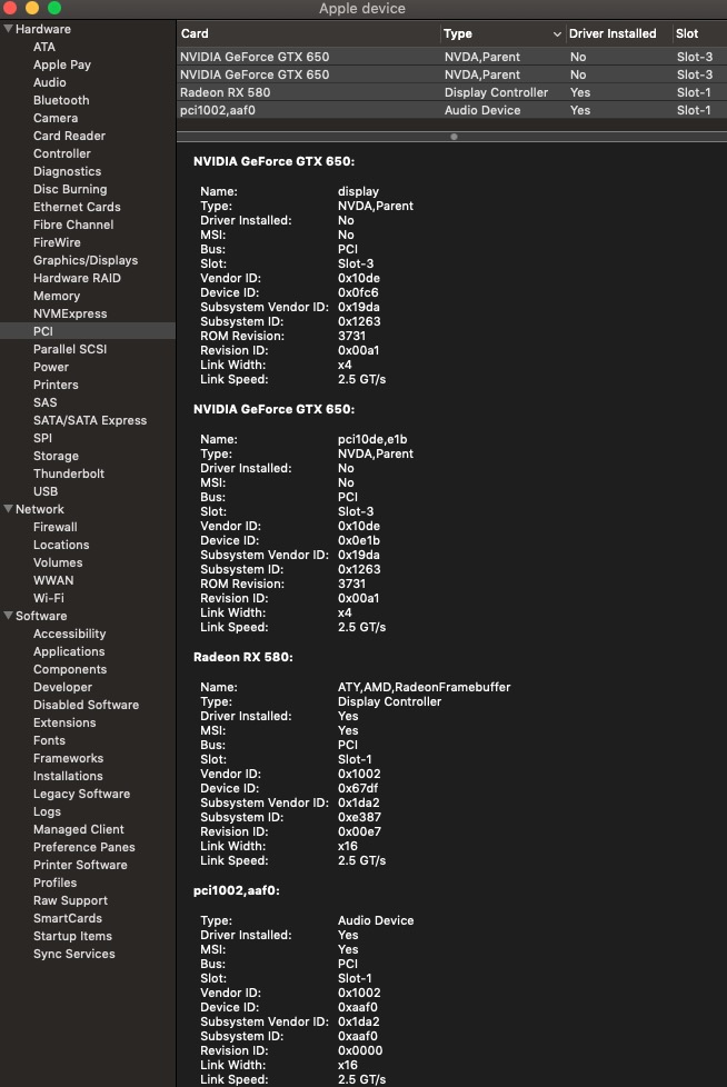

Added some lspci output showing both cards in the system at the same time, perhaps this will be of use... GTX 650 is 'off' and the RX 580 is 'on'.
The goal here is to allow someone to keep a cheap mac flashed unsupported GPU in slot 3 (or presumably slot 4) and be able to have a modern GPU in slot 1/2. This give you the ability to potentially have the best of both worlds.

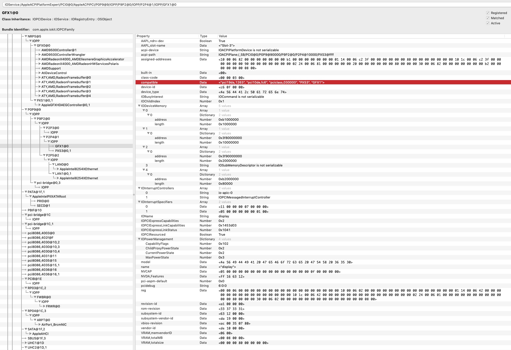

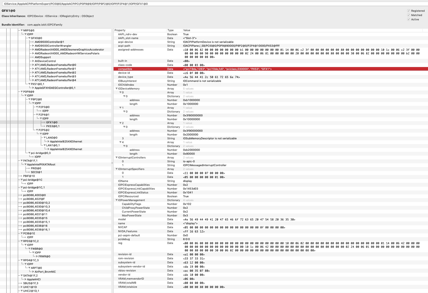

I've patched the DSDT and one SSDT, and while they both are in my config I'm not confident that the SSDT is being loaded based on how I'm reading the OC debug log. I used Clover to extract the DSDT / SSDT, preboot log attached as well if curious.

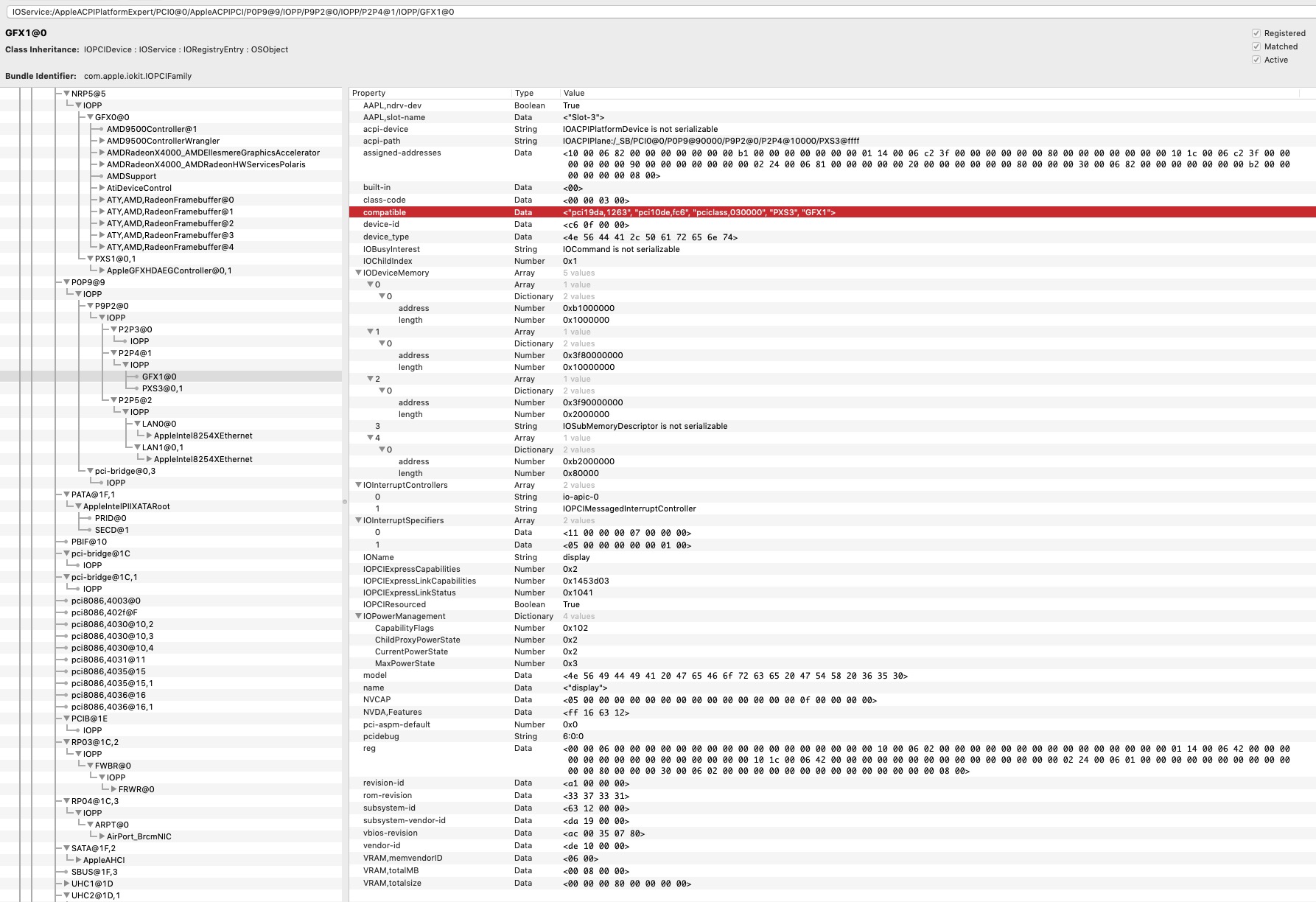

Screenshot shows IOReg info for the NVDA card in slot 3, you can see that nothing has attached to it like you can see at the top of the screenshot where the AMD card has all the expected things attached to it.
Another reason I'm not sure if it is loading these correctly is that I attempted to rename part of the device path to try to help me see if it was actually loading the patches. (I tried to rename P2P4 to P2P6, which isn't reflected in the IOReg, but the net effect of disabling the NVDA GPU still seems to have been effective).
Side note: with current config I do get full h264 and HEVC encode/decode, but still have to figure out the DRM part as shikigva=144 that works in my hack imacpro to give netflix in safari just gives me red screen on the 3,1 with audio playing in the background.

│ ├┬22:10.0-[30-35]   # g3x8 > g3x4    [10b5:8747] [0604] (rev ca) PCI bridge: PLX Technology, Inc. PEX 8747 48-Lane, 5-Port PCI Express Gen 3 (8.0 GT/s) Switch
│ │└┬30:00.0-[31-35]  # g3x4           [8086:1578] [0604] PCI bridge: Intel Corporation DSL6540 Thunderbolt 3 Bridge [Alpine Ridge 4C 2015]
│ │ ├┬31:00.0-[35]    # g1x4           [8086:1578] [0604] PCI bridge: Intel Corporation DSL6540 Thunderbolt 3 Bridge [Alpine Ridge 4C 2015]
│ │ │└─35:00.0        # g1x4           [8086:1577] [0880] System peripheral: Intel Corporation DSL6540 Thunderbolt 3 NHI [Alpine Ridge 4C 2015]
│ │ ├┬31:01.0-[34]    # g1x4           [8086:1578] [0604] PCI bridge: Intel Corporation DSL6540 Thunderbolt 3 Bridge [Alpine Ridge 4C 2015]
│ │ ├┬31:02.0-[33]    # g1x4           [8086:1578] [0604] PCI bridge: Intel Corporation DSL6540 Thunderbolt 3 Bridge [Alpine Ridge 4C 2015]
│ │ │└─33:00.0        # g1x4           [8086:15b6] [0c03] USB controller: Intel Corporation DSL6540 USB 3.1 Controller [Alpine Ridge]
│ │ └┬31:04.0-[32]    # g1x4           [8086:1578] [0604] PCI bridge: Intel Corporation DSL6540 Thunderbolt 3 Bridge [Alpine Ridge 4C 2015]
│ └┬22:11.0-[36-3b]   # g3x8 > g3x4    [10b5:8747] [0604] (rev ca) PCI bridge: PLX Technology, Inc. PEX 8747 48-Lane, 5-Port PCI Express Gen 3 (8.0 GT/s) Switch
│  └┬36:00.0-[37-3b]  # g3x4           [8086:1578] [0604] PCI bridge: Intel Corporation DSL6540 Thunderbolt 3 Bridge [Alpine Ridge 4C 2015]
│   ├┬37:00.0-[3b]    # g1x4           [8086:1578] [0604] PCI bridge: Intel Corporation DSL6540 Thunderbolt 3 Bridge [Alpine Ridge 4C 2015]
│   │└─3b:00.0        # g1x4           [8086:1577] [0880] System peripheral: Intel Corporation DSL6540 Thunderbolt 3 NHI [Alpine Ridge 4C 2015]
│   ├┬37:01.0-[3a]    # g1x4           [8086:1578] [0604] PCI bridge: Intel Corporation DSL6540 Thunderbolt 3 Bridge [Alpine Ridge 4C 2015]
│   ├┬37:02.0-[39]    # g1x4           [8086:1578] [0604] PCI bridge: Intel Corporation DSL6540 Thunderbolt 3 Bridge [Alpine Ridge 4C 2015]
│   │└─39:00.0        # g1x4           [8086:15b6] [0c03] USB controller: Intel Corporation DSL6540 USB 3.1 Controller [Alpine Ridge]
│   └┬37:04.0-[38]    # g1x4           [8086:1578] [0604] PCI bridge: Intel Corporation DSL6540 Thunderbolt 3 Bridge [Alpine Ridge 4C 2015]
├┬00:05.0-[11]        # g2x16 > g1x16  [8086:4025] [0604] (rev 20) PCI bridge: Intel Corporation 5400 Chipset PCI Express Port 5
│├─11:00.0            # g2x16 > g1x16  [10de:1180] [0300] (rev a1) VGA compatible controller: NVIDIA Corporation GK104 [GeForce GTX 680]
│└─11:00.1            # g2x16 > g1x16  [10de:0e0a] [0403] (rev a1) Audio device: NVIDIA Corporation GK104 HDMI Audio Controller
├┬00:09.0-[12-1a]     # g2x4 > g1x4    [8086:4029] [0604] (rev 20) PCI bridge: Intel Corporation 5400 Chipset PCI Express Port 9
│├┬12:00.0-[13-19]    # g1x8 > g1x4    [8086:3500] [0604] (rev 01) PCI bridge: Intel Corporation 6311ESB/6321ESB PCI Express Upstream Port
││├┬13:00.0-[14-17]   # g1x4           [8086:3510] [0604] (rev 01) PCI bridge: Intel Corporation 6311ESB/6321ESB PCI Express Downstream Port E1
│││└┬14:00.0-[15-17]  # g2x4 > g1x4    [12d8:2308] [0604] PCI bridge: Pericom Semiconductor Device
│││ ├┬15:01.0-[16]    # g2x2           [12d8:2308] [0604] PCI bridge: Pericom Semiconductor Device
│││ │└─16:00.0        # g2x2           [1b21:1242] [0c03] USB controller: ASMedia Technology Inc. ASM1142 USB 3.1 Host Controller
│││ └┬15:02.0-[17]    # g2x2           [12d8:2308] [0604] PCI bridge: Pericom Semiconductor Device
│││  └─17:00.0        # g2x2           [1b21:0625] [0106] (rev 01) SATA controller: ASMedia Technology Inc. Device
││├┬13:01.0-[18]      # g1x4 > g1x0    [8086:3514] [0604] (rev 01) PCI bridge: Intel Corporation 6311ESB/6321ESB PCI Express Downstream Port E2
││└┬13:02.0-[19]      # g1x4           [8086:3518] [0604] (rev 01) PCI bridge: Intel Corporation 6311ESB/6321ESB PCI Express Downstream Port E3
││ ├─19:00.0          # g1x4           [8086:1096] [0200] (rev 01) Ethernet controller: Intel Corporation 80003ES2LAN Gigabit Ethernet Controller (Copper)
││ └─19:00.1          # g1x4           [8086:1096] [0200] (rev 01) Ethernet controller: Intel Corporation 80003ES2LAN Gigabit Ethernet Controller (Copper)
│└┬12:00.3-[1a]       # g1x8 > g1x4    [8086:350c] [0604] (rev 01) PCI bridge: Intel Corporation 6311ESB/6321ESB PCI Express to PCI-X Bridge
├─00:0f.0             # g0x0           [8086:402f] [0880] (rev 20) System peripheral: Intel Corporation 5400 Chipset QuickData Technology Device
├─00:10.0             #                [8086:4030] [0600] (rev 20) Host bridge: Intel Corporation 5400 Chipset FSB Registers
├─00:10.1             #                [8086:4030] [0600] (rev 20) Host bridge: Intel Corporation 5400 Chipset FSB Registers
├─00:10.2             #                [8086:4030] [0600] (rev 20) Host bridge: Intel Corporation 5400 Chipset FSB Registers
├─00:10.3             #                [8086:4030] [0600] (rev 20) Host bridge: Intel Corporation 5400 Chipset FSB Registers
├─00:10.4             #                [8086:4030] [0600] (rev 20) Host bridge: Intel Corporation 5400 Chipset FSB Registers
├─00:11.0             #                [8086:4031] [0600] (rev 20) Host bridge: Intel Corporation 5400 Chipset CE/SF Registers
├─00:15.0             #                [8086:4035] [0600] (rev 20) Host bridge: Intel Corporation 5400 Chipset FBD Registers
├─00:15.1             #                [8086:4035] [0600] (rev 20) Host bridge: Intel Corporation 5400 Chipset FBD Registers
├─00:16.0             #                [8086:4036] [0600] (rev 20) Host bridge: Intel Corporation 5400 Chipset FBD Registers
├─00:16.1             #                [8086:4036] [0600] (rev 20) Host bridge: Intel Corporation 5400 Chipset FBD Registers
├─00:1b.0             # g0x0           [8086:269a] [0403] (rev 09) Audio device: Intel Corporation 631xESB/632xESB High Definition Audio Controller
├┬00:1c.0-[1b]        # g1x1 > g1x0    [8086:2690] [0604] (rev 09) PCI bridge: Intel Corporation 631xESB/632xESB/3100 Chipset PCI Express Root Port 1
├┬00:1c.1-[1c]        # g1x1 > g1x0    [8086:2692] [0604] (rev 09) PCI bridge: Intel Corporation 631xESB/632xESB/3100 Chipset PCI Express Root Port 2
├┬00:1c.2-[1d-1e]     # g1x1           [8086:2694] [0604] (rev 09) PCI bridge: Intel Corporation 631xESB/632xESB/3100 Chipset PCI Express Root Port 3
│└┬1d:00.0-[1e]       # g1x1           [104c:823e] [0604] PCI bridge: Texas Instruments XIO2213A/B/XIO2221 PCI Express to PCI Bridge [Cheetah Express]
│ └─1e:00.0           #                [104c:823f] [0c00] FireWire (IEEE 1394): Texas Instruments XIO2213A/B/XIO2221 IEEE-1394b OHCI Controller [Cheetah Express]
├┬00:1c.3-[1f]        # g1x1           [8086:2696] [0604] (rev 09) PCI bridge: Intel Corporation 631xESB/632xESB/3100 Chipset PCI Express Root Port 4
│└─1f:00.0            # g1x1           [14e4:4328] [0280] (rev 03) Network controller: Broadcom Inc. and subsidiaries BCM4321 802.11a/b/g/n
├─00:1d.0             #                [8086:2688] [0c03] (rev 09) USB controller: Intel Corporation 631xESB/632xESB/3100 Chipset UHCI USB Controller #1
├─00:1d.1             #                [8086:2689] [0c03] (rev 09) USB controller: Intel Corporation 631xESB/632xESB/3100 Chipset UHCI USB Controller #2
├─00:1d.2             #                [8086:268a] [0c03] (rev 09) USB controller: Intel Corporation 631xESB/632xESB/3100 Chipset UHCI USB Controller #3
├─00:1d.3             #                [8086:268b] [0c03] (rev 09) USB controller: Intel Corporation 631xESB/632xESB/3100 Chipset UHCI USB Controller #4
├─00:1d.7             #                [8086:268c] [0c03] (rev 09) USB controller: Intel Corporation 631xESB/632xESB/3100 Chipset EHCI USB2 Controller
├┬00:1e.0-[20]        #                [8086:244e] [0604] (rev d9) PCI bridge: Intel Corporation 82801 PCI Bridge
├─00:1f.0             #                [8086:2670] [0601] (rev 09) ISA bridge: Intel Corporation 631xESB/632xESB/3100 Chipset LPC Interface Controller
├─00:1f.1             #                [8086:269e] [0101] (rev 09) IDE interface: Intel Corporation 631xESB/632xESB IDE Controller
├─00:1f.2             #                [8086:2681] [0106] (rev 09) SATA controller: Intel Corporation 631xESB/632xESB SATA AHCI Controller
└─00:1f.3             #                [8086:269b] [0c05] (rev 09) SMBus: Intel Corporation 631xESB/632xESB/3100 Chipset SMBus Controller
gfxutil -t
                  /cpus/CPU0@0 = Acpi(0x00000E15,0x0)
                  /cpus/CPU1@1 = Acpi(0x00010E15,0x0)
                  /cpus/CPU2@2 = Acpi(0x00020E15,0x0)
                  /cpus/CPU3@3 = Acpi(0x00030E15,0x0)
                  /cpus/CPU4@7 = Acpi(0x00040E15,0x0)
                  /cpus/CPU5@6 = Acpi(0x00050E15,0x0)
                  /cpus/CPU6@4 = Acpi(0x00060E15,0x0)
                  /cpus/CPU7@5 = Acpi(0x00070E15,0x0)
                  /PCI0@0 = PciRoot(0x0)
                  /PCI0@0/IOCM = PciRoot(0x0)/Acpi(PNP0C02,0x0)
                  /PCI0@0/APIC = PciRoot(0x0)/Acpi(PNP0003,0x0)
00:00.0 8086:4003 /PCI0@0/pci8086,4003@0 = PciRoot(0x0)/Pci(0x0,0x0)
00:01.0 8086:4021 /PCI0@0/NRP1@1 = PciRoot(0x0)/Pci(0x1,0x0)
21:00.0 10b5:8747 /PCI0@0/NRP1@1/PXS2@0 = PciRoot(0x0)/Pci(0x1,0x0)/Pci(0x0,0x0)
22:08.0 10b5:8747 /PCI0@0/NRP1@1/PXS2@0/pci-bridge@8 = PciRoot(0x0)/Pci(0x1,0x0)/Pci(0x0,0x0)/Pci(0x8,0x0)
29:00.0 8086:15ea /PCI0@0/NRP1@1/PXS2@0/pci-bridge@8/pci-bridge@0 = PciRoot(0x0)/Pci(0x1,0x0)/Pci(0x0,0x0)/Pci(0x8,0x0)/Pci(0x0,0x0)
2a:00.0 8086:15ea /PCI0@0/NRP1@1/PXS2@0/pci-bridge@8/pci-bridge@0/pci-bridge@0 = PciRoot(0x0)/Pci(0x1,0x0)/Pci(0x0,0x0)/Pci(0x8,0x0)/Pci(0x0,0x0)/Pci(0x0,0x0)
2e:00.0 8086:15eb /PCI0@0/NRP1@1/PXS2@0/pci-bridge@8/pci-bridge@0/pci-bridge@0/pci8086,15eb@0 = PciRoot(0x0)/Pci(0x1,0x0)/Pci(0x0,0x0)/Pci(0x8,0x0)/Pci(0x0,0x0)/Pci(0x0,0x0)/Pci(0x0,0x0)
2a:01.0 8086:15ea /PCI0@0/NRP1@1/PXS2@0/pci-bridge@8/pci-bridge@0/pci-bridge@1 = PciRoot(0x0)/Pci(0x1,0x0)/Pci(0x0,0x0)/Pci(0x8,0x0)/Pci(0x0,0x0)/Pci(0x1,0x0)
2a:02.0 8086:15ea /PCI0@0/NRP1@1/PXS2@0/pci-bridge@8/pci-bridge@0/pci-bridge@2 = PciRoot(0x0)/Pci(0x1,0x0)/Pci(0x0,0x0)/Pci(0x8,0x0)/Pci(0x0,0x0)/Pci(0x2,0x0)
2c:00.0 8086:15ec /PCI0@0/NRP1@1/PXS2@0/pci-bridge@8/pci-bridge@0/pci-bridge@2/pci8086,15ec@0 = PciRoot(0x0)/Pci(0x1,0x0)/Pci(0x0,0x0)/Pci(0x8,0x0)/Pci(0x0,0x0)/Pci(0x2,0x0)/Pci(0x0,0x0)
2a:04.0 8086:15ea /PCI0@0/NRP1@1/PXS2@0/pci-bridge@8/pci-bridge@0/pci-bridge@4 = PciRoot(0x0)/Pci(0x1,0x0)/Pci(0x0,0x0)/Pci(0x8,0x0)/Pci(0x0,0x0)/Pci(0x4,0x0)
22:09.0 10b5:8747 /PCI0@0/NRP1@1/PXS2@0/pci-bridge@9 = PciRoot(0x0)/Pci(0x1,0x0)/Pci(0x0,0x0)/Pci(0x9,0x0)
23:00.0 8086:15ea /PCI0@0/NRP1@1/PXS2@0/pci-bridge@9/pci-bridge@0 = PciRoot(0x0)/Pci(0x1,0x0)/Pci(0x0,0x0)/Pci(0x9,0x0)/Pci(0x0,0x0)
24:00.0 8086:15ea /PCI0@0/NRP1@1/PXS2@0/pci-bridge@9/pci-bridge@0/pci-bridge@0 = PciRoot(0x0)/Pci(0x1,0x0)/Pci(0x0,0x0)/Pci(0x9,0x0)/Pci(0x0,0x0)/Pci(0x0,0x0)
28:00.0 8086:15eb /PCI0@0/NRP1@1/PXS2@0/pci-bridge@9/pci-bridge@0/pci-bridge@0/pci8086,15eb@0 = PciRoot(0x0)/Pci(0x1,0x0)/Pci(0x0,0x0)/Pci(0x9,0x0)/Pci(0x0,0x0)/Pci(0x0,0x0)/Pci(0x0,0x0)
24:01.0 8086:15ea /PCI0@0/NRP1@1/PXS2@0/pci-bridge@9/pci-bridge@0/pci-bridge@1 = PciRoot(0x0)/Pci(0x1,0x0)/Pci(0x0,0x0)/Pci(0x9,0x0)/Pci(0x0,0x0)/Pci(0x1,0x0)
24:02.0 8086:15ea /PCI0@0/NRP1@1/PXS2@0/pci-bridge@9/pci-bridge@0/pci-bridge@2 = PciRoot(0x0)/Pci(0x1,0x0)/Pci(0x0,0x0)/Pci(0x9,0x0)/Pci(0x0,0x0)/Pci(0x2,0x0)
26:00.0 8086:15ec /PCI0@0/NRP1@1/PXS2@0/pci-bridge@9/pci-bridge@0/pci-bridge@2/pci8086,15ec@0 = PciRoot(0x0)/Pci(0x1,0x0)/Pci(0x0,0x0)/Pci(0x9,0x0)/Pci(0x0,0x0)/Pci(0x2,0x0)/Pci(0x0,0x0)
24:04.0 8086:15ea /PCI0@0/NRP1@1/PXS2@0/pci-bridge@9/pci-bridge@0/pci-bridge@4 = PciRoot(0x0)/Pci(0x1,0x0)/Pci(0x0,0x0)/Pci(0x9,0x0)/Pci(0x0,0x0)/Pci(0x4,0x0)
22:10.0 10b5:8747 /PCI0@0/NRP1@1/PXS2@0/pci-bridge@10 = PciRoot(0x0)/Pci(0x1,0x0)/Pci(0x0,0x0)/Pci(0x10,0x0)
30:00.0 8086:1578 /PCI0@0/NRP1@1/PXS2@0/pci-bridge@10/pci-bridge@0 = PciRoot(0x0)/Pci(0x1,0x0)/Pci(0x0,0x0)/Pci(0x10,0x0)/Pci(0x0,0x0)
31:00.0 8086:1578 /PCI0@0/NRP1@1/PXS2@0/pci-bridge@10/pci-bridge@0/pci-bridge@0 = PciRoot(0x0)/Pci(0x1,0x0)/Pci(0x0,0x0)/Pci(0x10,0x0)/Pci(0x0,0x0)/Pci(0x0,0x0)
35:00.0 8086:1577 /PCI0@0/NRP1@1/PXS2@0/pci-bridge@10/pci-bridge@0/pci-bridge@0/pci8086,1577@0 = PciRoot(0x0)/Pci(0x1,0x0)/Pci(0x0,0x0)/Pci(0x10,0x0)/Pci(0x0,0x0)/Pci(0x0,0x0)/Pci(0x0,0x0)
31:01.0 8086:1578 /PCI0@0/NRP1@1/PXS2@0/pci-bridge@10/pci-bridge@0/pci-bridge@1 = PciRoot(0x0)/Pci(0x1,0x0)/Pci(0x0,0x0)/Pci(0x10,0x0)/Pci(0x0,0x0)/Pci(0x1,0x0)
31:02.0 8086:1578 /PCI0@0/NRP1@1/PXS2@0/pci-bridge@10/pci-bridge@0/pci-bridge@2 = PciRoot(0x0)/Pci(0x1,0x0)/Pci(0x0,0x0)/Pci(0x10,0x0)/Pci(0x0,0x0)/Pci(0x2,0x0)
33:00.0 8086:15b6 /PCI0@0/NRP1@1/PXS2@0/pci-bridge@10/pci-bridge@0/pci-bridge@2/pci8086,15b6@0 = PciRoot(0x0)/Pci(0x1,0x0)/Pci(0x0,0x0)/Pci(0x10,0x0)/Pci(0x0,0x0)/Pci(0x2,0x0)/Pci(0x0,0x0)
31:04.0 8086:1578 /PCI0@0/NRP1@1/PXS2@0/pci-bridge@10/pci-bridge@0/pci-bridge@4 = PciRoot(0x0)/Pci(0x1,0x0)/Pci(0x0,0x0)/Pci(0x10,0x0)/Pci(0x0,0x0)/Pci(0x4,0x0)
22:11.0 10b5:8747 /PCI0@0/NRP1@1/PXS2@0/pci-bridge@11 = PciRoot(0x0)/Pci(0x1,0x0)/Pci(0x0,0x0)/Pci(0x11,0x0)
36:00.0 8086:1578 /PCI0@0/NRP1@1/PXS2@0/pci-bridge@11/pci-bridge@0 = PciRoot(0x0)/Pci(0x1,0x0)/Pci(0x0,0x0)/Pci(0x11,0x0)/Pci(0x0,0x0)
37:00.0 8086:1578 /PCI0@0/NRP1@1/PXS2@0/pci-bridge@11/pci-bridge@0/pci-bridge@0 = PciRoot(0x0)/Pci(0x1,0x0)/Pci(0x0,0x0)/Pci(0x11,0x0)/Pci(0x0,0x0)/Pci(0x0,0x0)
3b:00.0 8086:1577 /PCI0@0/NRP1@1/PXS2@0/pci-bridge@11/pci-bridge@0/pci-bridge@0/pci8086,1577@0 = PciRoot(0x0)/Pci(0x1,0x0)/Pci(0x0,0x0)/Pci(0x11,0x0)/Pci(0x0,0x0)/Pci(0x0,0x0)/Pci(0x0,0x0)
37:01.0 8086:1578 /PCI0@0/NRP1@1/PXS2@0/pci-bridge@11/pci-bridge@0/pci-bridge@1 = PciRoot(0x0)/Pci(0x1,0x0)/Pci(0x0,0x0)/Pci(0x11,0x0)/Pci(0x0,0x0)/Pci(0x1,0x0)
37:02.0 8086:1578 /PCI0@0/NRP1@1/PXS2@0/pci-bridge@11/pci-bridge@0/pci-bridge@2 = PciRoot(0x0)/Pci(0x1,0x0)/Pci(0x0,0x0)/Pci(0x11,0x0)/Pci(0x0,0x0)/Pci(0x2,0x0)
39:00.0 8086:15b6 /PCI0@0/NRP1@1/PXS2@0/pci-bridge@11/pci-bridge@0/pci-bridge@2/pci8086,15b6@0 = PciRoot(0x0)/Pci(0x1,0x0)/Pci(0x0,0x0)/Pci(0x11,0x0)/Pci(0x0,0x0)/Pci(0x2,0x0)/Pci(0x0,0x0)
37:04.0 8086:1578 /PCI0@0/NRP1@1/PXS2@0/pci-bridge@11/pci-bridge@0/pci-bridge@4 = PciRoot(0x0)/Pci(0x1,0x0)/Pci(0x0,0x0)/Pci(0x11,0x0)/Pci(0x0,0x0)/Pci(0x4,0x0)
00:05.0 8086:4025 /PCI0@0/NRP5@5 = PciRoot(0x0)/Pci(0x5,0x0)
11:00.0 10de:1180 /PCI0@0/NRP5@5/PXS1@0 = PciRoot(0x0)/Pci(0x5,0x0)/Pci(0x0,0x0)
11:00.1 10de:0e0a /PCI0@0/NRP5@5/PXS1@0,1 = PciRoot(0x0)/Pci(0x5,0x0)/Pci(0x0,0x1)
00:09.0 8086:4029 /PCI0@0/P0P9@9 = PciRoot(0x0)/Pci(0x9,0x0)
12:00.0 8086:3500 /PCI0@0/P0P9@9/P9P2@0 = PciRoot(0x0)/Pci(0x9,0x0)/Pci(0x0,0x0)
13:00.0 8086:3510 /PCI0@0/P0P9@9/P9P2@0/P2P3@0 = PciRoot(0x0)/Pci(0x9,0x0)/Pci(0x0,0x0)/Pci(0x0,0x0)
14:00.0 12d8:2308 /PCI0@0/P0P9@9/P9P2@0/P2P3@0/PXS4@0 = PciRoot(0x0)/Pci(0x9,0x0)/Pci(0x0,0x0)/Pci(0x0,0x0)/Pci(0x0,0x0)
15:01.0 12d8:2308 /PCI0@0/P0P9@9/P9P2@0/P2P3@0/PXS4@0/pci-bridge@1 = PciRoot(0x0)/Pci(0x9,0x0)/Pci(0x0,0x0)/Pci(0x0,0x0)/Pci(0x0,0x0)/Pci(0x1,0x0)
16:00.0 1b21:1242 /PCI0@0/P0P9@9/P9P2@0/P2P3@0/PXS4@0/pci-bridge@1/pci1b21,1242@0 = PciRoot(0x0)/Pci(0x9,0x0)/Pci(0x0,0x0)/Pci(0x0,0x0)/Pci(0x0,0x0)/Pci(0x1,0x0)/Pci(0x0,0x0)
15:02.0 12d8:2308 /PCI0@0/P0P9@9/P9P2@0/P2P3@0/PXS4@0/pci-bridge@2 = PciRoot(0x0)/Pci(0x9,0x0)/Pci(0x0,0x0)/Pci(0x0,0x0)/Pci(0x0,0x0)/Pci(0x2,0x0)
17:00.0 1b21:0625 /PCI0@0/P0P9@9/P9P2@0/P2P3@0/PXS4@0/pci-bridge@2/pci1b21,625@0 = PciRoot(0x0)/Pci(0x9,0x0)/Pci(0x0,0x0)/Pci(0x0,0x0)/Pci(0x0,0x0)/Pci(0x2,0x0)/Pci(0x0,0x0)
13:01.0 8086:3514 /PCI0@0/P0P9@9/P9P2@0/P2P4@1 = PciRoot(0x0)/Pci(0x9,0x0)/Pci(0x0,0x0)/Pci(0x1,0x0)
13:02.0 8086:3518 /PCI0@0/P0P9@9/P9P2@0/P2P5@2 = PciRoot(0x0)/Pci(0x9,0x0)/Pci(0x0,0x0)/Pci(0x2,0x0)
19:00.0 8086:1096 /PCI0@0/P0P9@9/P9P2@0/P2P5@2/LAN0@0 = PciRoot(0x0)/Pci(0x9,0x0)/Pci(0x0,0x0)/Pci(0x2,0x0)/Pci(0x0,0x0)
19:00.1 8086:1096 /PCI0@0/P0P9@9/P9P2@0/P2P5@2/LAN1@0,1 = PciRoot(0x0)/Pci(0x9,0x0)/Pci(0x0,0x0)/Pci(0x2,0x0)/Pci(0x0,0x1)
12:00.3 8086:350c /PCI0@0/P0P9@9/pci-bridge@0,3 = PciRoot(0x0)/Pci(0x9,0x0)/Pci(0x0,0x3)
00:0f.0 8086:402f /PCI0@0/pci8086,402f@F = PciRoot(0x0)/Pci(0xF,0x0)
00:10.0 8086:4030 /PCI0@0/PBIF@10 = PciRoot(0x0)/Pci(0x10,0x0)
00:10.1 8086:4030 /PCI0@0/AMAP@10,1 = PciRoot(0x0)/Pci(0x10,0x1)
00:10.2 8086:4030 /PCI0@0/pci8086,4030@10,2 = PciRoot(0x0)/Pci(0x10,0x2)
00:10.3 8086:4030 /PCI0@0/pci8086,4030@10,3 = PciRoot(0x0)/Pci(0x10,0x3)
00:10.4 8086:4030 /PCI0@0/pci8086,4030@10,4 = PciRoot(0x0)/Pci(0x10,0x4)
00:11.0 8086:4031 /PCI0@0/pci8086,4031@11 = PciRoot(0x0)/Pci(0x11,0x0)
00:15.0 8086:4035 /PCI0@0/pci8086,4035@15 = PciRoot(0x0)/Pci(0x15,0x0)
00:15.1 8086:4035 /PCI0@0/pci8086,4035@15,1 = PciRoot(0x0)/Pci(0x15,0x1)
00:16.0 8086:4036 /PCI0@0/pci8086,4036@16 = PciRoot(0x0)/Pci(0x16,0x0)
00:16.1 8086:4036 /PCI0@0/pci8086,4036@16,1 = PciRoot(0x0)/Pci(0x16,0x1)
00:1b.0 8086:269a /PCI0@0/HDEF@1B = PciRoot(0x0)/Pci(0x1B,0x0)
00:1c.0 8086:2690 /PCI0@0/pci-bridge@1C = PciRoot(0x0)/Pci(0x1C,0x0)
00:1c.1 8086:2692 /PCI0@0/pci-bridge@1C,1 = PciRoot(0x0)/Pci(0x1C,0x1)
00:1c.2 8086:2694 /PCI0@0/RP03@1C,2 = PciRoot(0x0)/Pci(0x1C,0x2)
1d:00.0 104c:823e /PCI0@0/RP03@1C,2/FWBR@0 = PciRoot(0x0)/Pci(0x1C,0x2)/Pci(0x0,0x0)
1e:00.0 104c:823f /PCI0@0/RP03@1C,2/FWBR@0/FRWR@0 = PciRoot(0x0)/Pci(0x1C,0x2)/Pci(0x0,0x0)/Pci(0x0,0x0)
00:1c.3 8086:2696 /PCI0@0/RP04@1C,3 = PciRoot(0x0)/Pci(0x1C,0x3)
1f:00.0 14e4:4328 /PCI0@0/RP04@1C,3/ARPT@0 = PciRoot(0x0)/Pci(0x1C,0x3)/Pci(0x0,0x0)
00:1d.0 8086:2688 /PCI0@0/UHC1@1D = PciRoot(0x0)/Pci(0x1D,0x0)
00:1d.1 8086:2689 /PCI0@0/UHC2@1D,1 = PciRoot(0x0)/Pci(0x1D,0x1)
00:1d.2 8086:268a /PCI0@0/UHC3@1D,2 = PciRoot(0x0)/Pci(0x1D,0x2)
00:1d.3 8086:268b /PCI0@0/UHC4@1D,3 = PciRoot(0x0)/Pci(0x1D,0x3)
00:1d.7 8086:268c /PCI0@0/EHCI@1D,7 = PciRoot(0x0)/Pci(0x1D,0x7)
00:1e.0 8086:244e /PCI0@0/PCIB@1E = PciRoot(0x0)/Pci(0x1E,0x0)
00:1f.0 8086:2670 /PCI0@0/LPCB@1F = PciRoot(0x0)/Pci(0x1F,0x0)
                  /PCI0@0/LPCB@1F/LNKA = PciRoot(0x0)/Pci(0x1F,0x0)/Acpi(PNP0C0F,0x1)
                  /PCI0@0/LPCB@1F/LNKB = PciRoot(0x0)/Pci(0x1F,0x0)/Acpi(PNP0C0F,0x2)
                  /PCI0@0/LPCB@1F/LNKC = PciRoot(0x0)/Pci(0x1F,0x0)/Acpi(PNP0C0F,0x3)
                  /PCI0@0/LPCB@1F/LNKD = PciRoot(0x0)/Pci(0x1F,0x0)/Acpi(PNP0C0F,0x4)
                  /PCI0@0/LPCB@1F/LNKE = PciRoot(0x0)/Pci(0x1F,0x0)/Acpi(PNP0C0F,0x5)
                  /PCI0@0/LPCB@1F/LNKF = PciRoot(0x0)/Pci(0x1F,0x0)/Acpi(PNP0C0F,0x6)
                  /PCI0@0/LPCB@1F/LNKG = PciRoot(0x0)/Pci(0x1F,0x0)/Acpi(PNP0C0F,0x7)
                  /PCI0@0/LPCB@1F/LNKH = PciRoot(0x0)/Pci(0x1F,0x0)/Acpi(PNP0C0F,0x8)
                  /PCI0@0/LPCB@1F/DMAC = PciRoot(0x0)/Pci(0x1F,0x0)/Acpi(PNP0200,0x0)
                  /PCI0@0/LPCB@1F/FWHD = PciRoot(0x0)/Pci(0x1F,0x0)/Acpi(0x080025D4,0x0)
                  /PCI0@0/LPCB@1F/HPET = PciRoot(0x0)/Pci(0x1F,0x0)/Acpi(PNP0103,0x0)
                  /PCI0@0/LPCB@1F/IPIC = PciRoot(0x0)/Pci(0x1F,0x0)/Acpi(PNP0000,0x0)
                  /PCI0@0/LPCB@1F/MATH = PciRoot(0x0)/Pci(0x1F,0x0)/Acpi(PNP0C04,0x0)
                  /PCI0@0/LPCB@1F/RTC = PciRoot(0x0)/Pci(0x1F,0x0)/Acpi(PNP0B00,0x0)
                  /PCI0@0/LPCB@1F/TIMR = PciRoot(0x0)/Pci(0x1F,0x0)/Acpi(PNP0100,0x0)
                  /PCI0@0/LPCB@1F/LDRC = PciRoot(0x0)/Pci(0x1F,0x0)/Acpi(PNP0C02,0x0)
