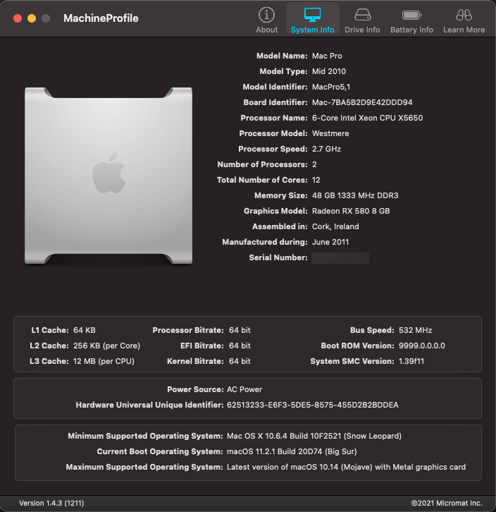

One question: in machine profile.app, my 5,1's bus speed is reported as being 532 MHz. Is this expected or can it be rectified in config.plist?
Some info, 48 GB RAM, OC 0.6.6, BootRom 144.0.0.0 (real), 9999.0.0.0.0 (not so real, OC)

Hi all
That's normal for 1066MHz memory.

I see, that look like another side effect of board ID injection (cosmetic issue).
Can you check if you disable SMBIOS spoofing, will that still shows Bus Speed 532MHz, or Processor Interconnect Speed 6.4GT/s?
Another possibility is that Big Sur never designed to handle the cMP. Therefore, the apps can't correctly extract the required info from IOReg.
Might be, as you said, that some apps cannot properly read data either because of OC or because big sur is not meant for a cMP. Another bench app, CL!ng, reports RAM as being non EEC but the device to device measurement is at 9090 MiB/s.
