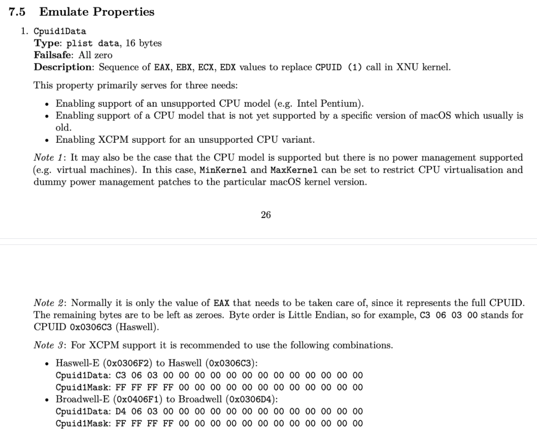

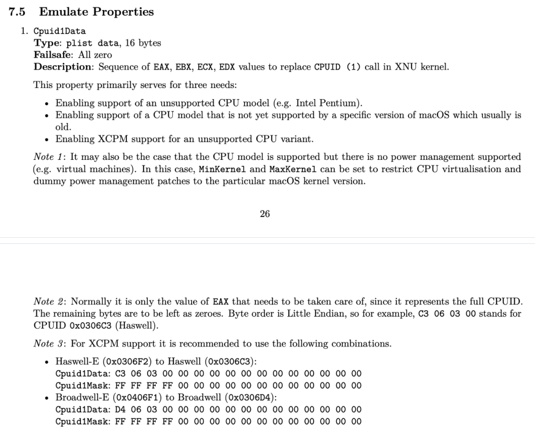

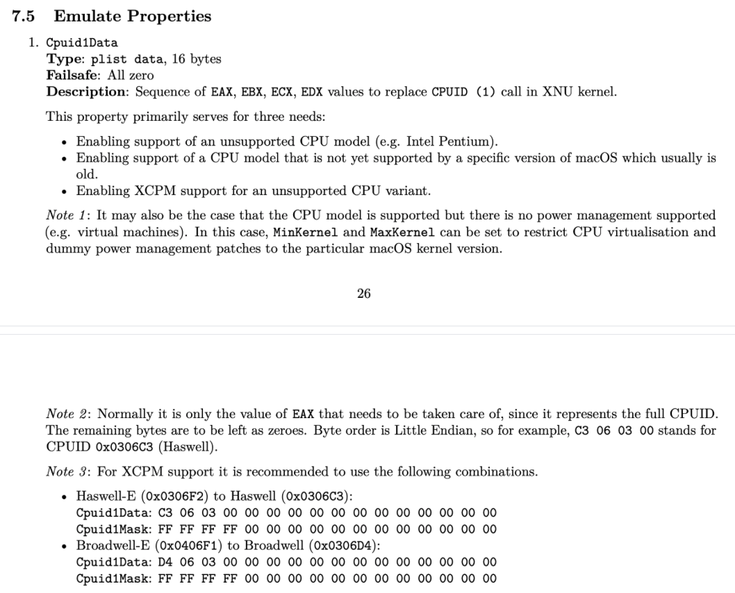

@cdf about the Cpuid1Data and Cpuid1Mask, the failsafe Hex values should be 16 bytes all zeroes 00 00 00 00 00 00 00 00 00 00 00 00 00 00 00 00, see #85. Your config.plist should include also these failsafe values.

The current values in cdf's config is correct.
I was under the impression the properties are actually not included into @cdf config and they are manually added with the advanced configuration. I just checked the config.plist and the property keys are there.
