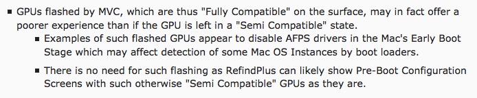

I’m thinking about getting my rx580 flashed by macvidcards. Anyone know if there are any issues or special handling needed to use with OC?
Have been working with Alex to reflash my boot rom and have had a lot of hassles without boot screen which he reccomended. Are there any known problems with rEFIndplus or OC if I get it flashed?

Might be best to refer back to him as he knows a lot about GPUs.
Reactions: startergo
So the reason it came up is becuase in order to flash BootROM, I had to pull all my drives out inluding EFI and make sure native booting to Mojave, but somehow the machine got all wacked with recovery mode and different things and it became quickly very tiresome...ultimatley still haven't gotten the machine back, have to reinstall Mojave, and Had to go get another mac in order to create a USB boot drive, which will be easier to manage with native boot screen also...not that Refind couldn't do that just fine, but Refind isn't currently on my native mojave drive, which I have been trying to keep pristine and "native"
you have me wondering though, perhaps I could put a different instance of RefindPlus on that drive (without OC), so that when I am going to boot native mojave, it would still go through RefindPlus first for the bootscreen, etc..without running OC... Then my other main EFI partition would have the normal RefindPlus+OC setup. that break my rule though of keeping the "fallback" drive absolutely native.
That might negate the need to flash the GPU...especially if there are going to be any potential issues with a MVC flashed GPU conflicting with RefindPlus+OC.
Your problem was not having a reliable fail-safe ready disk. I bet that most people here have old small SATA disks, some like me have several from old upgrades. I have one pair of vanilla Mojave fail-safe installs at my home and at my office and when things go whacko, I just install one with SATA bay 1 and reset the NVRAM 4-times.
Besides that, I also have a createinstallmedia USB Mojave installer always ready, everyone should have one 8GB USB key with it, things can go wrong and it's too cheap to not have one just for the day Murphy arrives. I remove any bootable disks and my Mac Pro the boots from the Mojave createinstallmedia USB disk automatically and after SIP is disabled, I do what is needed to be done.
If things really go out of hand, I remove the non-flashed GPU, install an AppleOEM (I have a GT120 always ready) and then I get everything working again.
You don't want it to happen, but when it will, you'll be glad to be ready.
