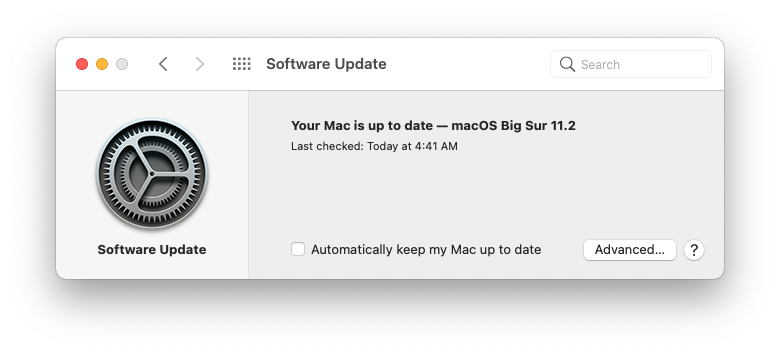

What do I need to do to get the updates to show up in system preferences?
It says I'm up to date with 11.2 when 11.2.1 should be available. VMM flag on doesn't make a difference.
Thanks
Mac Pro 5,1 (mid 2010), OC 0.6.6, Config attached
EDIT: Solved, had to disconnect VPN for the update to show up, Mullvad app was causing the issue.

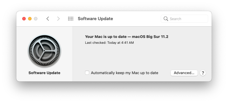

Thanks
EDIT: Solved, had to disconnect VPN for the update to show up.
