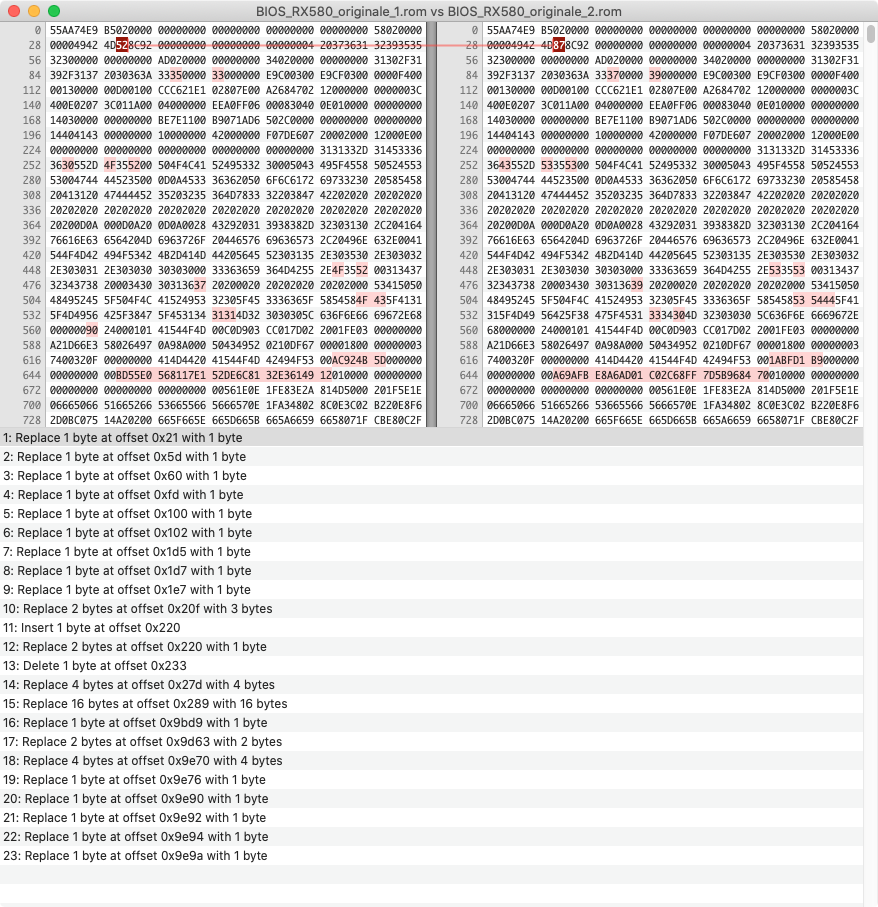

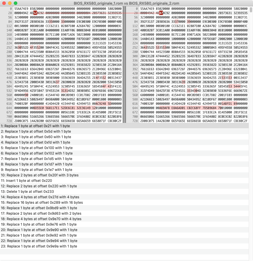

The ROM size will always be the same, as your dump is a binary image of the physical EPROM, either 128 or 256 kbytes.
The version reported may be the same.
Compare the two files and report back.
You are true, ROM are not exactly the same (even there are not much differences, all at beginning).

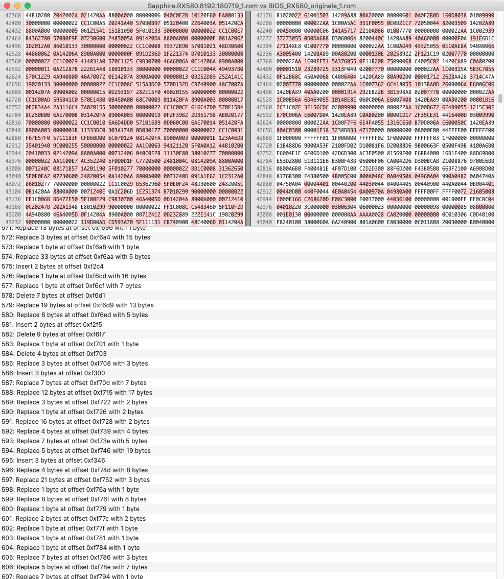

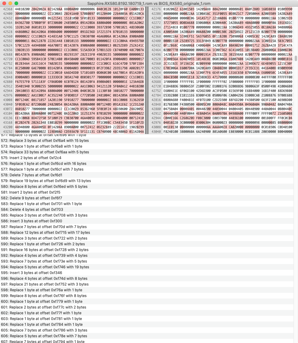

And even less, my bios is the same I downloaded from techpowerup.com and ati-atiflash utility said to be the same:
Here there are much more differences, even in the middle from the files.

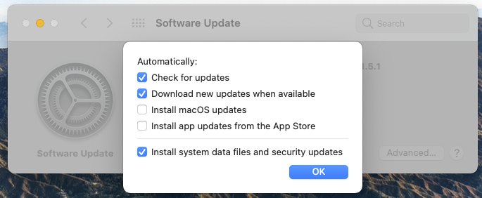

@cdf do you know what could cause the new software notifications not to function? I was running until yesterday on 11.4. not knowing 11.5 and 11.5.1 were released, I never got the notification.
Not sure. Probably not an OpenCore thing because I know that your config is correct. I installed 11.4 and shortly thereafter 11.5, both from a bootable installer. In 11.5, I received the 11.5.1 notification and proceeded with the update.
I was offered 11.5.1 as soon as I finished installing 11.5! I didn't install 11.5.1 immediately, but a couple of days afterwards. It went fine (using latebloom).

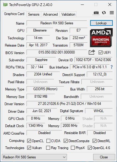

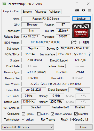

OK, at last a found the switch and turned the card to "the other mode" (is there a way to know which mode I get?). But nothing changed for boot picker... I can't see any. :(
And looking the GPU-Z information, the ROM seems exactly the same with 1340/2000MHz default clock (I don't insert both screenshots, because they have exactly the same data):
.View attachment 1812331
But the firmware that ati-atiflash utility said it's the same as the one loaded on card before any modify, was the one compiled on 2018-07-19 01:39:00, with 1411/2000 clock frequencies. And the one that ati-atiflash utility accepted to load on card (an with which card seemed to be broken), was the one compiled on 2017-10-19 06:35:00, always with 1411/2000, instead ati-atiflash utility won't install the firmware with 1340/2000MHz.
