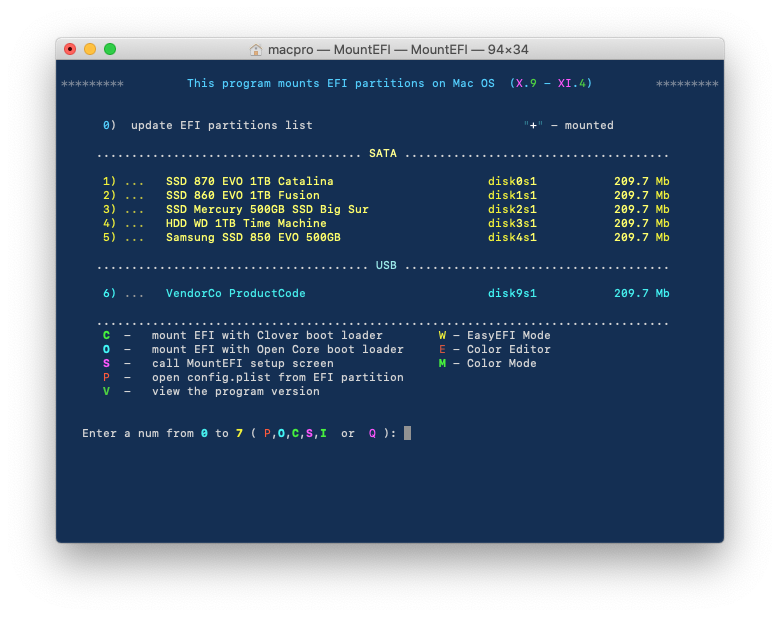

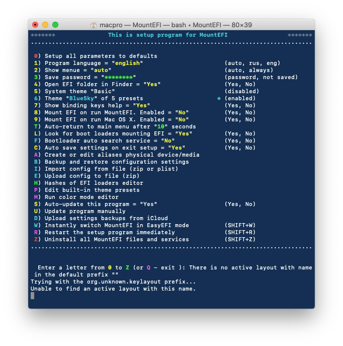

If you are looking for a clear, quick and easy way to mount, dismount and identify EFI volumes I suggest you head over to Github for Andrej Antipov's MountEFI utility program. MountEFI
MountEFI is a shell script program which operates in Terminal. MountEFI provides a Terminal GUI for searching and mounting EFI/ESP partitions for macOS versions Maverick to Big Sur.
After you download the MountEFI-master.zip file look in the MountEFi-master folder for MountEFI.zip file.
Unzip MountEFI.zip to get the MountEFI.app. When you click on the app it will start Terminal and present its GUI main menu.
As noted in several previous posts macOS reassigns disk numbers on restarts. A particularly nice feature of MountEFI is that the setup menu provides the ability to create or edit an alias for physical device/media. This feature is provided through letter A of the Setup Menu. Looking at the screenshot of my Main Menu example below look at SATA device #5. This is the native name of my Samsung SSD disk. Disks 1 to 4 have been re-named using the alias feature. These disk names can follow any scheme you want and are retained between cold and warm restarts which eliminates confusion as to which disk has which EFI and operating system. There are many other useful features for loading and configuring config.plist files that you can explore.
Screenshot of the Main Menu:

Screenshot of I - Extra Menu
Screenshot of S - Setup Menu
